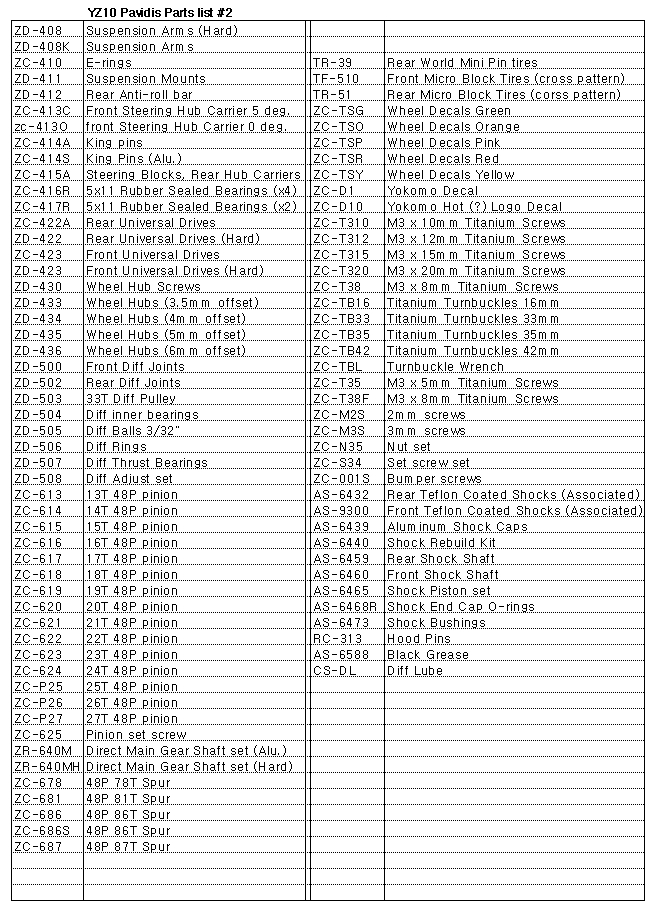

There's ZC and ZD part number prefixes?
My 93 uses a ZC-656 rear belt and a ZC-651 front belt.
As for the pulleys, they are also available as ZD/ZC-503. The ZD is 33T, the ZC is 35T.
Associated also has a YZ10 parts list PDF.

However, there won’t be a part number for the 93 WCS car with M3 Belts, as the very few kits that were made were only ever M2 Belt driven.
The parts list you have there will be for the “Works” cars not the “World Championship Special” which was a oddball mix of Works 93 and Works 94 cars (Pre 94 back end and Post 94 front end) and ran a belt longer than the Pavidis (the longest listed M3 belt).
After some sleuthing we have managed to work out it should be 175t with the 35t pulleys 👍
