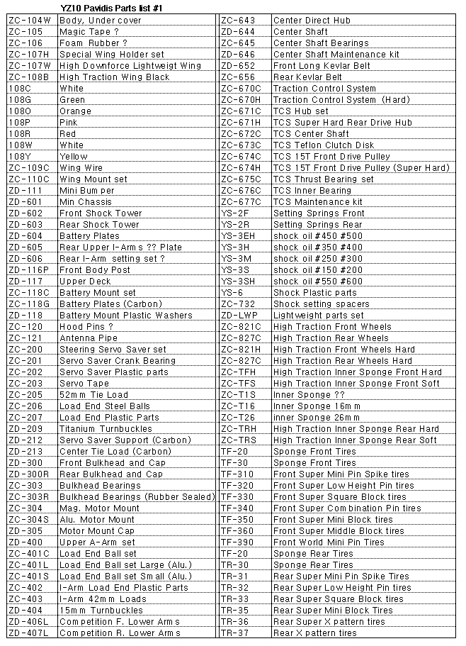

There's ZC and ZD part number prefixes?
My 93 uses a ZC-656 rear belt and a ZC-651 front belt.
As for the pulleys, they are also available as ZD/ZC-503. The ZD is 33T, the ZC is 35T.
Associated also has a YZ10 parts list PDF.
