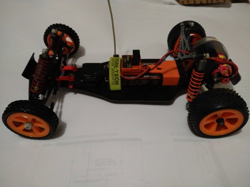

She's a runner now. The electronics layout isn't pretty, mostly becuase I have the battery adapter cable and lipo voltage monitor that i use to run on my older electronics. The Futaba ESC is pretty damn nice. need to do some swapping of tires and such before I run it on a track. I found that JC Racing makes JRX2 wheels that are 2.2 so I'm definitely going to try to source a couple sets of those might do an upscaled version of my Pro logo wheels wheels I did for the mini later on for this. Didn't have to redo the battery hold down adapter, I just moved the Pure Tech strap forward more since where it was mounted originally the holes were kinda messed up. Still need a new body, wing, wing tubes, some hardware and replace some ballcups that have excessive slop (but still not as bad as the Mini JRX2 out of the box lol) but overall I'm fairly happy with it as a runner, although it is a bit on the uglier side.

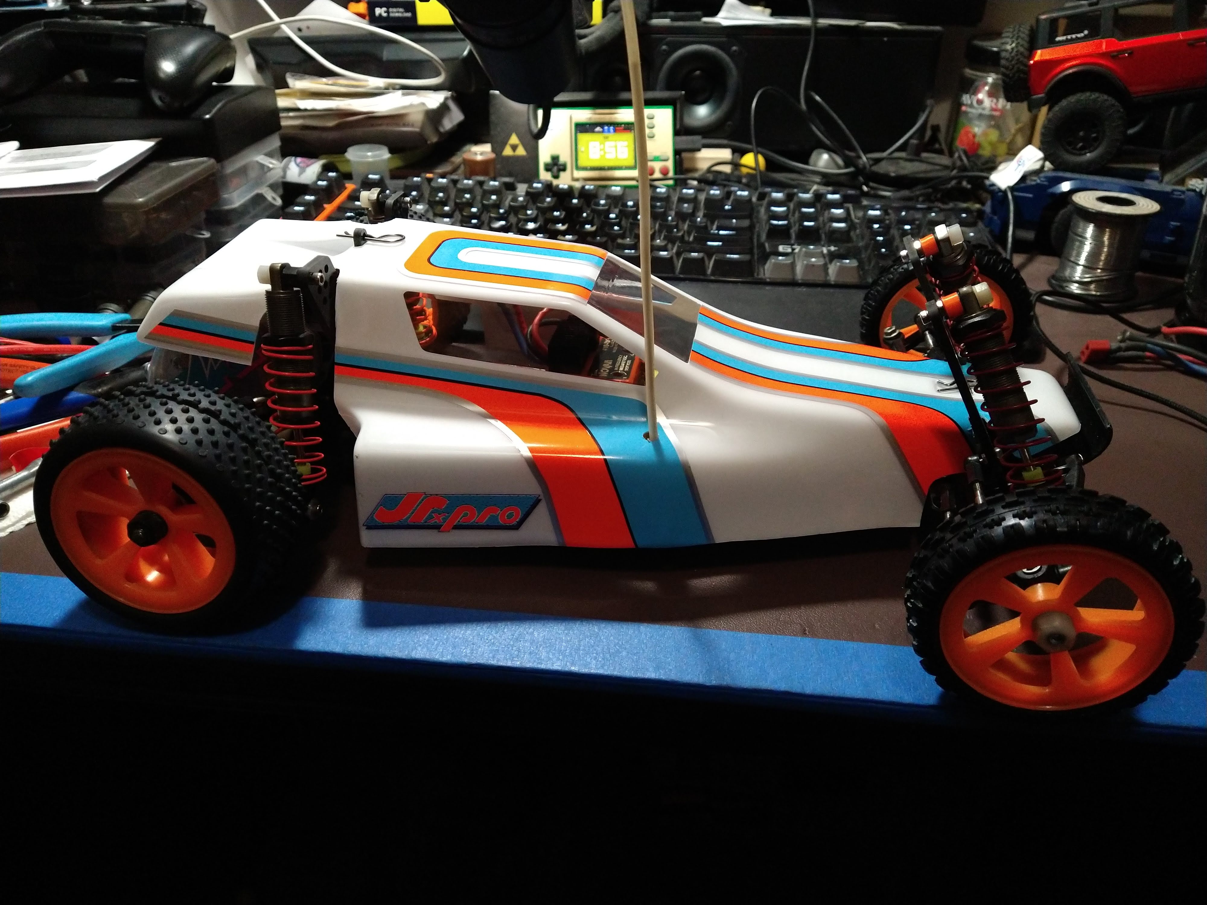

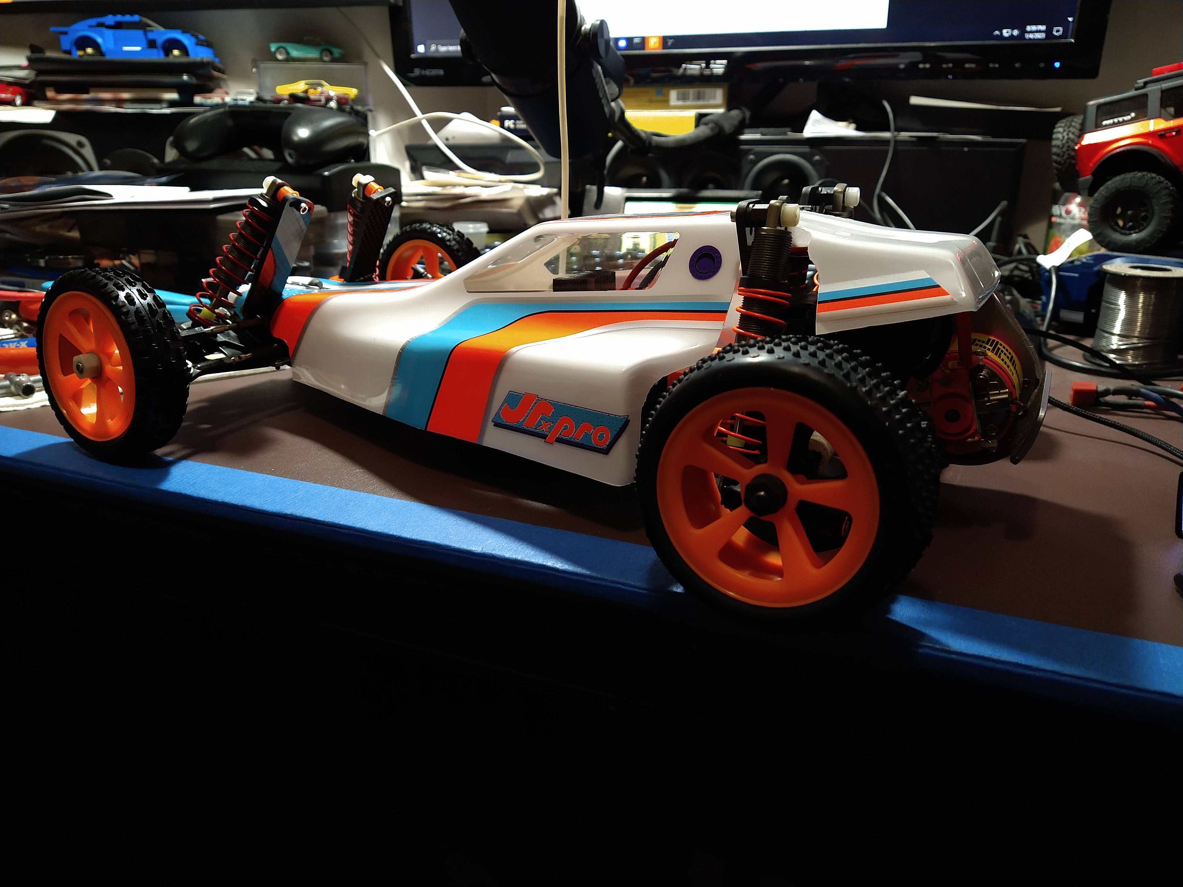

Got my MCI and TBG order in a few days ago and decided to paint up and decal the Pro finally.
Image Image
Image Image
It wasn't my intention to do Gulf colors but the colors just go so well.
Even did my Mini JRX2 in the same scheme, now if they only made neon orange wheels for the mini.
