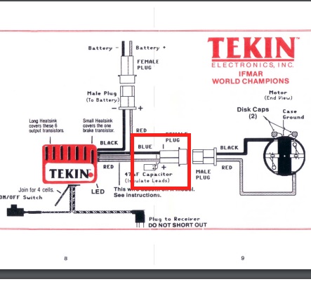

ChocoTaco73 wrote: Tue Oct 11, 2022 3:28 pm Getting the runner ready for the Kinwald Classic this weekend. Going up against B2s and XXs so I doubt it'll be all that competitive but it will be fun! Hoping my 88/89 vintage Tekin ESC600 Pro XT holds up, was surprised it even worked lol
Love it! What's with the Cap on the motor leads though? shouldn't that be on the battery leads instead?

RogueIV wrote: Tue Oct 11, 2022 8:18 pm Love it! What's with the Cap on the motor leads though? shouldn't that be on the battery leads instead?
Nope, on the motor leads. Used a cap from my Hobbywing Justock ESC since I had it handy.

ChocoTaco73 wrote: Tue Oct 11, 2022 9:03 pm
interesting, never seen that one before. Learn something new everyday!

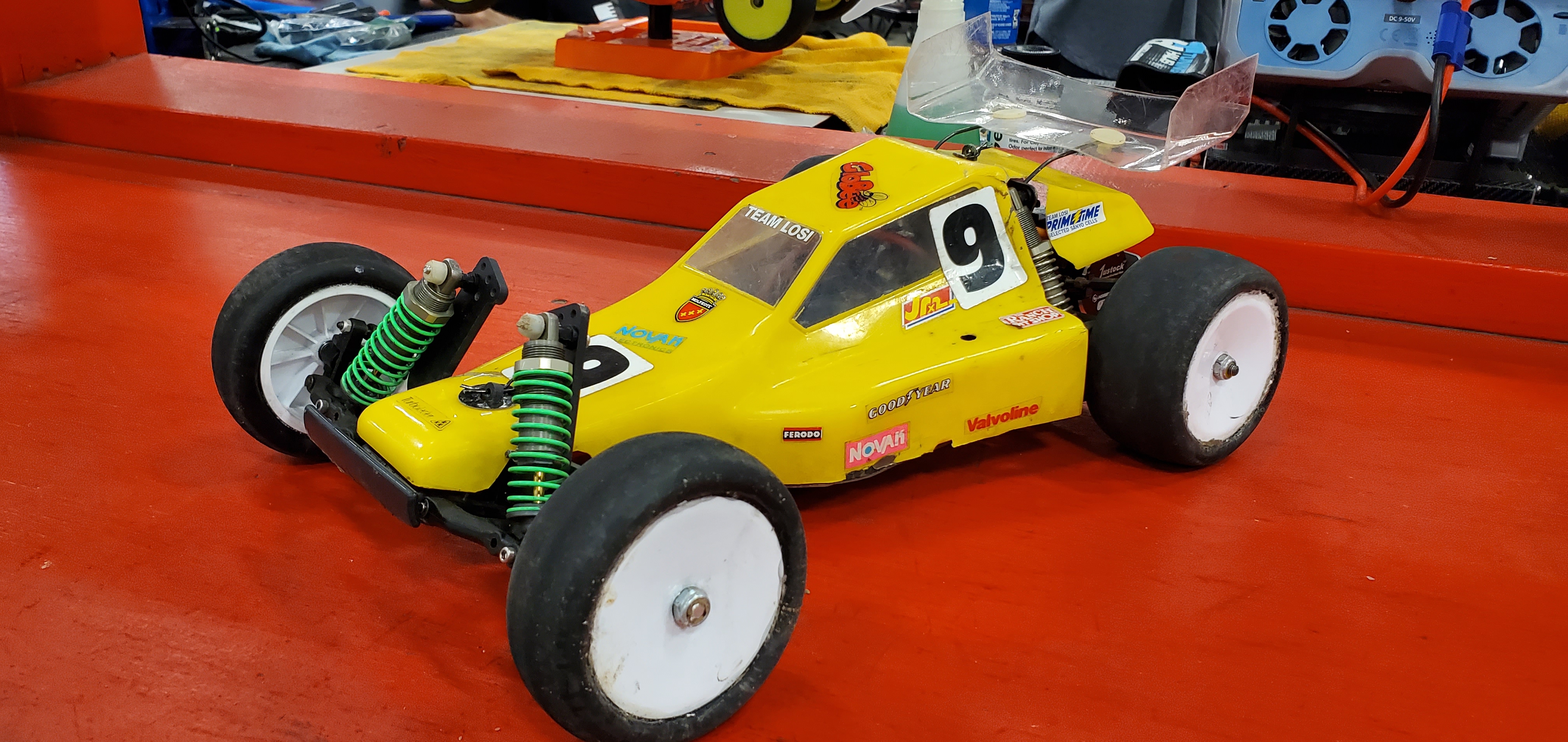

Welp, qualified first in the Vintage B main and had the lead til the very last lap when I buffed it lol With the exception of a turnbuckle the old girl didn't let me down all weekend. So fun actually racing a JRX2 after after 30+ years. Good times!

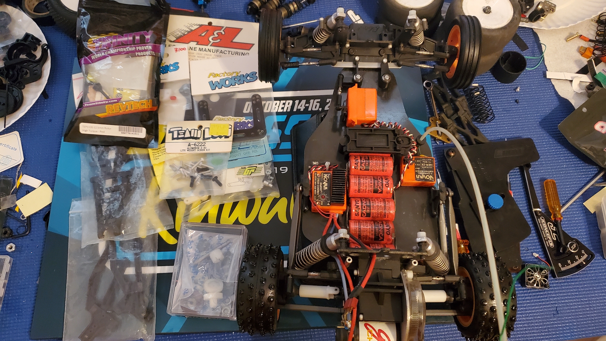

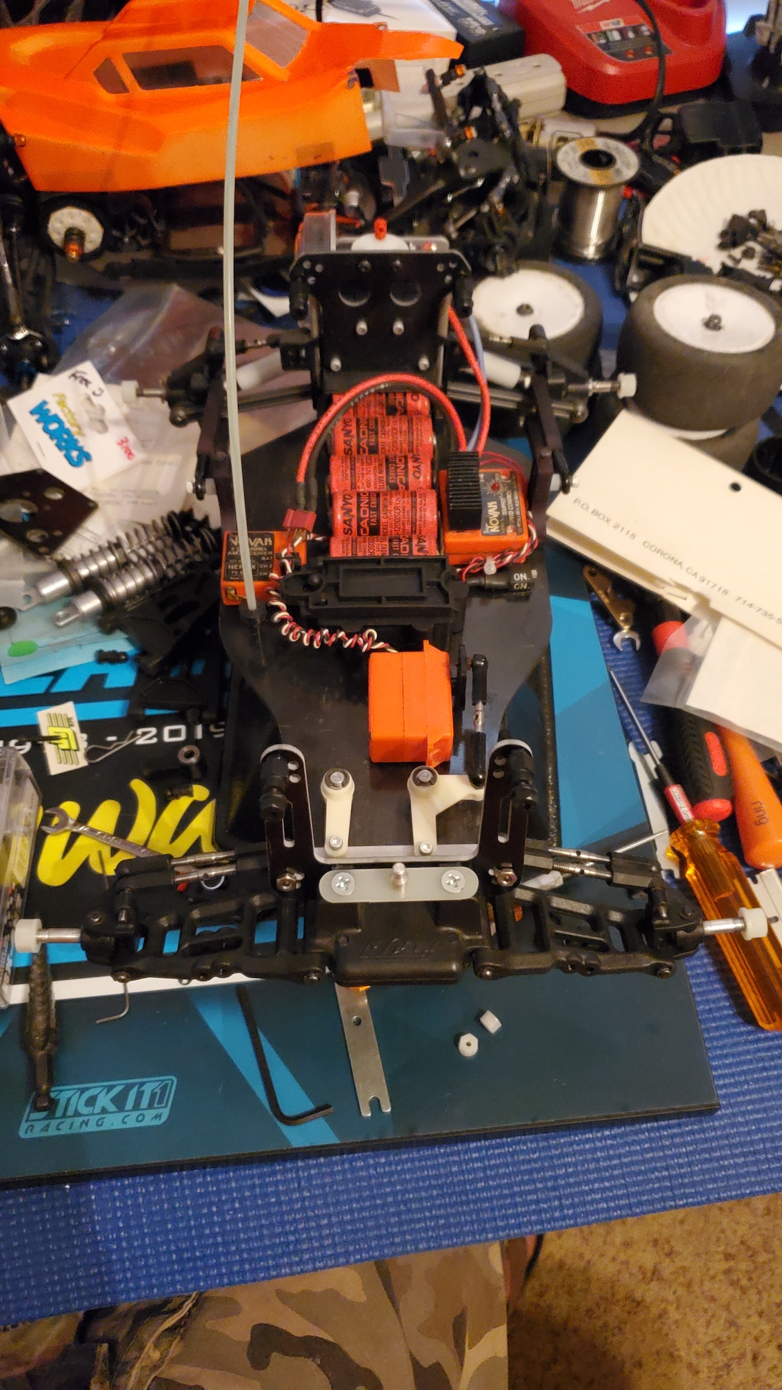

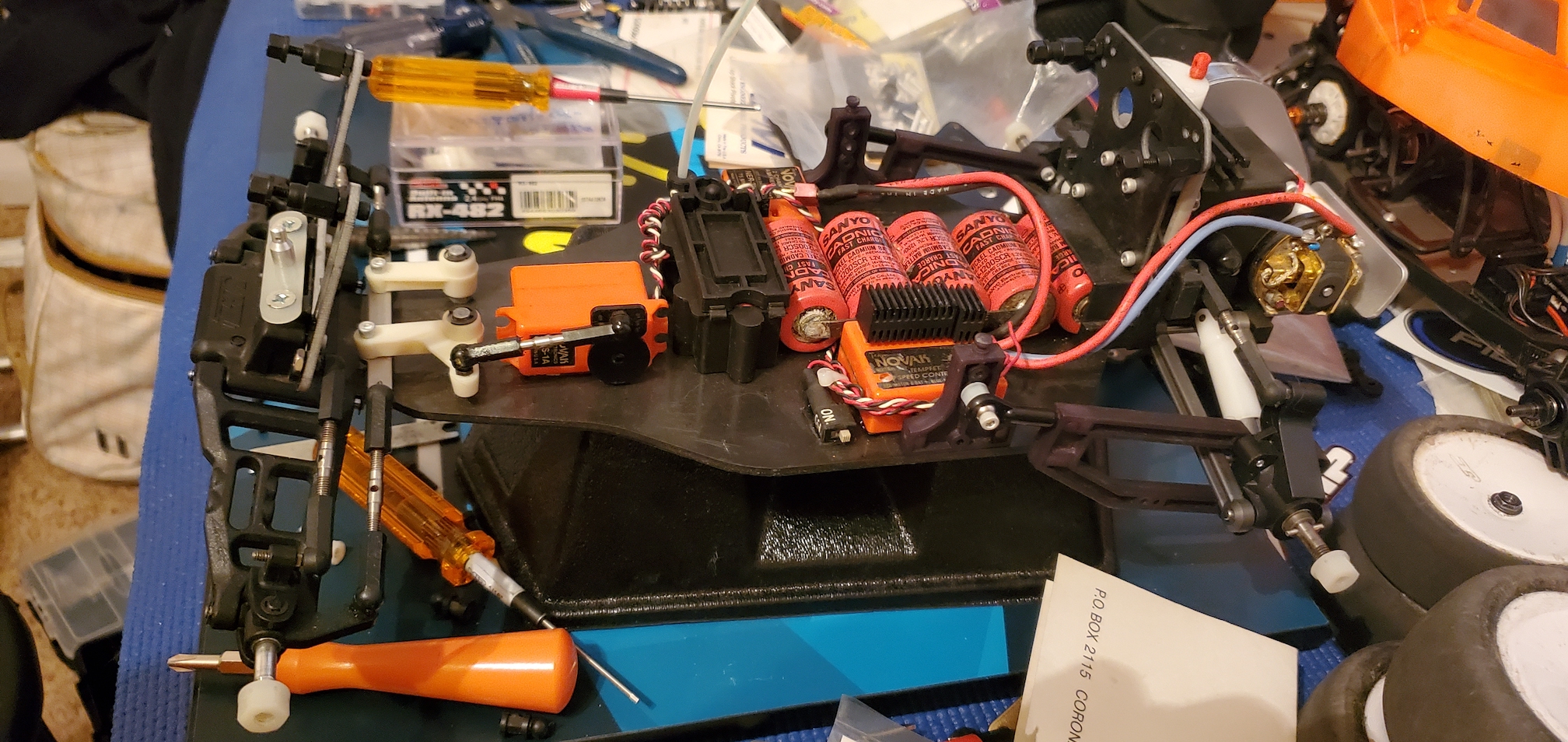

Decided to show my shelfer some love today with:
Lunsford trailing arms
A&L/Factory Works front and rear shock towers
JG front body mount
MIP bellcranks
Andy's front arms
RPM upper shock bushings
More to come :mrgreen:

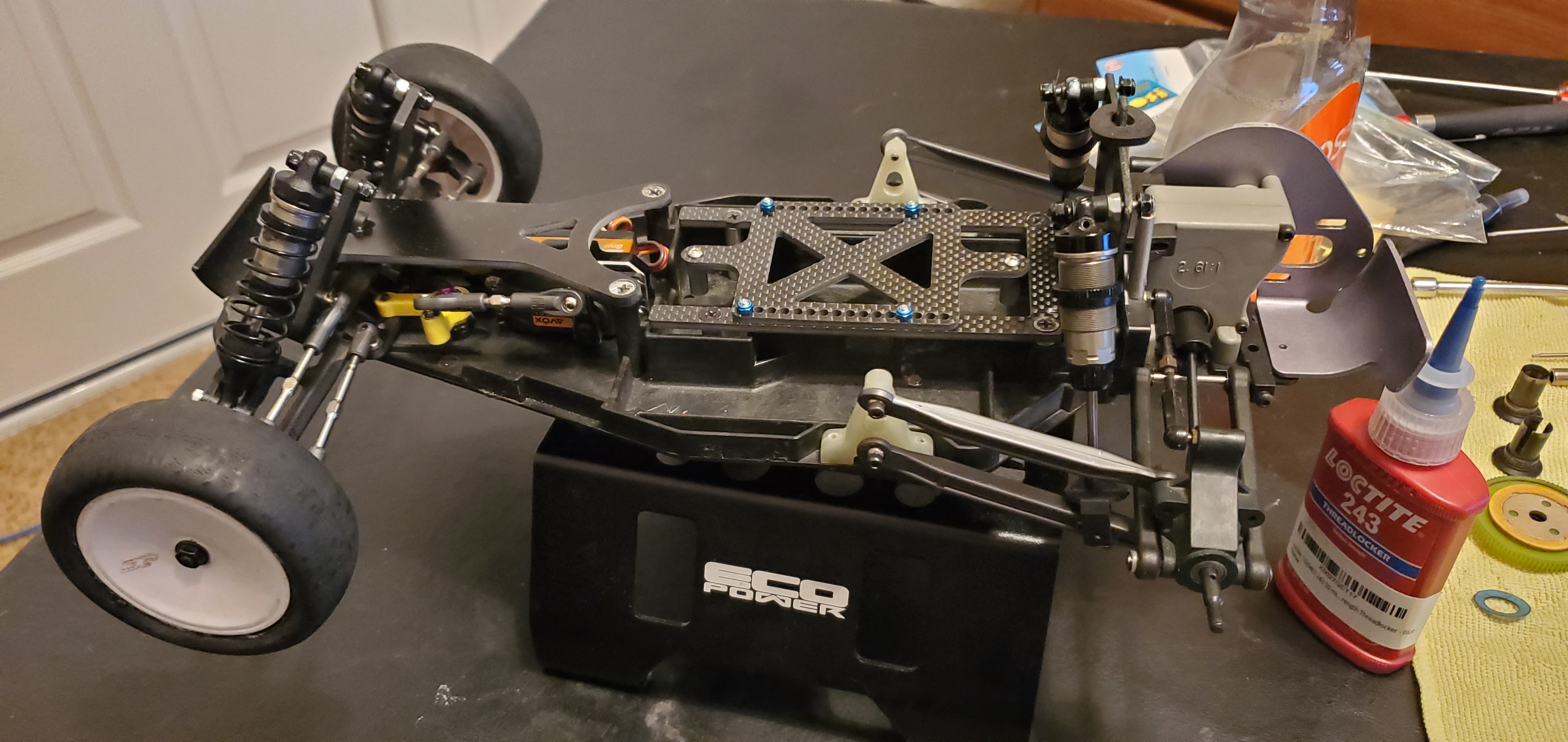

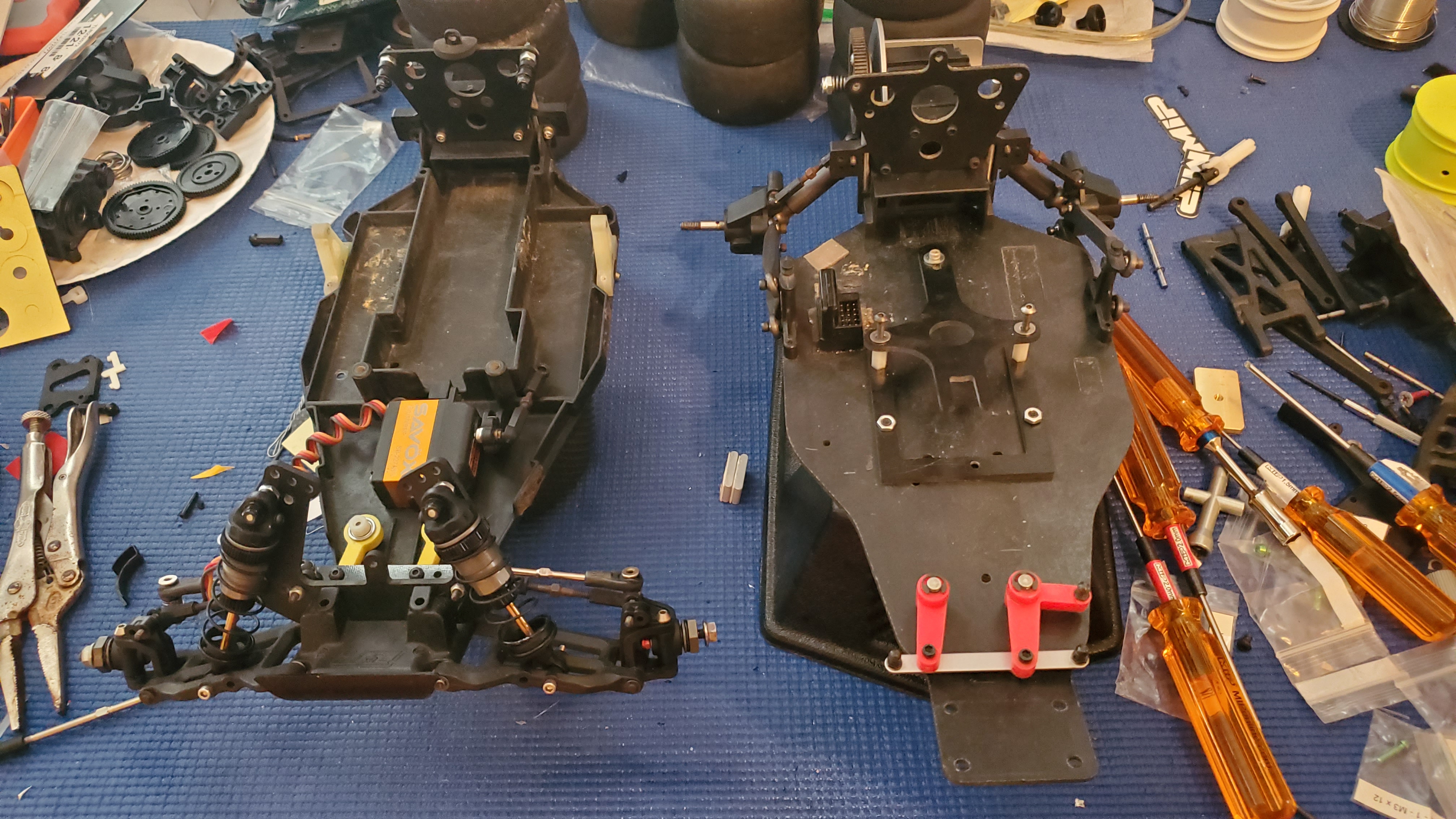

What's better than 1 5-link runner? Why 2 of course :mrgreen:

ChocoTaco73 wrote: Wed Dec 14, 2022 5:09 pm What's better than 1 5-link runner? Why 2 of course :mrgreen:
What hub and knuckles are up front on the JR2 chassis?
ChocoTaco73
Posts: 112
Joined: Wed Jan 26, 2022 6:53 pm
Location: Las Vegas, NV
Has thanked: 57 times
Been thanked: 101 times
Re: My JRX2 restore/race build
Post by ChocoTaco73 »
Schumacher Cougar LD2, so I can use my modern hex AE offset front wheels. I'll most likely use my JC Racing wheels for the other, want to keep that one mostly stock.

ChocoTaco73 wrote: Mon Dec 19, 2022 7:56 pm Schumacher Cougar LD2, so I can use my modern hex AE offset front wheels. I'll most likely use my JC Racing wheels for the other, want to keep that one mostly stock.
RogueIV wrote: Sun Dec 18, 2022 12:06 pm
Is that a direct fit? I wonder if I can do the same with the Storm ST parts and my LXT so I don't have to use my wheel adapters.
ChocoTaco73
Posts: 112
RogueIV wrote: Mon Dec 19, 2022 10:11 pm Is that a direct fit? I wonder if I can do the same with the Storm ST parts and my LXT so I don't have to use my wheel adapters.
I had to drill out the Schumacher caster blocks to 1/8 in order for the hinge pins to fit but that's it.
