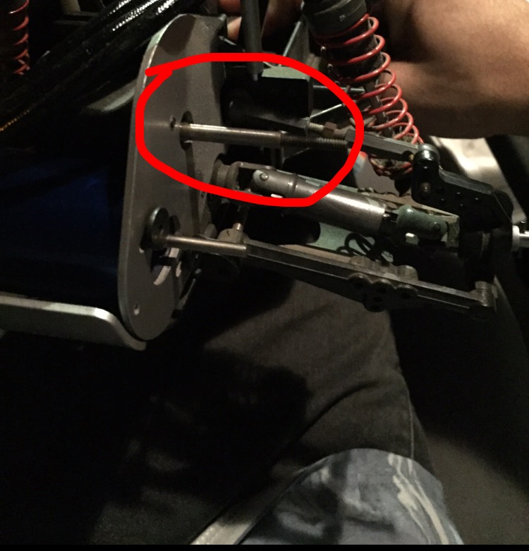

Hey guys so the other day i found my dads old jrx2 he built when he was a kid but never got it running, so i thought id try and buy the parts for it to get it running. I'm sorta new to this so any help would be appreciated! I ran into a problem with the spur gear(i believe is what its called). the guy at the hobby shop said i am missing an extension to it. Not sure what to look up online to find it so anyone know what it is?

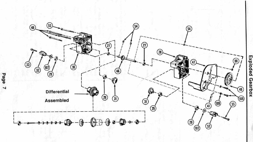

Don't know what extension he's talking about...
In this diagram from the manual, the area you are talking about is on the far right - but that's for the stock setup. That pinion shaft looks longer than stock though...maybe for a hydra drive? Do you have any other parts to go with this?
Re: JRX2 build help
i dont have any other parts unfortunately. but i did some research and it looks like all im missing is the clutch, spring, and hex nut, am i right?R Cane wrote:Don't know what extension he's talking about...
