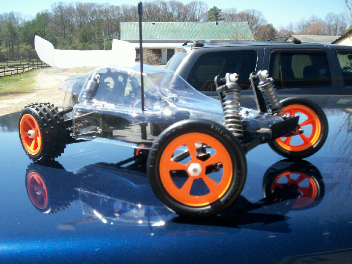

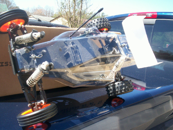

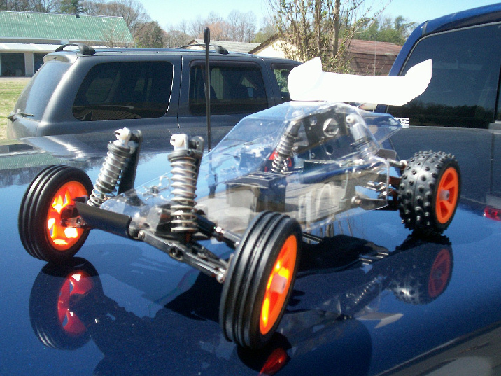

This will be my first Jrx2 build , just picked this up locally over the weekend along with a small box of parts. Looks like all the parts are still there to reassemble the 5 link. Performance and durability wise which is the better set up to use and also the large screws on the bottom of the chassis are also quite worn , is there any recommendations for replacement screws.

Almost finished , just need some small parts here and there. Installed the b2 front and rear rims , tried xx rims but they rubbed on the suspension links. I see what you guys mean about the slop. Thought my rear wheels wear loose but I took it for a test spin around the house and it does seem to drive well although the transmission does sound a bit loud. Is it normal for these transmission to make a bit more noise or am I just use to the almost silent rc10 stealth transmission. Well , on to the body...

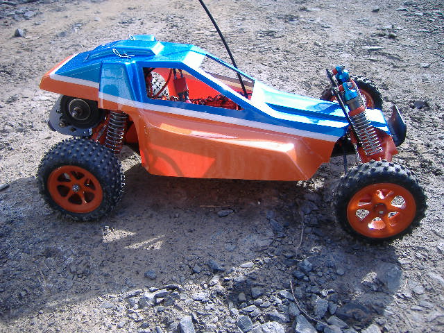

here is a pic of my x2. if you call gary mcallister and ask for the roadrunner (i can't recall the pt#)they will pull one for you. with a little creative trimming it looks pretty good
heres one on my trx1

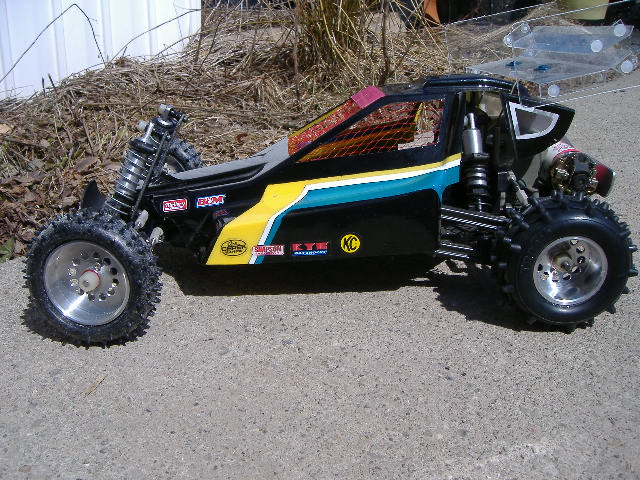

You can get a body? their on ebay here is mine with Erichs repro? your car is comming along great
