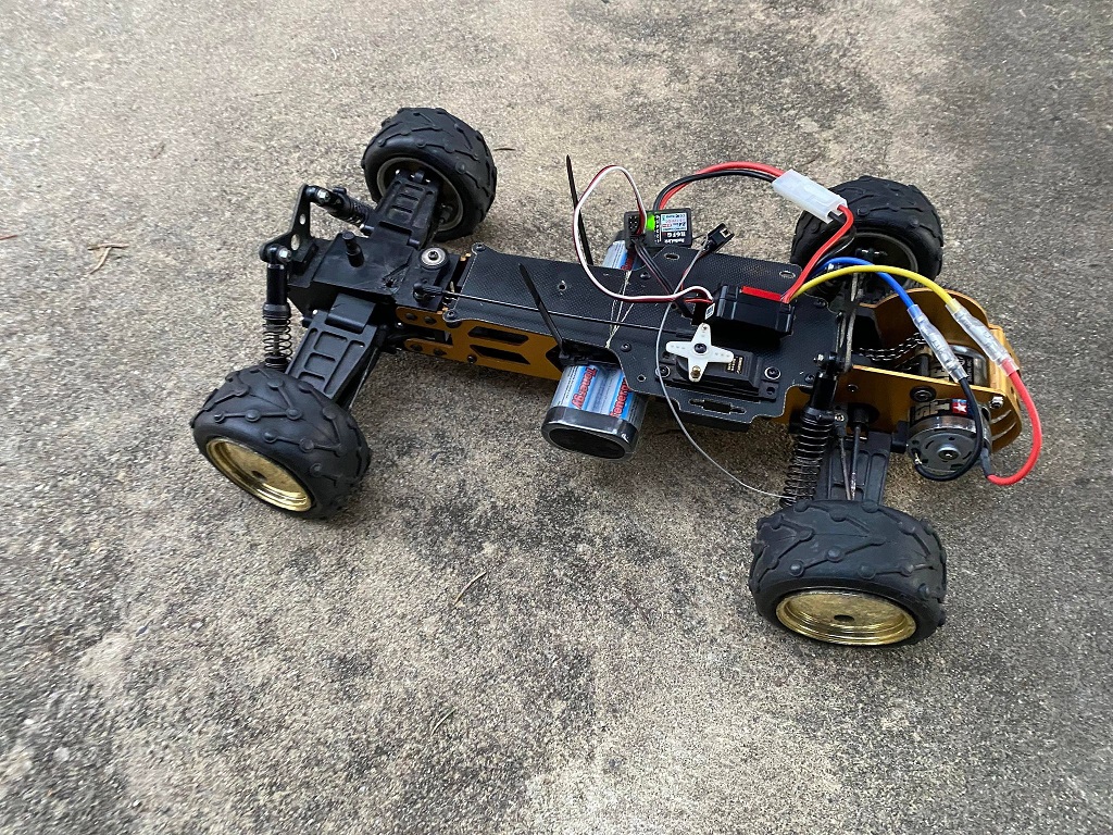

here is a bit of teaser on the AYK Radiant... after getting it running i remembered how terrible the steering was. since i don't need two servos i can make a new top plate that will also have a hook and loop strap on each side to hold the battery. the steering linkage in the chassis had become loose and to get to it meant tearing down the car... a bit of a pain to service. i'm hoping to resolve the steering once and for all. my attempts when i was 15 left some damage by using a steering setup from some other manufacturer that did nothing to fix the problem and left a hacked up bit of plastic with nothing to show for it. it makes me mad just looking at the hack job i did. i was young and foolish.
holy crap even with rotted tires this thing is fun
this is a bit of poor design that has far too much sloop and the screws work loose under the load of steering
testing moving the steering servo forward for a far more simplified top plate layout. the long throw arm and weak servo can be replaced with a much shorter throw and high torque servo, maybe.

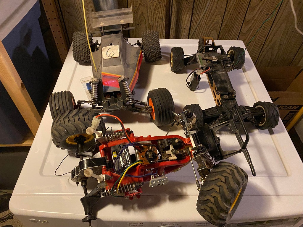

the collection last week.

while still having the cars is pretty cool, they were all very well used and abused. the least challenging to get back to running condition is the JRX2/T - it needed parts for the shocks and will need bell cranks as they are splitting at the ball joint holes. the Blackfoot is now running but it will be some time until it is where i'd like it to be. the Radiant is going to be the most challenging as parts are rare and it was not well treated by my 15 year old self.
