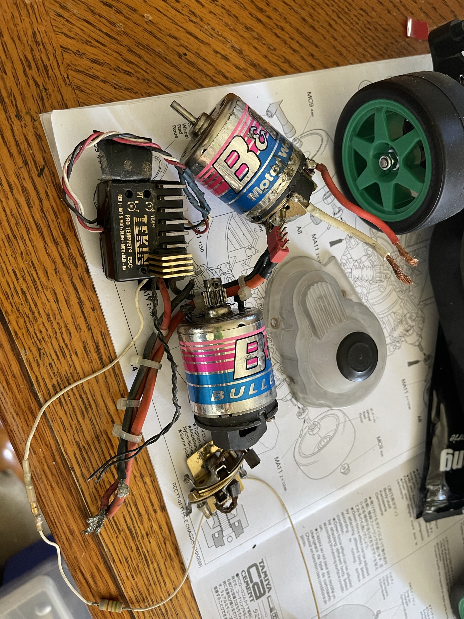

I found some of the extra parts that came with the car. The round indentations behind the Tekin is a dead giveaway.
Best things I see are the ESC and cover. Motors look beat.
