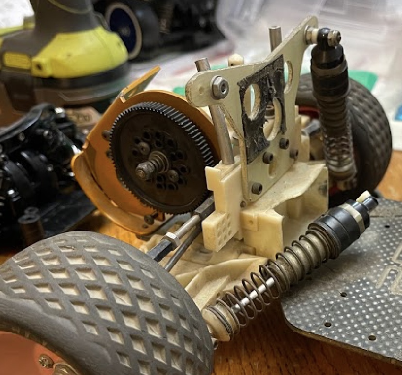

New guy here and excited to get back into RC with my kids. I’m in my 40’s so these buggies were my first love. I’d watch my neighbor for hours jumping his RC10 on the sidewalk. My parents got me a first gen Ultima. Loved it. Lol. Later, I got into nitro and vintage Tamiya before the kids came along. I’ve always wanted an RC10.
I remember getting this chassis from an old apartment manager years ago. Memory is hazy. Not having time to research, I stored it. Fast forward 10+ years…I’m going through my boxes.
Last night I did some cursory research on this forum and other databases. I narrowed it down to an early 90s RC10 graphite. But is it a Team car? I see it has parts missing and aftermarket pieces. I’d like the resident expert eyes to lake a look at the following folder. Maybe I’m completely wrong. :lol:

Just would like to see if this is something my son could bash around or selected as a restoration project. Either way it’s a plus!

I don't think the RC10 Graphite had a Team Car version, just a bushing and a bearing version, and a 6 gear and stealth gearbox versions. Yours has the stealth gearbox.

Yes, it's a team car.
I wouldn't give it to your son to bash on. Most of the parts are discontinued and usually pricey if you need to replace them. if he's new to R/C, I'd get him a Traxxas Bandit if you wanted to stick with a buggy. They're pretty durable and parts for them are everywhere.

That car looks to be in great shape.
Be sure to re-hydrate the nylon parts before trying to drive it. A lot of durability is lost when the parts dry out over time.

So that’s pretty neat! It’s headed to be a restored runner then. I thought maybe it could be a Team car based on what’s left of it. Going to do some more research on parts and other cars posted here. Need to see what “rehydrating” entails too.
It’s probably not super rare but cool to find it’s a special version.

Real nice Graphite Team Car you have there. Welcome to the madness :lol:

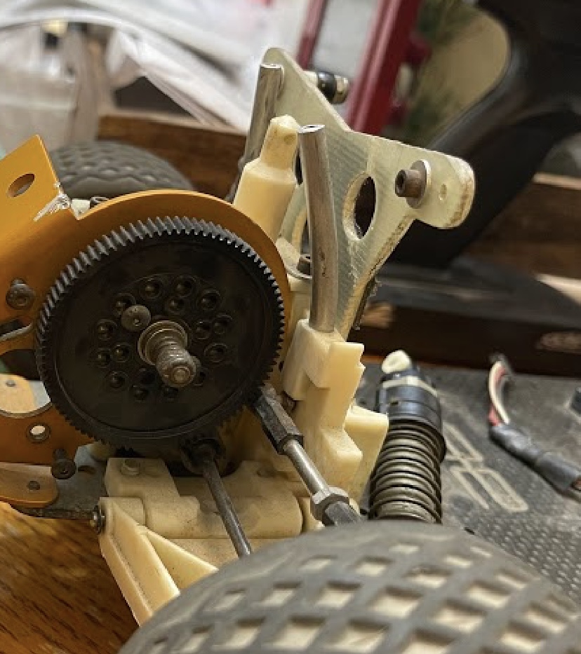

A piece of K&S #83060 aluminum tube cut to length will teplace that bent wing tube just fine. But that rear shock tower looks like it might be cracked. It might need replacement or upgrade.

Frankentruck wrote: Tue Jan 03, 2023 11:08 pm A piece of K&S #83060 aluminum tube cut to length will teplace that bent wing tube just fine. But that rear shock tower looks like it might be cracked. It might need replacement or upgrade.
Yep good eye. The rear tower is damaged. Aluminum tube tip noted.

The RPM is a vast improvement over the original pieces.
IMHO, the original setup is probably the RC10's biggest problems. It wasn't corrected until the Worlds car, which basically used a cheap copy of Hogue bellcranks.
Shock towers are easy. Originals are still common, JConcepts makes some, Vintage RC, and Factory Works. Most of my cars have Factory Works towers, as Jeff is awesome to work with and has lots of options.
