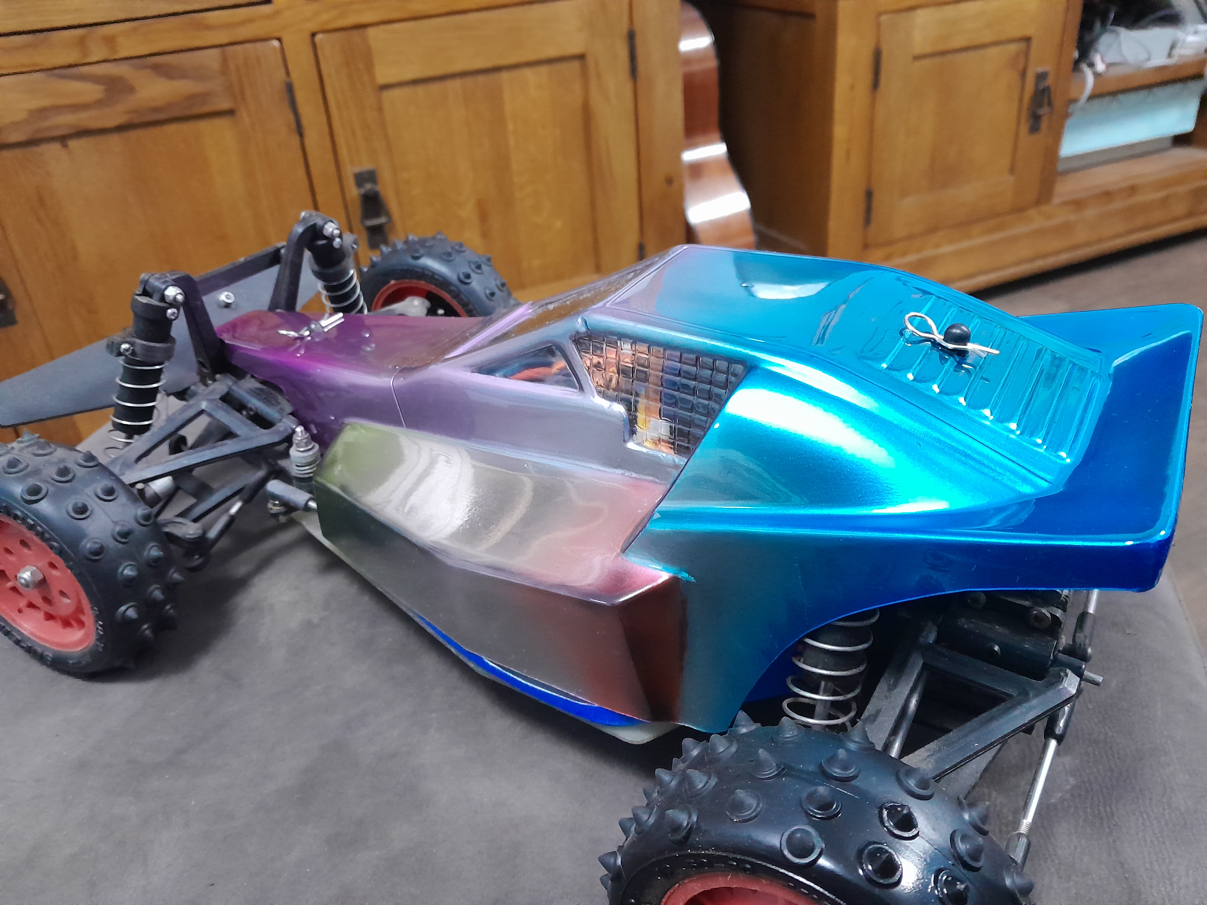

I finally summoned the nerve to try the new paints on a body , I've had this Mini Mustang body waiting for 6+ months , these are candy colours faded in with chrome on the sides and aircraft fuselage aluminium through the centre section then all backed with black , the chrome colours show every little defect in the body mould , and every little paint defect too.

Yep that is the worst thing about chrome paint. I use the Spaz Stix chrome paint when I airbrush chrome on a body and if you even have a simple speck of dust, or a fingerprint, or even look at it cross eyed it will show up

Real chrome is the same, magnifying dents and such.
Instead of chrome, I use metallic silver. It has more of a bright aluminum color.

The above two comments are spot on , the reflection shows absolutely every tiny defect , I can see the roughness of the buck used to form the body , little chips in the buck , I get that the buck is probably as old as the hills but I've never seen this effect before .
