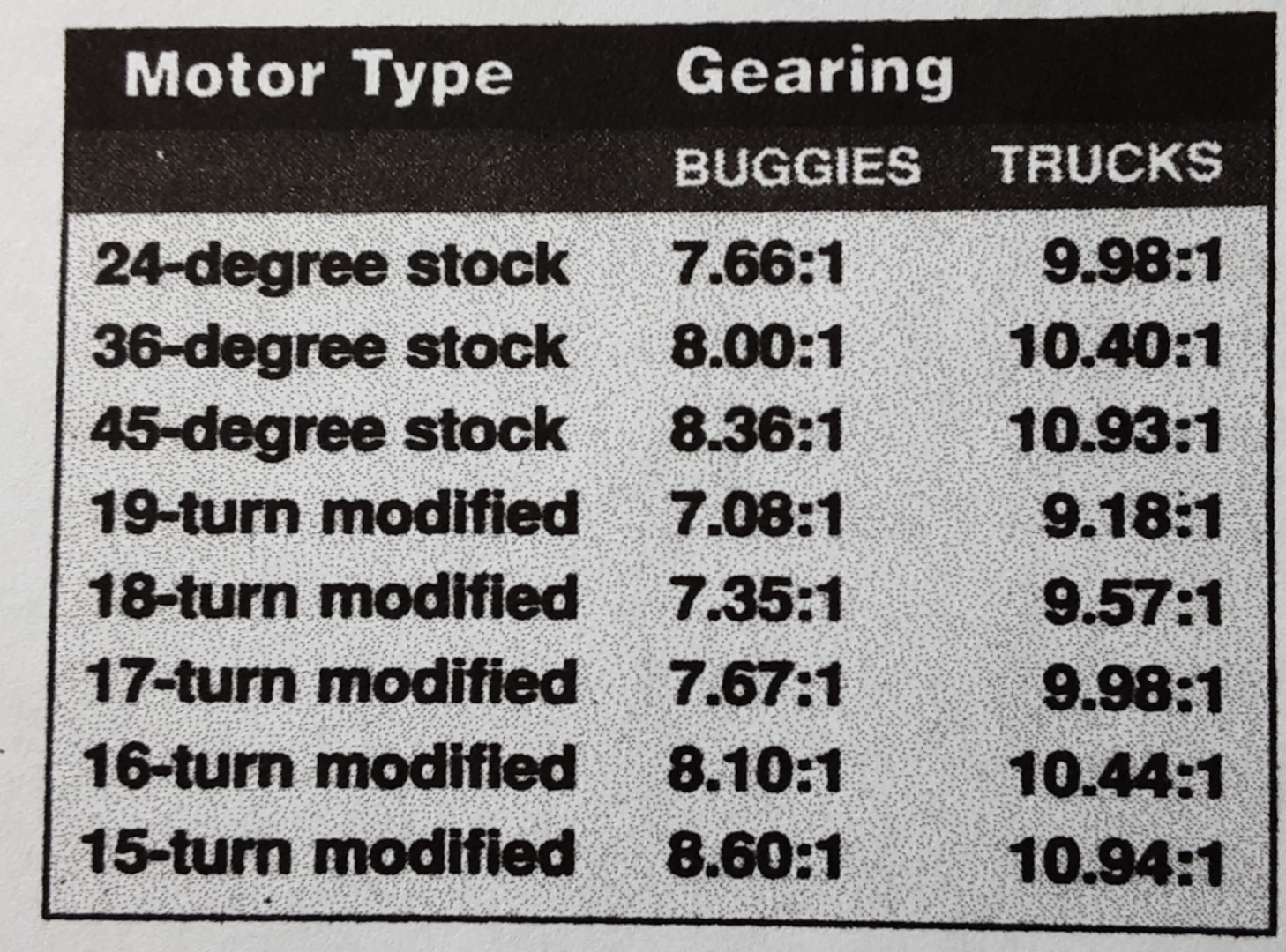

Here are some final ratio recommendations from back in the day. Keep in mind that those were based on racing conditions with older SCRC batteries.

1.83:1
