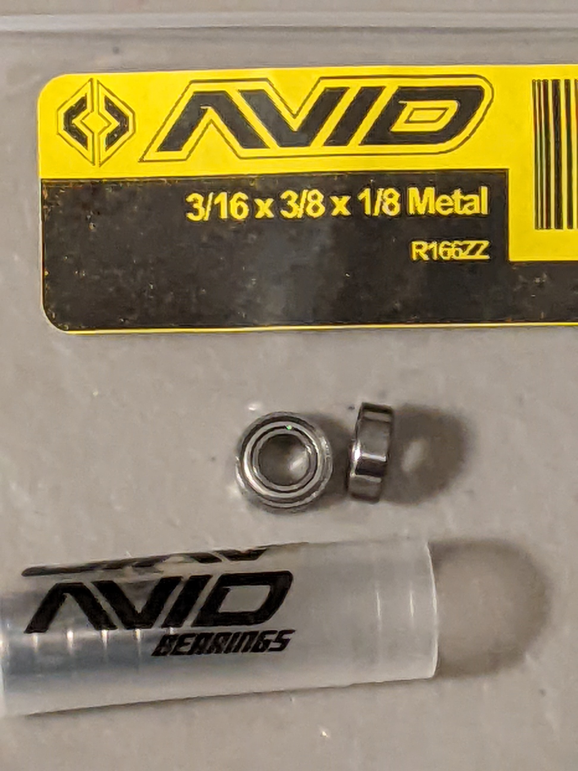

Any pictures of what your rear axle setup currently looks like could be helpful, just to confirm.
If the rear bearing carrier/hub is just a straight through hole with nothing to stop bearings from being pushed all the way through, then you need flanged bearings. Those are industry part number FR166ZZ. If flanged bearings aren't needed, then R166ZZ will work. A total of 4 are needed to do both rear axles. I last orders mine from Avid, but those part numbers work on many places. Hobby suppliers, Amazon, etc. Avid is basically $1 per bearing so I get spares.

Copy that amazon link please I typed csw7210 in there and have found zipp!! Thank you for the bearings ill need those!!
