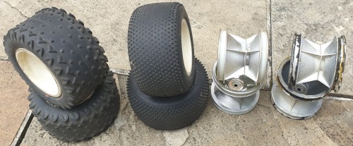

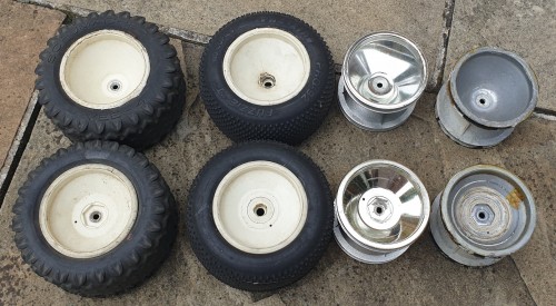

I looked in the shed.... soooo many rabbits.... but U2 were (as always) wrong - I found what I was looking for :lol:
The wheels with rubberware are, from memory, from a Schumacher Wildcat truck. Sadly, they're glued on,and fairly worn, so would need a dose of acetone vapour.
The third pair are new chrome rears, I think from a Rascal or similar...
The fourth pair are a well used pair of white rears, painted silver.

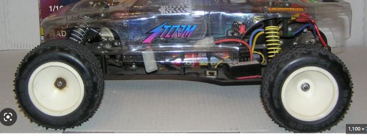

klavy69 wrote: Fri Jan 27, 2023 9:05 pm You got pictures of what storm wheels look like?
There were 2 styles (maybe more) and I think both were available in yellow or white.
The pics are from the interweb for illustration purposes. Not mine.
