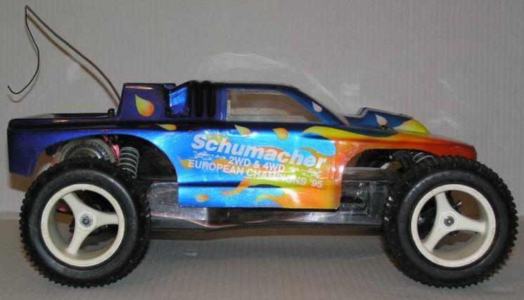

klavy69 wrote: Fri Jan 27, 2023 9:05 pm You got pictures of what storm wheels look like?
There were 2 styles (maybe more) and I think both were available in yellow or white.
The pics are from the interweb for illustration purposes. Not mine.
