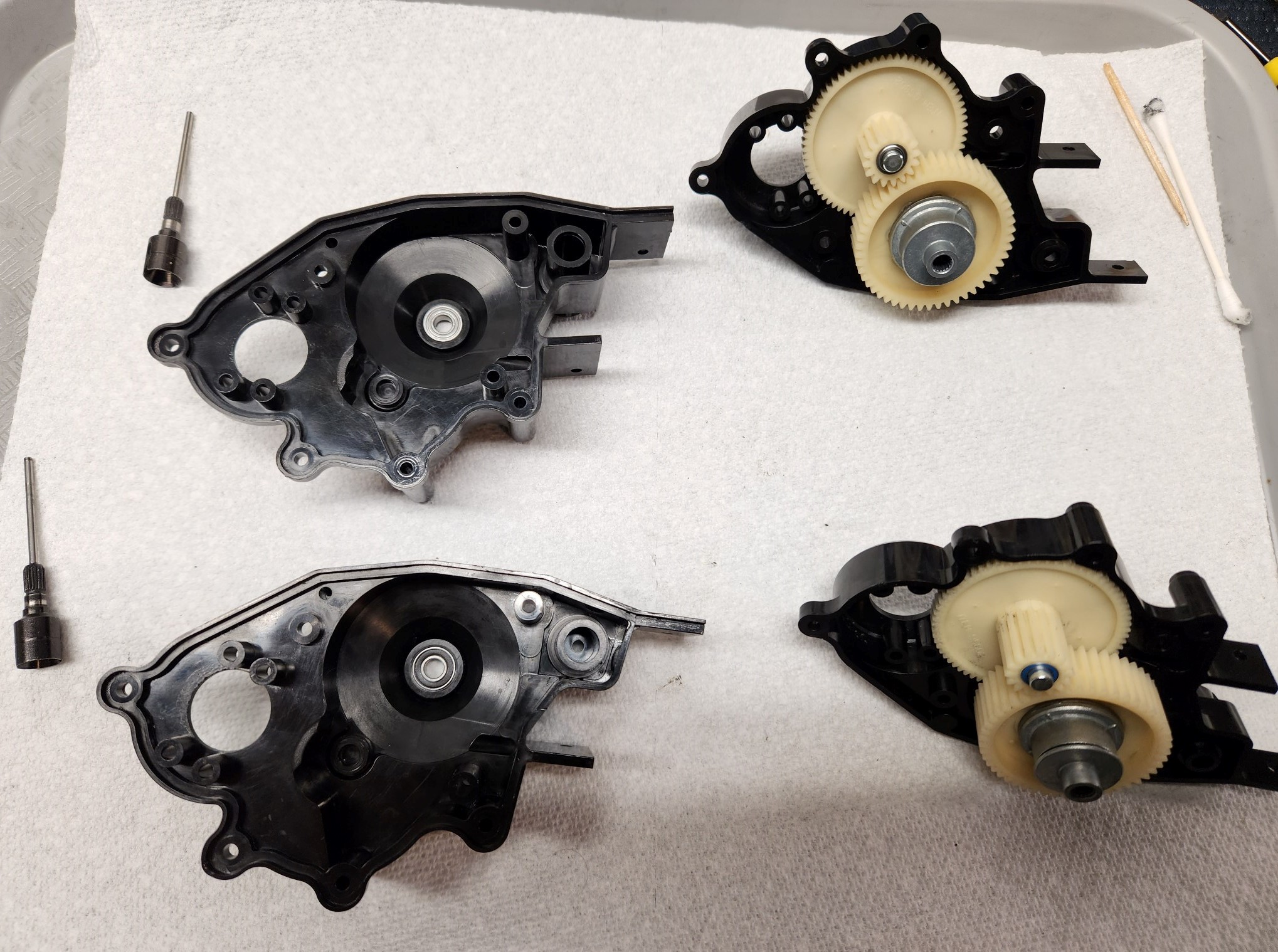

Started putting together two FXT's. Cleaned all parts in the ultrasonic cleaner and assembled the transmissions. Replacing all the bushings with bearings.

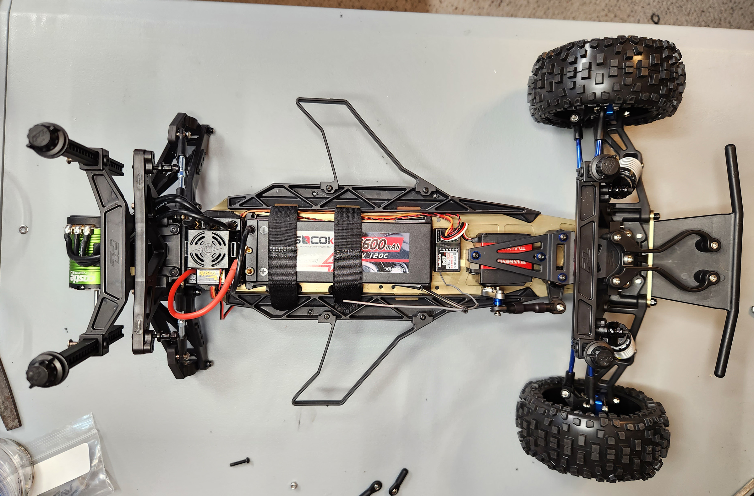

Got a little more work in on the Pro-2 as I have to wait a few days for trans parts. Front end and pan section are fully done, and even fully wired. Just need to clean some rear end parts and get the trans internals, and will be looking into body and paint. I really want to jump the gun and get into the body, but I am a clear body reamer/cutter/trimmer kind of guy, so have to wait until the end.

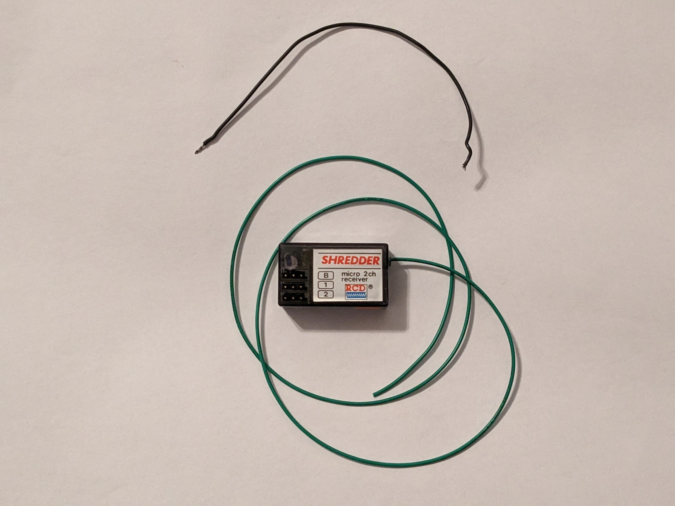

Replaced the stubby antenna wire on a nice little Shredder receiver with one of the correct length. It should have been black like the original, but since it's 75mhz the green that I have isn't a bad change.

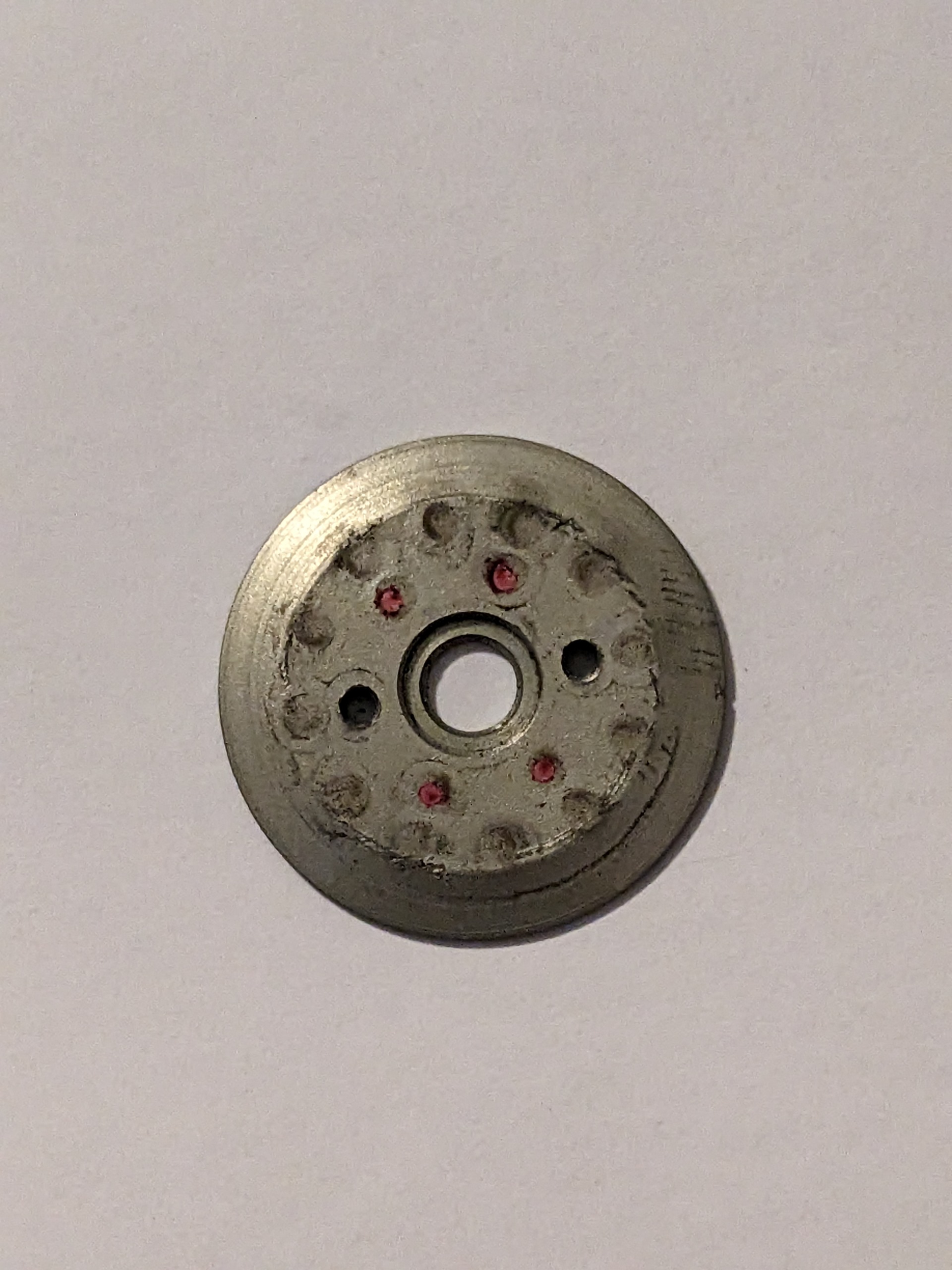

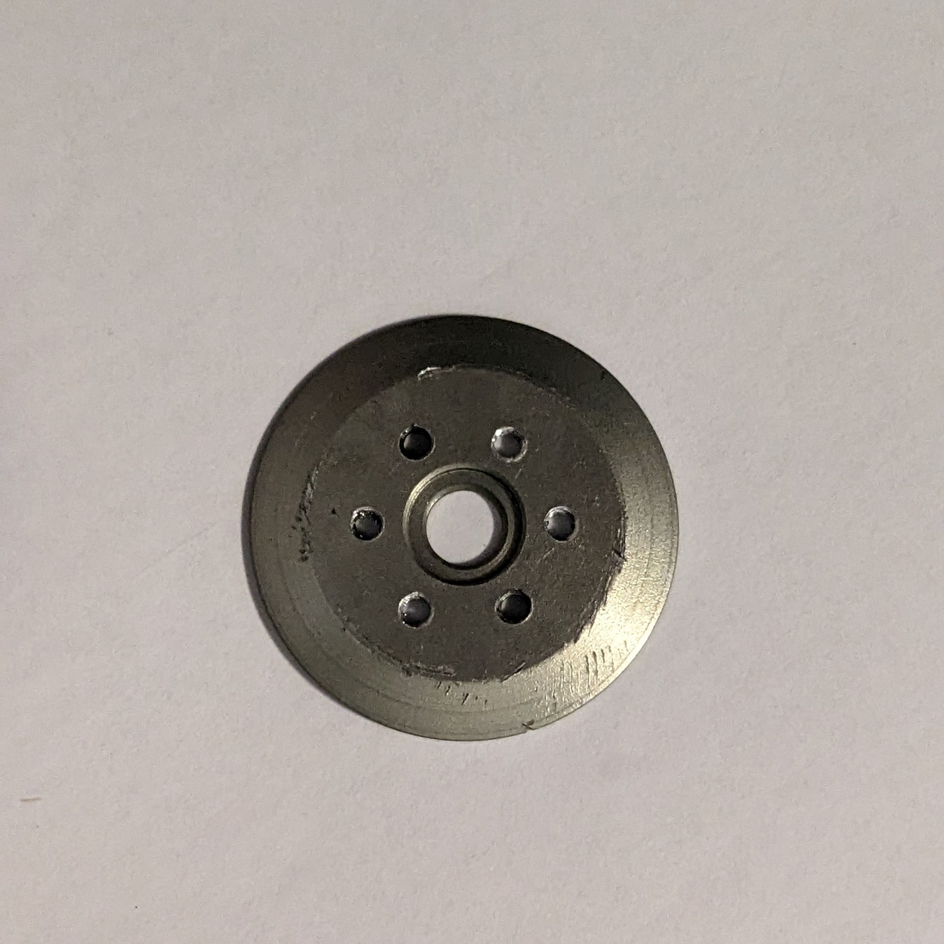

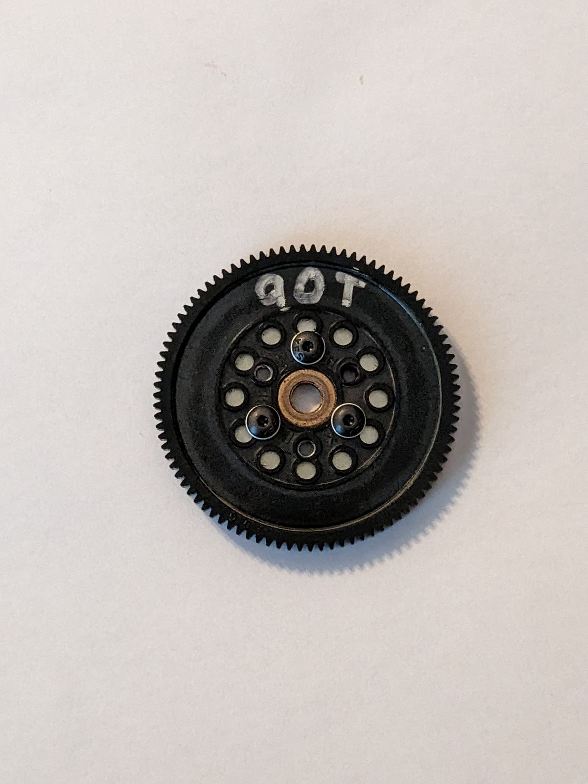

Also experimenting with slipper hub spur gear attachment. Was 2 screw now is 6 screw. Using 2 is a poor design because it results in spur gear rocking that loosens the 2 screws. The 3 screw pattern is ideal. I can do that now or do the 6 screw overkill. I'll try the 3 first.

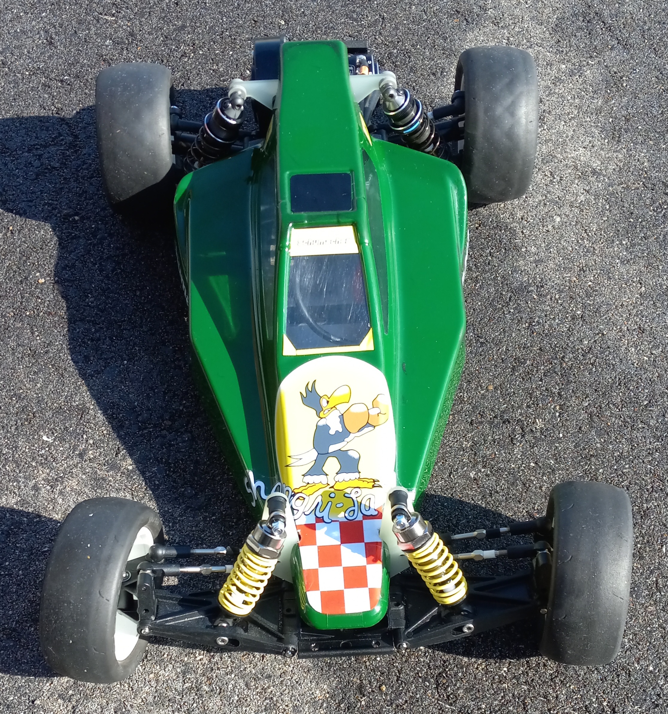

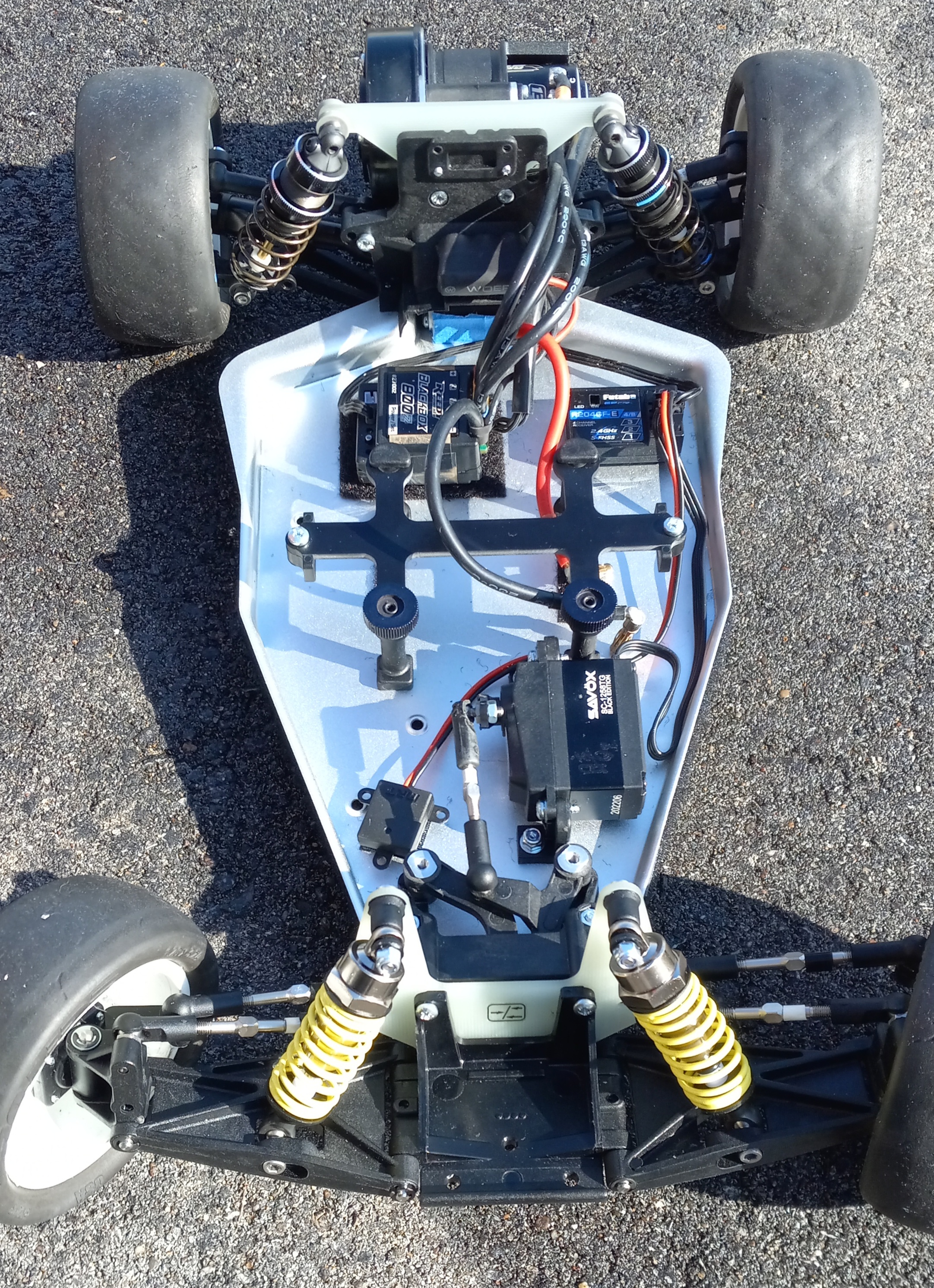

I moved the short front big bore shocks to the back of my Cougar. I attached them using an XLS mount and ditched the wing assembly/shock mount/body mount setup. They have 5mm of internal limiters and 70w oil (up from 45). I put the stock front shocks back on the front with ~7.5 mm of internal limiters. This took nearly 10 mm out of the ride height. I am trying to resolve traction rolling issues and, of course, make it faster.
Quite convenient that the XLS mount lined up perfectly. The XLS suspension strap fits perfectly as well, and can be inverted to get the car even lower. I had concerns about the strength of the strap, though, because it would have moved the shock mounting points much farther out and away from the bulkhead.

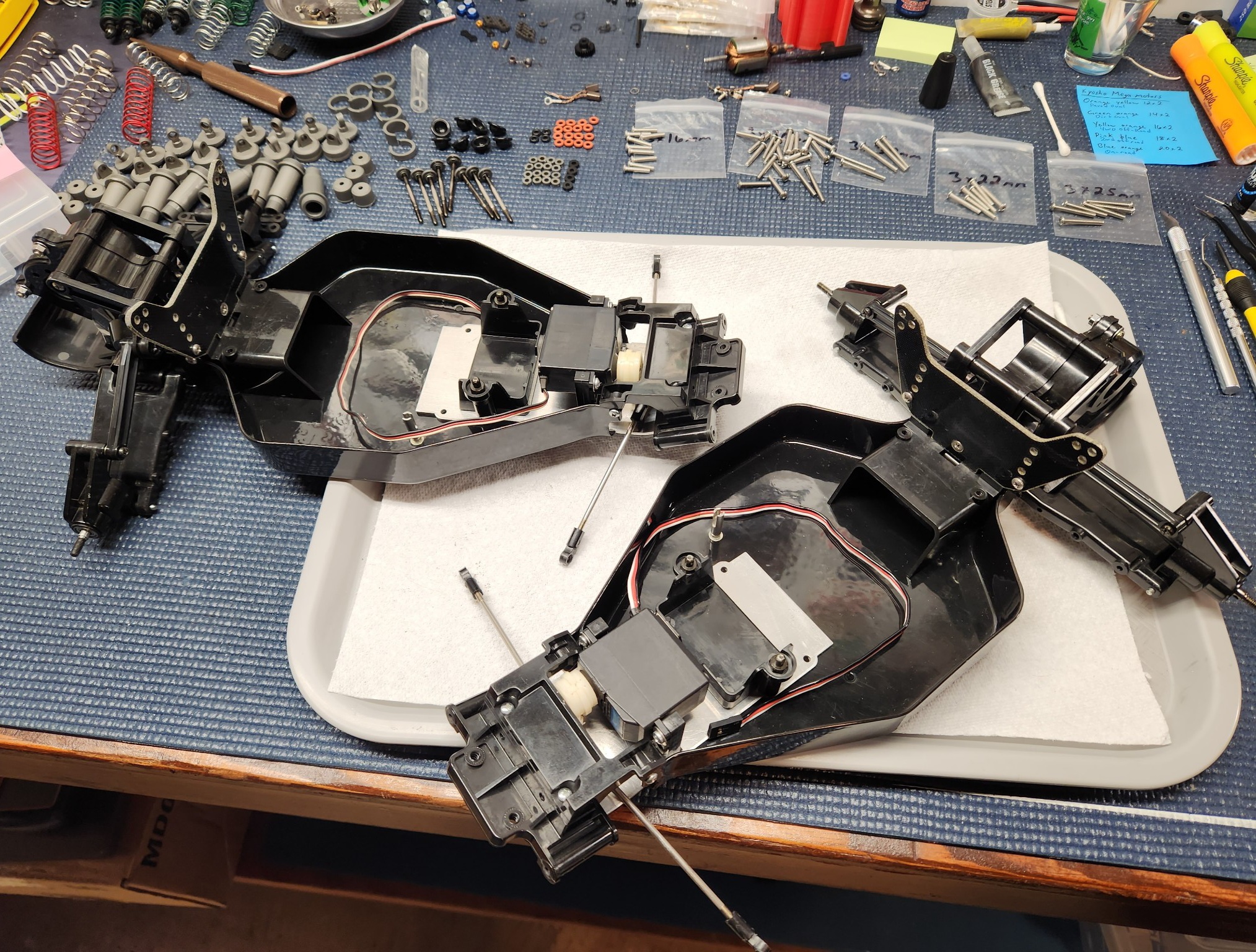

More FXT progress last night. Assembling them to factory spec for now. One will be a runner, and one a shelfer. The runner will get necessary upgrades and be properly molested afterwards.

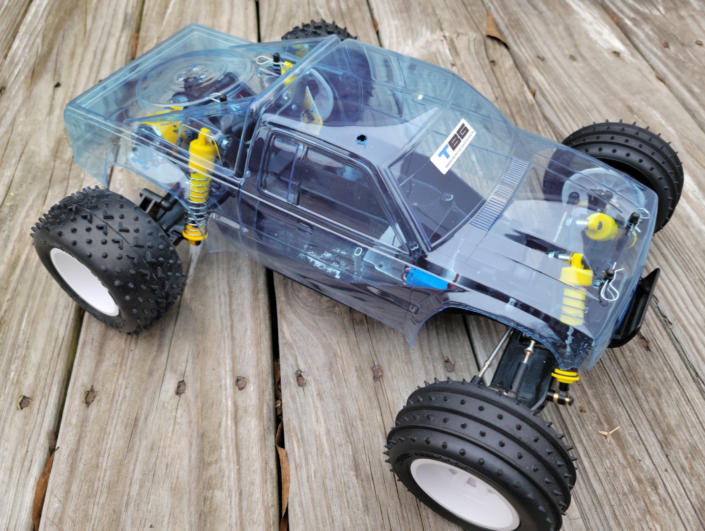

After seeing Jerry building two FXT's at a time, I figured that I should at least rough cut the body on mine.

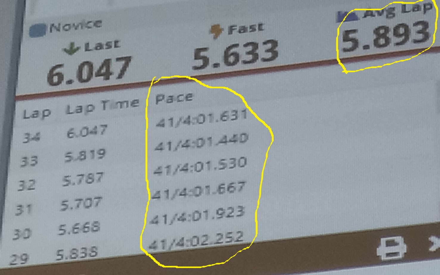

My lower stiffer Cougar was flying last night!
It has a lot more left in it as it was pushing wide on exit, forcing me to modulate the throttle. Even so, I think the car is "done" for now. Time to work on the driver. Well, maybe thicker fluid in the right front shock.
In the previous race, I did 25 laps with a lot of time lost to crashes (traction rolls). My best lap ever in any session was a 6.1. Last night I ran on a 41 lap pace with no crashes for 34 laps and clocked a 5.6.
Granted it was free practice, with no SR10s or Slashes knocking me about, but the improvement was huge. Just being able to concentrate on speed vs not flipping over was worth doing all of the work.
Anyway, I harbor no illusions about ever being good at this. It is just fun running the vintage platform and making it work. The response from the other racers has been really positive. Several folks have mentioned possibly joining me to form a buggy class.
