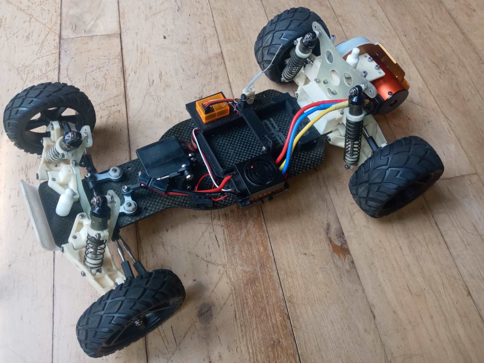

So, I've been making progress getting my Team Edition carbon chassis RC10 back together. I got an 81 tooth spur gear on the way. Can anyone recommend a pinion size for use with a 4-pole 4300 kv motor on 2S? Thanks!

It's going to be temperature and surface dependent. If you are running on a dry flat open parking lot at 50° temp you can go fast. Running on grass at 92°, not as much.
I picked up a pinion set from Robinson racing to figure stuff out for myself.
1055 "SIX PACK" Steel Motor Pinion Gears
1/8" / 48 pitch 15T, 17T, 19T, 21T, 23T, 25T $16.75
Start at a small tooth and go up from there. If at the end of the run the motor or esc is too touch go back down one size.
