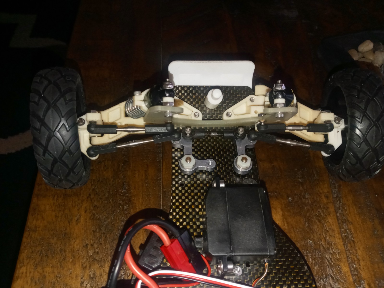

I'm not sure what you all are using for turnbuckles but I was in the market for some for my Team Car rebuild. I'm far too cheap to buy anything titanium, nor am I a good enough driver to make use of any performance gains. I wanted something a tiny bit more flashy than the universal cut-to-length Dubro ones I could find. I ran across these spiffy stainless steel ones marketed for R/C airplanes. I did a little figuring/guessing and bought 2 pairs in the 1 5/16 inch length for front and rear bulkheads and 1 pair of the 1 1/2 inch for the front steering turnbuckles, for use with slightly longer than stock RPM standard length ball cups. They turned out pretty nice IMO.

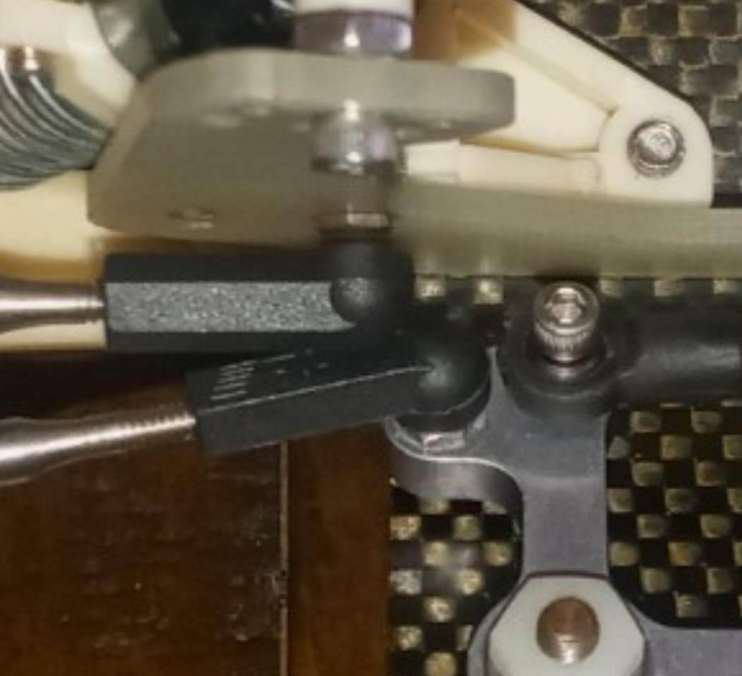

Not to be the bearer of bad news, but I believe that you'll find that you have an interference problem between these ball cups. Move the steering as you compress the suspension.
You have RPM ball cups AND RCPS/Losi bellcranks. Either one is likely to cause problems by themselves, and it's almost guaranteed with both. I personally avoid using either on a buggy front end.
You can try moving the camber links to the outer holes of the shock tower, if you have enough adjustability.
Schumacher makes a low profile ball stud that can be used at the tower to provide a little more clearance.
