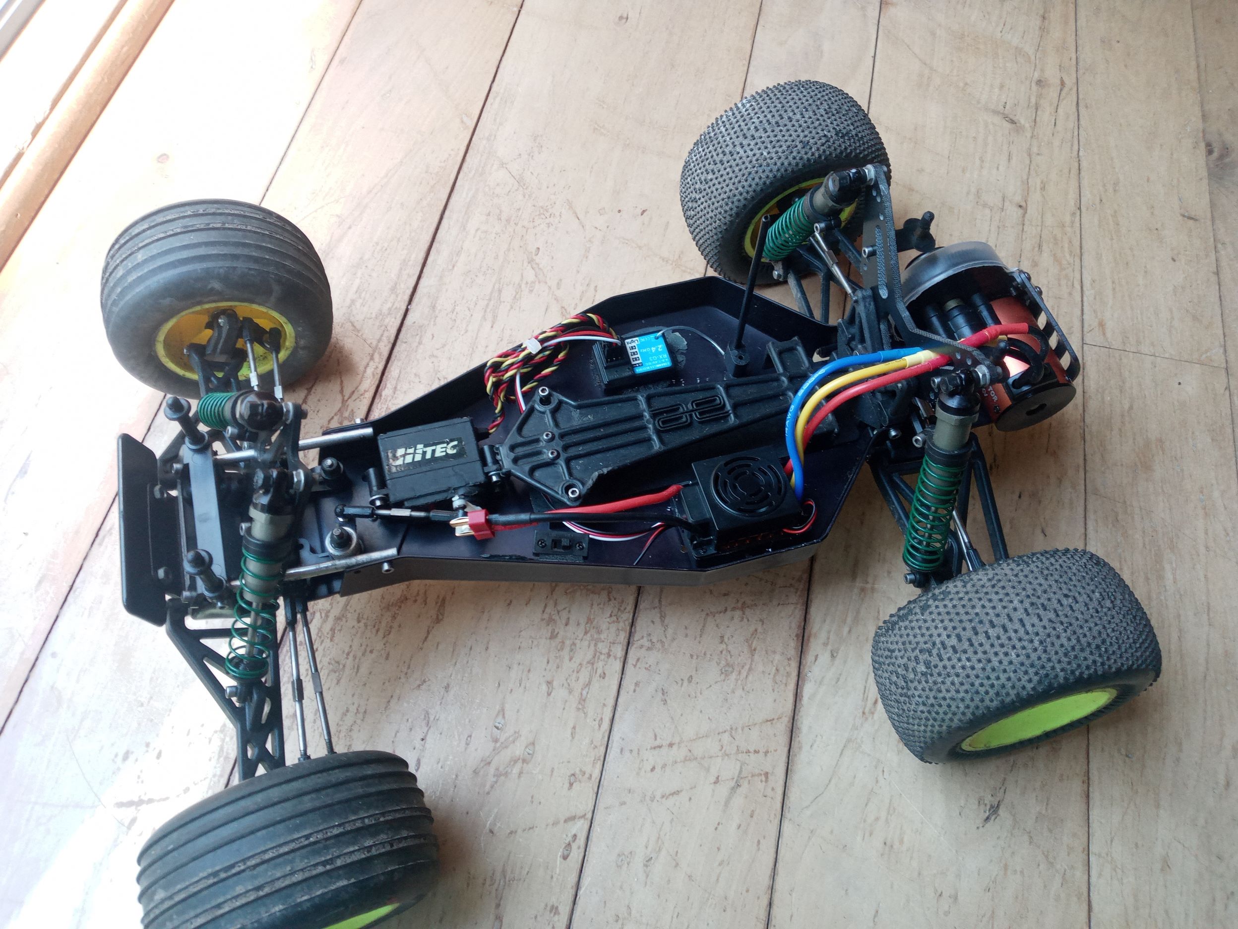

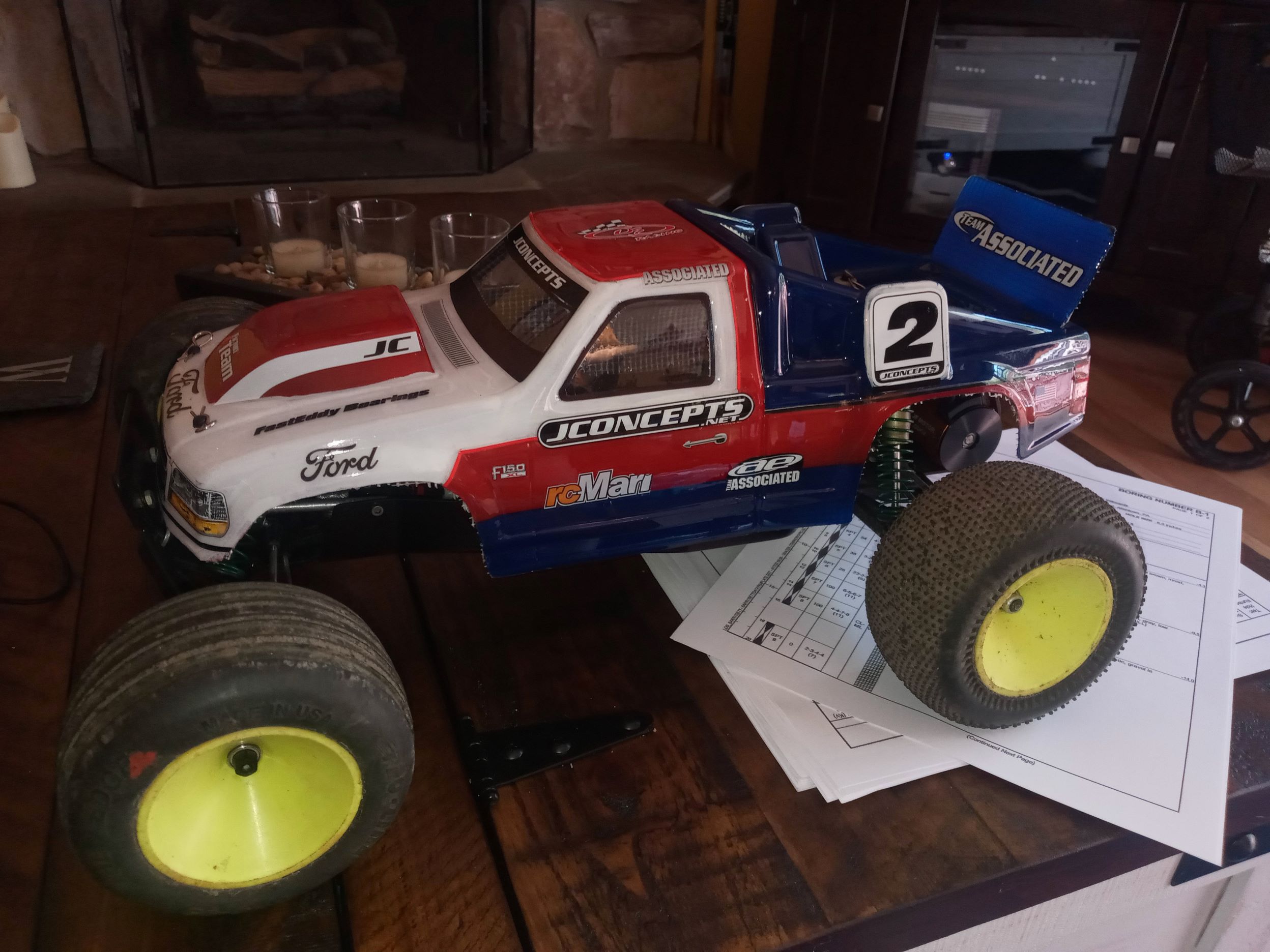

I also posted this in the "What did you get in the post today?" thread but figured I'd throw a couple pics up here also. I love this truck already. Threw a new set of Anderson PowerPole connectors on the ESC to match my batteries (been using them for literally over 25 years) and took it out for some fun in the driveway. Quick and nimble, super fun to drive. I love it.

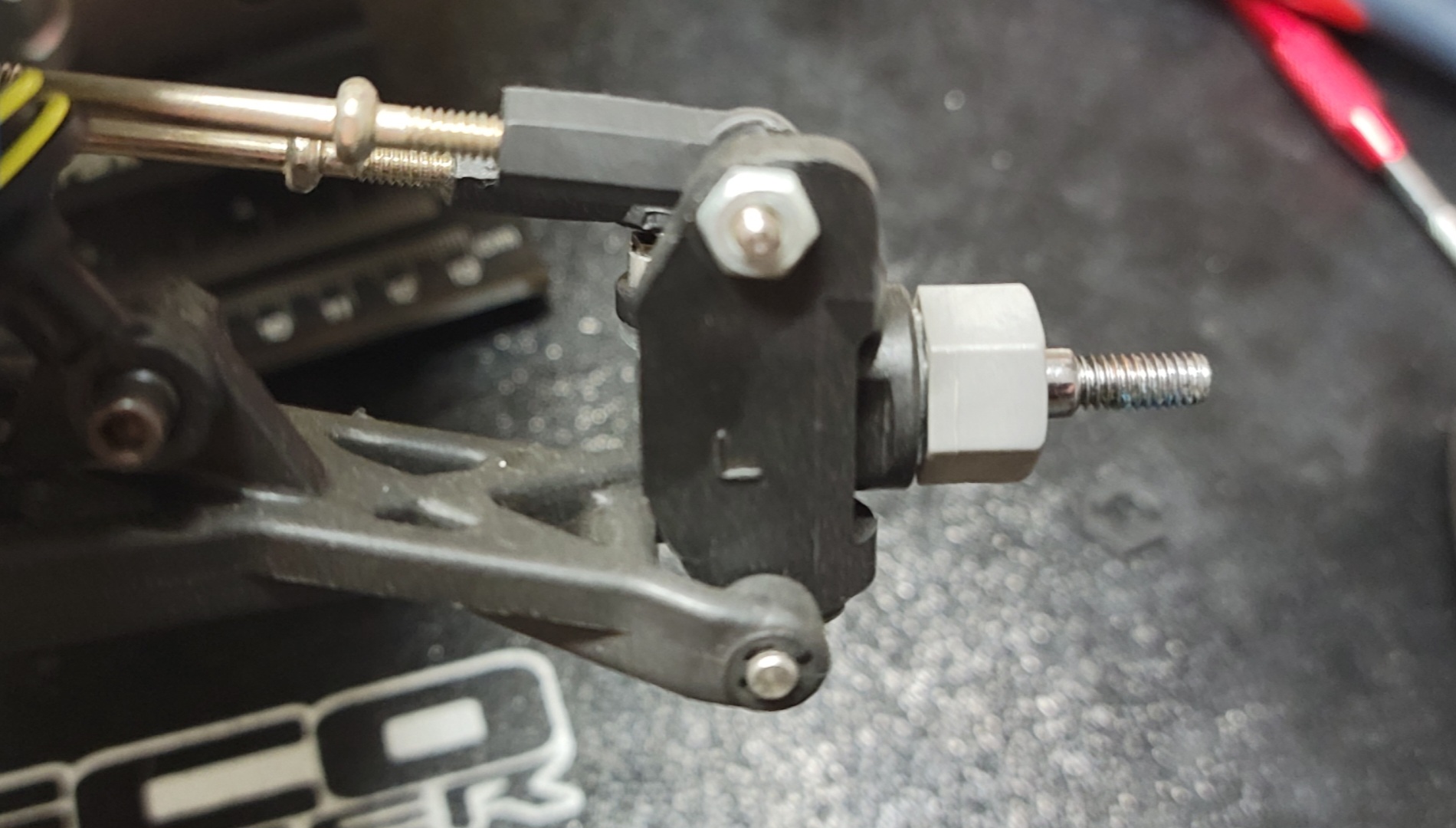

I gots a question for you all. Decided I'm not going to reuse the yellow dish wheels with the new Evader tires cause I don't like 'em. Figured I'd do a 12mm hex conversion and ran across this: https://aircastlesolutions.com/products/12mm-adapter-kit-vintage-rc10-b2-b3-b4-and-vintage-rc10t-t2-t3-t4.
And then I found these nice lookin wheels from Kyosho: https://www.ebay.com/itm/294767074833?hash=item44a17c9e11:g:bIMAAOSwUlJh71A~&amdata=enc%3AAQAIAAAAwDU%2BuexjD0MnbSt8RBTwQFhc96uWIuVABJ2HuKi%2FBioQjpmKZfvVNcjwc4aQmNuUMgbyZBnMXSQ3MzPWVOYKGLUDknn8UJdaRuTi4zElwOnBAIfZTdafxCljhSAG4xsGz6sfIv0xj4NtKAK6CULMAOgJzOyhgODpspp12EhkrZDEVlWqjTaPsaMvt%2FuZoD67s5Wqb35%2BvY%2FkC2m3f91oGf2K4xPtEFWxau6Uvns048FkspMpxrIeADz8UcxVfD%2F3VQ%3D%3D%7Ctkp%3ABk9SR8yrvoD4YQ.
Are there any fitment problems that any of you might know about with these parts?

Those front adapters like that are a poor option.
I chose to use cheap Traxxas parts for a couple of mine. Its a few mm narrower than stock but really isn't noticeable.
If your truck has 3/16 axles, those hexes should work. As should any hex for a 3/16 axle.
If you have 1/4 axles, Factory Works makes an aluminum hex.
If you do have 3/16 axles JConcepts and JC Racing has wheels.
For 1/4 axles, JC Racing has full sets. Factory Works may still have some rears that could be used with JConcepts fronts.

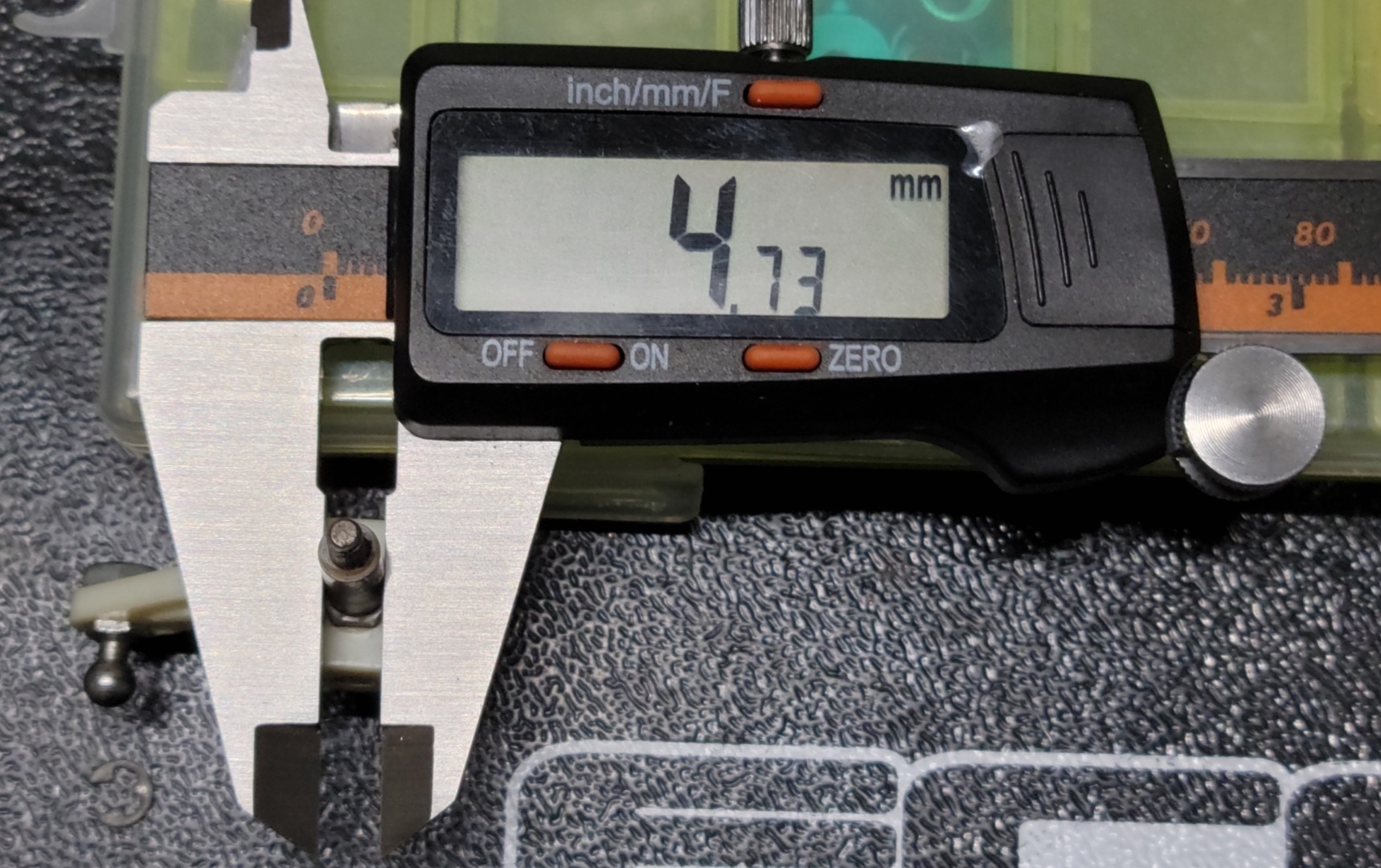

It looks like I have 3/16" axles front and rear. What traxxas parts are you referring to? I think I'd like to try and convert to 12mm hexes honestly.juicedcoupe wrote: ↑Wed Apr 26, 2023 8:27 pm Those front adapters like that are a poor option.

Just one last thing and I'll be settled on way or the other because I've got some 12mm wheels that I'd love to use and also found pin/bearing wheels that I like enough also. The rear conversion is easy, NBD. I also found these for the front which also may simplify things, obviously for 5mm axles but 5mm is so darn close to the 3/16" that I need. https://www.horizonhobby.com/product/12-hex-bearing-conversion-front-adapter/HRATGH10BF08.html. I know they're out of stock currently but I can wait a bit if this is a reasonable option. Thoughts?

In terms of bearing race clearance, 3/16 is a mile away from 5mm. A 5mm bearing is outright sloppy on a 3/16 axle.Mwildmann wrote: ↑Thu Apr 27, 2023 9:52 am
But just like the earlier kit, that type of hex conversion is a poor design. All are poor fitting and sloppy, and they put the load on the wrong spot of the bearings.
It may be alright on a shelf car. But it's likely to break in short order on a offroad truck, and hopefully it doesn't screw up your axle and caster block with it.

Nuff said. Thank you, I was worried about slop and the small difference in 5mm bearing/3/16" axle diameter becomes much more pronounced over the height of the tire. I'm done with trying to convert the front then and likely will leave the rear pin drive also.juicedcoupe wrote: ↑Thu Apr 27, 2023 10:43 am In terms of bearing race clearance, 3/16 is a mile away from 5mm. A 5mm bearing is outright sloppy on a 3/16 axle.
