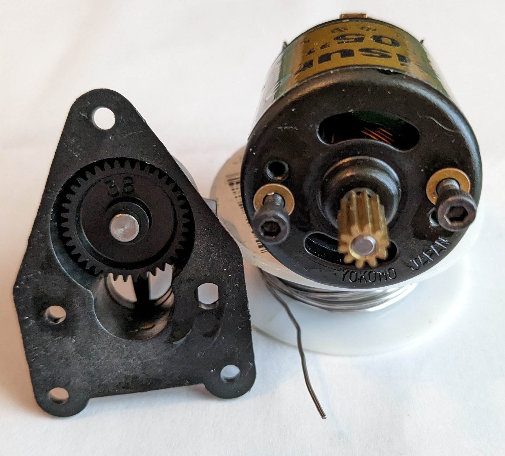

I think the solder tabs definitely need to be used. I think using the endbell screws would just result in a short circuit of the ESC across the sync ring that the screws go into.

Frankentruck wrote: Tue Jun 06, 2023 5:44 pm I think the solder tabs definitely need to be used. I think using the endbell screws would just result in a short circuit of the ESC across the sync ring that the screws go into.
Definitely...but I have no idea why they would have marked it that way, it's not helpful.

I agree, I don't see any value in these markings. They make no sense to me.

It looks like I'll have to find a pinion gear to use a replacement motor. The pinion is pressed on. No set screw or flat spot on the armature.

Frankentruck wrote: Tue Jun 06, 2023 6:21 pm It looks like I'll have to find a pinion gear to use a replacement motor. The pinion is pressed on. No set screw or flat spot on the armature.
Heat it up with a torch and it might expand enough to pull it off. Then overdrill it to slide on a motor shaft (1/8"?) then drill and tap threads for a set screw. That's what I would try, unless those are something common like Mod. 1 pitch or something.

I have a puller that might take it off, but I'm going to think about that for a while.

Idk looks like a really good excuse to buy a mini induction tool to me :lol:

MarkyDents wrote: Tue Jun 06, 2023 8:16 pm Idk looks like a really good excuse to buy a mini induction tool to me :lol:
Can't argue with that!
