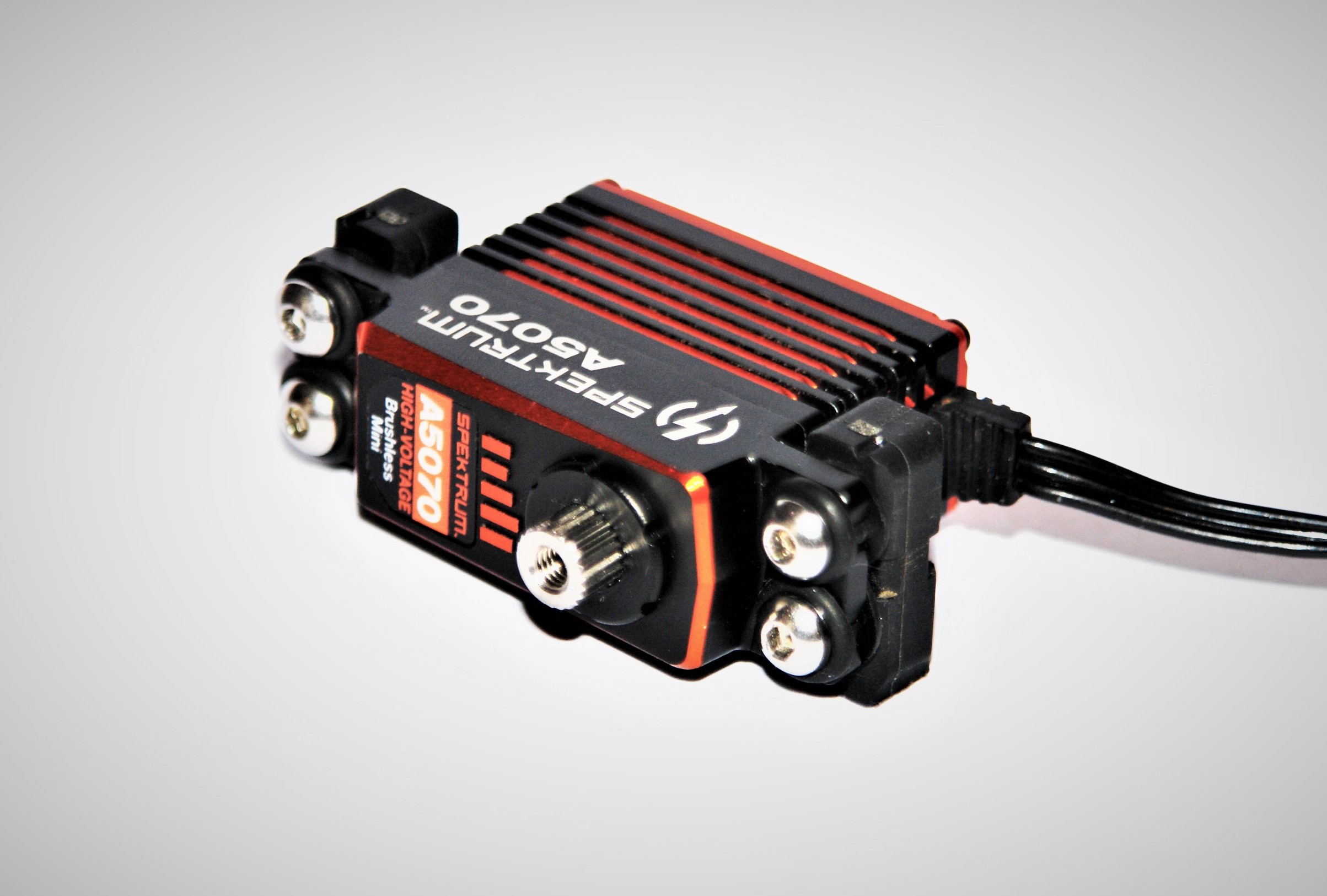

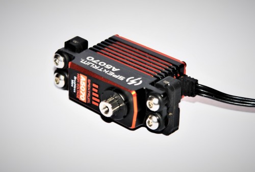

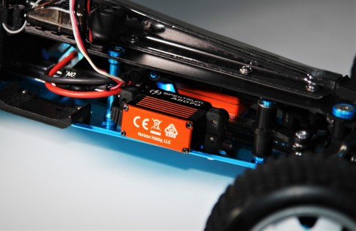

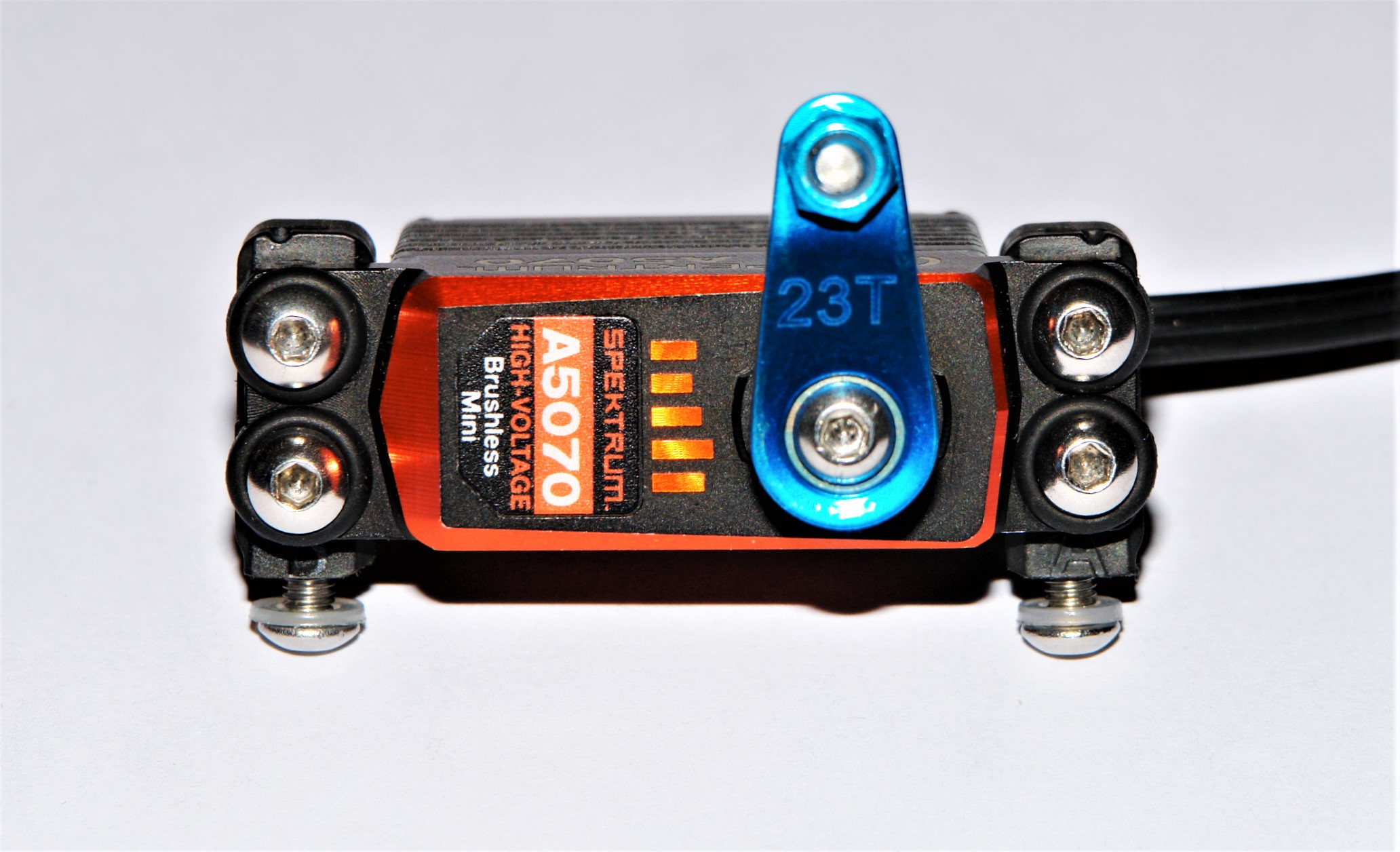

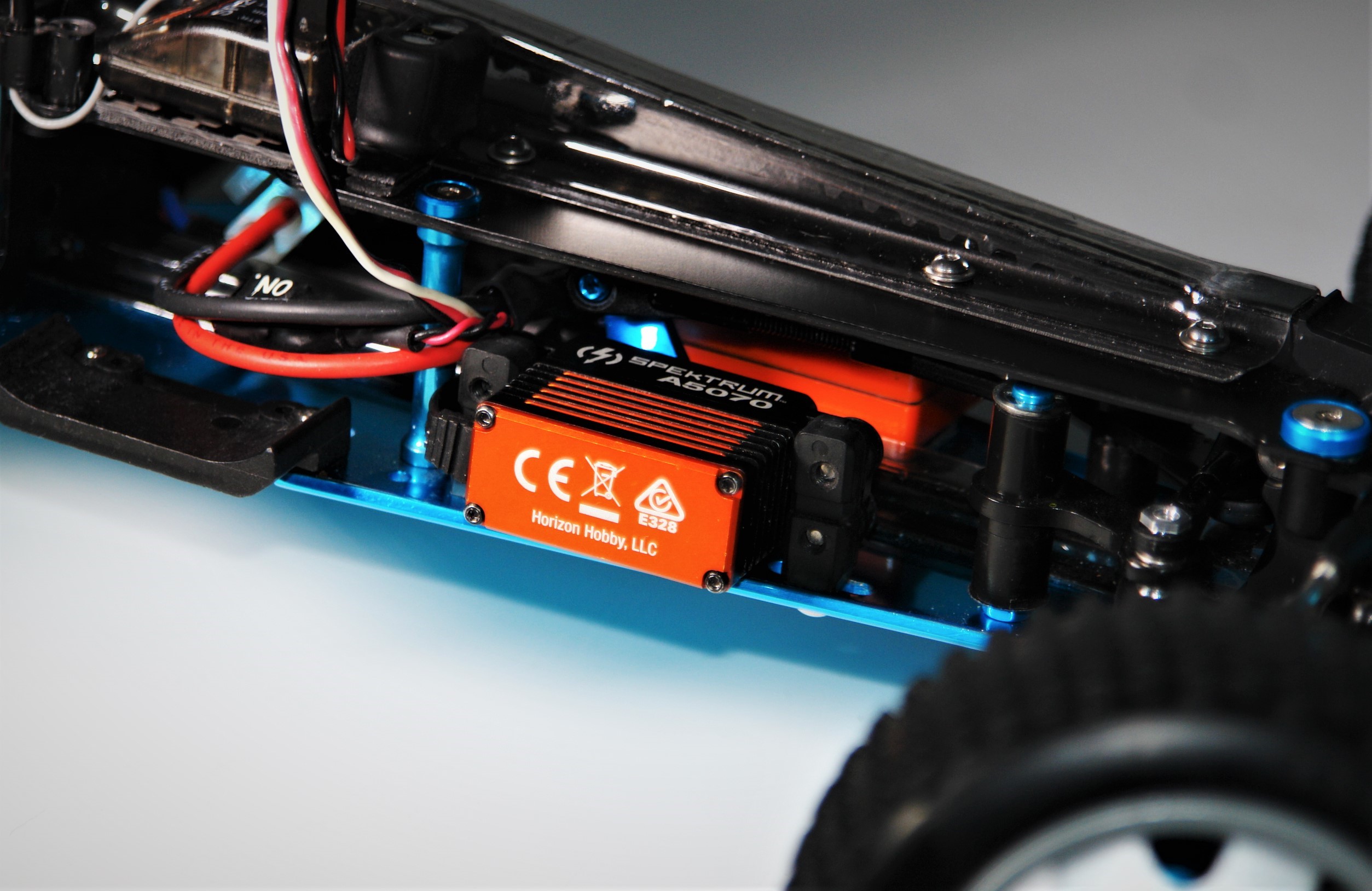

Shocks are back to stock form for now.
I haven't felt the servo was up to the build.
So I ordered a Spektrum, a pretty one.
It"s size should help with alignment to the servo saver.
way more torque and speed than the placeholder Futaba that is in there now.
Anodized a servo horn to match the rest of the car.
I didn't know if the bright orange could go with the blue-teal but somehow it does.
Chuck
Chuck

Re: Turbo Optima mid SE
The fit is really nice. I will shorten the horn to servo saver a bit.
Really good alignment as well.
Chuck
Chuck

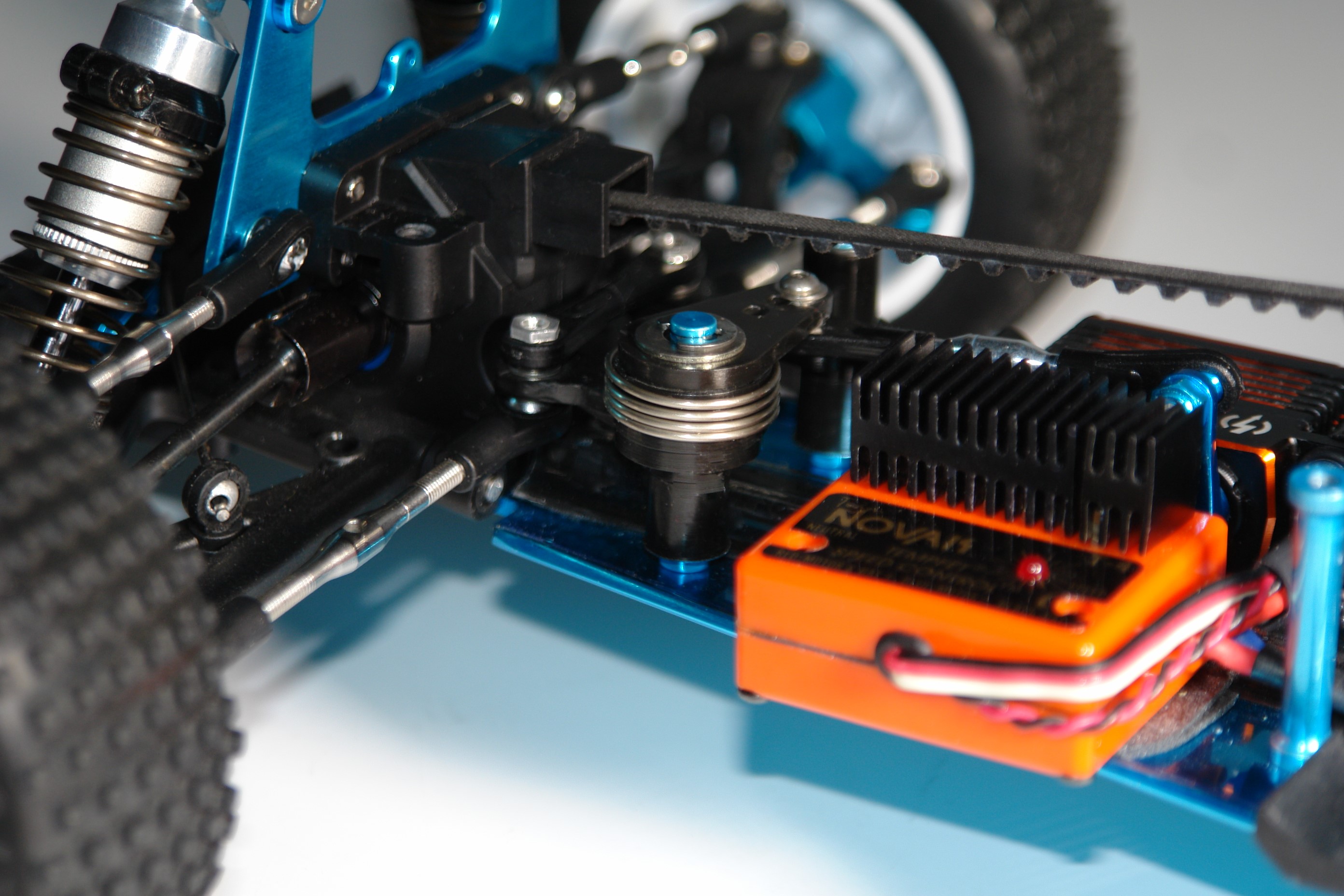

Couples of smalls today
The idler was an attempt to minimize excess play in the rear gearbox.
This idler is slightly larger than the Pargu.
Also switched back to the Kyosho main gear pinion and removed the Thorpe.
The Kyosho was also slightly larger than the Thorpe.
All in all about a 50% reduction in backlash.
The servo saver spring is pretty nice.
I stumbled across these springs looking at other TOMSE parts.
Everyone else probably knows about them but me.
The spring took nearly 90% of the slop out of the steering.
Chuck
Chuck

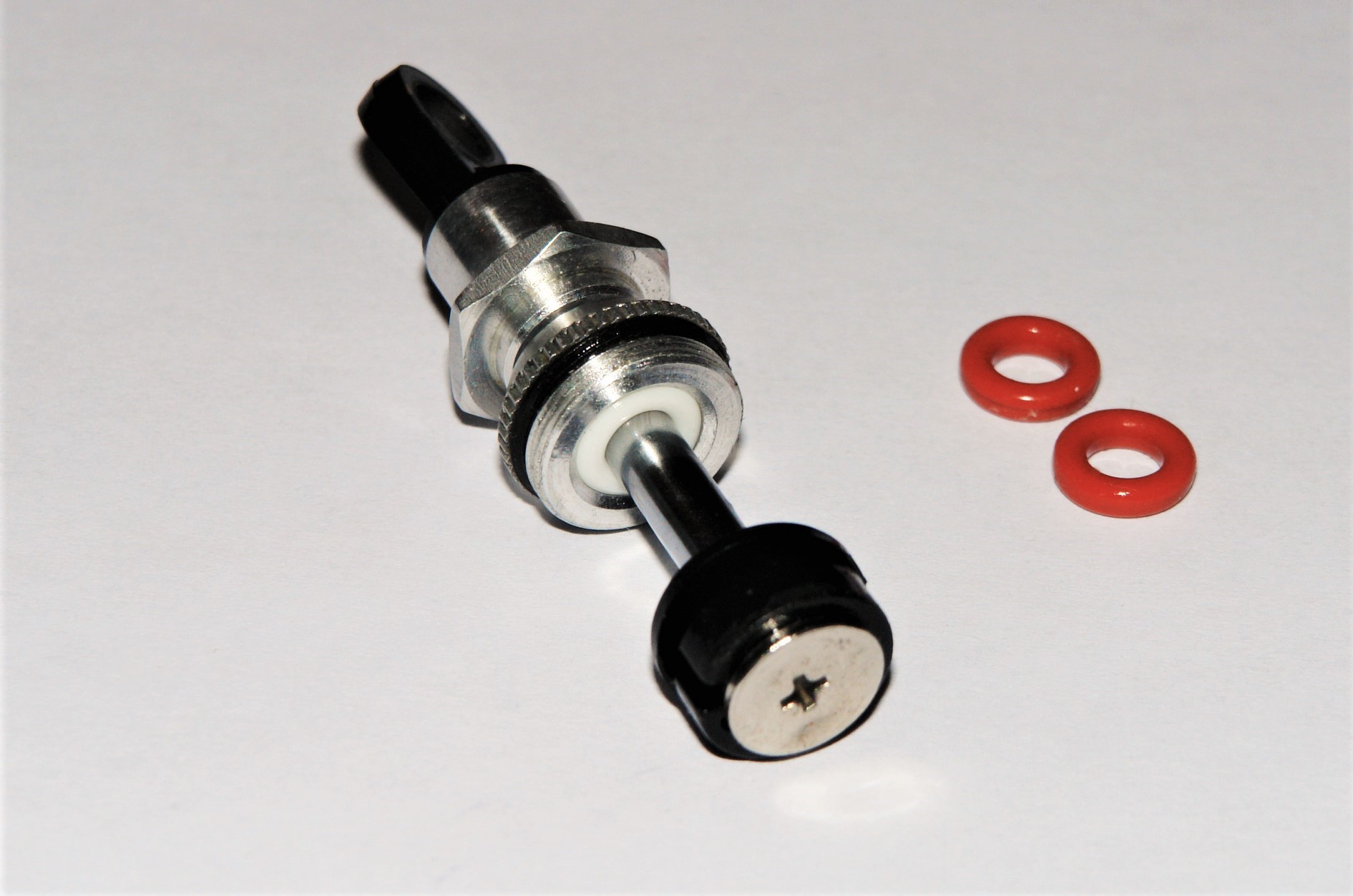

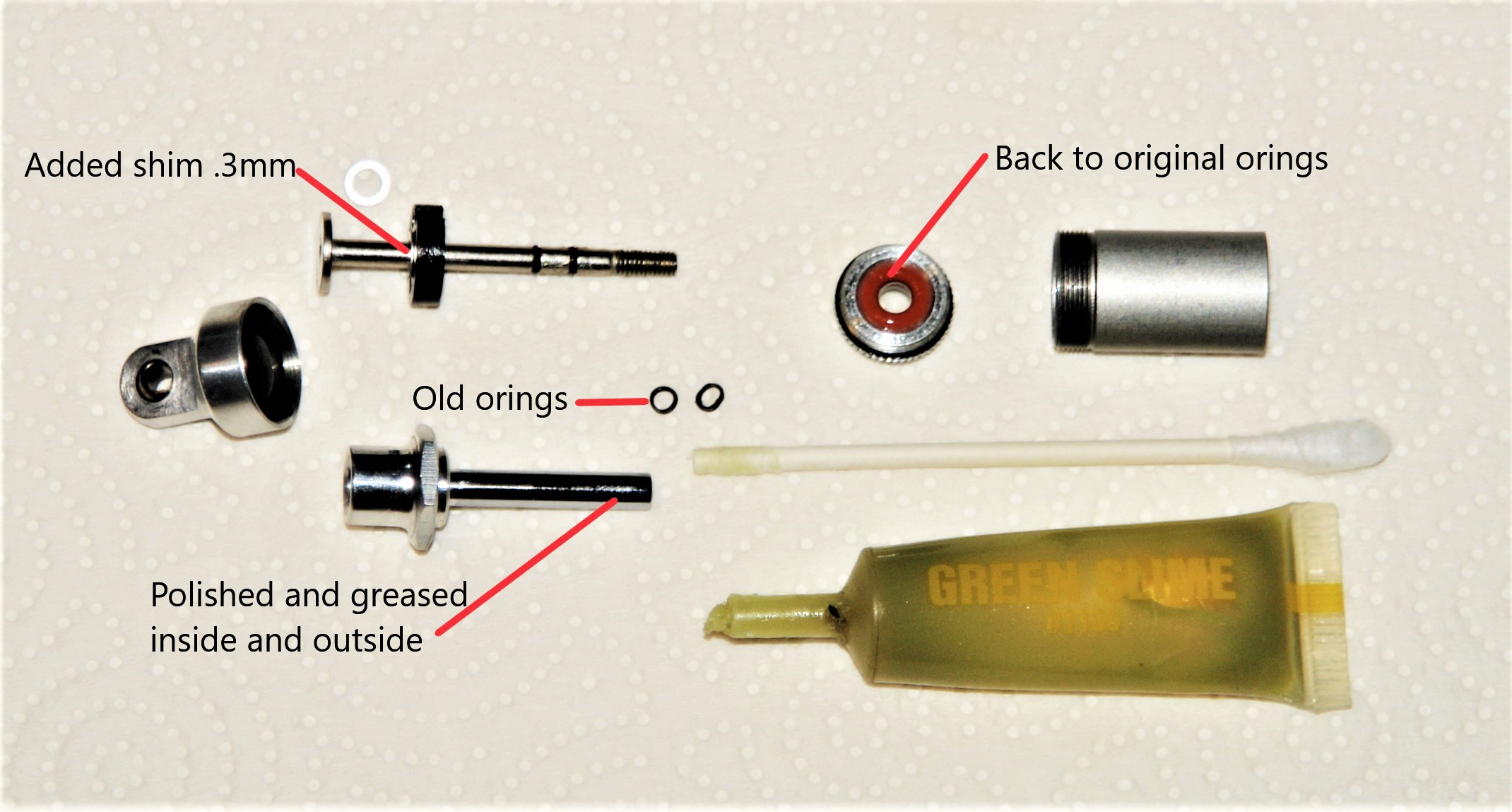

Back into the shocks again.
Got some of the tiny o-rings that seal the inner shaft to the outer tube installed. A couple of the shocks showed signs of a small leak.
Polishing the inside of the larger shock tube is important.
Went back to the original large orange o-rings. The large white o-rings were getting too tight on the shock shaft.
And I added a shim to the inner shock shaft between the floating valve and the top of the inner shock shaft.
The shock " variable damping adjustment" is, in my way of thinking, quite aggressive.
A small turn of the adjuster can make a large damping increase on the rebound.
I can't think of an other shock configuration that restricts the rebound.
Several aftermarket configs alter the compression stroke not the rebound.
Anyways this thin shim, .3mm, still retains some rebound damping but no where near the original.
Overall, in my opinion, a much smoother shock emulating more the feel of a modern shock.
I had tried a .7mm shim and it was way too much.
A very small addition with a large change.
Chuck

Yep, they are really cool shocks but rebound dampening being adjustable really makes no. It should have been the compression instead. Oh well.
- RichieRich
- Posts: 2360
- Location: Los Angeles, CA
- Has thanked: 39 times
- Been thanked: 25 times
@radioactivity If I'm reading your post correctly, a small adjustment, using the shim between the floating piston and the head of the shock shaft, makes the rebound much better?
