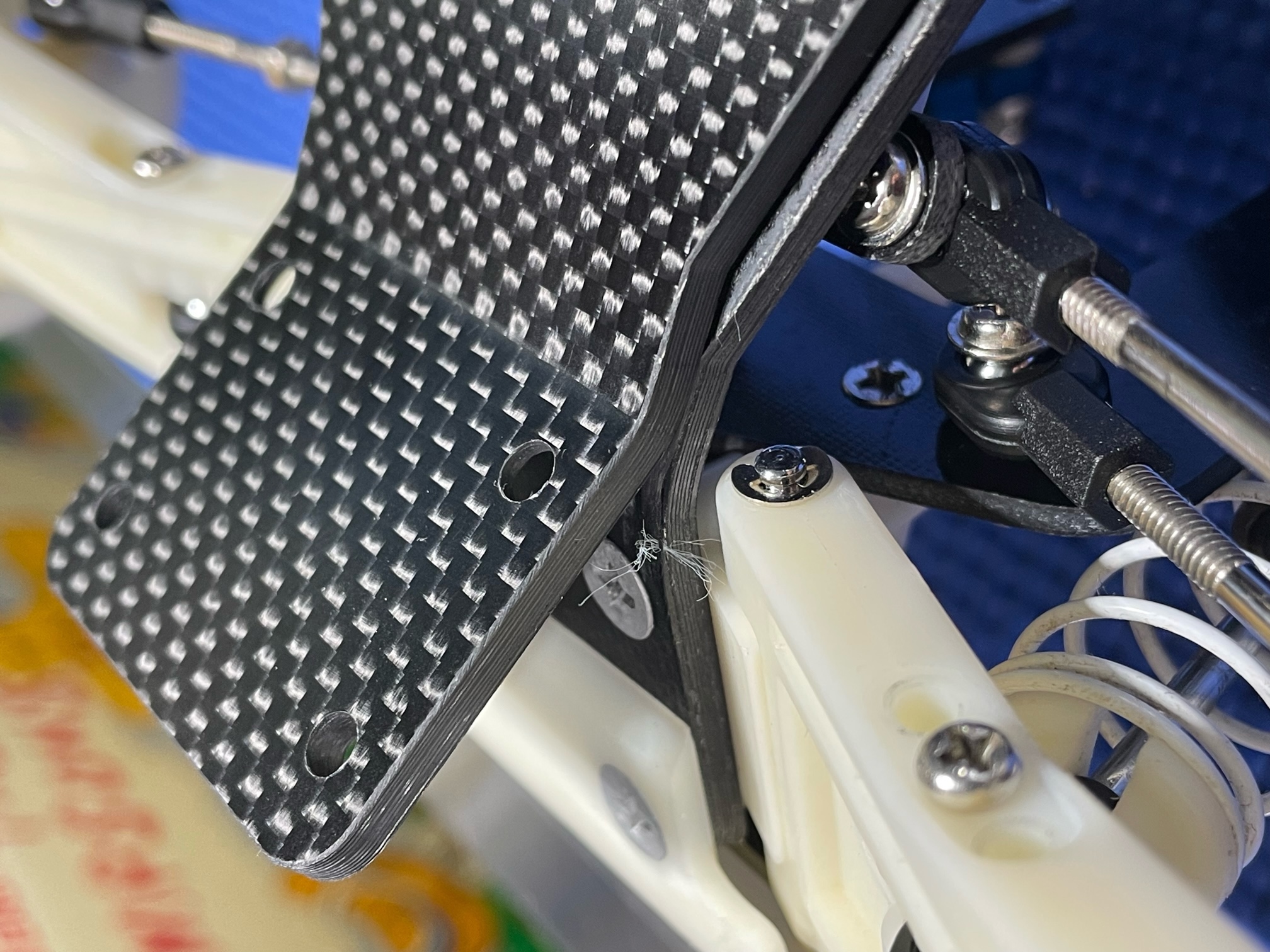

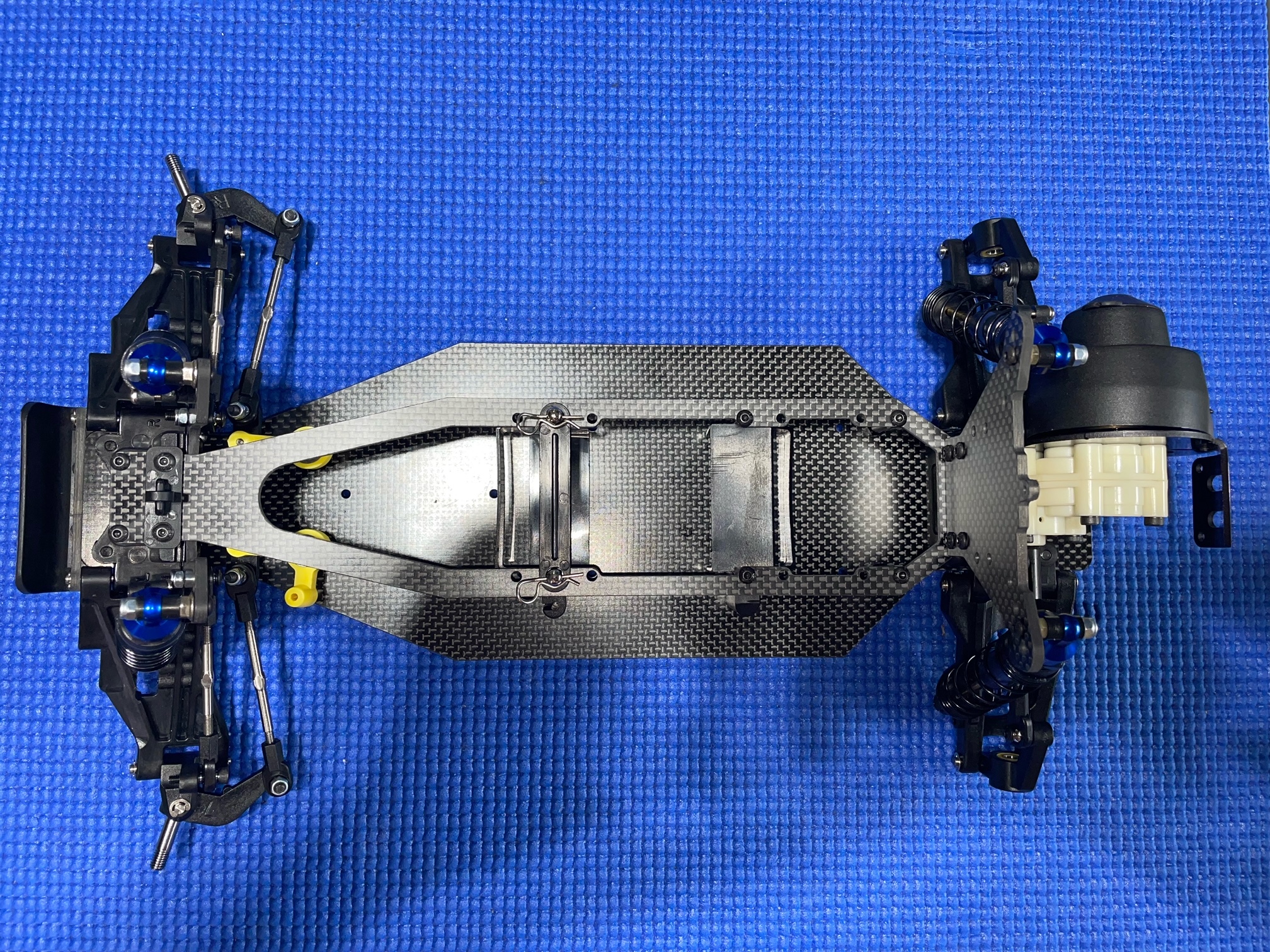

Note that the kick-up is 25deg and not 30deg. I did this because the front mounts are actually 25deg on TRX1 and 30deg on everything else? I measured with a digital level.
You can see the difference between the stock chassis and my chassis. Though the stock chassis was a little long for some reason, it did not fit the Composite Craft top deck.

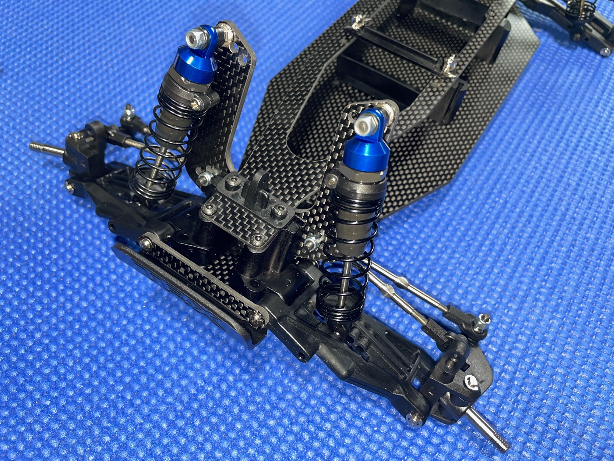

I put this together last night to make sure everything fit good.

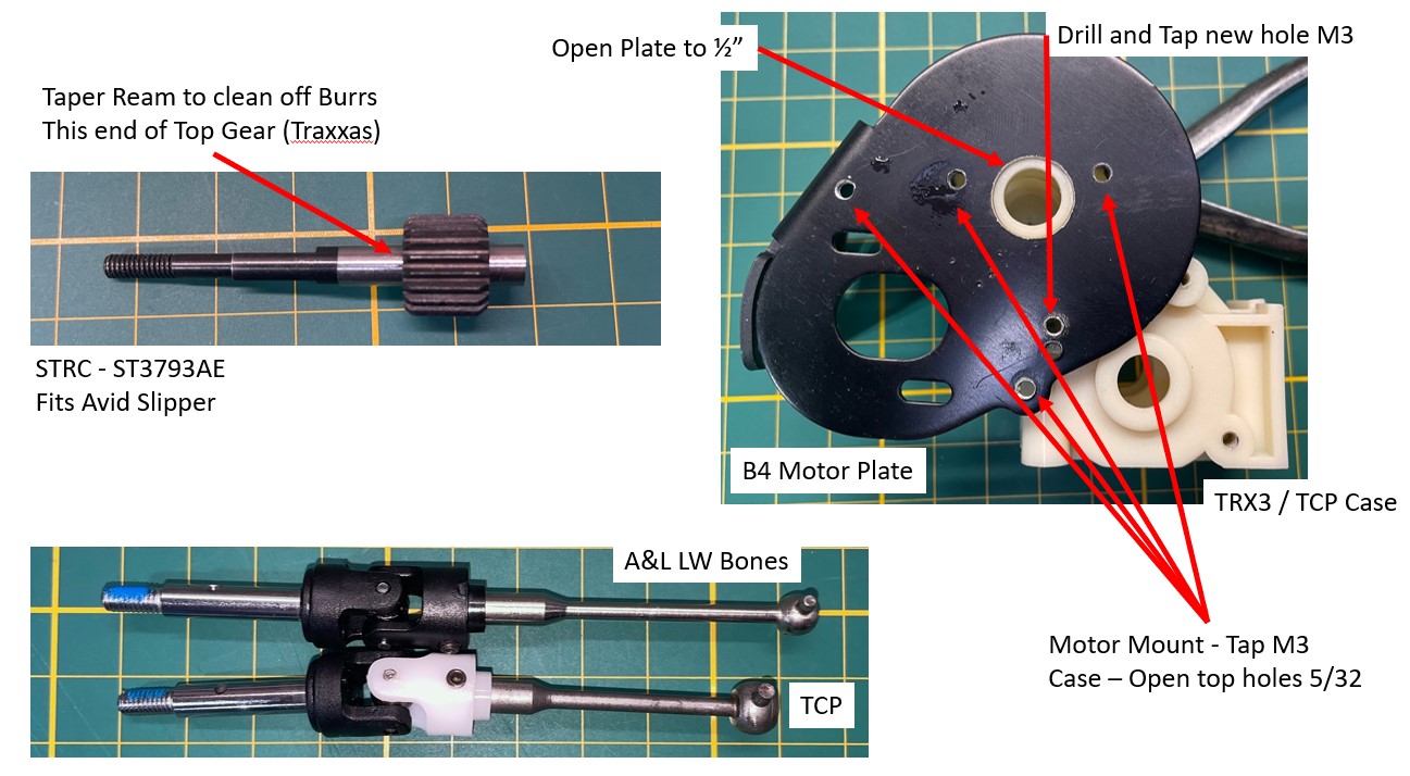

I need to machine down the A&L dog bones unless anyone knows some that fit.
Included is a picture of the mods I did to use the B4 motor plate.
Few things to do. I used TCP front steering blocks so I need new turnbuckles (I used Schumacher). Trim RPM Cover to clear screw. Figure out dog bones.

I know that A&L dogbones for the TRX-1 are longer for a Lethal Weapon application. You might have those or some truck dogbones. Because standard A&L bones for the TRX-1 stock trans. are a direct fit.
