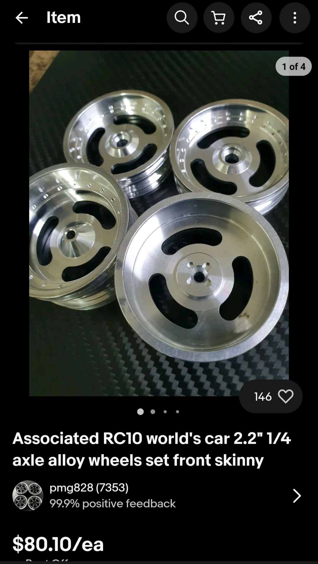

Welcome. If you're looking for aluminum wheels and still have the 1/4" tapered rear axles, these wheels on eBay from Korea are pretty nice.

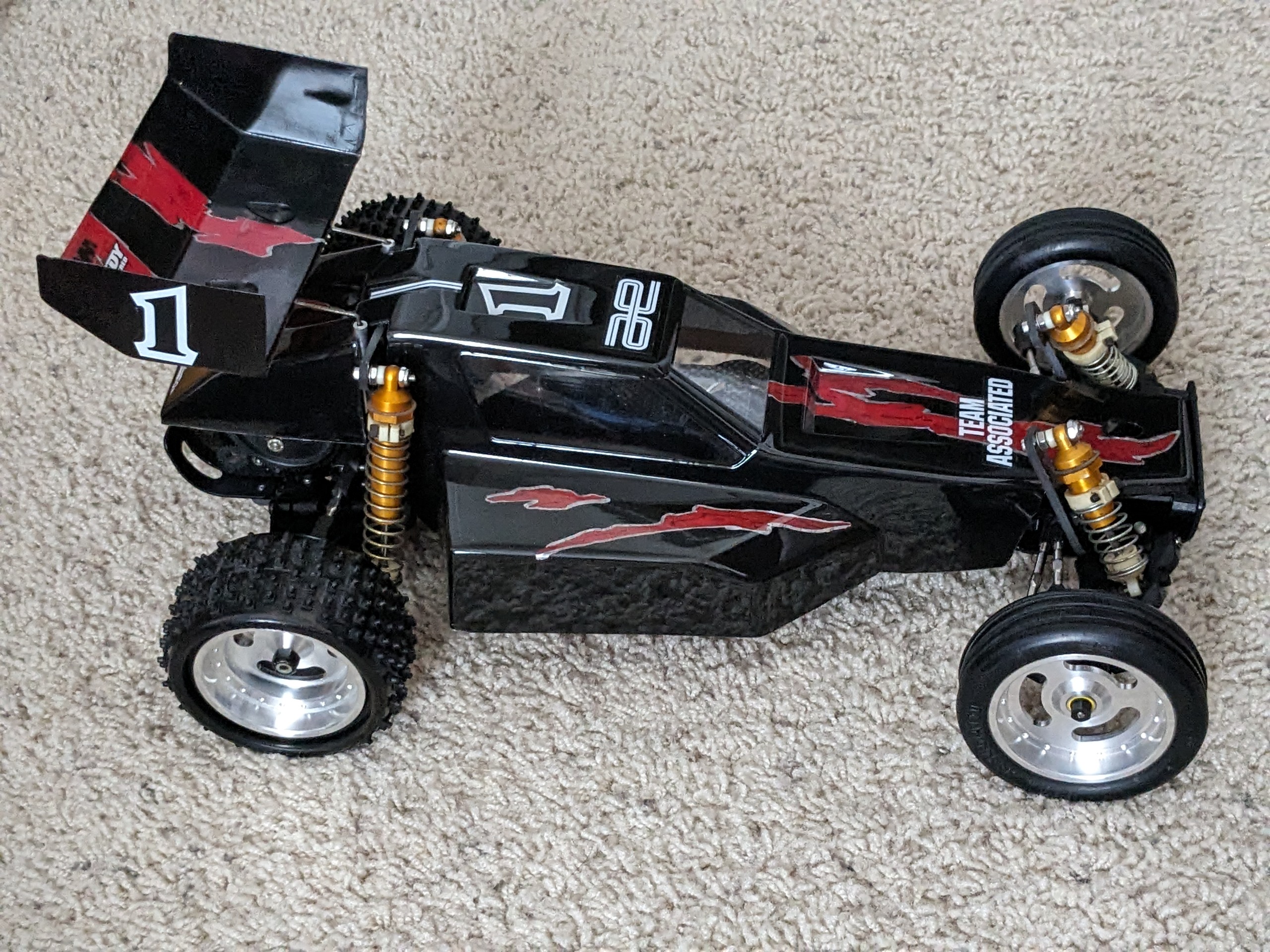

I have them on this buggy.
They could work with Schumacher street tires like I have on my RC10B4 here.

Thanks for the link and the Schumacher name for tires.Frankentruck wrote: ↑Tue Sep 19, 2023 3:40 pm Welcome. If you're looking for aluminum wheels and still have the 1/4" tapered rear axles, these wheels on eBay from Korea are pretty nice.
https://www.rc10talk.com/viewtopic.php?p=554615&hilit=schumacher#p554615
Those look good on your buggy too
