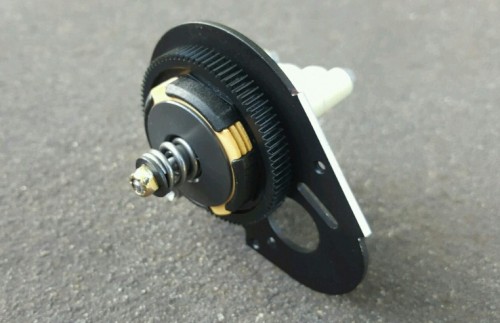

Jimbo302
Posts: 355
Joined: Sun May 15, 2016 6:05 pm
Location: Micronesia
Has thanked: 14 times
Been thanked: 5 times
Re: Upgrading top shaft of stealth
Post by Jimbo302 »
Mine? It's a B3, it's factory black.

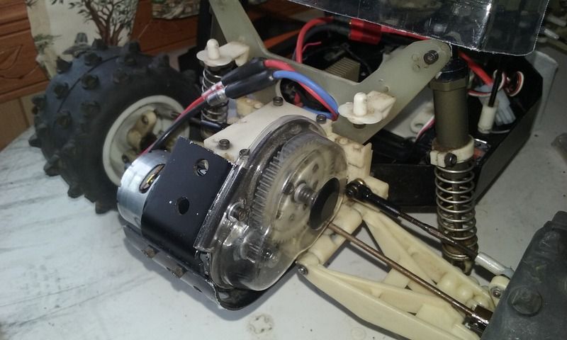

clm
Posts: 942
Location: Oregon Coast
Has thanked: 100 times
Been thanked: 205 times
Post by clm »
I may be nostalgic... But I really liked the original stealth slipper, two bolts and the spur gear was off without changing the slipper adjustment lol

Jimbo302
Posts: 355
Post by Jimbo302 »
This awesomeness?
clm
Posts: 942
Post by clm »
Yup that would be the two screw one.
