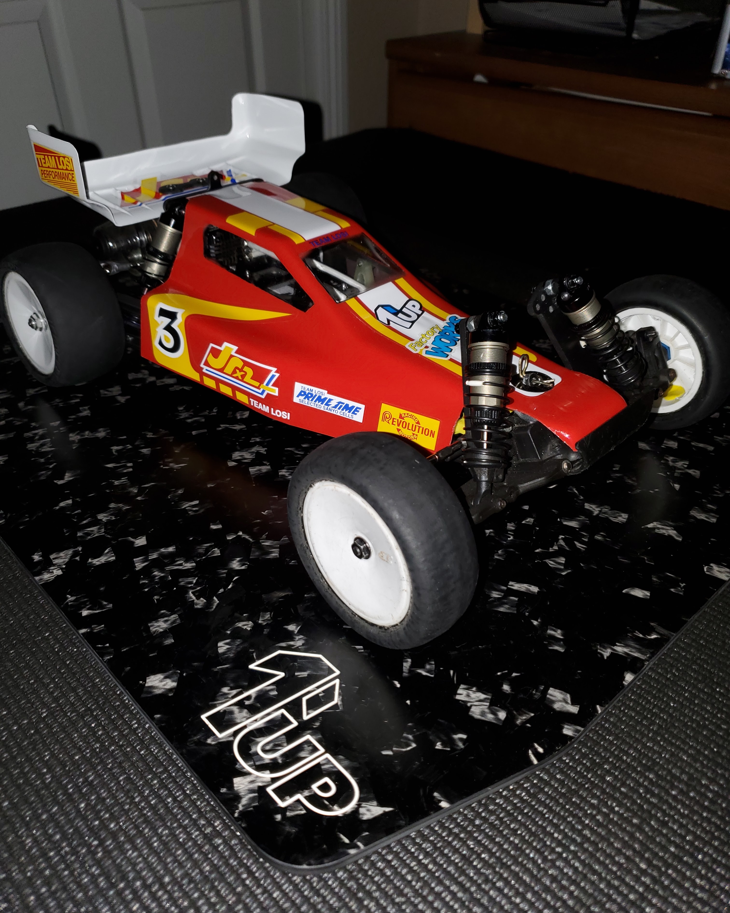

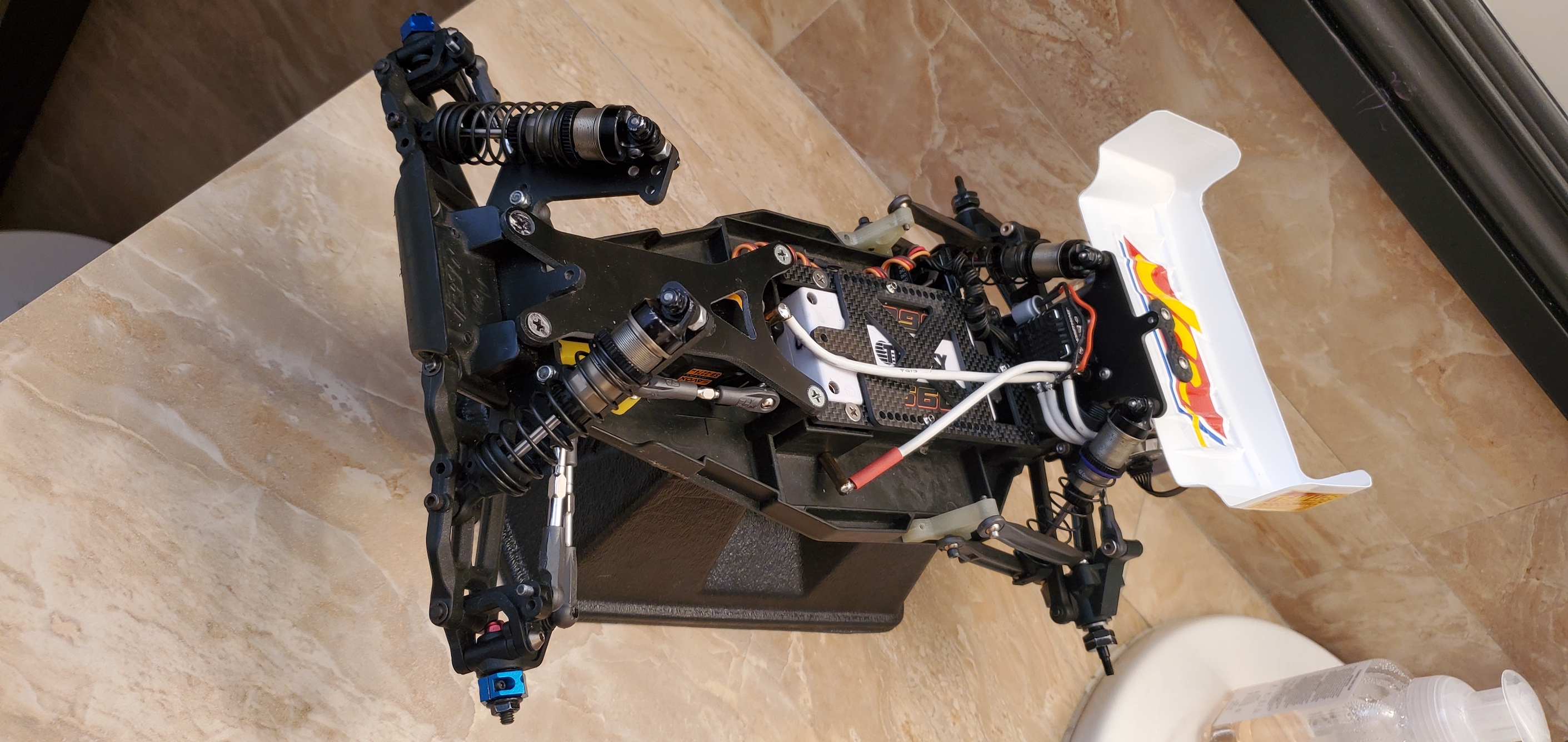

Okay, now I’m done, so I figured I’d go down my 5-link runner build, here goes:
Junior 2 chassis
XX-T retrofit trans w/22 5.0 slipper
MIP XX CVDs w/XXX Gen 2 axles
Vintage RC lipo holder (modified)
Robinson side bulkheads
Factory Works chassis brace, steering and rear shock tower
Jammin’ Pro SE front shock tower
RPM front arms and lower rear links
Schumacher LD2 front hubs, steering blocks and axles (to run modern AE offset wheels)
TLR 22 5.0 big bore shocks, servo mount and wing mount (modified)
Schumacher and TLR turnbuckles and rod ends/ball cups
TBG Junior 2 body (which I butchered) w/MCI Racing decals
Savox servo, HobbyWing XR10 Stock Spec ESC and 1UP/Motiv/Team Glitch MC4 17.5

Oh that was you on FB! Great build. I didnt ask before but how's the geometry on the ld2 knuckles compared to stock?

RogueIV wrote: Fri Oct 13, 2023 5:38 pm Oh that was you on FB! Great build. I didnt ask before but how's the geometry on the ld2 knuckles compared to stock?
I had to play with raising and lowering the bellcranks to get the right turnbuckle angles so bumpsteer was reduced. Also, the Jammin' front shock tower has taller holes for the camber link ball studs which works great with the Schumacher hubs as their camber link location is higher than the stock JRX2 hub. With the stock JRX2/Pro-SE tower the car would have a lot of camber gain and bump steer to try and get rid of. I'm sure it's doable either way, will just take some trial and error.

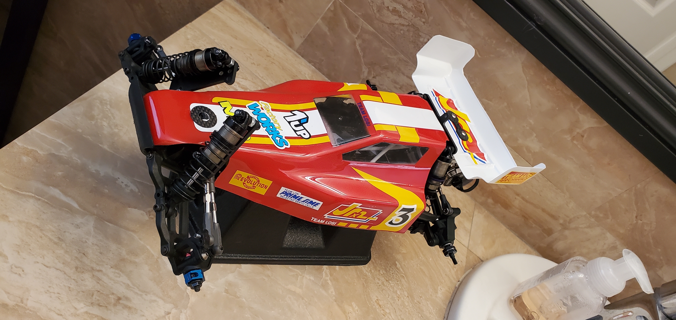

One more pic before the BK race next weekend:
