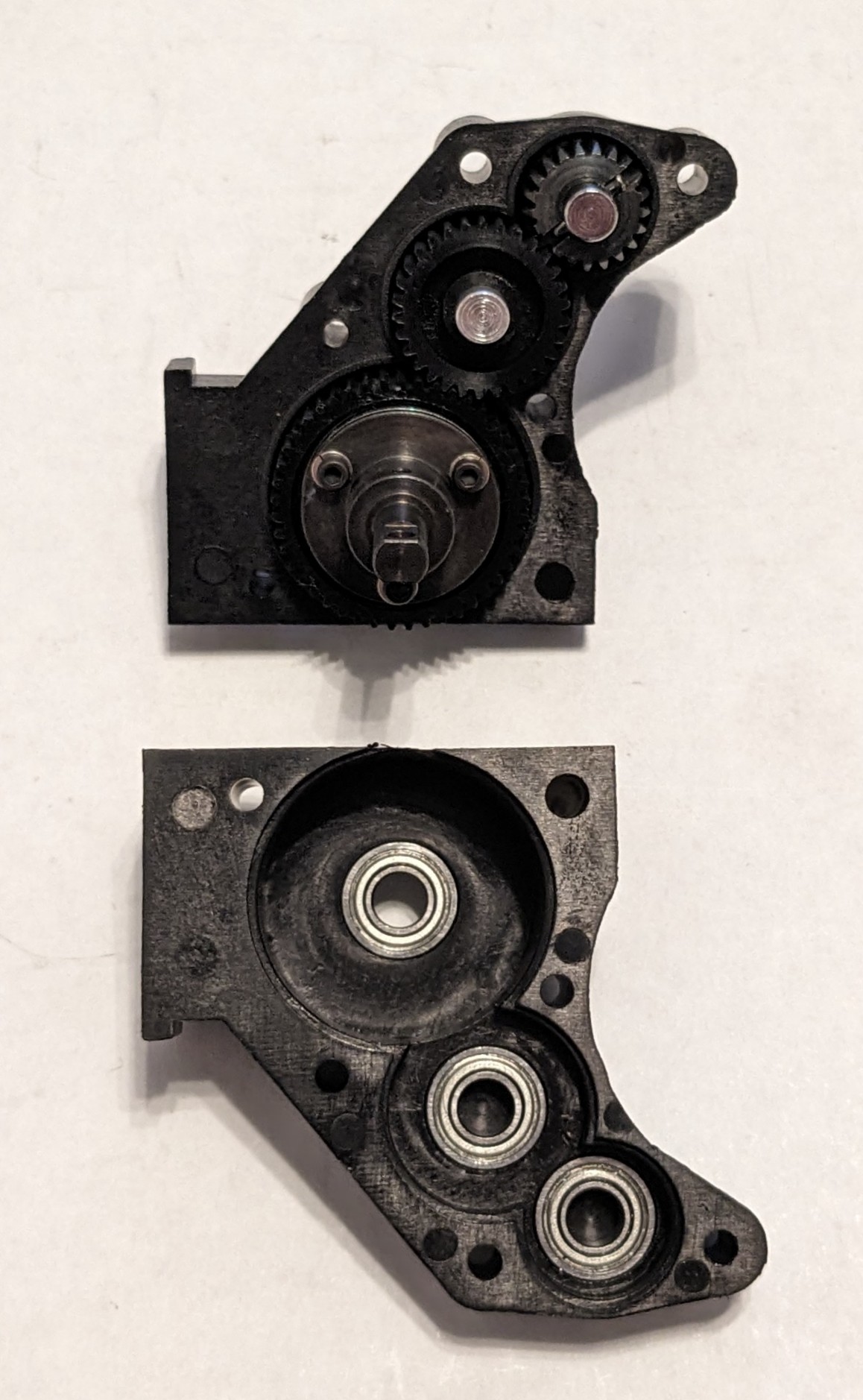

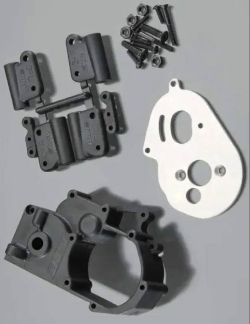

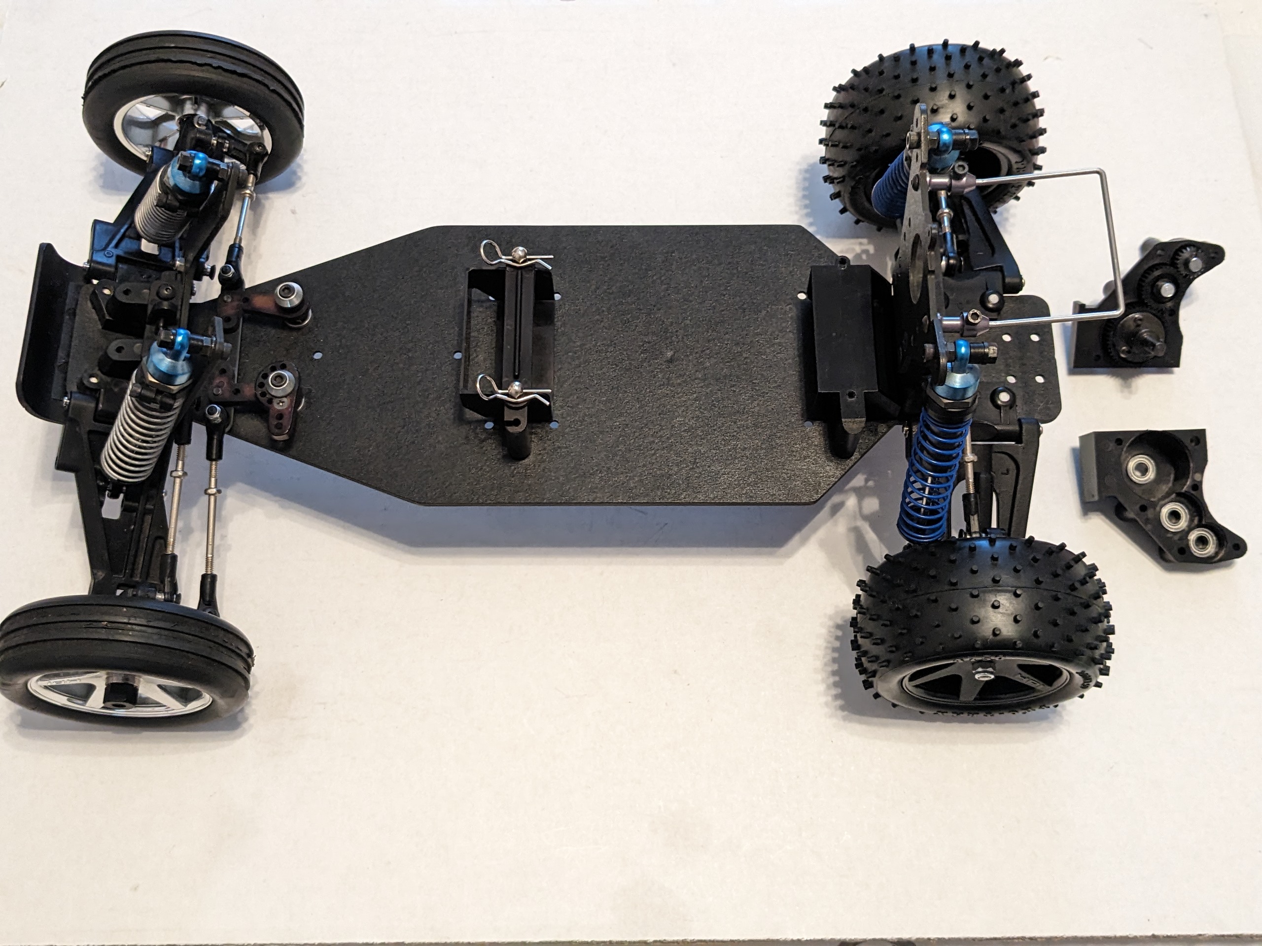

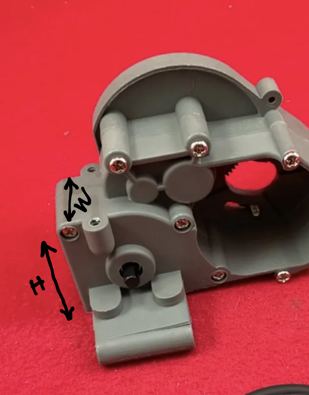

I think I'm going to have a lot of trouble finding a complete TRX-1 gearbox for my buggy. While searching, it looked to me like I might be able to make a Bandit gearbox work. I actually thinking of a modified RPM Bandit gearbox so I would get an aluminum motor plate. But I need some measurements. Does anyone have one of these gearboxes sitting around and could take precision height and width measurements for the front of it?

You could get TRX-3 trans case, a pro ball diff kit, top shaft/top gear, idler, and slipper components. But then you would need to source a motor plate or modify one.

The eBay prices on the individual gearbox parts seem pretty high. But even the path I'm looking at could get close to $100 for all new parts. Maybe I should just put a Stealth gearbox there and be done with it.

Taken with digital vernier calipers...Frankentruck wrote: ↑Mon Oct 30, 2023 3:28 pm ...Does anyone have one of these gearboxes sitting around and could take precision height and width measurements for the front of it?
Height is 37mm/1.45in
width... depends on where you measure as the case is tapered.... 23.9mm/.94in at the bottom 23.4mm/.92in at the top

The width is great but unfortunately the height is about 0.5" too tall. Bummer. Thanks for the measurements.

Bummer indeed. Very welcome though. Would cutting down the nose of the gearbox be an option?Frankentruck wrote: ↑Tue Oct 31, 2023 8:00 am The width is great but unfortunately the height is about 0.5" too tall. Bummer. Thanks for the measurements.

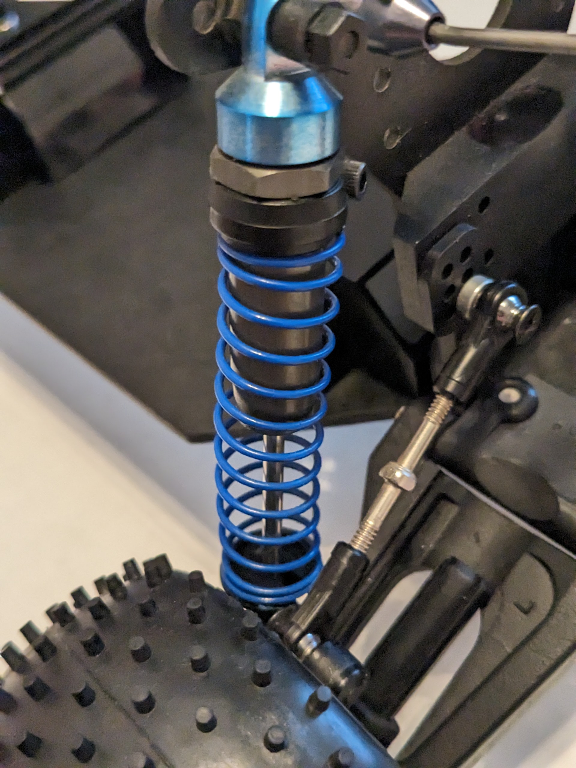

The 2520 pro diff seems to be just what was needed, although it's a little sloppy from side to side. In metric-ness, it's about 0.81mm total looseness. I might add a little shim to each put shaft.

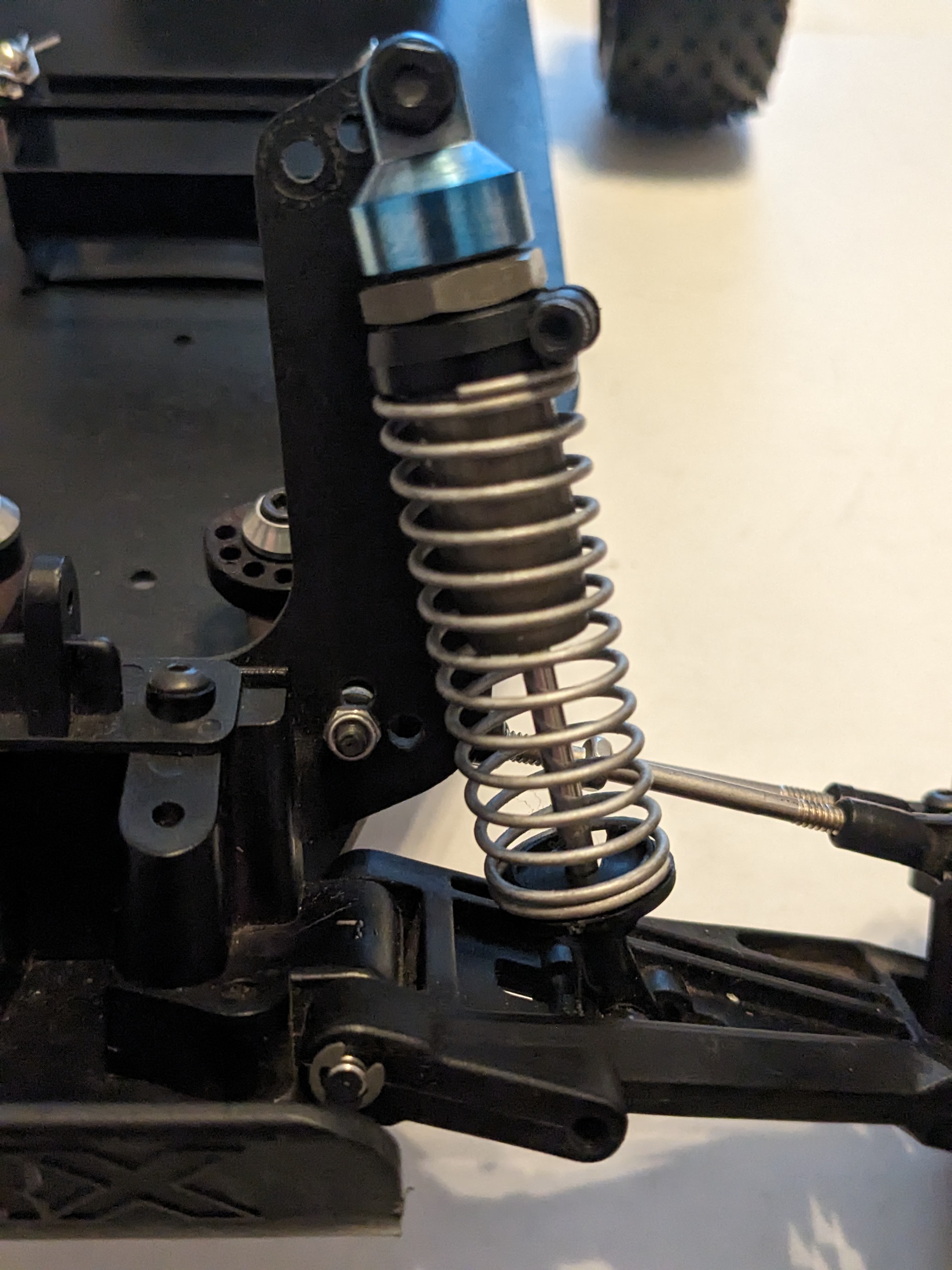

Looking closer at my rolling chassis, the shocks look a lot like RC10 team car shocks with different tops. Hmmmm....

Re: TRX-1 hodgepodge - Bandit, Rustler, Slash gearbox parts?
+1 with the shocks. If you want "official" shims/"washers", TRA 1985.

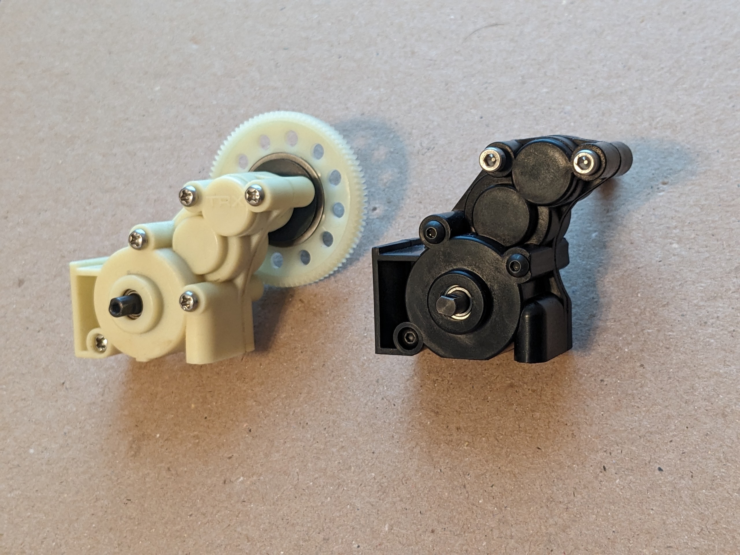

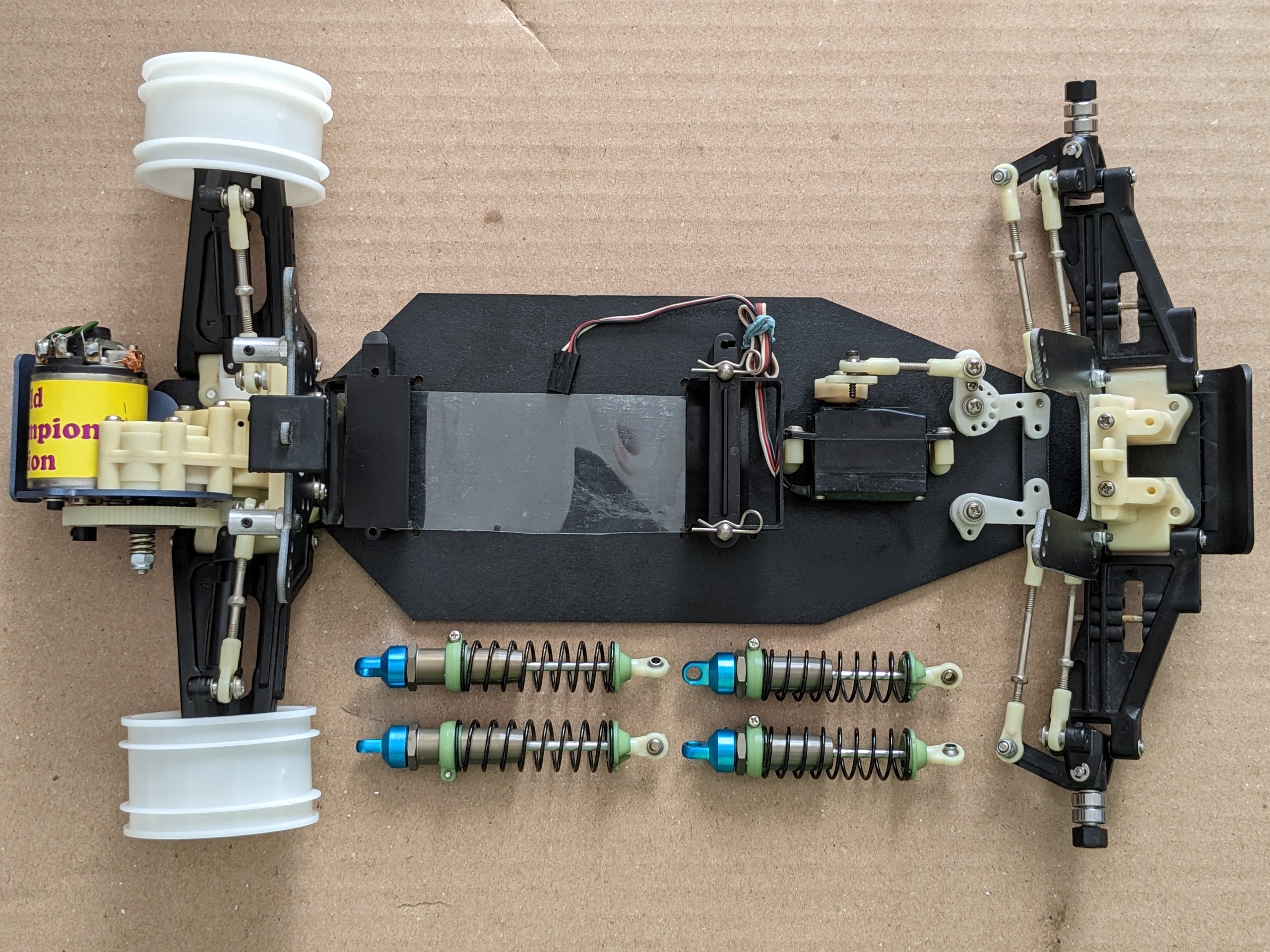

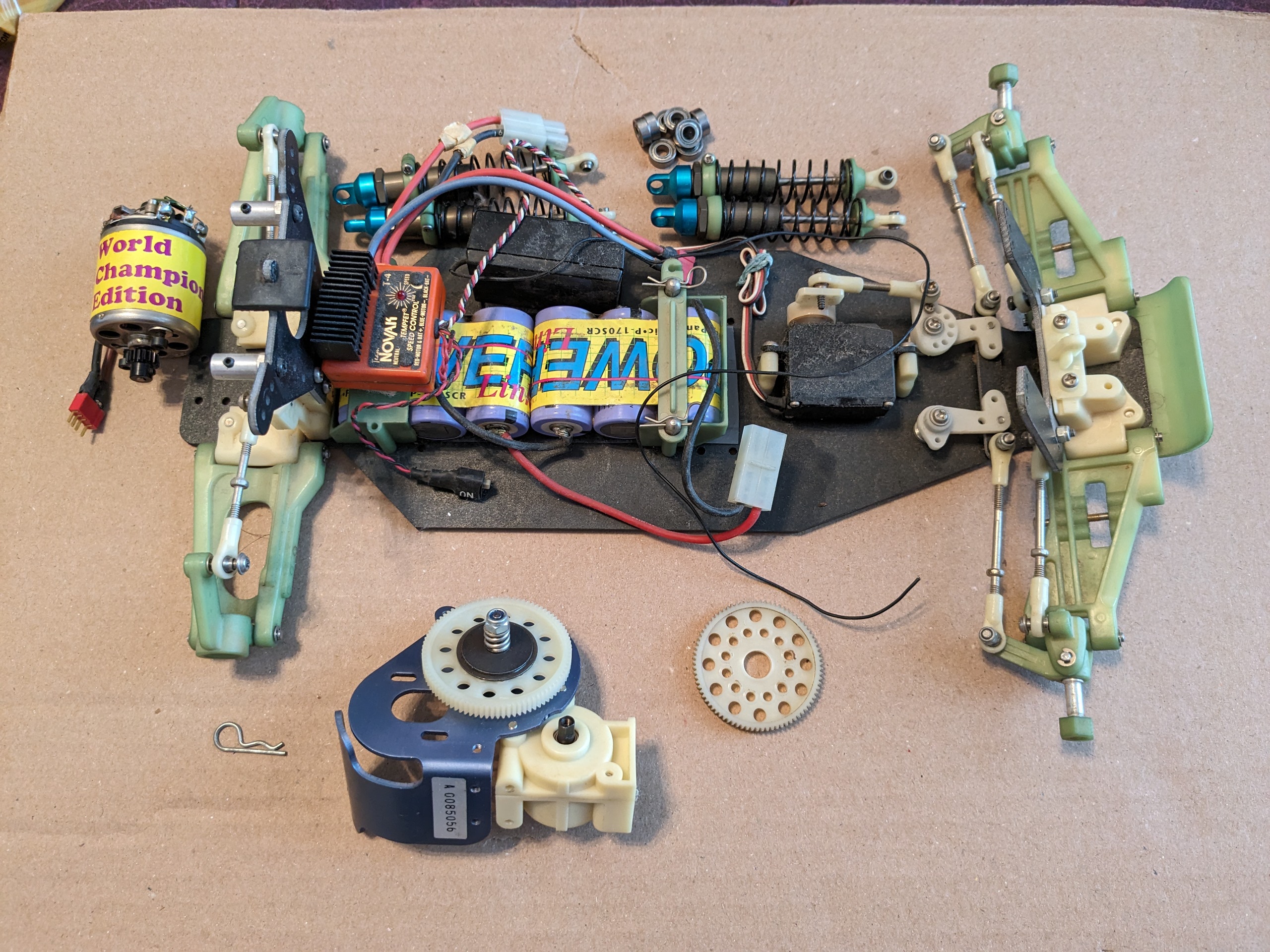

I came across a nice, one owner, mostly complete TRX-1 in a lovely shade of Kermit the Frog green. It came with a really nice motor plate too. However, some slight difference between the TRX-3 gearbox and a TRX-1 gearbox mean the TRX-1 motor plate only works with a TRX-1 gearbox. Well crap, now I have another TRX-1 that needs parts too. But at least it's green?

Well, now you have to build a shelfer, with that trans and motorplate as the foundation.Frankentruck wrote: ↑Tue Jan 23, 2024 5:56 pm I came across a nice, one owner, mostly complete TRX-1 in a lovely shade of Kermit the Frog green. It came with a really nice motor plate too. However, some slight difference between the TRX-3 gearbox and a TRX-1 gearbox mean the TRX-1 motor plate only works with a TRX-1 gearbox. Well crap, now I have another TRX-1 that needs parts too. But at least it's green?

Kermit is pretty well cleaned up, but now I need to figure out what to do for front wheels.
The rears here are Bandit 2474 pin drive wheels, but the matching Bandit 2475 are also a pin drive wheel. I would prefer the fronts to be the old fashioned bearing in wheel setup. Any thoughts what I might use?
