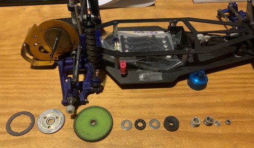

I realized I completely neglected to mention that this car came with most of the proper makings of a Team Losi Hydra-Drive (sans the HD itself) today I managed to pick one up for it.
Here’s what pieces are present as of now.

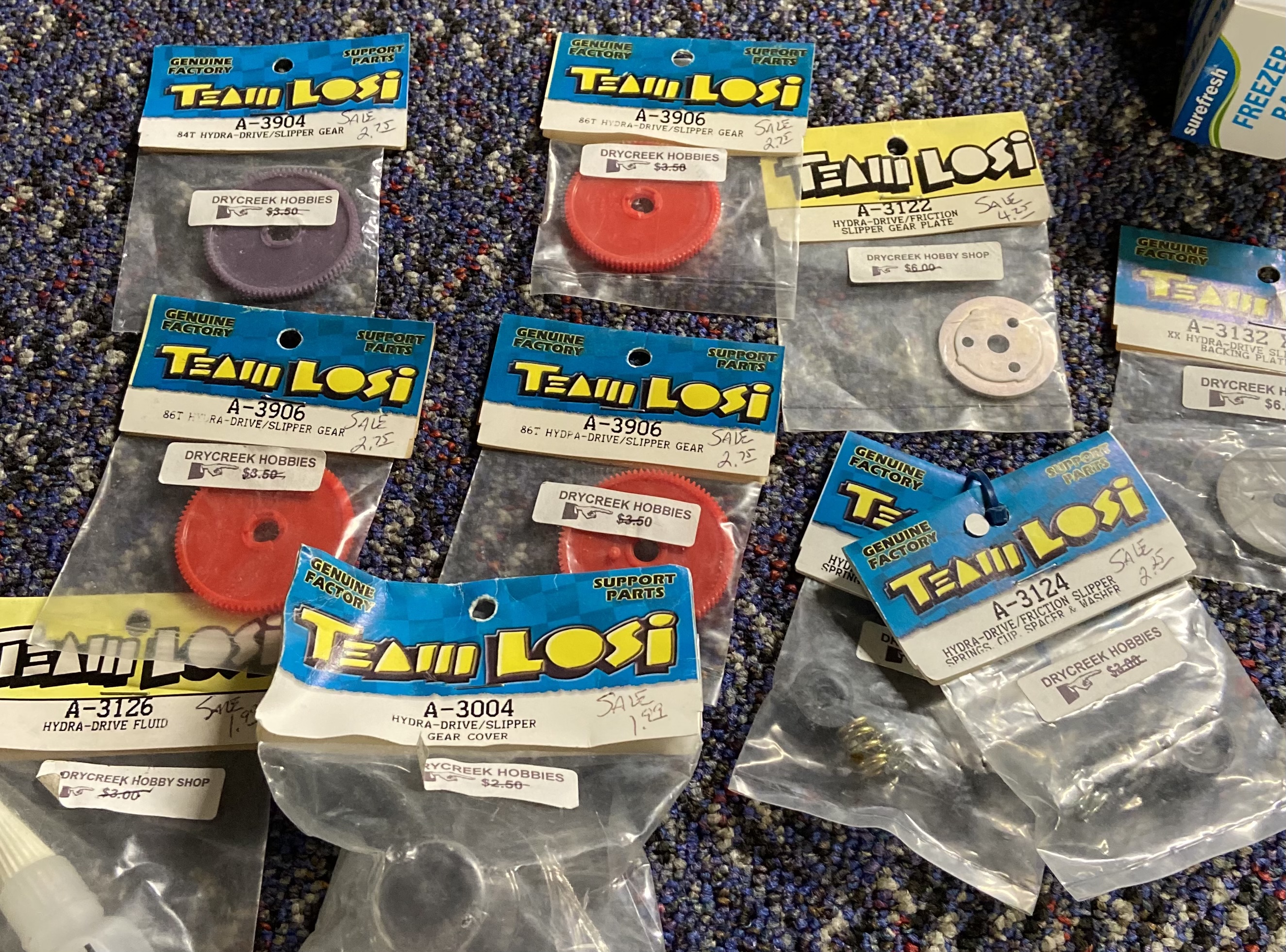

Re: RPM “ 91 Worlds “ with Composite Craft chassis
Post by jcwrks »
You won't use the round plastic spring cup to the left of the spring in your pic. You do need the smaller one (LOSA 3124) that goes on the end of the small spring (only use 1 of course) with the nut topping it off. Not sure if a plain washer would suffice since there is nothing to keep the spring centered otherwise.
http://vintagelosi.com/Instructions_files/HydraDrive_A3100.pdf

Luckily a buddy of mine had some HD pieces I was able to get off of him.

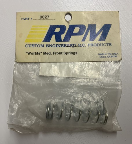

jcwrks
Posts: 674
Location: San Angelo, TX
Has thanked: 171 times
Been thanked: 393 times
Post by jcwrks »
Are you wrenching on this one still? My interest is piqued. :D
RPM Worlds front springs RCCA 05-1993.JPG (32.09 KiB) Viewed 736 times

jcwrks wrote: Thu Oct 12, 2023 8:59 am Are you wrenching on this one still? My interest is piqued. :D
Heck I probably have a set or two of those and the softer yellow springs..
Btw probably the only description I’ve ever seen of the springs short of medium and soft.
