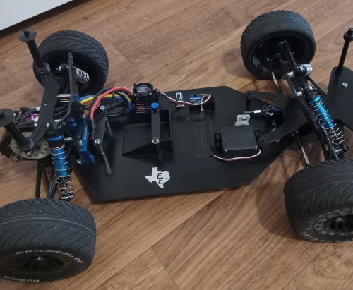

I've built my T3 into a homemade, short course spec abomination....I cut my own chassis, shock tower, and braces from G10 fiberglass, and pretty much redesigned most of the layout....It's become my street terrorizer, and is easily the most fun driving car I have.

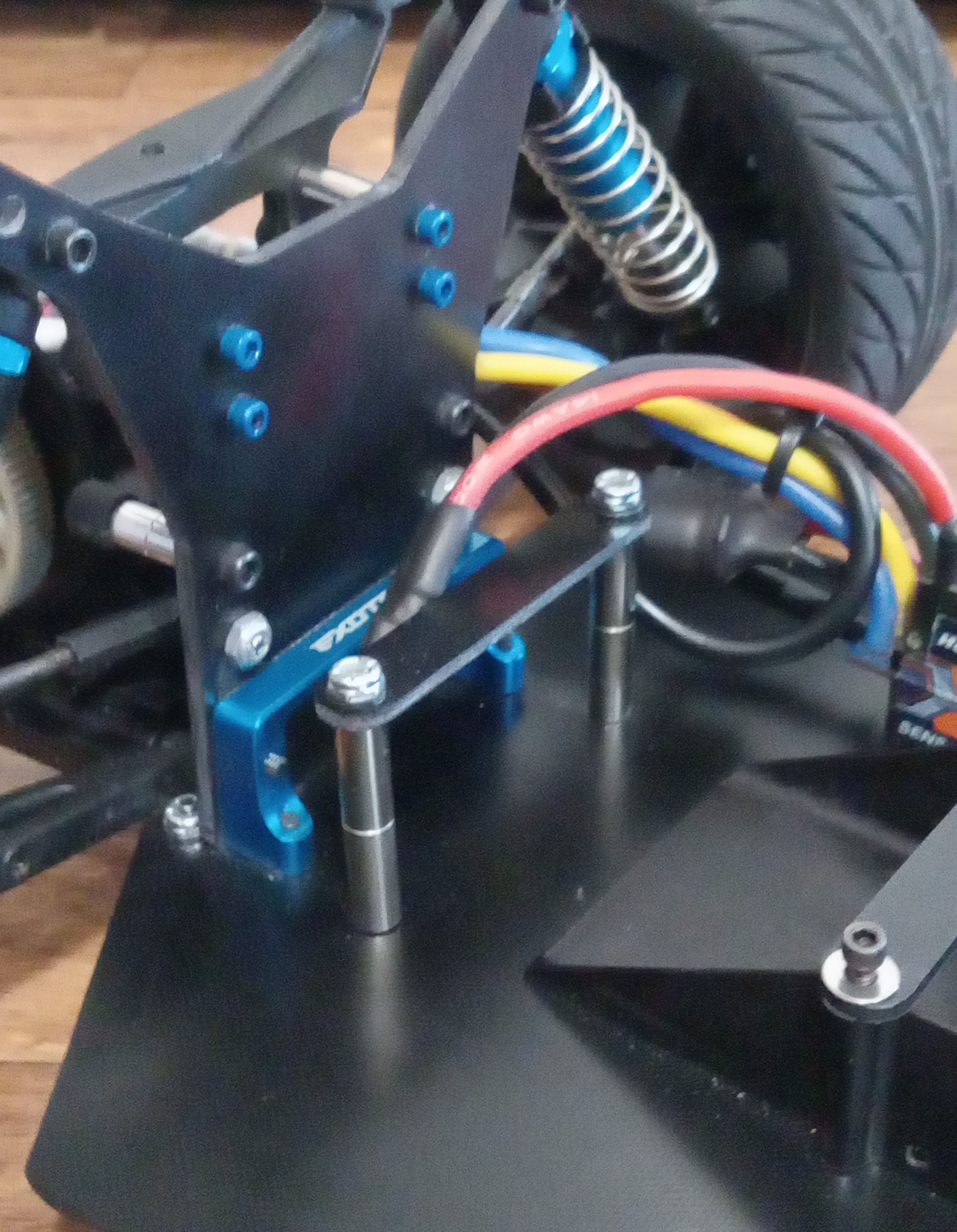

Are you using a servo mount as a rear shock tower mount? That's a really nice custom T3 chassis.Russ Winn wrote: ↑Sat Dec 16, 2023 11:09 am I've built my T3 into a homemade, short course spec abomination....I cut my own chassis, shock tower, and braces from G10 fiberglass, and pretty much redesigned most of the layout....It's become my street terrorizer, and is easily the most fun driving car I have.

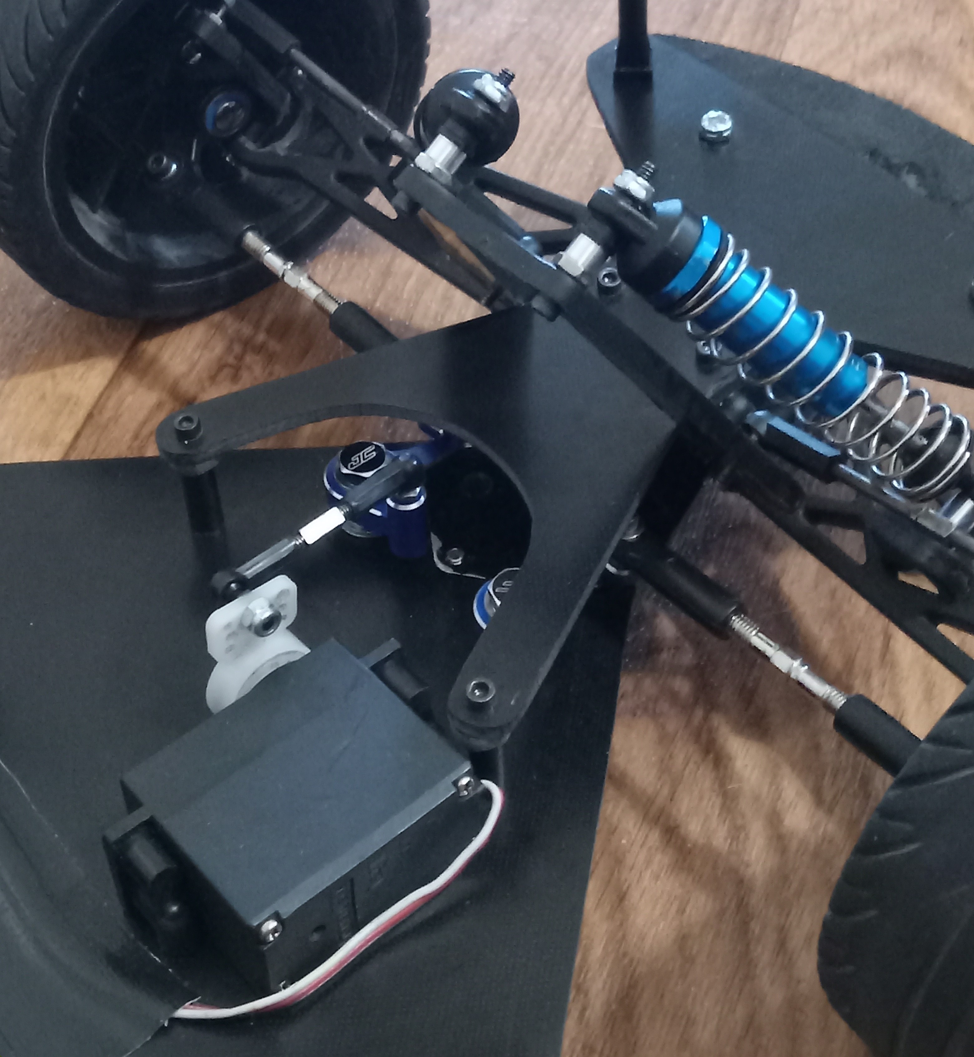

Thank you so much!...Yes, it's a servo mount from Exotek. The bracket in front of it is the rear battery holder. Here's a close up:
Here's the front:
I used a JConcepts steering crank for an RC10.
Here's the front:

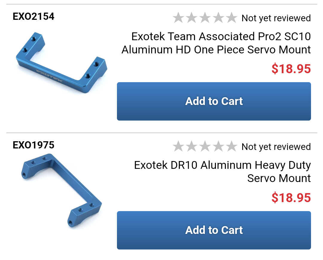

That is a very cool setup! The shock tower mount is a nice solution. Did you use the DR10 or the Pro2 SC10 version?

Neither....It's an old T3 stadium truck, just stretched to short course specs.Frankentruck wrote: ↑Sun Dec 17, 2023 11:17 am That is a very cool setup! The shock tower mount is a nice solution. Did you use the DR10 or the Pro2 SC10 version?

It is a really cool T3 remake. The Exotek servo mount is what Im asking about. I see 2 models of them made and I'm curious which you used.
Are you saying there also used to be an Exotek T3 servo mount made?

Sorry, I misunderstood your question. Actually, I'm not sure which one I used. I just looked them up, and I think either would work.
