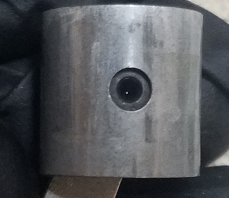

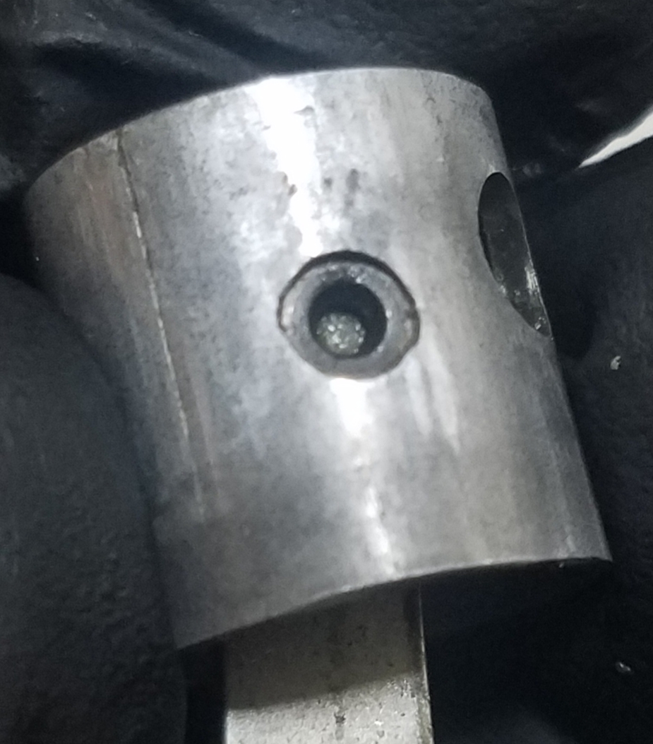

I am replacing the conrod on my OS Max .12 CZ-Z. How am I supposed to remove the wrist pin without destroying it? It feels good still, and I cant find replacements for the life of me. I also dont see any g clips on either end that are supposed to be there? Does anyone know; A: are they supposed to be there? B: where can I get new ones if they are? I have looked online for any clips from OS that might fit, but my lack of nitro knowledge is letting me down here. Can someone please point me in the right direction?

The CZ series don't use clips, they have nylon ends on the wristpin that keep it centered. If you pick up a new wristpin you will get the nylon ends. You should be able to just push that pin right out.
