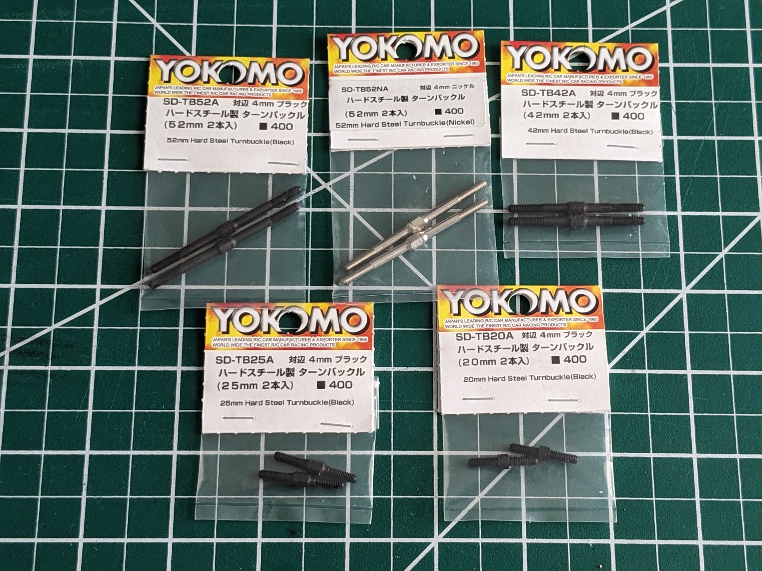

4mm for all three:
From the parts list page of the Yokomo YZ-4 SF...
As printed:
Yokomo Turnbuckle size.JPG (8.84 KiB) Viewed 1108 times

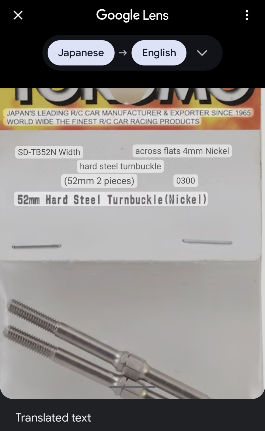

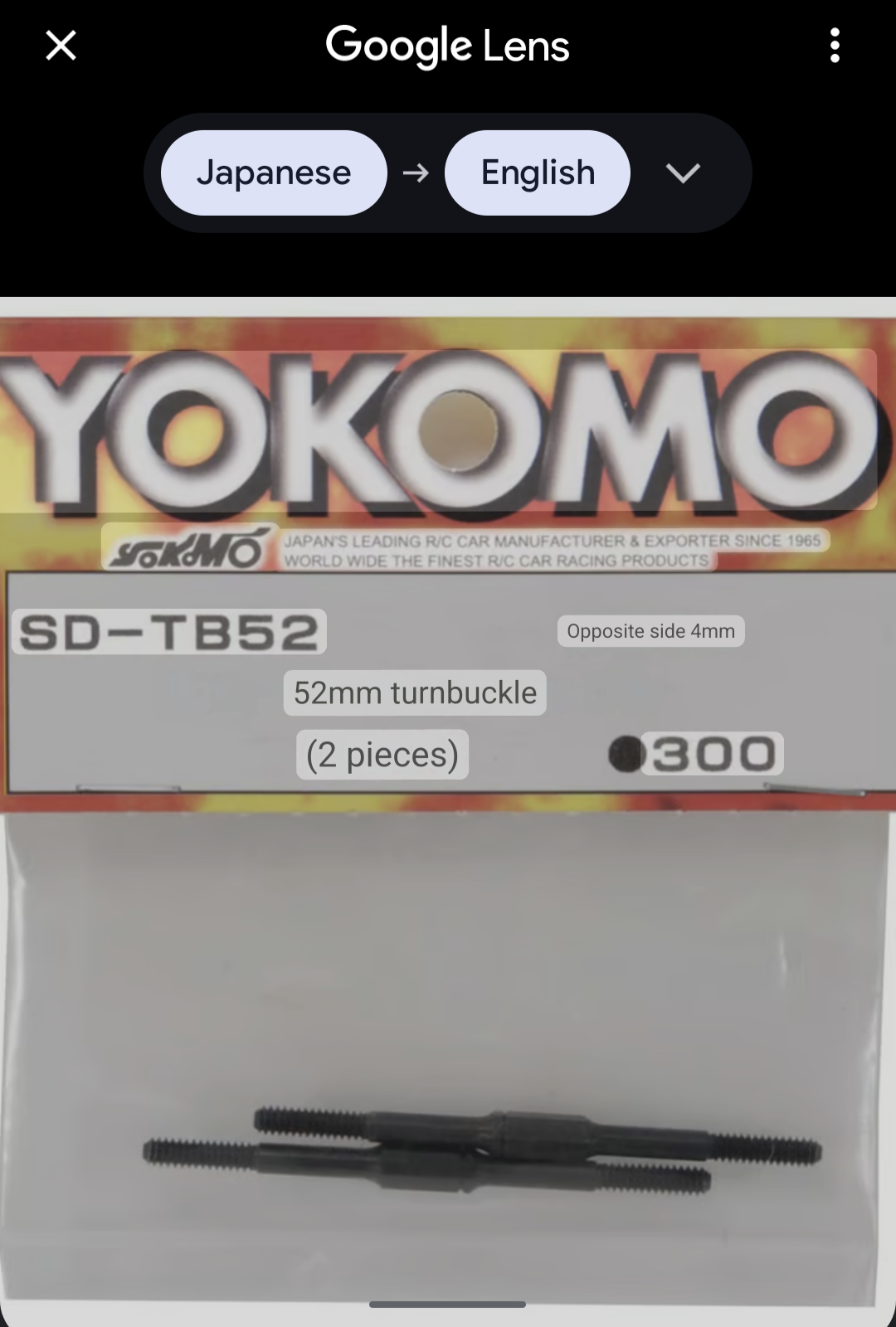

Translated:
Yokomo Turnbuckle Size Translated.JPG (9.04 KiB) Viewed 1108 times

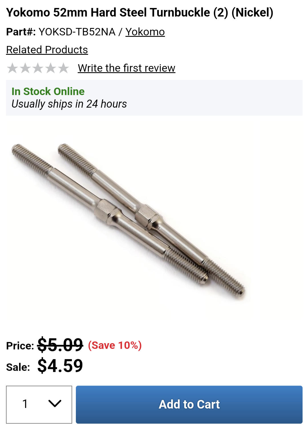

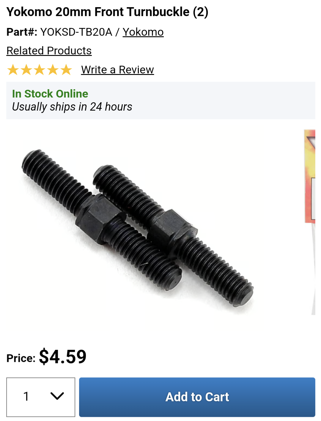

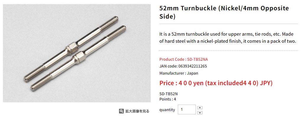

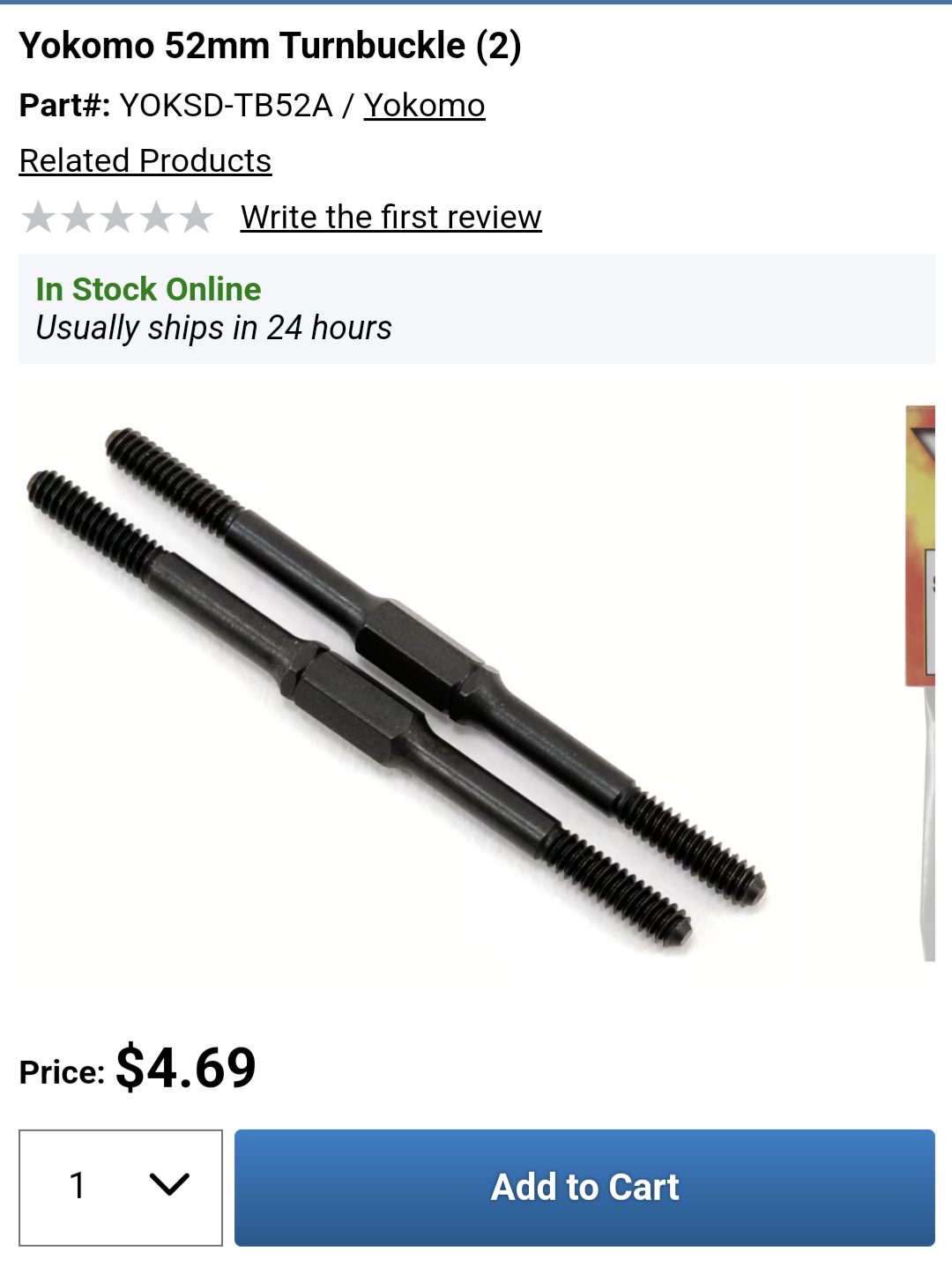

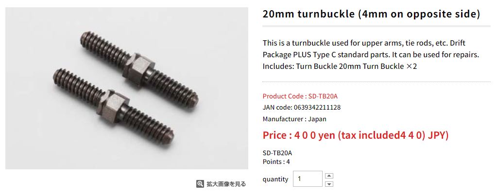

No parts page that listed sd-tb20a so, from teamyokomo.com...
Also from teamyokomo.com...

I saw Techno listing their turnbuckles as 4mm then the thread as 3mm and wondered if Yokomo was doing the same thing. :?
Other possibilities...
CEN:
CQ0310 is a steel 3x25
CQ0313 is a steel 3x52
Integy:
C29050 is a titanium 3x26
C29057 is a titanium 3x52
Schumacher:
640203 is a titanium 3x20
7318 is a titanium 3x53
Acer:
43721226420472 is a titanium 3x24
43638996861176 is a titanium 3x52
Associated:
1418 is a titanium 3x21
1406 is a titanium 3x51

Which shows the same "4mm" spec... then I took a caliper to one of the YZ-2T's I've got and the turnbuckle shaft measures out to 2.8mm
...Apparently the US isn't the only one with a standardization problem :roll: :wink:

Google translate:
Posts: 3810
Has thanked: 2605 times
Been thanked: 2979 times
Re: Yokomo turnbuckle shaft size?
All are 3mm rod turnbuckles
