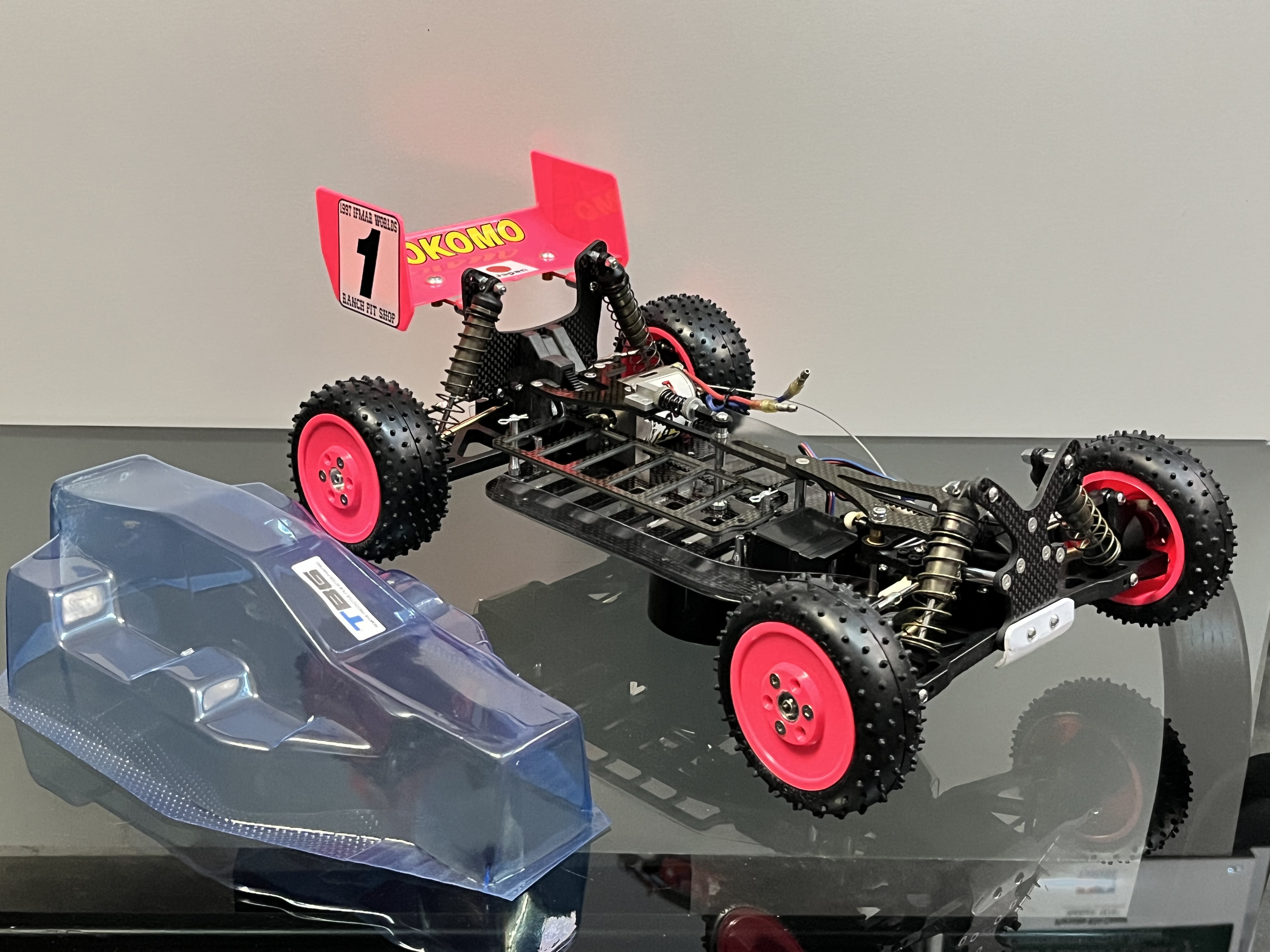

JC Racing wheels and wing, paint and Tekin Pro Star ESC to go and this is done
If it's Old Skool, It's Kool
RC10th
Posts: 4761
Has thanked: 52 times
Been thanked: 1548 times
Re: Yokomo MX-4........ Restore or part out?
Post by RC10th »
Wow, that's fantastic !
Great job Kym, definitely has the old racer look to it !
