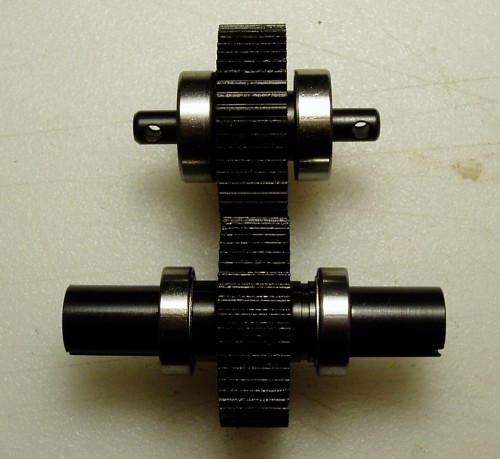

Pictures of the aluminum version of the transmission:

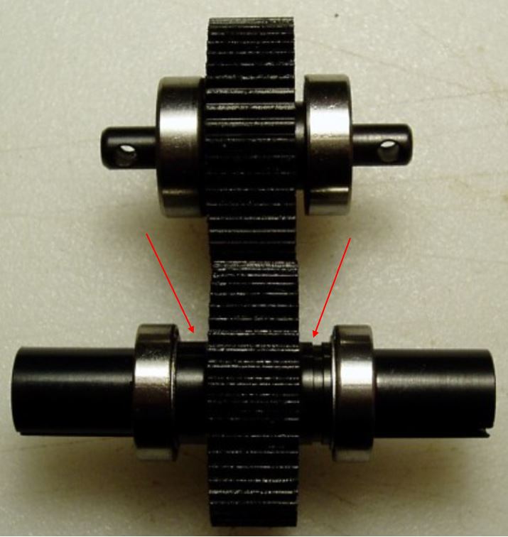

those cases seem to have enough material in the bearing seating to deepen the depth of the bearing hole by 1mm or maybe a bit more on each side.
Picture and text by XLR8:
Quote:
Yes, the BBX diff assembly is too wide to fit the plastic Austar/Injora cases.
Austar/Injora assembly width outside-outside bearings approximately 21.2. Bearings are 5mm wide
BBX assembly width without shims (I removed them after taking the photo) approximately 24.3. Bearings are 4mm wide.
O.A. width of Austar plastic cases is about 25.2mm so there isn't much material available for modification. Maybe it's possible to increase bearing bore depth.

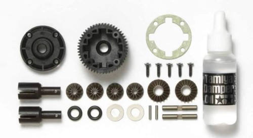

Now is this the Tamiya diff we're talkig about? :
Or the ball diff?:

Bearings inboard -- modifying the diff:
A TA06 (or BBX) ball diff could offer the simplest swap IF the outdrives can be modified to move the bearings inboard (approximately 1.5mm/side if using 4mm wide bearings) – as you’ve mentioned in your last post. It’s worth trying but the outdrives are almost certainly hardened steel and I haven’t had much luck lathe cutting or drilling hardened steel but my equipment isn’t the best.

I was about to order the Tamiya gear diff assembly (54471) and it suddenly occurred to me that the diff gear and side plate assembly is almost certainly too wide to fit the Austar/Injora case. That case is very narrow and closely hugs the gears.
Maybe the Tamiya ball diff (54306), with outdrive bearing seats modified to allow the bearing to ride farther inboard (reducing OA bearing to bearing width), would be a better candidate for this swap. Of course, the ball diff is designed to work with dog bones but I'm using Traxxas universal shafts for my Porsche project car. I need a diff with 5mm dia. drive axles not drive cups.

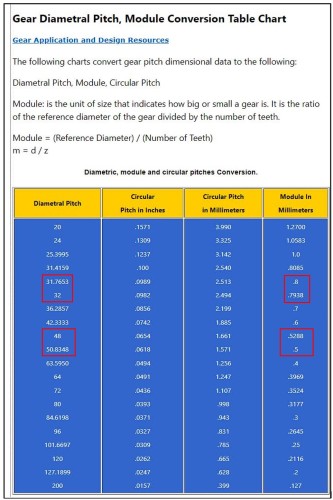

unfortunately that is not quite correct what Mr. Google had to say. See the table below. 32DP is close enough to work with MOD 0.8, but the mismatch between 48Dp and MOD 0.5 is too big. Especially the smaller the gears get. I have a 20T input shaft from Team Durango that I wanted to use with the RC10 stealth gearbox. Once that is installed, the gear mesh becomes "crunchy" I don't have a better word to describe it.
Here's the table:
Here's the table:
