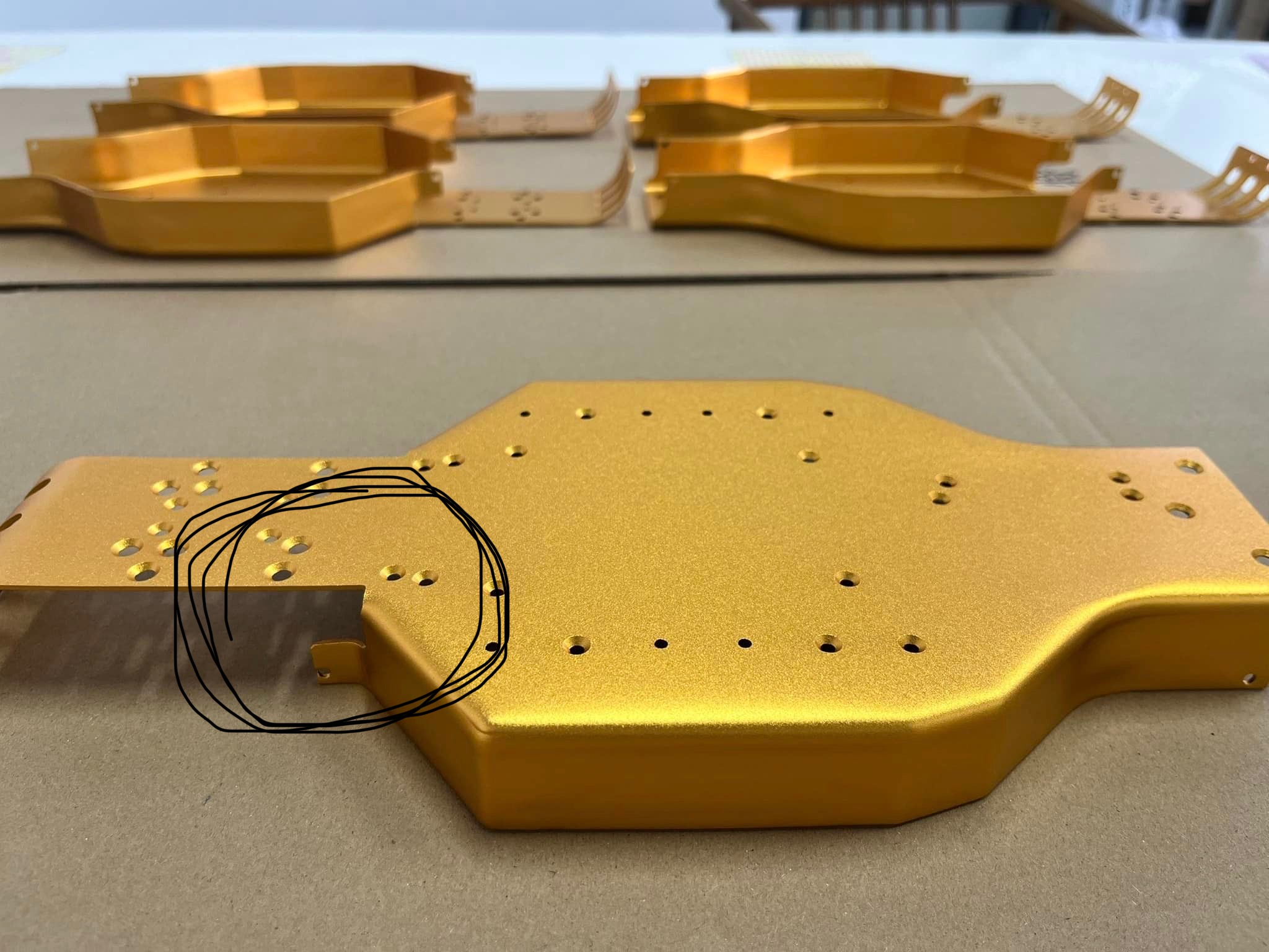

Sylvia Zhou https://www.facebook.com/profile.php?id=100085054200314 Manufacturing RC10 Aluminum Chassis`s and nose plate and tubes out of China ,Give a look? Also makes arms. For those that want to build a new kit or do not want to run their chassis ??

"They" go by lots of names. This is the main pic they put up when they introduced their "anodized" chassis. Anyone see an issue (outside of the "anodizing")? I pre-ordered two chassis plates from them, and as soon as I saw this pic, I canceled them. I pointed it out on their FB page, and they called me out for "speaking mistruths."drc35ca wrote: ↑Mon May 13, 2024 6:31 pm Sylvia Zhou https://www.facebook.com/profile.php?id=100085054200314 Manufacturing RC10 Aluminum Chassis`s and nose plate and tubes out of China ,Give a look? Also makes arms. For those that want to build a new kit or do not want to run their chassis ??
For nylon, FanRC stuff looks A LOT better than theirs.

That does look a bit sus.
The finish looks like Goldfinger painted it.

I don't know much about these cars.morrisey0 wrote: ↑Mon May 13, 2024 7:00 pm"They" go by lots of names. This is the main pic they put up when they introduced their "anodized" chassis. Anyone see an issue (outside of the "anodizing")? I pre-ordered two chassis plates from them, and as soon as I saw this pic, I canceled them. I pointed it out on their FB page, and they called me out for "speaking mistruths."drc35ca wrote: ↑Mon May 13, 2024 6:31 pm Sylvia Zhou https://www.facebook.com/profile.php?id=100085054200314 Manufacturing RC10 Aluminum Chassis`s and nose plate and tubes out of China ,Give a look? Also makes arms. For those that want to build a new kit or do not want to run their chassis ??
Too cryptic for me, Chief.
What are we supposed to be looking at?
What "issues" are we supposed to be concerned / upset about and why would AE call you out for "speaking mistruths?"

I dont care if they paint them with a rattle can as long as they fit so I dont have to scratch AE`s Rere super thin anodizing on a thin chassis! I repaint most of my chassis1`s with match paint anyway after a few months of hard running.

doesn't seem any more extreme than either of my rere silver or gold pans. Also the stiffeness mostly comes from the 4-40 screws bolting to the top of the pan. That said that screw hole is a bit too close to the edge for my liking. The finish looks like they blasted the aluminum instead of using a sander.

With respect to the hole so close to the edge: in addition to it being unsightly and weak, I have to wonder why it is so close. Is the hole slightly out of place? Or is the hole correctly located on a tab that is too short?
