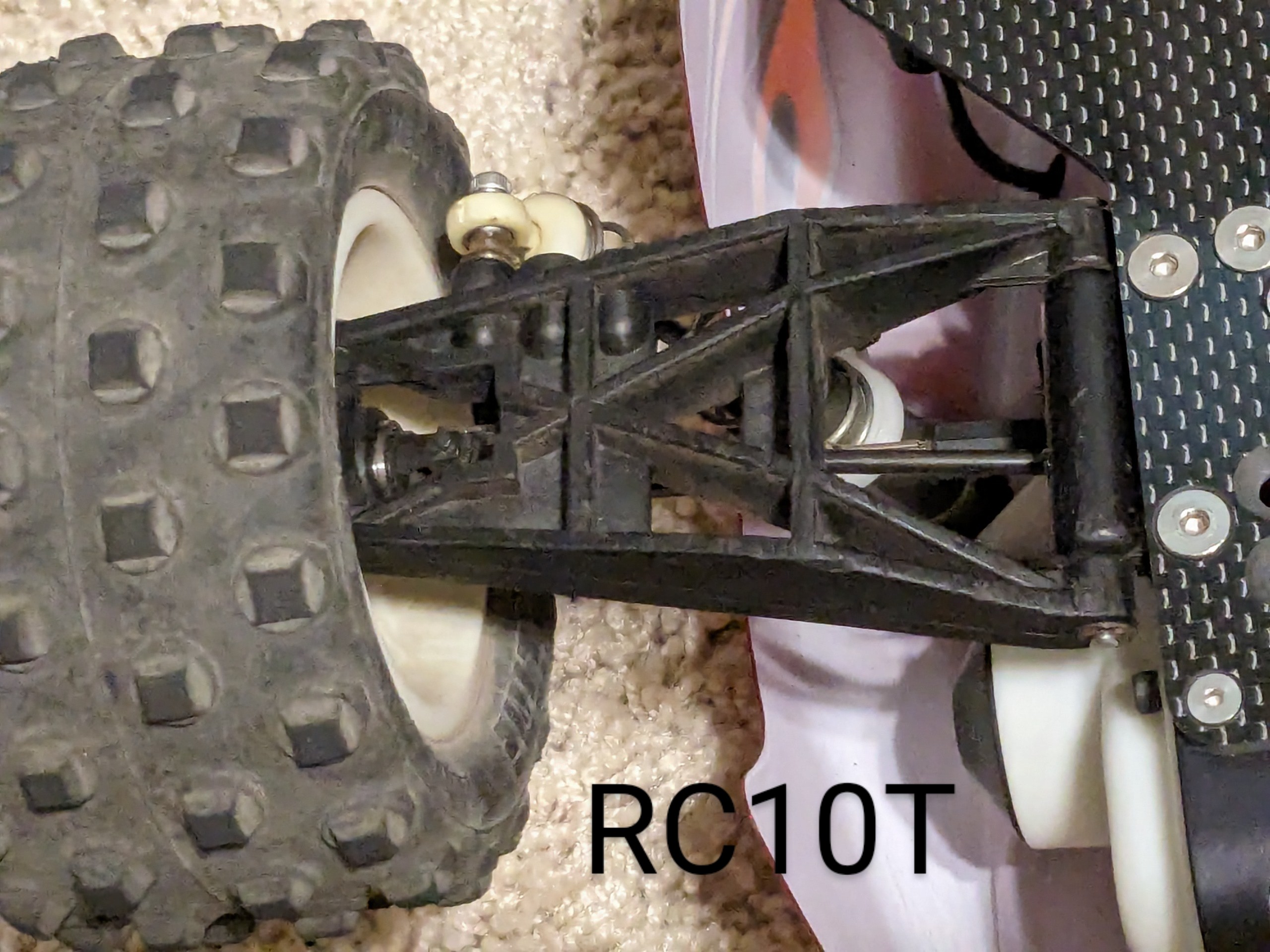

So the replacement arms have arrived from Factory Works. Thanks again Jeff.
Notice the difference (original arm is on the right).
The new arm lacks a stringer at the wheel end. I'm guessing the replacement arm is a later design?
With this design, perhaps some torsional rigidity is sacrificed but the droop problem is solved.
Of the two, I prefer the new design; droop is more important than torsional flex.

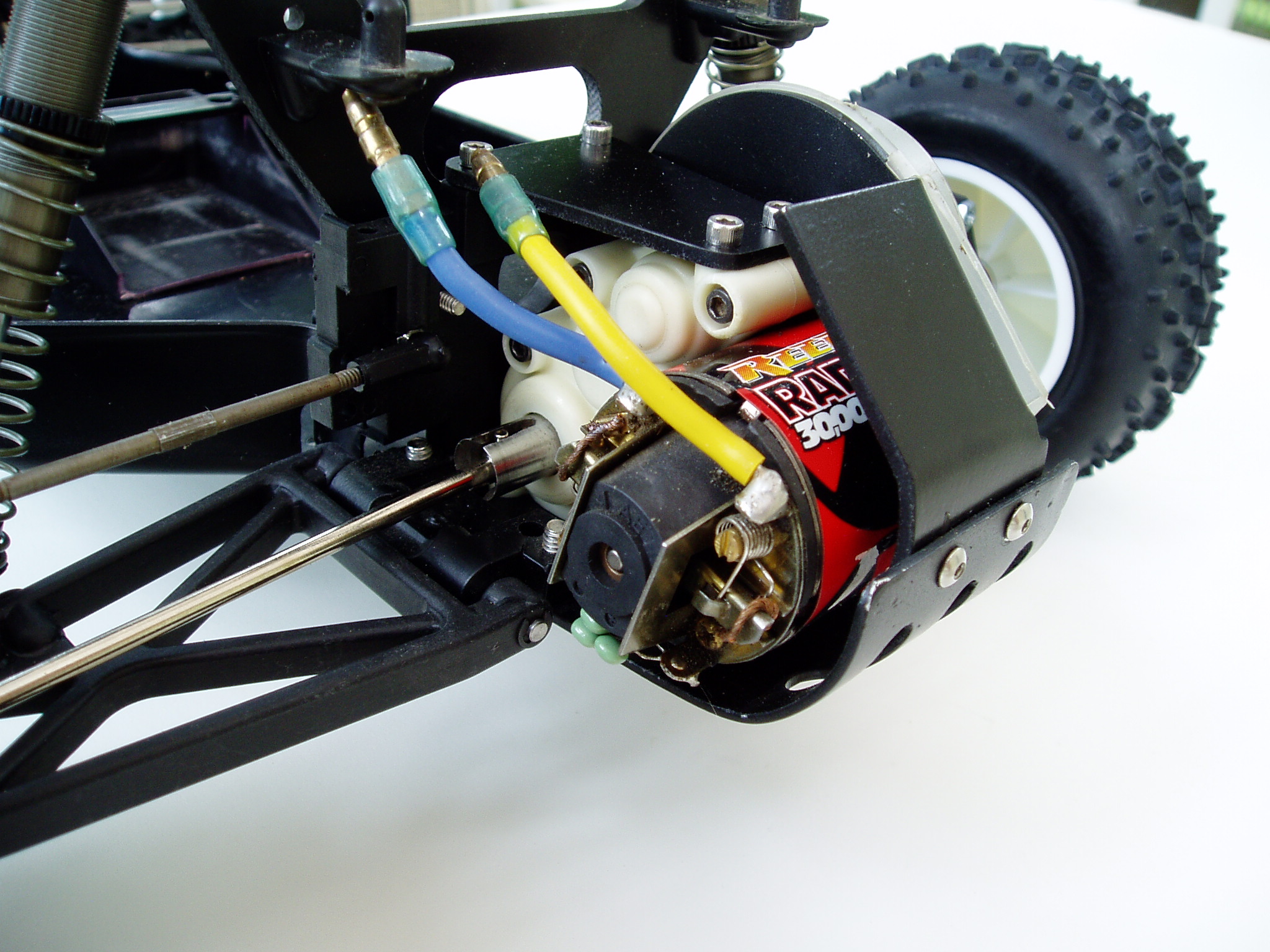

The chassis is finished so thought I'd post an update.
The tub has spent some time as a buggy so a quick coat of matte black hides the scratches.
I've had a couple new sets of these threaded shock bodies for a while and this seems like a good project to use a set.
Having never before owned or even driven a 10T, I don't want to drop-in a high HP brushless system until I've spent some time learning and dialing-in the truck.
So, I'll start with this brushed Reedy Radon which I think is 15 or 17 turn. Stealth cases are new. New stainless fasteners throughout.
That's it for now -- more to follow. :D
