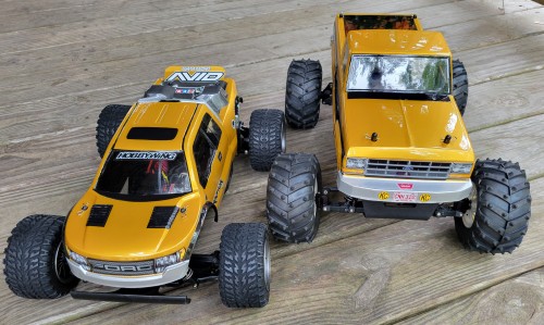

While it definitely isn't "chrome", I use Duratrax Silver Streak on bumpers and such. It is metallic and reflects well in sunlight (its overcast today, so...).
It also works great as a neutral backer.
