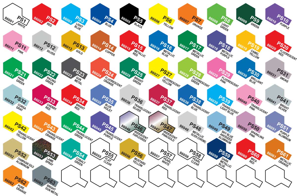

I'm trying to get a certain color for a 1/10 '67 Corvette body. I can't find the exact color match in Tamiya, or Duratrax polycarb spray paints.
I've seen some people say that if the inside of a lexan body is roughed up with a green pad to produce a scratchy looking adhesion surface, and then de-greased with soap and water, that then nearly any spray paint will stick to that surface. Has anyone tried this, or have experience with this?
Wanting to try color matched Chevy Marina Blue spray paint for autos, inside lexan.

I would think PS49 could get you there with the correct backing.

morrisey0 wrote: Mon Feb 12, 2024 8:19 am I would think PS49 could get you there with the correct backing.
I was checking that PS-49 out, but it has a matte anodized finish, while it could pass if I weren't being too particular, it doesn't have the right blue overall, Sky PS-49 looks like silver over blue, I need blue over silver.
Marina Blue Metallic is hard to capture in pictures, it's definitely sparkly, but not like an old 70's boat, it has a silver sheen below the blue that moves as you walk around and catch the sun off of it.

There's nothing foolish about using automotive paint on lexan. Just "prime" the body with PS-55 and I think you'll be fine.

Tamiya PS-55 is Flat clear, the Flat won't dull the layer beneath it?
I've only used PS-55 on the outside of lexan so far. Will test some plastic bottles with PS-55 on the inside this time.
The flat clear won't affect the finish in any way. Assuming, of course, that you are painting the inside of your body shell, the lexan provides a glass-like reflective finish.
