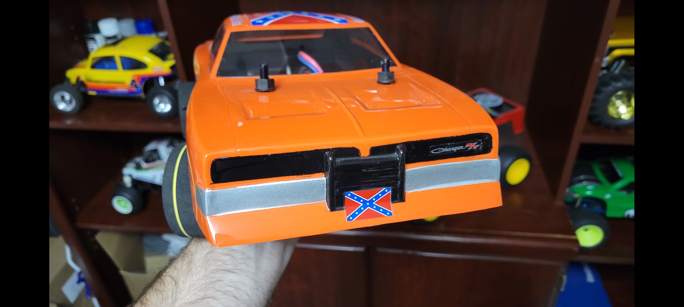

I used the same paint for the bumper on this one.

juicedcoupe wrote: Thu Feb 01, 2024 6:19 pm I used the same paint for the bumper on this one.
Nice General Lee! What make and year is your Charger body? Is that the MCIracing, General Lee decal set?
Did you spray over the X-11 with Tamiya PS orange? Did you back it with any other color?

Re: Brush Painting Aluminum/Chrome Details inside Lexan - First Attempt
GreenBar0n wrote: Thu Feb 01, 2024 7:24 pm
Thanks as always @juicedcoupe!
It is a 1/12 Bolink 69 Charger "Little Rebel" body, on a Digger chassis.
I applied several coats of the silver, until it had full coverage. The orange Duratrax paint is sprayed over it.
Yes, the decals are from MCI, in 1/12 sizing.

That's what I was hoping to hear, regarding the silver. I'll give it a go. Thanks!
