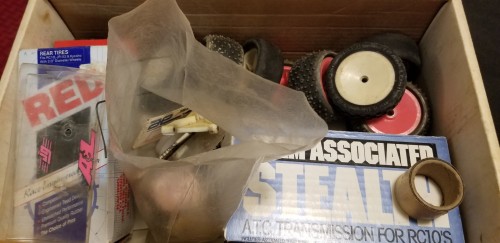

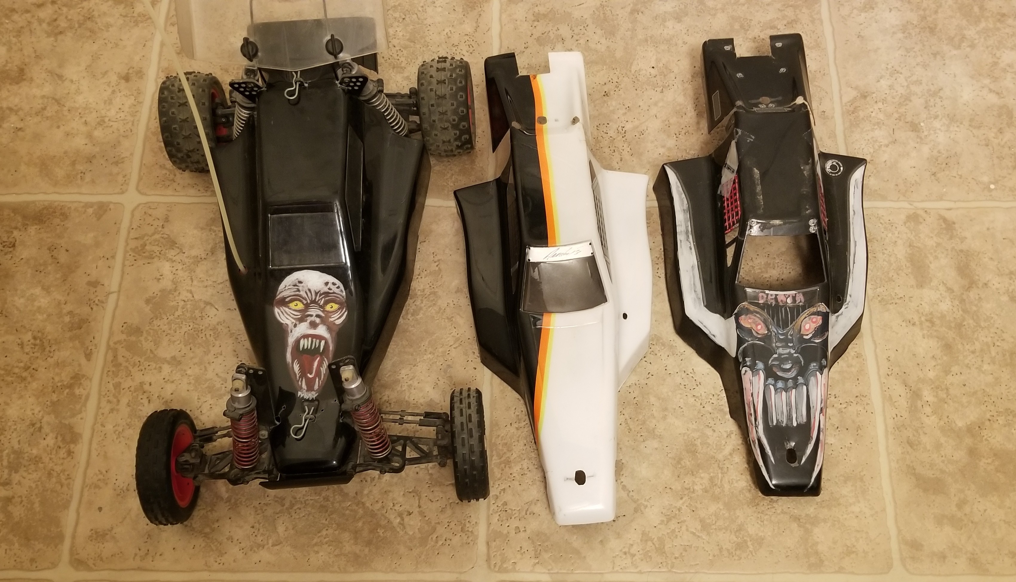

Since no thread is any good without pictures I'll start this one off with a picture and a story. Along the way I'll do a little RC archaeology as I dig through old track bags and parts boxes.

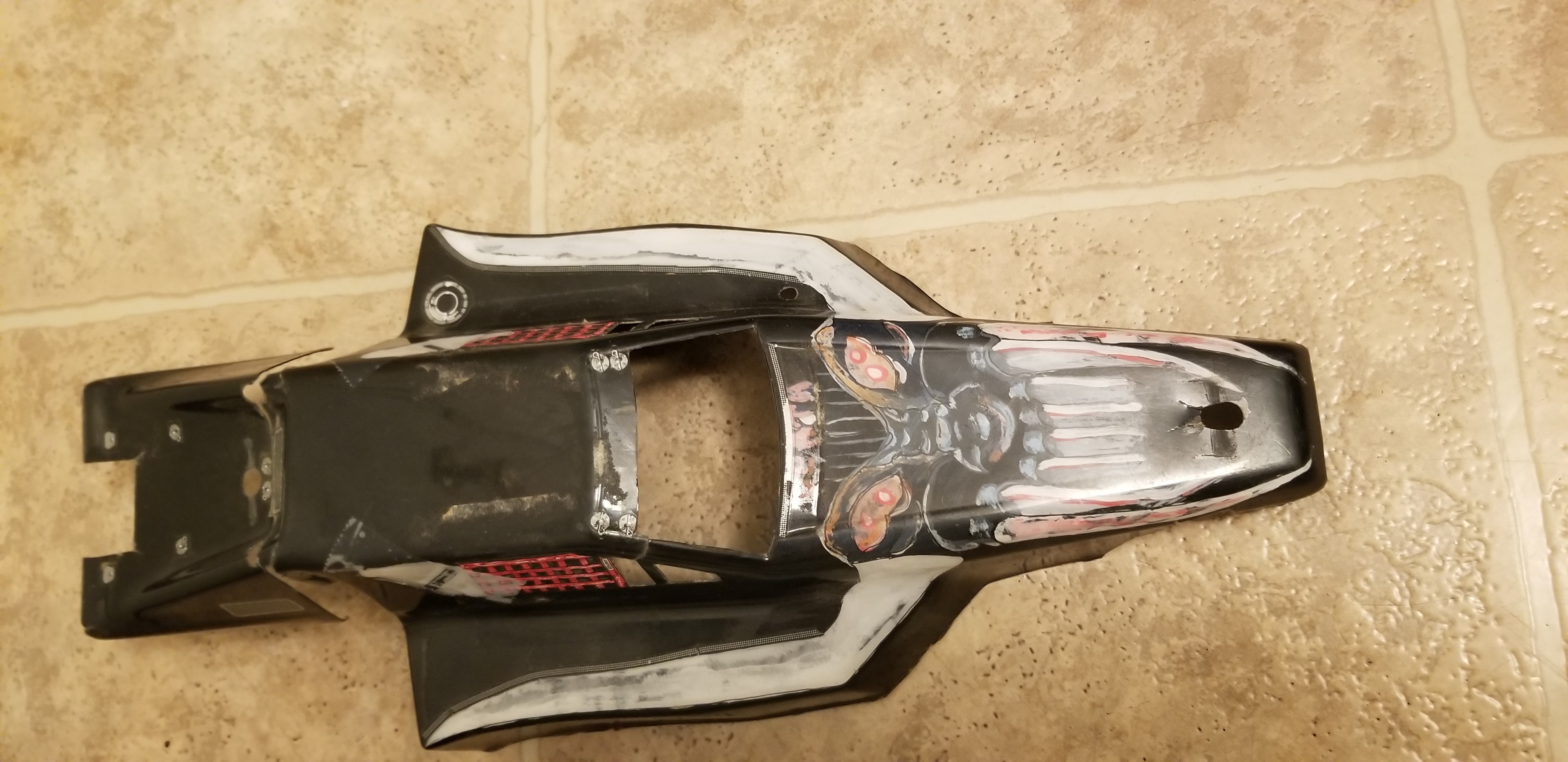

These are the doom buggies. Well, one doom buggy and the bodies off the other. My RC10 graphite is already in pieces on the bench but the pictures explain the title.
I have no idea what made me think of hunting for my old RC cars in my mom's garage, maybe something on youtube triggered a memory. Anyhow I found them, The Graphite, a JRX-Pro and an RC10L road car all neatly packed up in a box along with the original factory boxes, a track bag full of parts and tires, dried CA and leaky oil bottles. I had bought the RC10 new in 1989 or early 1990 when the graphite chassis RC10 was the new hotness from Associated. I ran it regularly at the old RCHR track in Costa Mesa CA, and in any dirt lot, park or cul-de-sac I could find.
A friend of mine free hand painted the motorhead themed body (the second by him, the first was damaged from heavy used and eventually tossed out). I painted the ghoul image on the JRX-Pro.

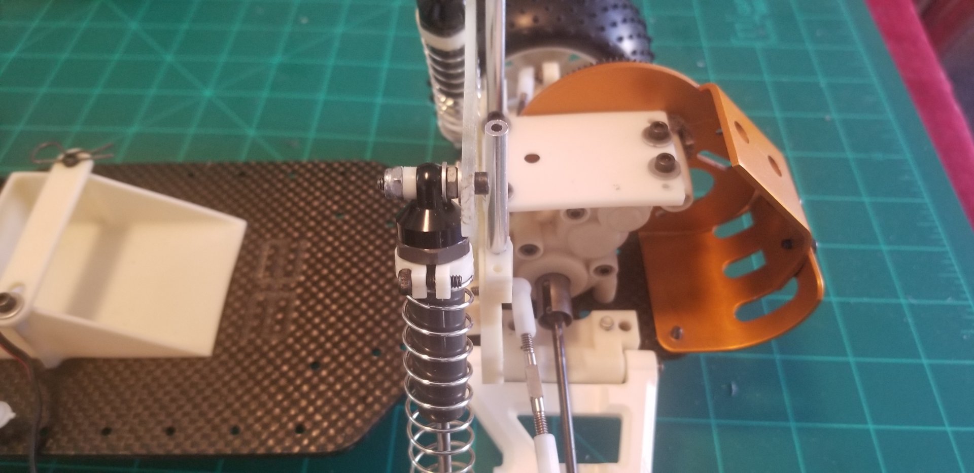

I added a stealth transmission, long front shock towers and some Andy's rear arms. My initially poor driving and constantly treating it as a dirt lot basher eventually caused minor delamination of the leading edge of the carbon fiber chassis. Nothing near the screw holes, just cosmetic damage at the edge, so I bought a little kydex bumper. That worked well, until it didn't:
Eventually I bought a second graphite chassis plate and installed a white Andy's front bumper to protect it. I kept the old plate as a backup but I can't imagine what it would take to do enough damage that I'd need it.

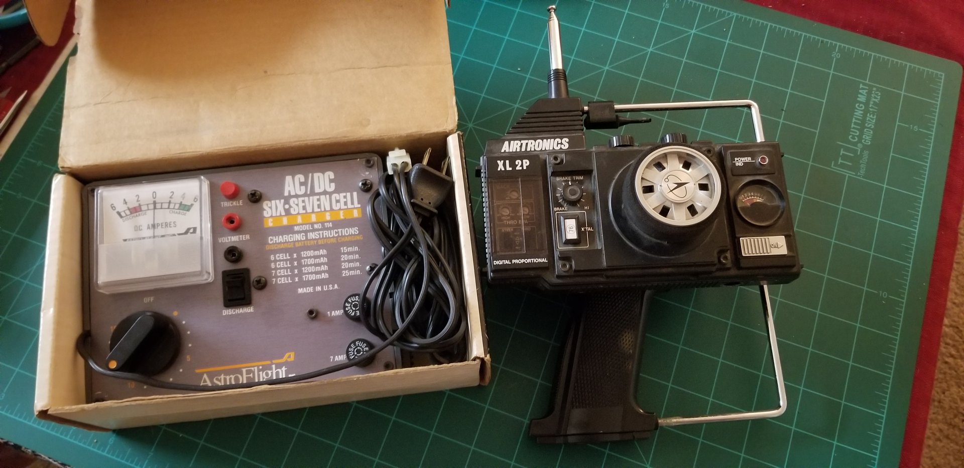

Anyhow, after a bit of fiddling with radio crystals and an old AstroFlight ni-cad charger I got the car running and ran it around in the street on some old slick tires. The car had spent 30+ years in boxes stuffed in hot grages, closets and various torage units. The batteries are probably vintage 1991 or 92 and the tires about the same, but they worked. The car ran. I realize this was not the wisest of moves. The bearings hadn't been serviced in 30 years nor had the shocks, they still had oil in them though.

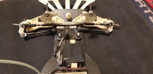

The buggy itself

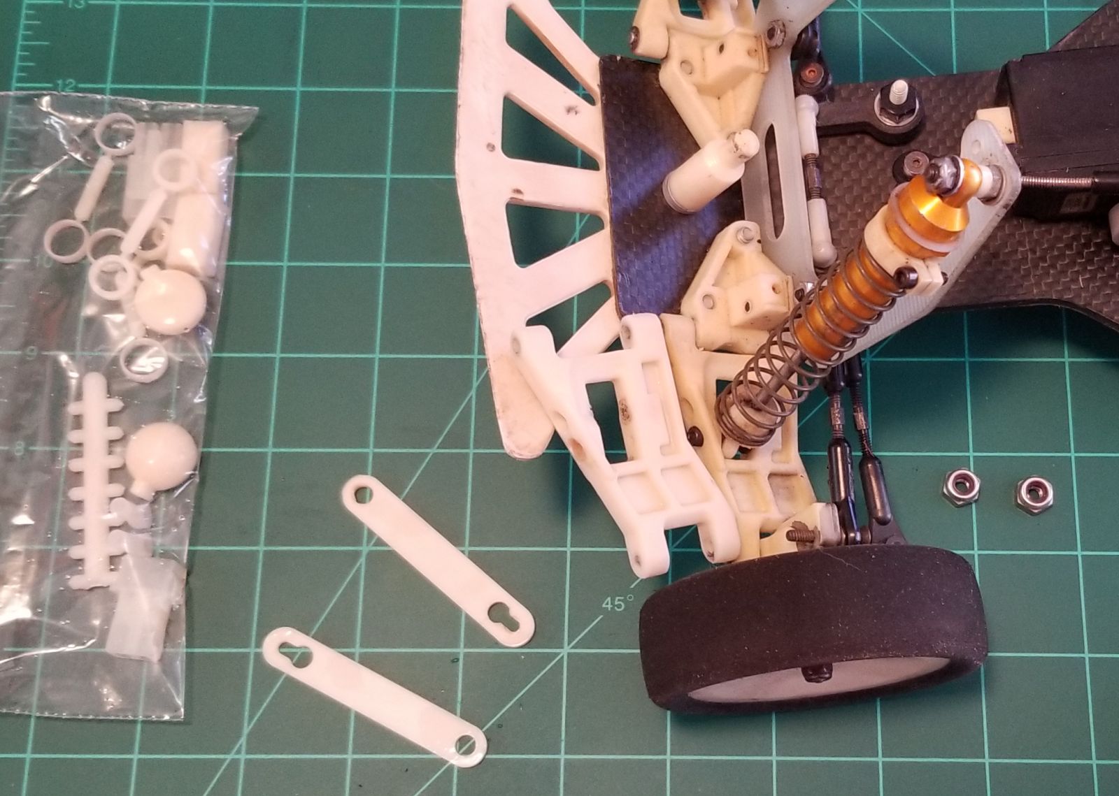

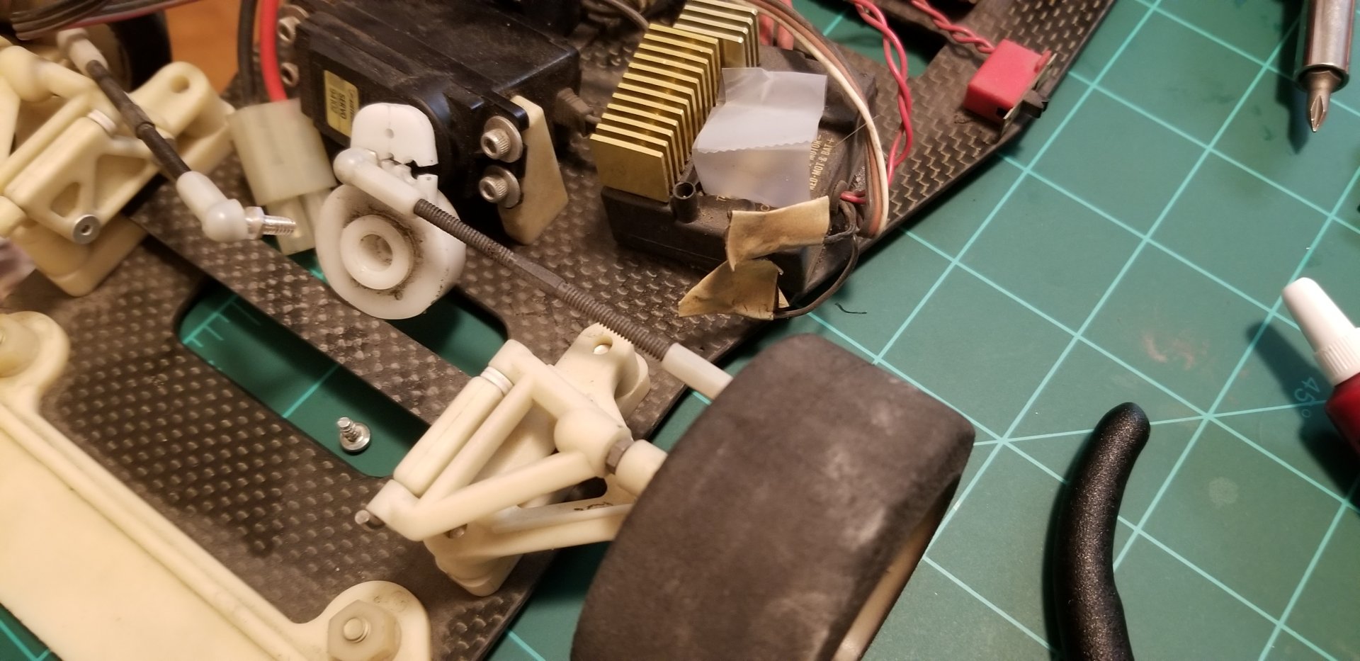

The front links. I have no idea what brand those are. The factory ball cups were getting worn out. Some were really loose and others were binding so I bought these.
If anyone recognizes those please let me know what they are.

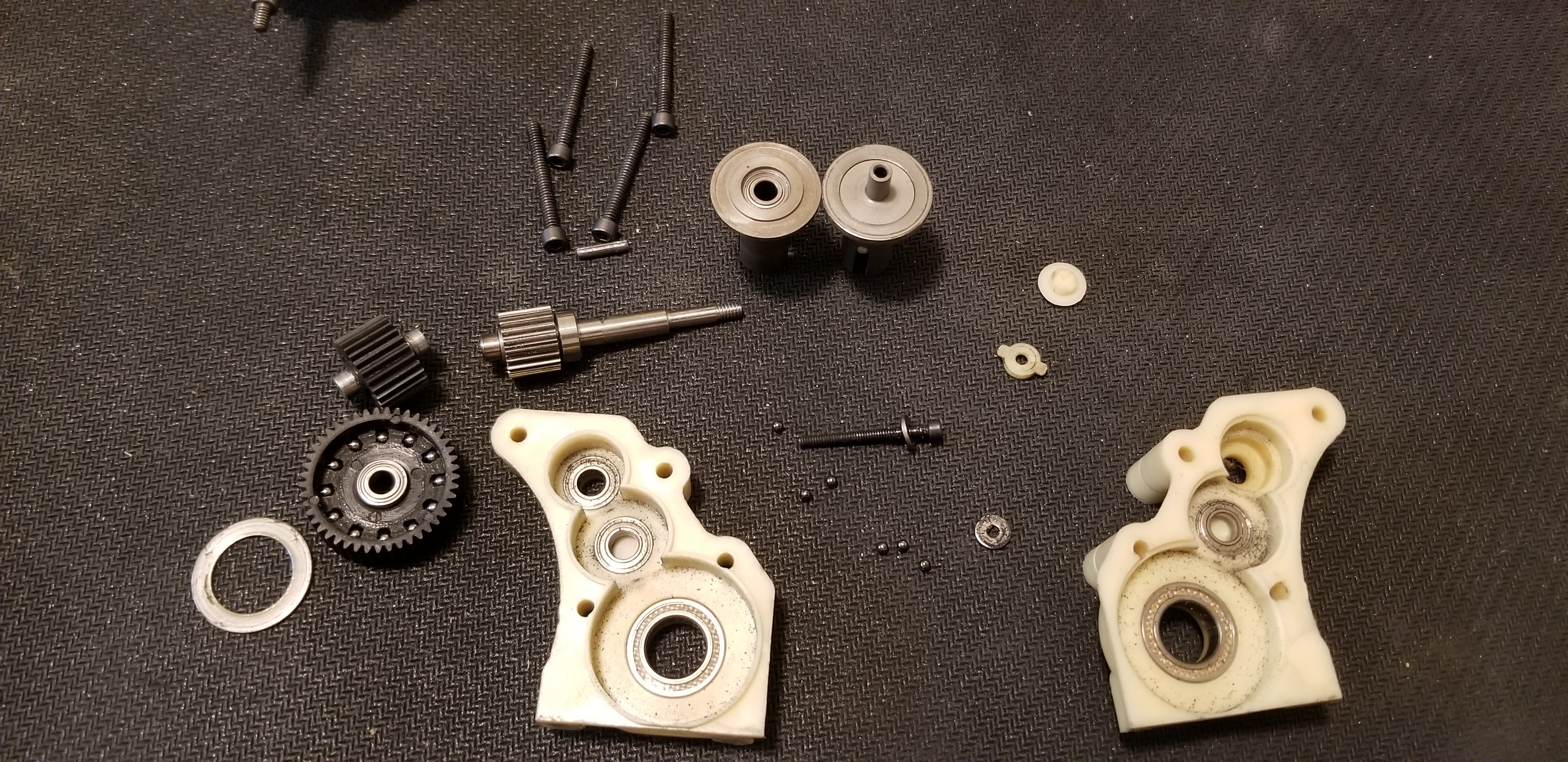

The transmission was a bit dirty inside. That's not grit in the photo, just dirty black grease. Maybe from the thrust bearing? I don't know. Anyhow it got cleaned and reassembled.

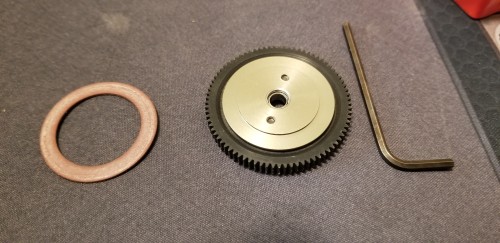

Here is the slipper clutch assembly:

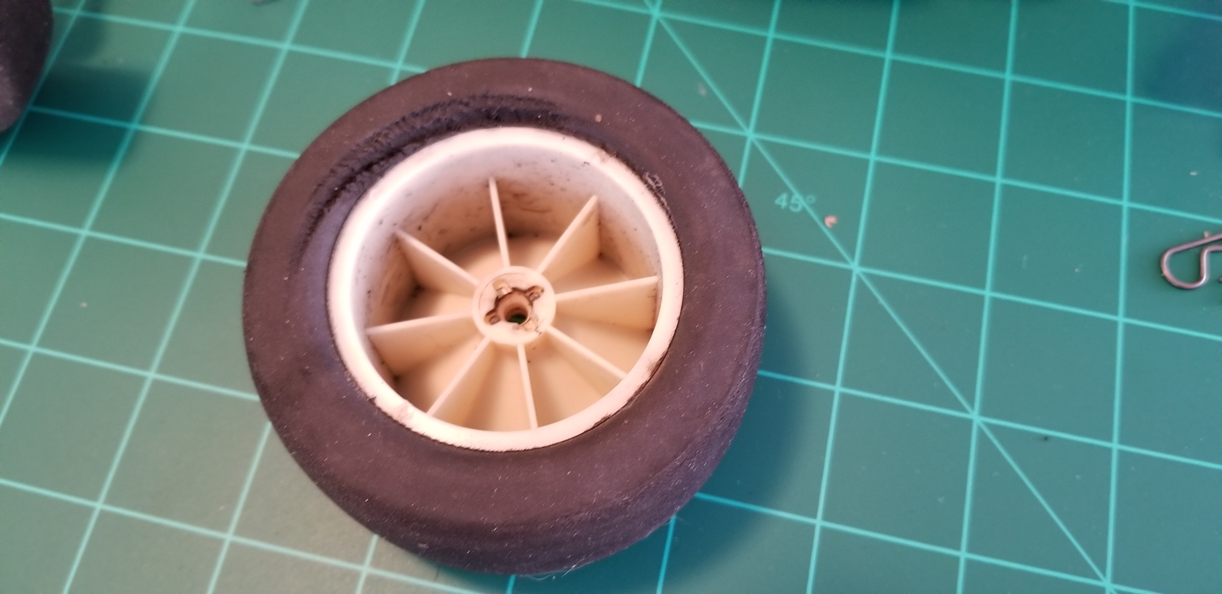

A bit about those tires. I have no idea what brand they are, but they are very soft and sticky. Age and heat have not hurt them at all. I also have a set of extra wide fronts that are made to overhang the fron rim, but the compound is different and very slick. I took them off because I got vastly better from traction with the skinnies.
Anyhow, turns out I likely never glued those tires up or at least didn't do a good job. on my last run after jumping some speed bumps and doing some power on spins the outer bead of one tire jumped off the rim causing the tire to fold over on the inside of the rim. I couldn't see it from where I was driving and hit the throttle. The car moved but the rim spun in the tire chewing up the inner sidewall
Since those were my only pair of street tires I can't drive it around the apartment parking lot. While the car is out of commission I decided to try my hand at peroxide bleahing some of the old spare parts in my box. It turns out Arizona sunshine in June is fantastic for quickly lightening nylon parts. Who knew?

The buggy itself

Nice buggy! The ball links are Dubro links.

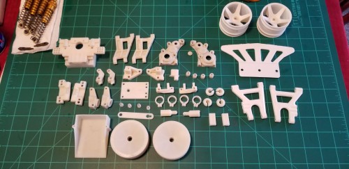

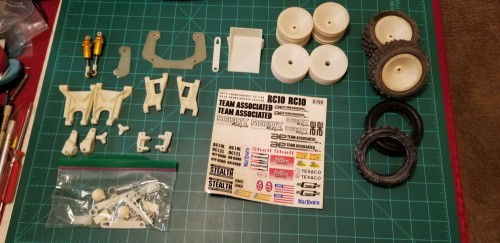

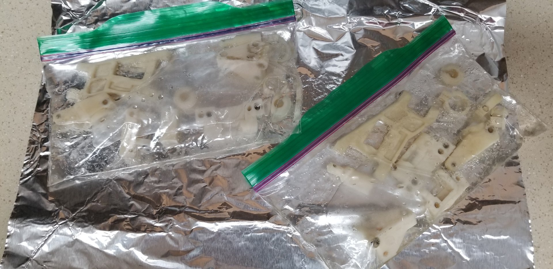

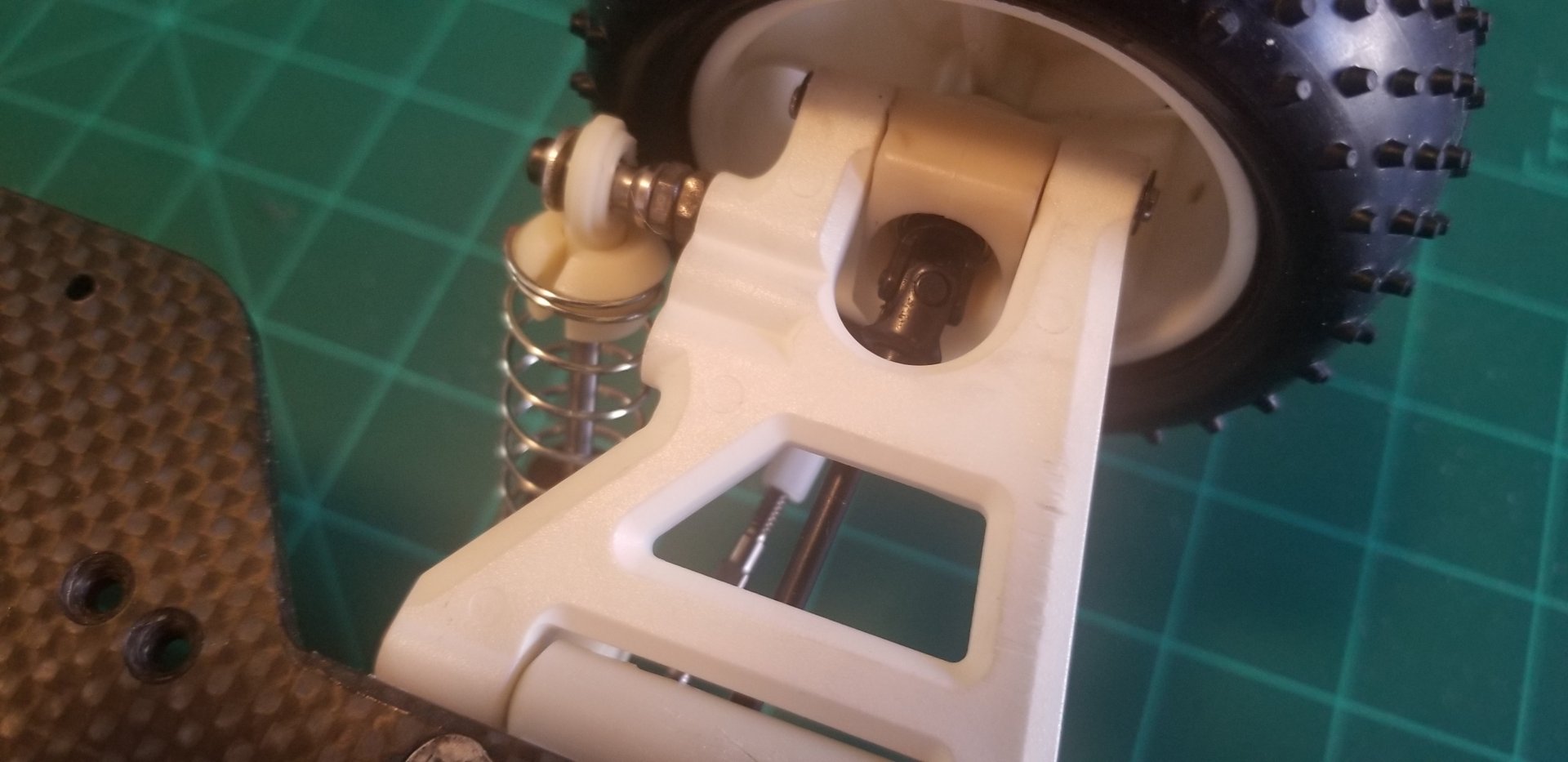

Gee those peroxide bleached spares sure look nifty, maybe I should bleach the whole car.
This is the bleached arm, vs an unbleached arm. The other parts never saw sunlight and were still fresh looking from my parts box (more on that later in archaeology) How it's going: At first I was only going to bleach the suspension bits but gave in and decided to do the stealth and everything else too. The fact that the ball diff comes out as a unit and isn't dissasembled made that decision easy.
As an experiment I split the parts into two sets, one half to be bleached in the sun and the other to be bleached in an immersion circulator (Anova Sous Vide) at 140F. Note: all parts and peroxide were in ziplock baggies. I did NOT fill the circulator with hydrogen peroxide, just water. Peroxide in the circulator would be bad After maybe 3 hours here is the difference between Arizona sun in early June and the hot bath. AZ sun for the win Side note: Stop bleaching your parts in glass jars. Use flat zipper bags placed on foil shiny side up. Glass blocks the majority of UVB rays allowing only UVA to penetrate. Also jars hold too much peroxide. With the amount of UV available the concentration of decomposing H2O2 in the jar is much lower than in the flat, high surface area low volume bag. It is the decomposition of peroxide into water and oxygen that bleaches your parts. The lower the concetration of oxygen from decomposition the slower the process. I'm bleaching stuff in ~6 hours. If you live in a norther latitude it will take longer so give yourself every advantage. And buy a fresh bottle whenever you're going to bleach parts. It's a $1.49 for a liter. That stuff that's been under the cabinet for 7 years is probably half decomposed already.
After seeing the difference I moved all the sous vide parts out to the sun so everything would finish up quicker. Total time was maybe 6 hours. The 5 parts on the far right are HPI wheels and Andy's arms and bumper. They were bright white to begin with and iddn't seem to change much if at all with the peroxide treatment. They did come out cleaner though.

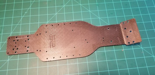

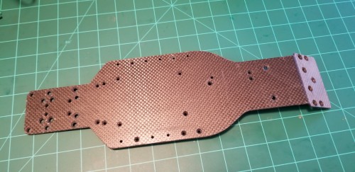

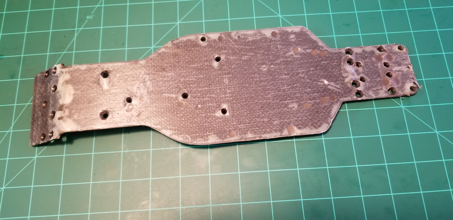

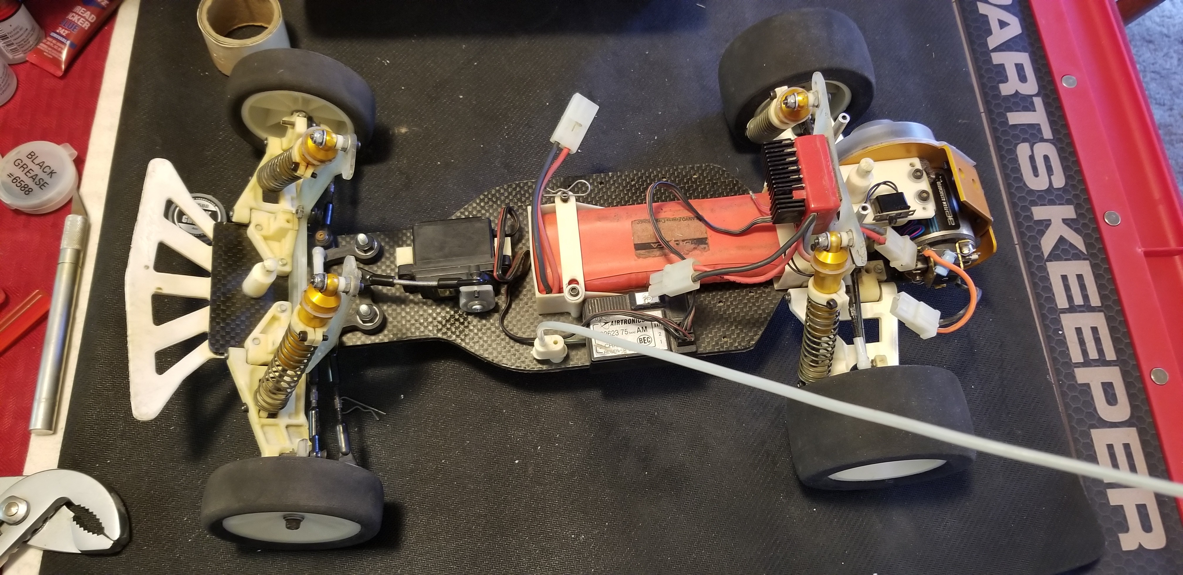

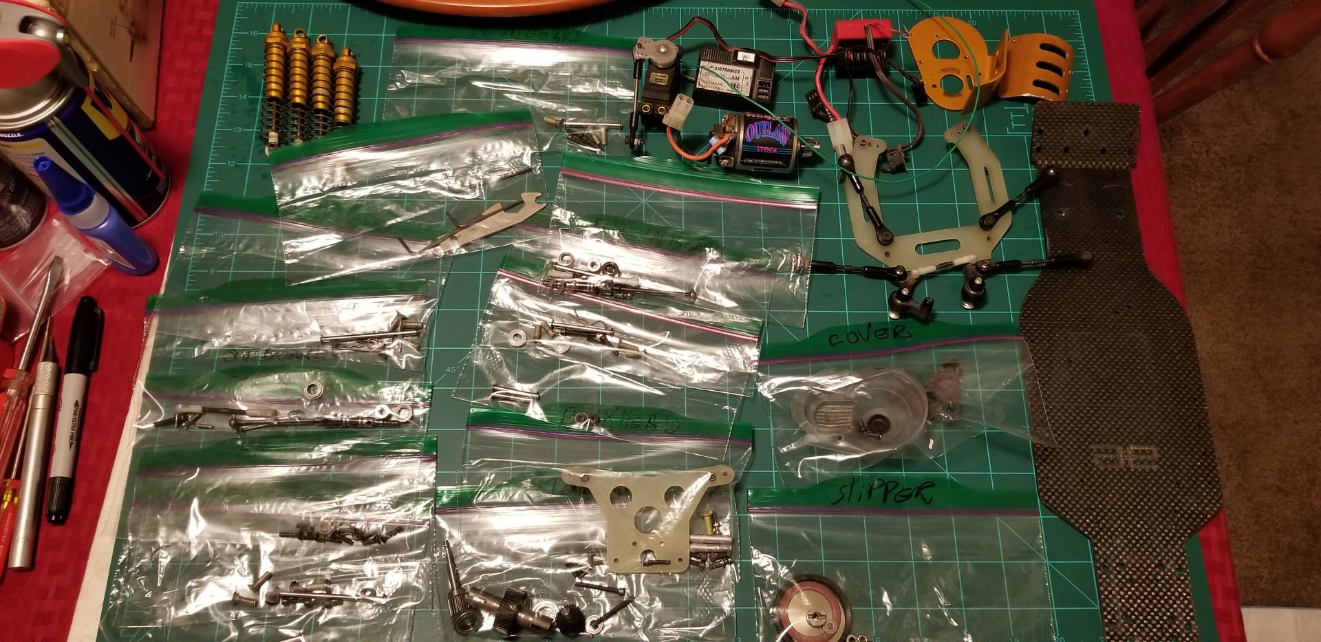

While the barts were baking I gave the old CF chassis some much needed attention. Most of that damage is old but I'm sure I added some skipping it off of a few speed bumps. Yes, I did cut holes in the protective sheet to access the screws. For all the abuse my cars took I was actually pretty serious about basic maintenace and tore down the car frequently to do maintenance and cleaning. I also replaced the front arms at some point. I have no idea why as the old arms were in perfect condition. The only thing I can think of is a saw a package that said RC10 LONG front arms and bought them without realizing they were what I already had.

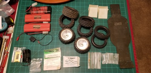

Cleaned off underside. Little marks and lines are residual adheasive from the thick protective sheet. And the top side You'll notice this chassis has countersunk holes for the Stealth transmission. As I noted in my previous post this is the second chassis plate for this car. I bought it because the first plate was starting to delaminate at the leading edge from hard use. That plate does not have countersunk holes. I believe it came with no holes at all. The Stealth tranny came with a bolt on drill guide plate so you could drill your own chassis and I think that is what I did, but I never took the extra step of countersinking them.

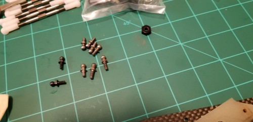

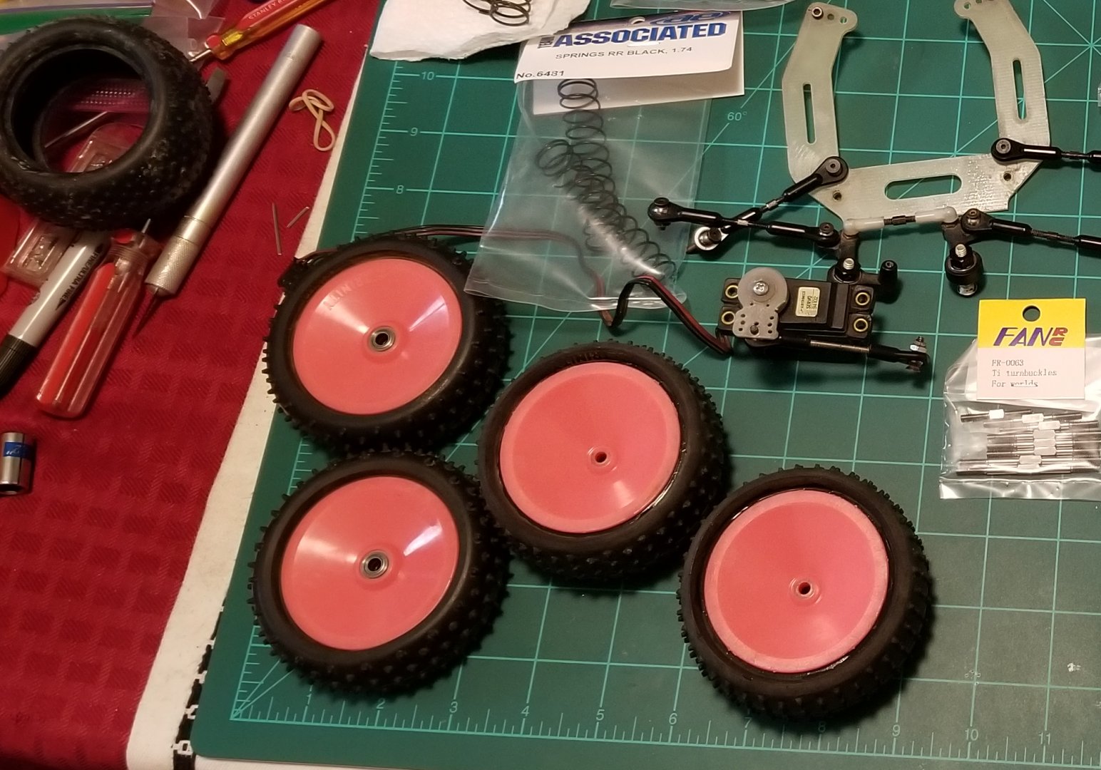

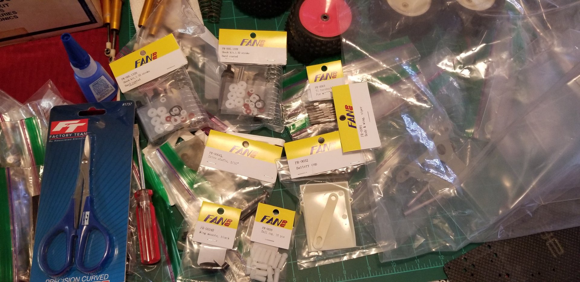

Anyhow, I decided that those black oxide turnbuckles and old aftermarket ball ends needed to go and that my shocks needed a rebuild. Sadly I only had one rebuild kit in my old box and that'll only rebuild two shocks. I searched in vain for rebuild kits and for the proper o-rings but had no luck. I decided to buy some modern repro hard anodized gray shocks. I'd always intended to replace the goldies with the newer style worlds shocks but retired the car before getting around to it.
I did later find that associated still sells the red o-rings and even carries the black FT springs that fit the RC10 rear shocks, but by that point I'd already pulled the trigger on a new set of FANRC shocks. It turns out that the local stocking dealer for FANRC was only 97 miles away in Chandler AZ (Hobby Action Raceway) so I made the drive last weekend and brought back a haul. In restrospect, I should have just ordered the parts online, shipping is cheaper than gas, especially in a 4x4 F150, but Hobby Action is a bit of an RC Mecca and I wanted to see it for myself. [*]Two sets of 1.32" shocks (I run long shocks on truck towers up front)
[*]Titanium turnbuckles because rusty black oxide steel turnbuckles needed to go
[*]Ball cups for the turnbuckles (really nice, the feel crisper and sharper than the orginals but look period correct)
[*]Teardrop wing buttons because I lost the originals. Black because black. You'll see.

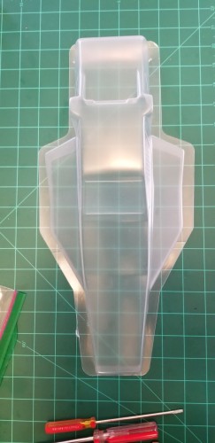

[*]Viper body because I like it better than the Any's bodies I was running and wanted to do something new, clean and classic
[*]A battery box so I don't feel guilty about hacking up a vintage box to fit NiMH batteries. I did force a NiMH pack into my old batter box but it really didn't fit and really stresses the box (I had to remove both battery end covers to make it fit at all)
[*]1.5mm Longer CVD axles. This was a bit of a mistake. The worlds style axles take a smaller diameter bearing and require shims and blue spacers. The bearings might not even fit my hub carriers, in which case I'll need to buy the new 0 degree worlds style hub carriers too. The Grphite came with 1.5 degree toe in hub carriers and 1.5 degree rear arm mounts for a totla of 3 degrees per side.
Reassembly was delayed again when I found that I no longer had a complete set of 4-40 ball ends. I ordered some online but they turned out to be M3, not 4-40. This still worked out okay in the end. M3 is ~5 or 6 thousnadths thicker than 4-40 which will work in Nylon, but I don't know that I'd want to do that anywhere I might switch back to 4-40 later. The threads in 4-40 might not bite firmly after gollowing an M3 screw. My solution was to use the M3 ends in the Houge bellcranks. That gave me enough of the correct length 4-40s to do the rest of the chassis and I will just leave the bellcranks M3 forever. Note that FANRC does sell 4-40 ball studs but Hobby Action was out of stock and I orderd the M3 impulsively.
Looks like I'm out of upload space for this post so next time I'll cover reassembly, the minor disasters I had along the way, various things I tried with mixed success and maybe a pic of the finished viper body.

Custom Works ball studs are also 4-40.

That chassis cleanup looks great. Looks like you're having a good time with it all. And don't fret, there are plenty of impulsive shoppers here.

While I was waiting for the M3 ball studs to come in and perserverating over it I tried to borrow/steal/gank the ball studs from the servo saver in my RC10L onroad car. Like most impromptu auto burglaries this did not go to plan and nobody was better off for it. I tried to pry the ball cup off the ball and its grip was stronger than the servo saver.
It was an utter waste. Those were titanium ball ends that really need to stay on the RC10L. At this point I decided to wait for the M3 ball ends and make do.

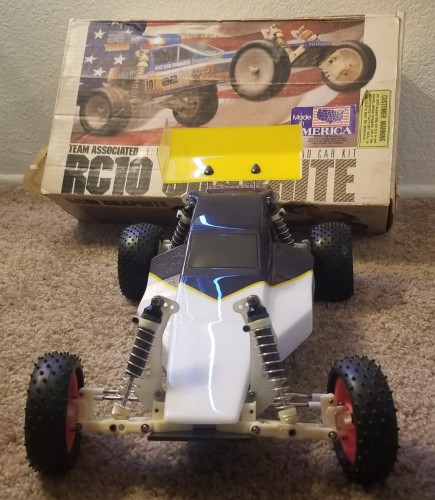

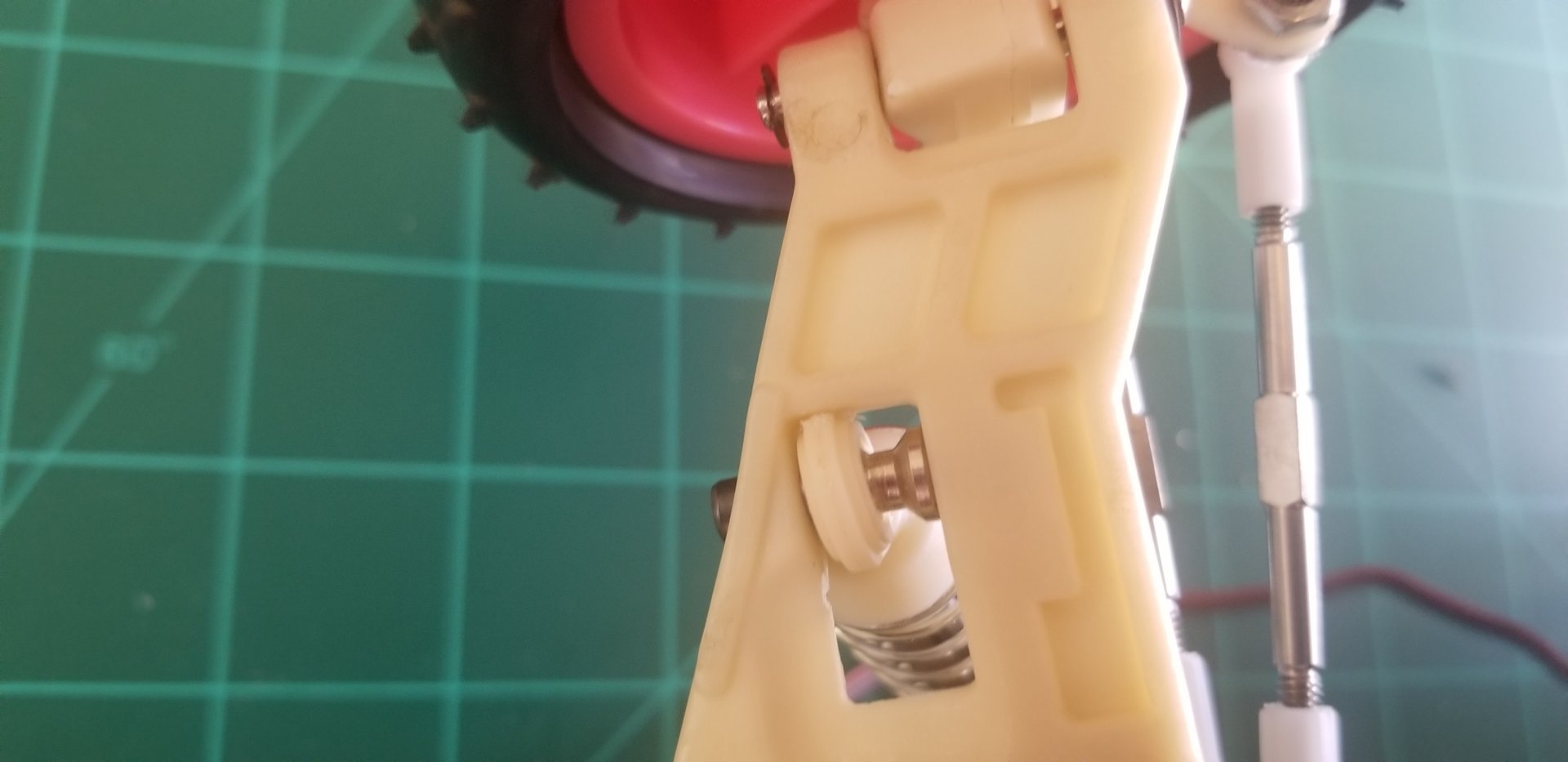

The stretched wheelbase caused me additional issues. The rear arms move back, which moves the lower shock mount position back, but the bulkhead doesn't shift so the upper shock mount is now further forward than the lower shock mount. This puts leverage on the shock and shock tower which gets worse under compression. To resolve this new problem I used longer 1 inch bolts and a pair of nuts as spacers to push the bottom of the shock forward and flipped the
shock bushings and washer around at the top mounting point to bring the upper shock back inline with the bottom. This worked fairly well. And for the top position: One other problem I ran into is that the shock rod ends for the shocks are larger and have a molded ring on them which very slightly interferes with the fron arm in the outer mounting hole. It was not possible to force the bolt through the hole in the pivot ball because it was not aligned with the hole in the arm. I had to slghtly dremel the edge of the shock rod end to get it to fit The M3 ball studs did arrive and I was able to install them as noted in my previous post. So at this point we have a roller. I did the front shock rod dremel Bubba job Saturday night and then got to work on the next stage of the project.

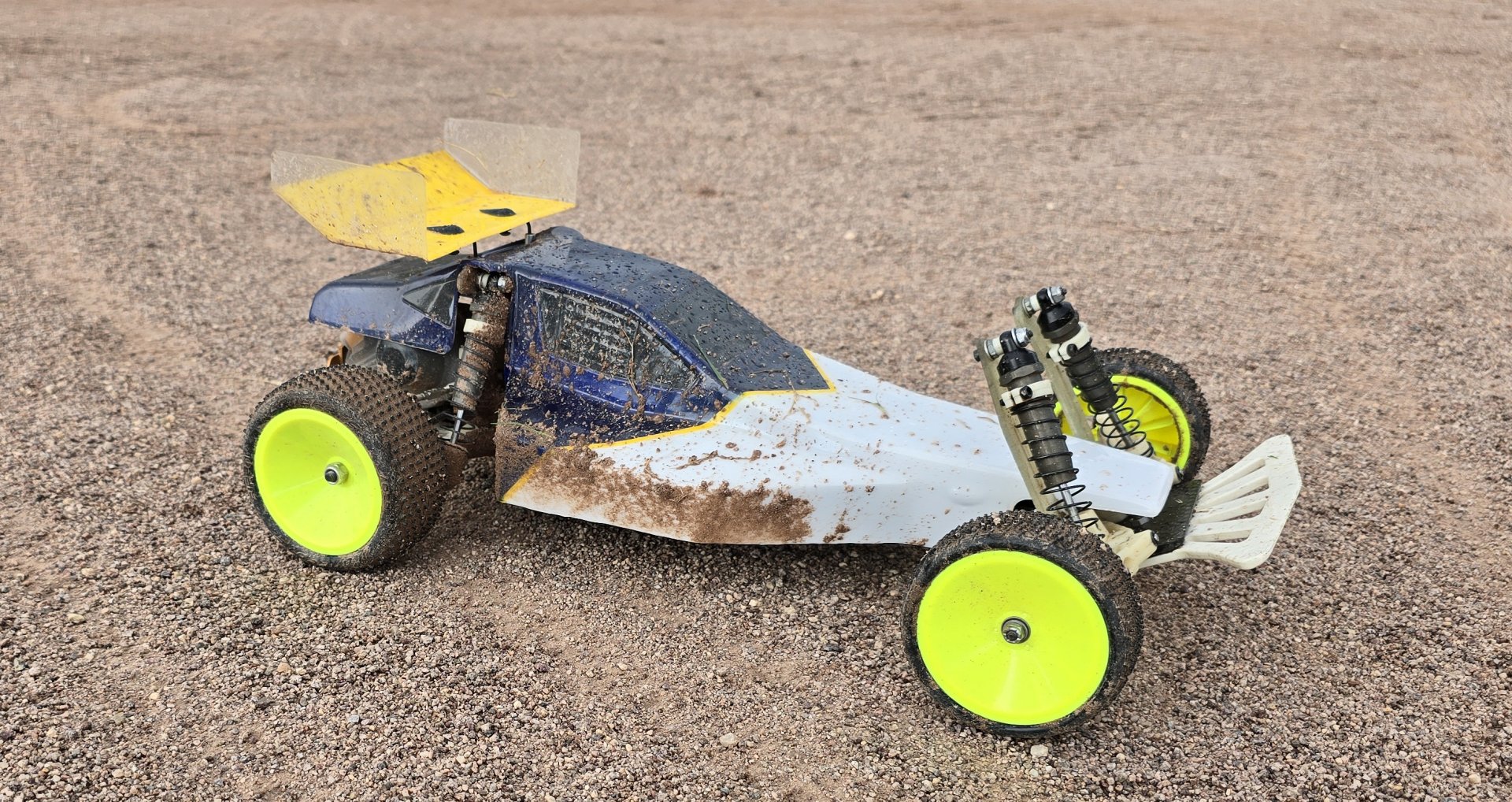

This thing: I spent Saturday night and late into Sunday morning masking, pinstriping and painting this thing. I had never worked with Tamiya masking tape or pinstriping and struggled quite a bit. had a few difficulties along the way and made some mistakes, but managed to get a look that, overall, I'm happy with. Yeah, not monster themed but I had the urge to do something traditional looking. I might still put a monster decal on the nose, but it looks so clean I will probably just leave it as is.
It's clean, hi-vis and you'll always know which way you are going
I still need to get the electronics back in it but it is largely complete and I'm really happy with how it turned out. There were a lot of "Oh Crap!" moments during the rebuild but it was worth it.

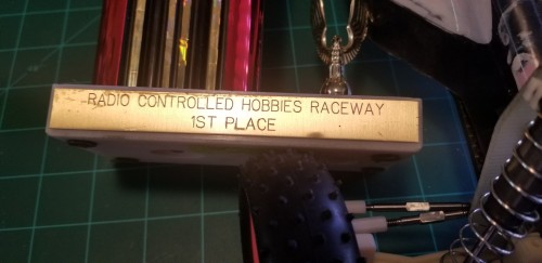

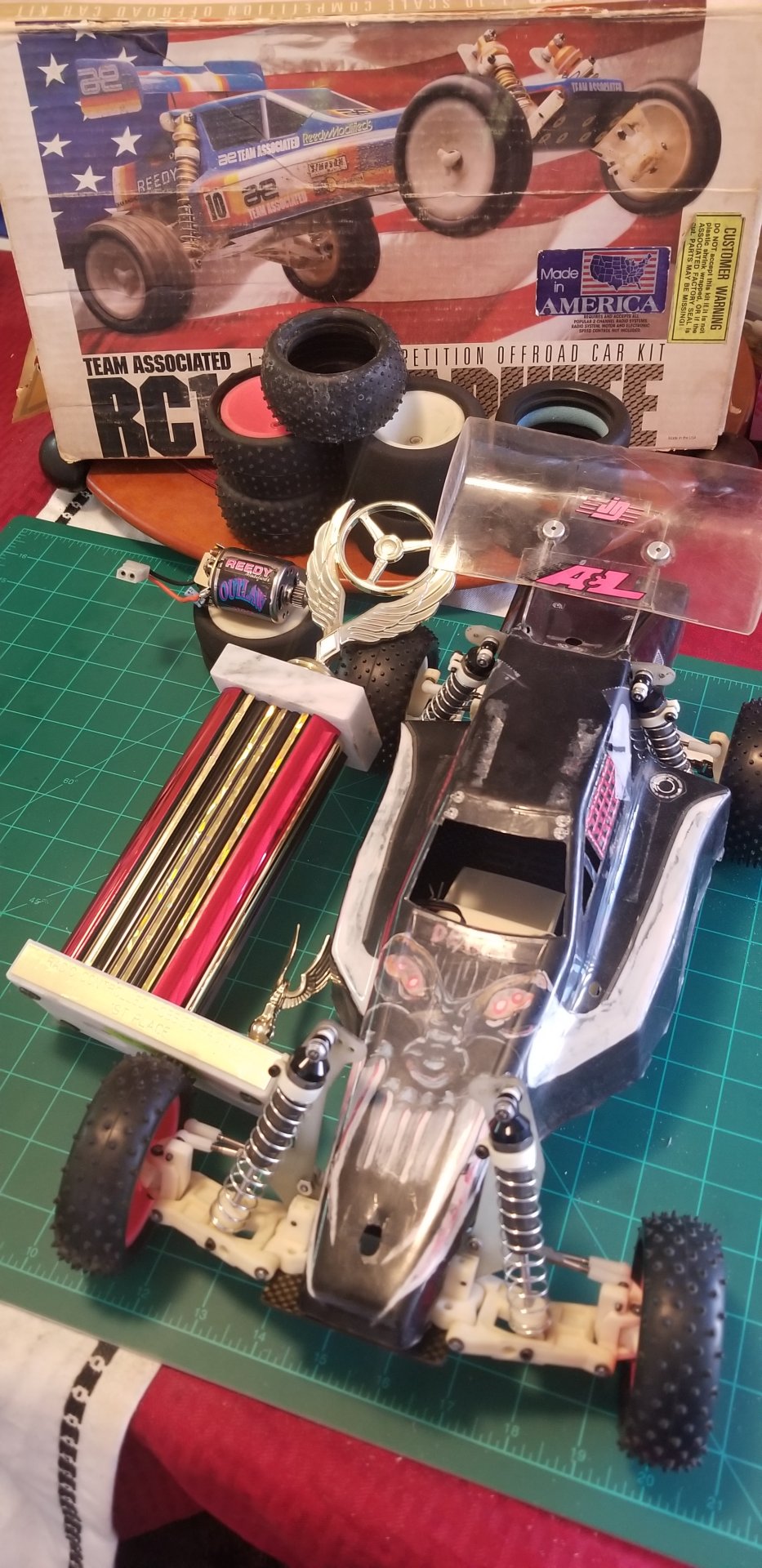

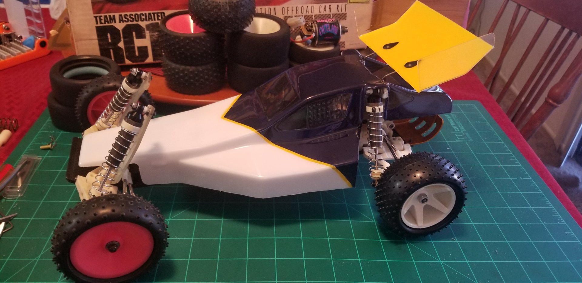

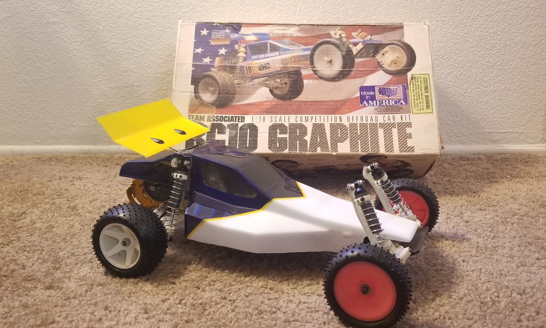

For nostalgia I dressed the buggy up in its race winning livery, or as close an approximation as I can get.
This is pretty much the identical tire and wheel package that I had on the car during its first race. Trinity front wheels and tires (literally the same 30+ year old trinity tires in front). HPI rear rims and Proline R.E.D. tires. I had matching pink Trinity rears but they were sold as 2.2 inch rims and at the time I thought ROAR approved rear wheels had to be 2.o or 2.15 inch or some such. Anyhow I slapped the HPI/Proline combo on the rear just to be safe. I had a monster body on but can't recall if it was this or a previous shell; both were painted by a friend and roughly copied the Motorhead "Rock N' Roll" album cover. The big difference would have been the gold bottom loader shocks.
My memory is a little fuzzy on this, but I was either running a Trinity Revtech or had swapped out to the Reedy Outlaw Stock motor pictured. I think it was the Reedy, because the old revtech had taken a beating and had a loose endbell. It was my first race so I was entered in the Novice class and managed to qualify 3rd. I got jumped at the tone by at least 3 other cars, all of which managed to get in a pile up at the first corner with the second place buggy. I followed P1 around 3/4ths of the track then he made a mistake and flipped over a pipe. That gave me a clean pass and I took the lead and never relinquished it. The only thing I remember after the first lap is that the announcer kept referring to my car as 'that monster buggy'. Anyhow, I won, leading every lap. It was both my first and last novice race. Once you won the novice A-main you had to move up to stock. I was not the most skilled driver and I did not have the fastest car. What I had was a car that was within my capabilities to drive consistently. I drove as clean as I knew how, avoided the first corner pile up and made very few mistakes.
A close up of the trophy Side note, the old RCHR in Costa Mesa was a fantastic track and I was very lucky to live so close to it.
Anynow, enough nostalgia, let's put that shiny new body back on and take some photos

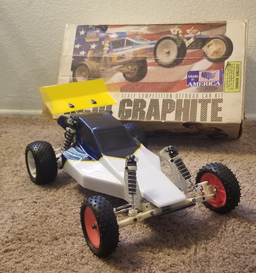

I have to say again how happy I am with the new body. I had a little bleed through in the pinstripes but overall it came out better than I expected. I like it so much I don't think I can stand to punch mounting holes in it. I need to come up with a velcro solution. there are 4 unused pre-countersunk holes along the side of the chassis for mounting a transverse batter box. That should be plenty to hold some kydex tabs and maybe a bit of foam padding. I could form the kydex or just shave the foam to closely follow the sides of the body and use that as once side for the velcro.

Great clean up rebuild, great story, great car.

Update time! What's in the box? (and the old track bag)
I promised a little RC archaeology a while back so let's take a look at what was gathering dust in storage all those years in the original box and my old tote/track bag.
Between the two the track bag was in far worse condition than the box. Various oil bottles had leaked in the bag, ruining it and the packaging of some of the parts - mostly just the paper labels, which made it hard to identify some things. This lead me to buy some things I didn't absolutely need. Anyhow I salvaed the contents and tossed the track bag out it was just some corporate logo giveaway tote.
Here is the end of the box with part number and MSRP - I've posted cover photos previously upthread That was quite a price for a bare kit in 1989. Of course back then we typically had retail markdowns. It probably sold for about $300-ish. Still, a new RC-10B7D kit is only $389, which seems pretty good compared to how much other things have gone up in price.
A look inside the box: tires and wheels, a stealth transmission box many take off and spare parts
what was in that Stealth box? The original six gear transmission was hiding in the stealth box.
Apparently I never throw the boxes away.
Certainly not full ones: Original Proline R.E.D.s, still in the box. Seen mounted on the HPI wheels in previous posts.
I had a second pair mounted up on HPI wheels that were well worn and full decomposed foam liners. Unfortunately I tore the bead on one trying to remove it from the wheel to clean it out. I used an acetone bath but the tire bead became brittle, either from time or acetone or both. I managed to get the other tire off the wheel and slathered it in WD-40 which restored the original pliability nicely, but what am I gonna do with one well worn tire?
Parts from the box and track bag in a couple of dumps so this doesn't get too long
parts dump 1: Three ancient Sanyo Cadnica 1200 mAh packs. All still work but only give about 5 or 6 minutes runtime at best (I don't think they ever did much more even new)
Tires: a pair of front and rear pyramid spike ires, 3-rib fronts and knobby spike rears on chrome look one piece associated wheels.
Replacement long rear and short front shock shafts
spare battery boxes (no idea why I have these)
The original CF chassis plate. The front corners delaminated and curled up slightly. I sealed them back together with CA, which worked fine, but I bought another chassis plate anyway and a couple bumpers
Airtronics battery box, 75 MHz radio flag, some 27MHz crystals (I have a second Airtronics XL-2P in 27MHz)
Reedy and Trinity/RevTech motor package notes.
Parts dump 2: Original gold shorty front shocks.
One good front shock tower and the remains of a second. Not pictured a third tower which was bent, but not quite broken. As noted above the buggy now sports RC-10T front towers and 1.32 shocks
The take off battery box from the buggy, I'm using a FANRC part instead because I needed to hack one up a bit to fit NiMH batteries and didn't want to hack up a vintage part.
More Associated one piece wheels, more fairly worn pyramid spike tires and some Losi
fronts (I needed something with more bite than 3-ribs okay?)
Vintage decals - these may have come from my RC-10L kit.
Take off parts. Sadly one of the rear hubs is cracked through the hing pin hole.
2 broken front towers and a broken rear hub - that's a lot of hard use. Strangely the long truck towers never broke even though they are much longer and you'd think they'd be easier to snap.

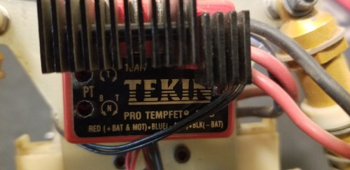

Still in the buggy when I found it were the Tekin Pro Tempfet 300 ESC and a Reedy Outlaw stock motor (note the lack of MR on the label. This was probably an early motor). The ESC has very little to identify it, but I found the manual that came with it and can scan it if anyone is interested. I think it's still available online from Tekin as a PDF though. While I was rebuilding the buggy I found a lone shock rebuild kit in my box; that's enough to rebuild two shocks. Those kits are no longer made, The plastic bits are fairly reuseable but the O-rings really need to be replaced. I had no luck initially finding the correct O-rings. I've since found Associated part 5407 which looks like it would work, but at the time I couldn't find the right size anywhere. This gave me an excuse to buy the FANRC hard anodiaed style shocks. This was what I had wanted to put on my RC-10 decades ago but had never done.
Shortly after receiving those shocks I found a second rebuild kit, missing the oil soaked label, in my track bag The shocks were $72 for two pair so I'm a bit torn on this. I did get the hard anodized shocks I wanted, but I could've rebuilt the goldies for free.
Oh, can't forget these bits - the AstroFlight charger and Airtronics XL 2P 75MHz remote. As I noted I also have the 27MHz, but I only have one battery holder between the two of them - long story but I tossed one battery holder out in 2017 when packing to move.

I decided I needed something better than the vintage 75MHz Airtronics if I'm going to drive the buggy and thought 'buy once, cry once', so:
I added the Flysky FS-CVT01 i-bus voltage sensor so I can monitor my lipo battery charge since the vintage Tekin ESC has no low voltage cut off.
I finally got all the bits to fit the 3/16th" axles and Jconcepts wheels and have taken the buggy out to the park a few times
I finally shot a little video of the buggy runninng too. I haven't reviewed or edited it yet, but if it's decent I'll post some short clips.
