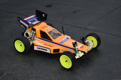

jonboy
Posts: 58
Joined: Fri Jul 14, 2023 12:41 pm
Location: S. Wales
Has thanked: 10 times
Been thanked: 14 times
Re: Fan RC FR-01
Post by jonboy »
Hi Guys than Fan RC is running real good .. CA'd bell cranks N diff is smooth cracking bit of kit.. bit of mockery with AE stickers :P got an under tray fitted too from penguin .. " I think"
Rc10812
Posts: 66
Joined: Tue Jul 02, 2024 8:33 pm
Has thanked: 31 times
Been thanked: 11 times
Re: Fan RC FR-01
Post by Rc10812 »
Really nice looking piece. Great paint job.
