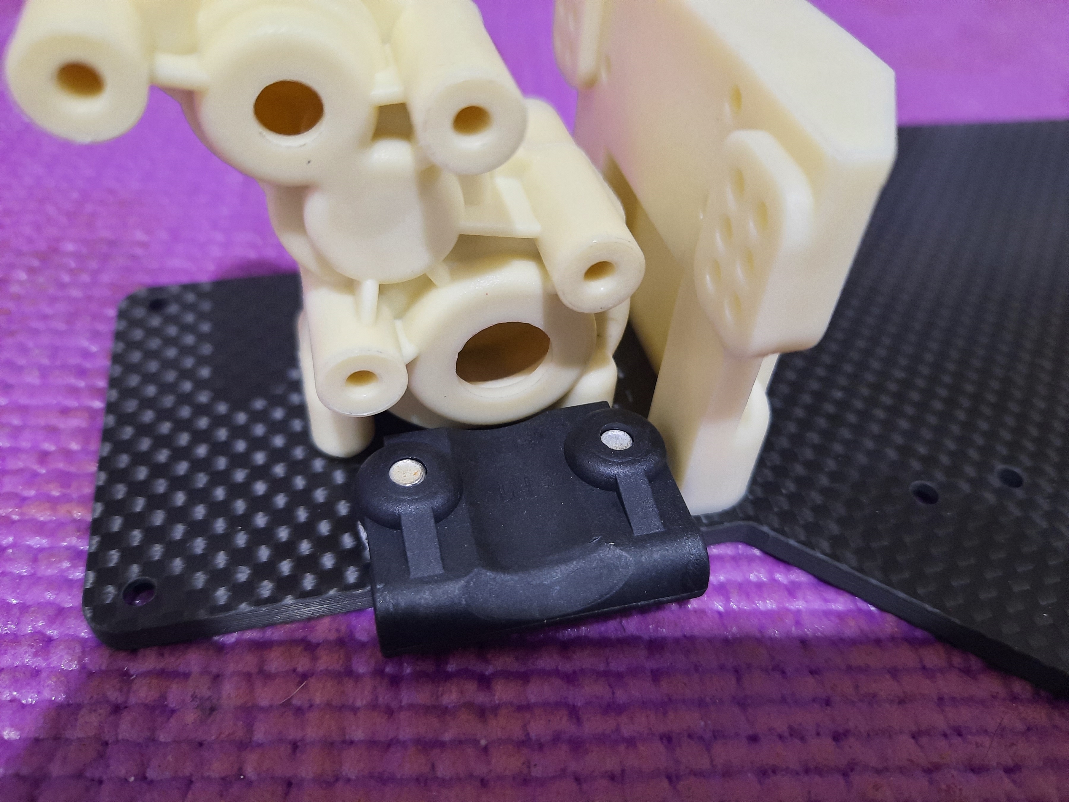

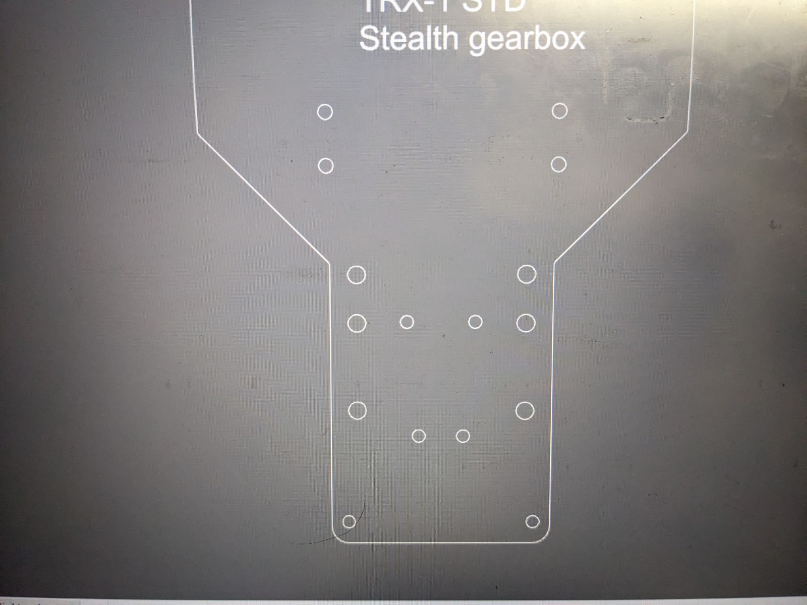

This project will use the Bezerk carbon chassis modified for a "Stealth" transmission. Having recently finished rebuilding a Team Car, I took some measurements and tested a few things to see if it would work. An overlay of the RC10 Graphite chassis was used to check all the hole positions.
The Stealth holes were moved back 4.5mm to get the outdrives inline over the centre of the arm mounts and to not foul the bulkhead. It looks to be in roughly the same position as the pro transmission in terms of weight distribution. On the original tranny, the casing slots into the bulkhead. I'll need a longer trans brace to the bulkhead.
The motor guard holes were also moved back. With the standard bloody gap between the guard and motor plate I thought this wouldn't be necessary. With hindsight...yes.
I mocked the rear end up.
Look's like I'll need to tap some holes. Scr8p mentioned somewhere that Cliff went around bending up the back of the tubs at the 93' World's for extra clearance. I was a bit worried with the longer arse on the thing.

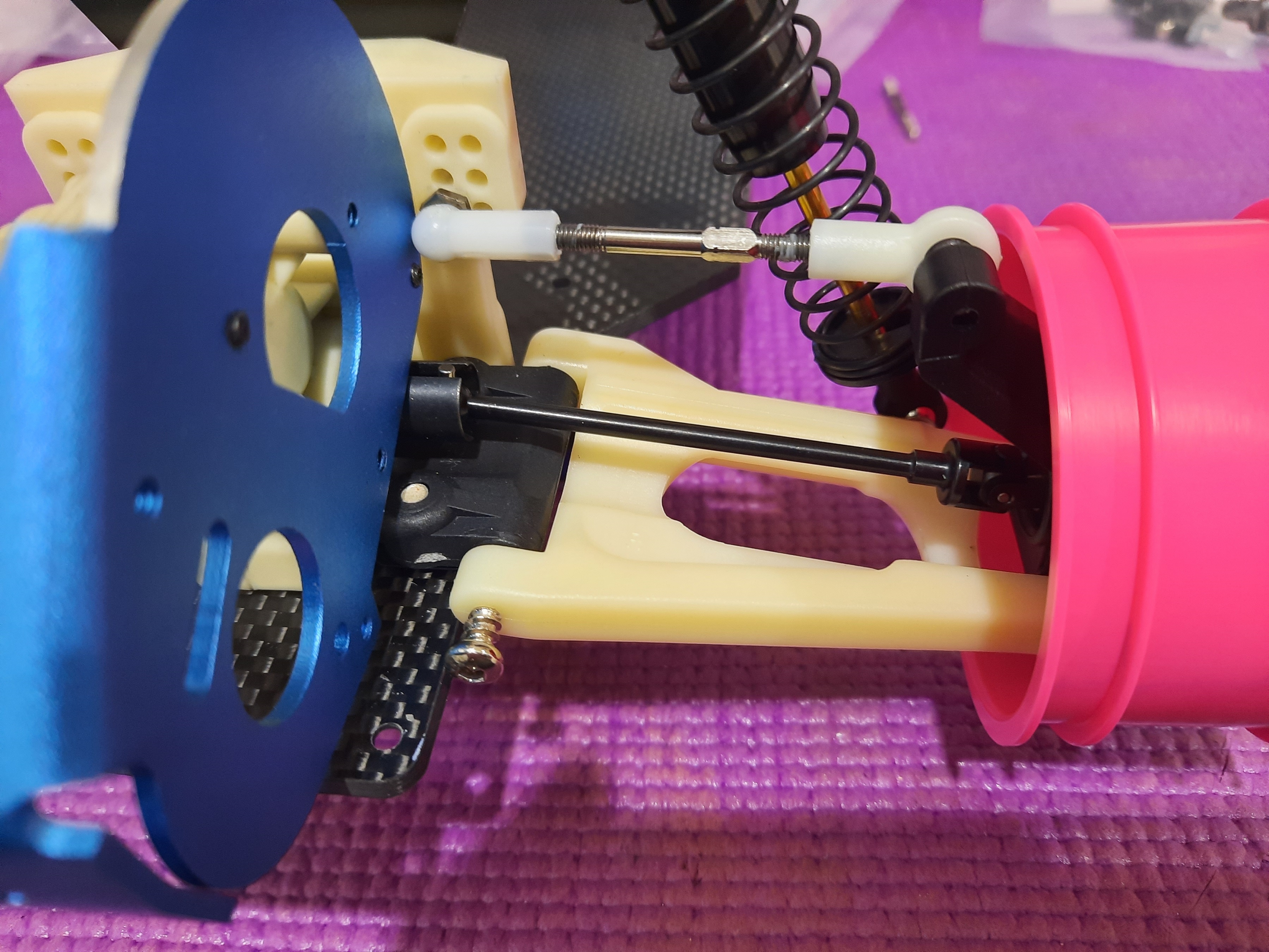

Of course, there's also the right side inner camber link mount fouling on the spur cover. I was planning on using Yokomo rod ends - well, not here.

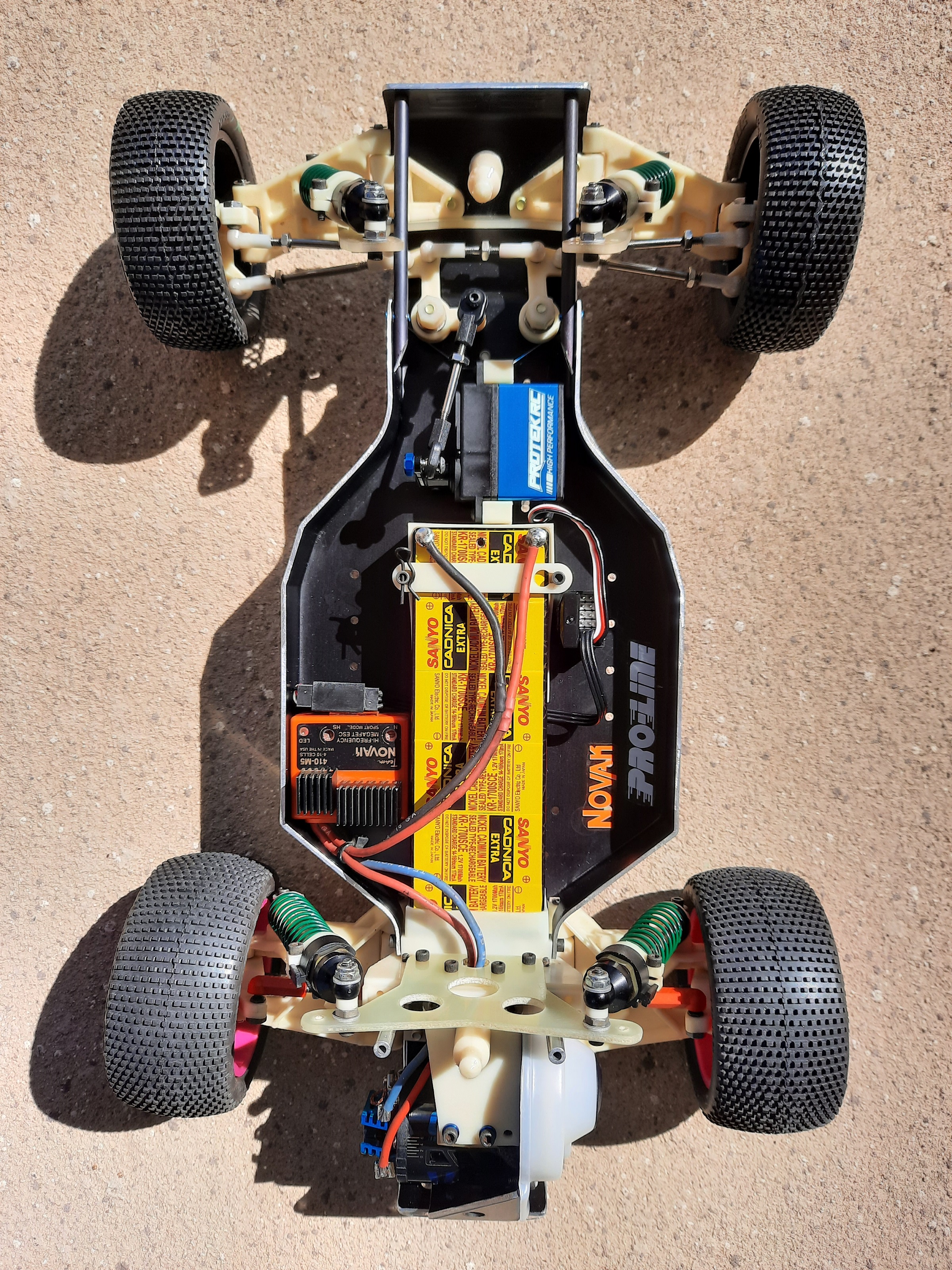

I don’t quite get what you’re building here. A TRX1 with a stealth transmission? Or an RC10 with Traxxas rear arms?
I’m guessing the last picture is not your vehicle?

Chewbacca wrote: Tue Sep 17, 2024 4:26 pm I’m guessing the last picture is not your vehicle?
That's my Team Car.

Back end's done.
Quite a bit of fettling with the printed parts. The hinge pin holes were 3mm instead of 1/8" (3.18mm), so I had to ream those. The 5x11x4mm bearings wouldn't fit without some work. Traxxas rear arm mounts needed minor dremeling for outdrive clearance.
