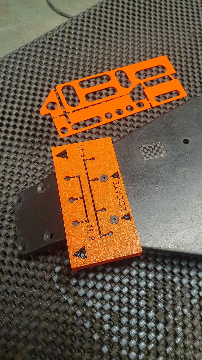

A couple of weeks ago the kit arrived. I ordered the kit including the “hybrid chassis" containing a carbon lower part of the chassis and an upper 3D printed part.

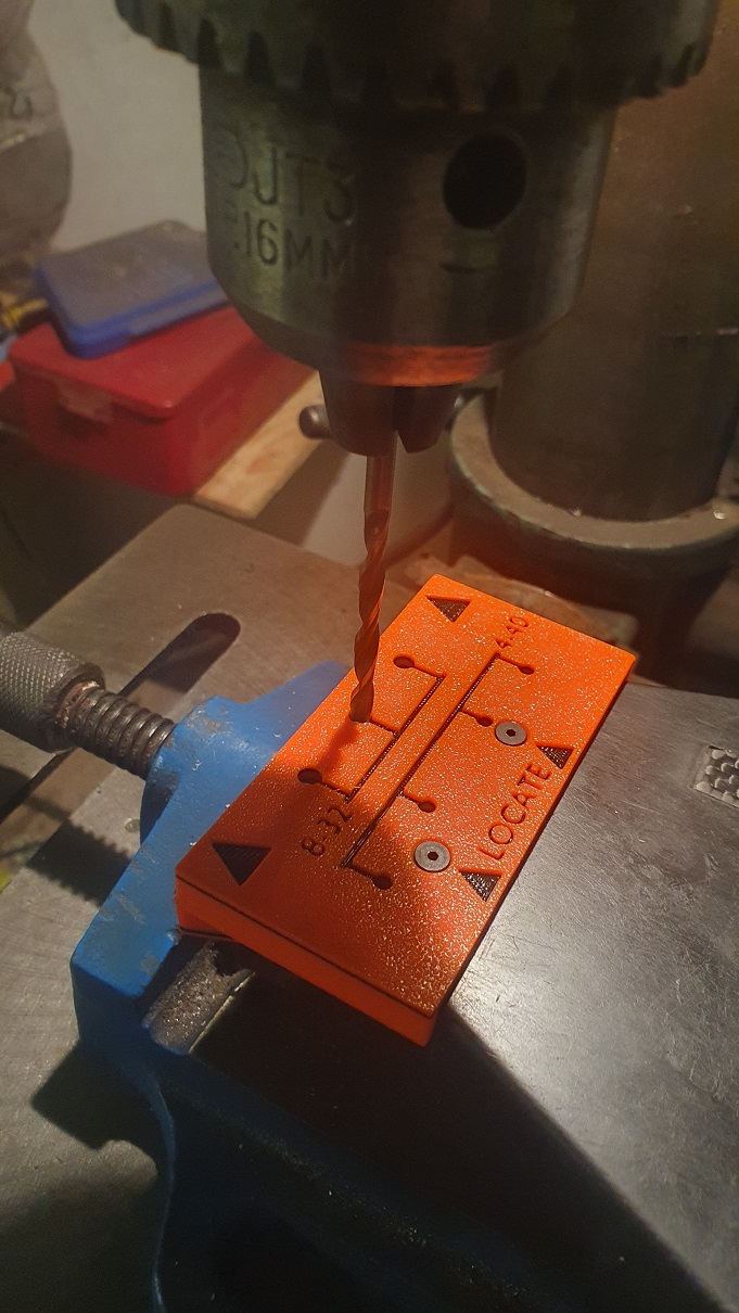

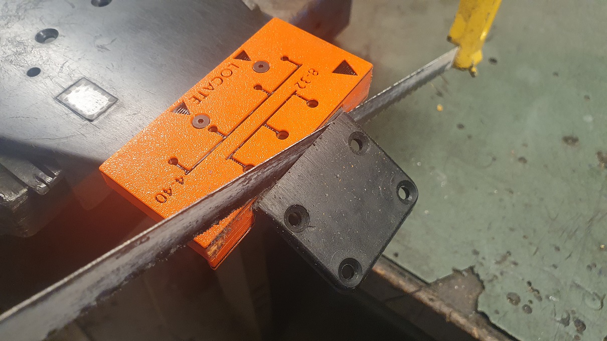

Included in the kit was also templates to use for modifying a molded chassis. I have a well used Junior 2 spare chassis that I can use so I decided to go that route.
It took a couple of deep breaths before I picked up the hacksaw and started to cut into the chassis. :lol:
The templates are also a guide for drilling.

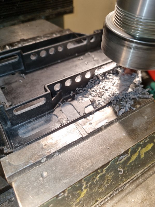

The chassis is now left with my brother for machining, I just got this picture from him:
I have been waiting since 1991 to build one of these, so I´m going to enjoy myself and allow this build to take its time.

Quick update.
Chassis machining not finished due to the machine is being moved.
Gearbox housing have been modified by removing the attachment points for truck body mount.

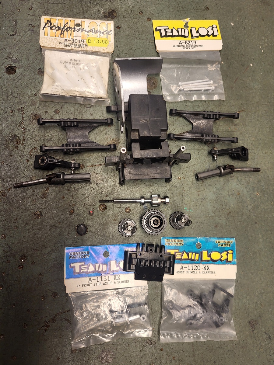

All hardware is being cleaned right now.
I have collected everything I need besides the original "short" ball cups.
Most of the collected parts are used. This combined with that I ordered spare chassis hinges, steering arms and front arms from GP3D means I plan to run the car when it´s finished.

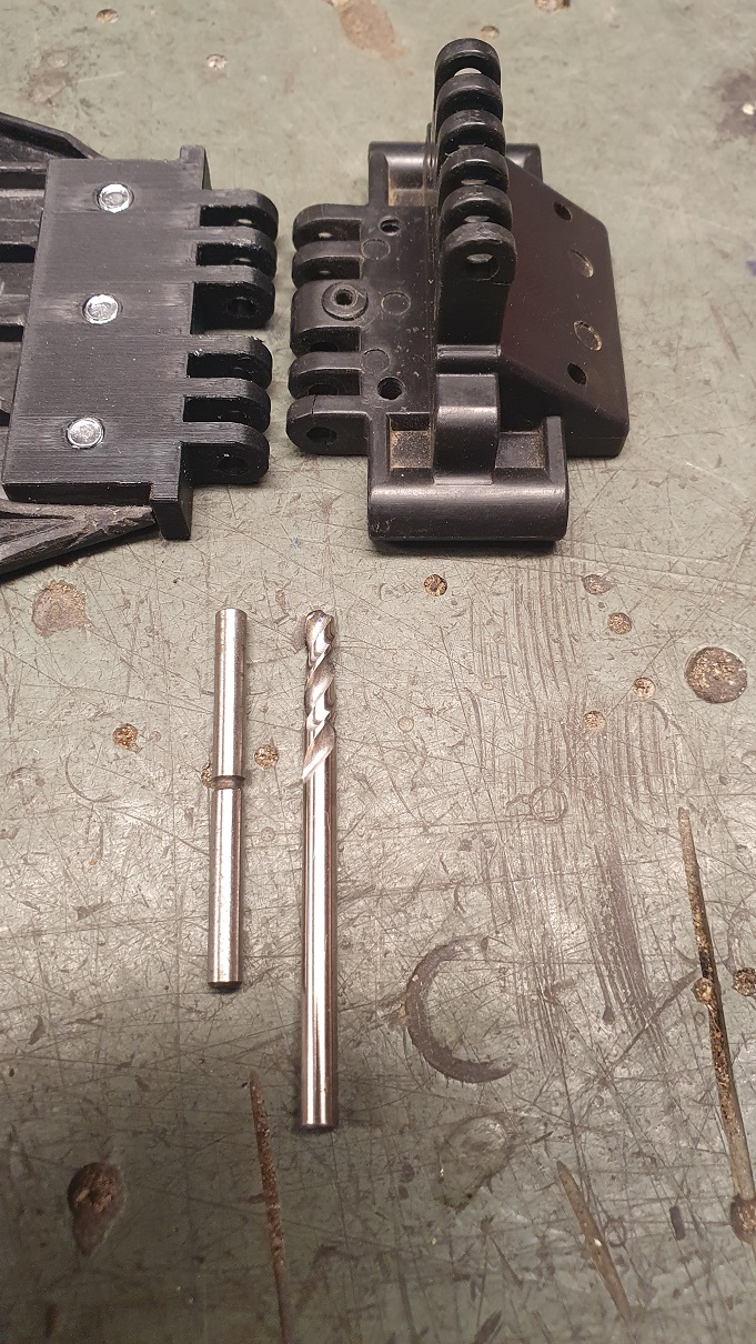

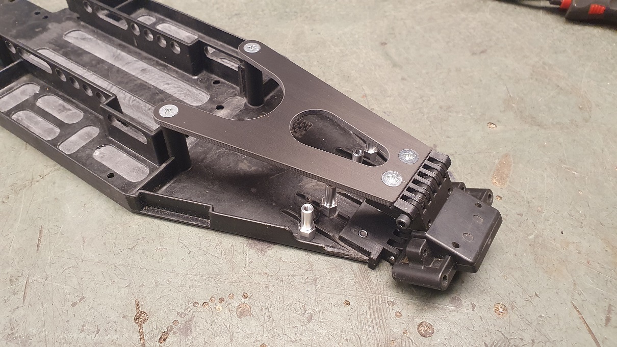

Chassis in now back from machining!
Made a quick testfit of front parts and it fits very nice.
Carbon from Bezerk is perfect!
Also, for us that are in the metric world...a 3.2mm pop rivet drill works great for clearing 1/8" (3.175mm) holes.
//Johan

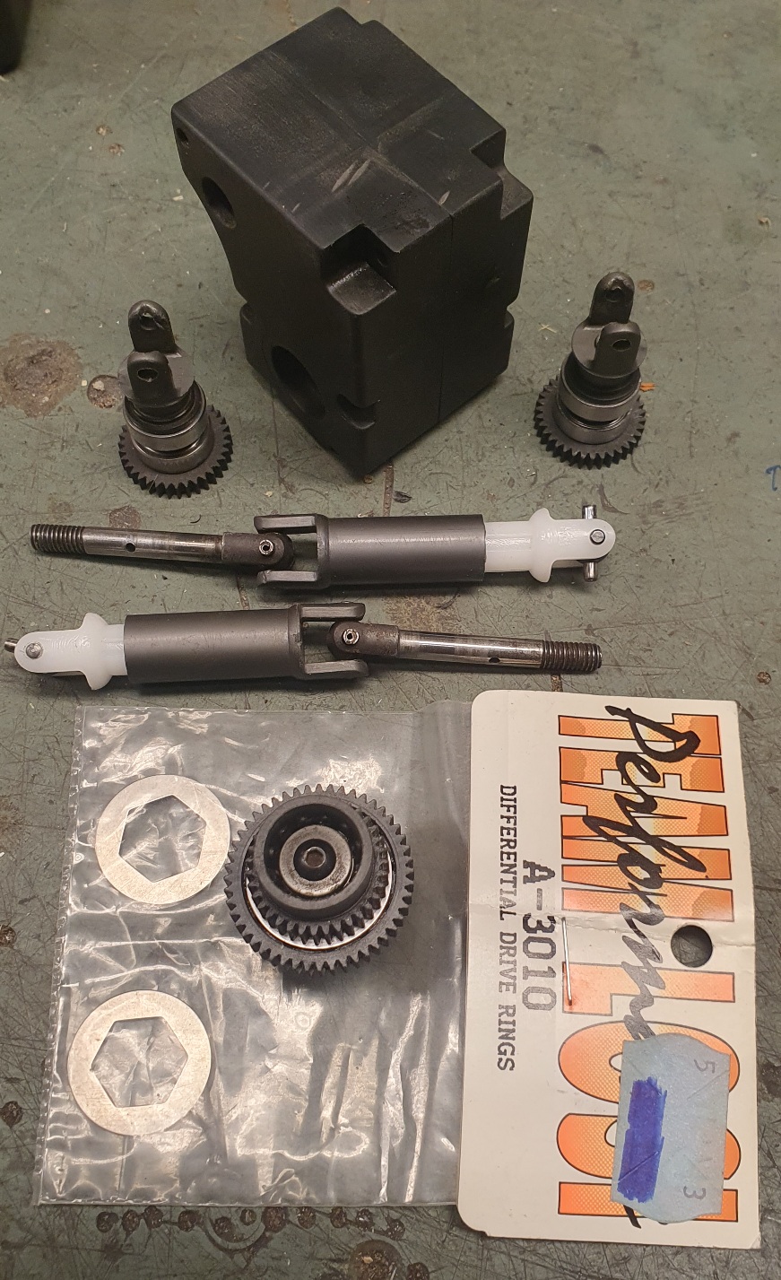

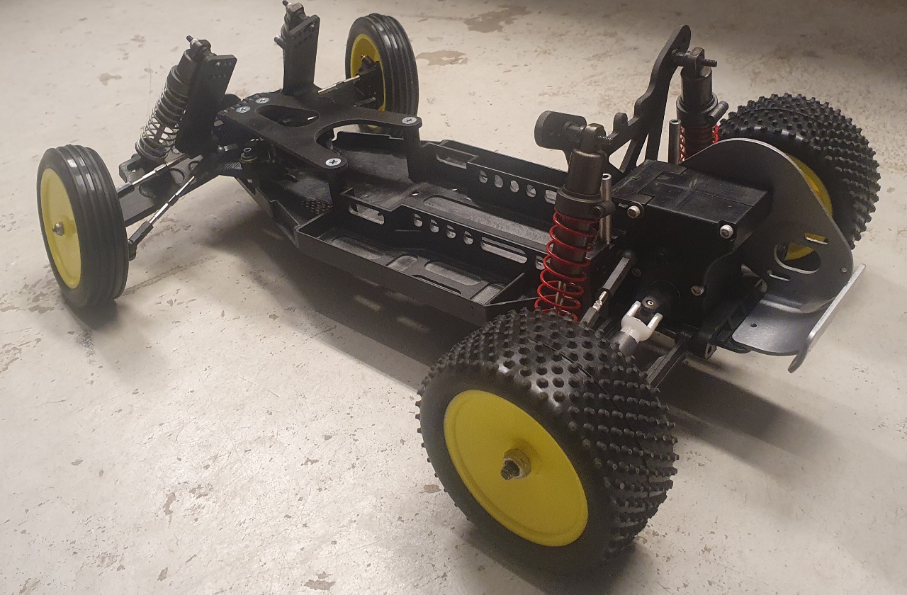

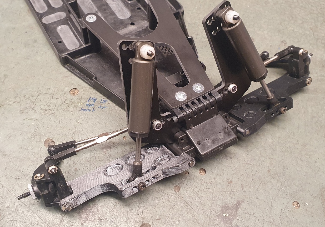

Had a couple of hours free time yesterday. :)

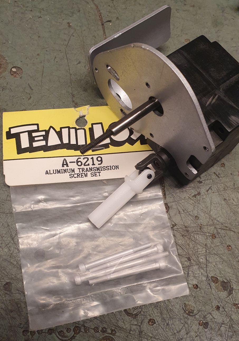

Reassembled the gearbox with new diff washers and diff balls. Mounted the sliders using new inner halves in white plastic.
Also used the set of alu gearbox screws I had.

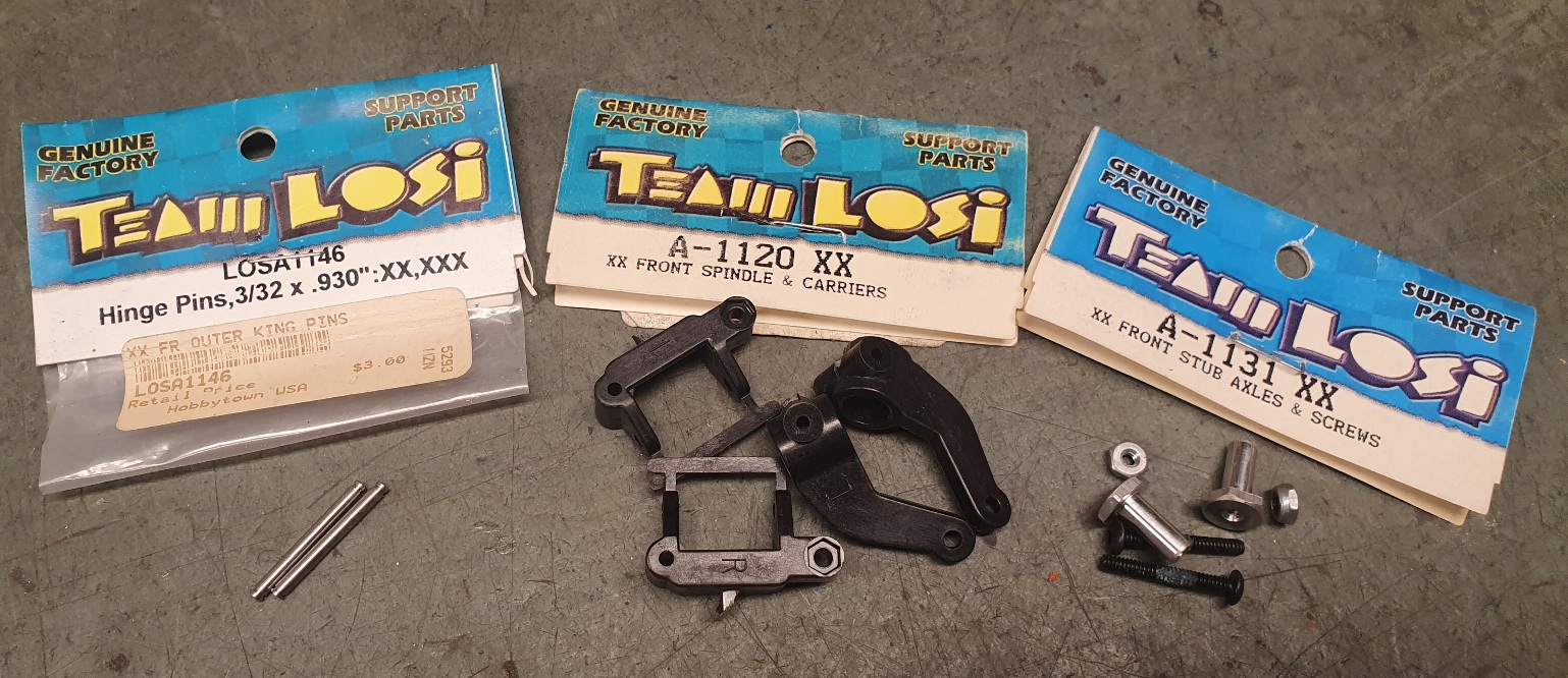

Continued assembly of the front end. Some light filing on the arms but that's it.
All new components for the spindles.
//Johan

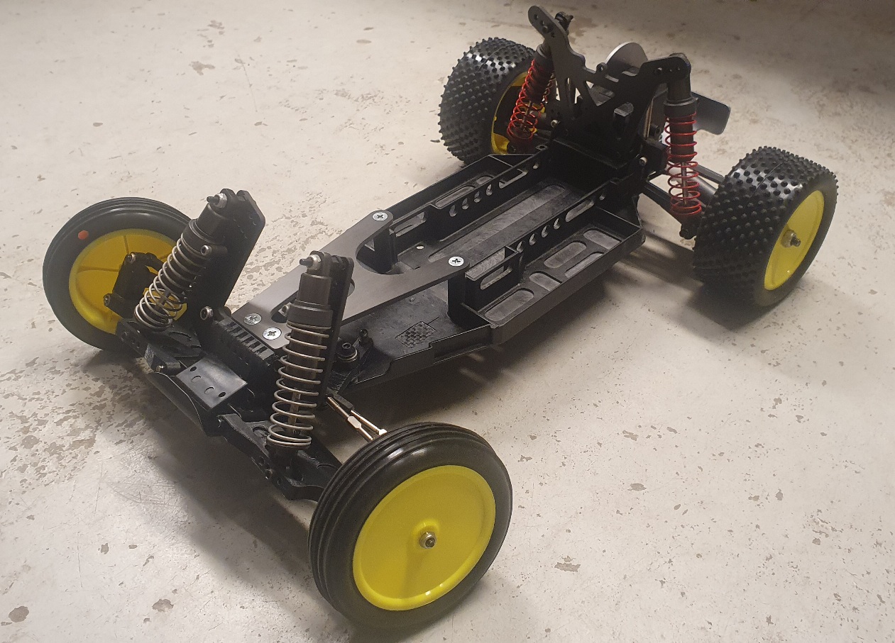

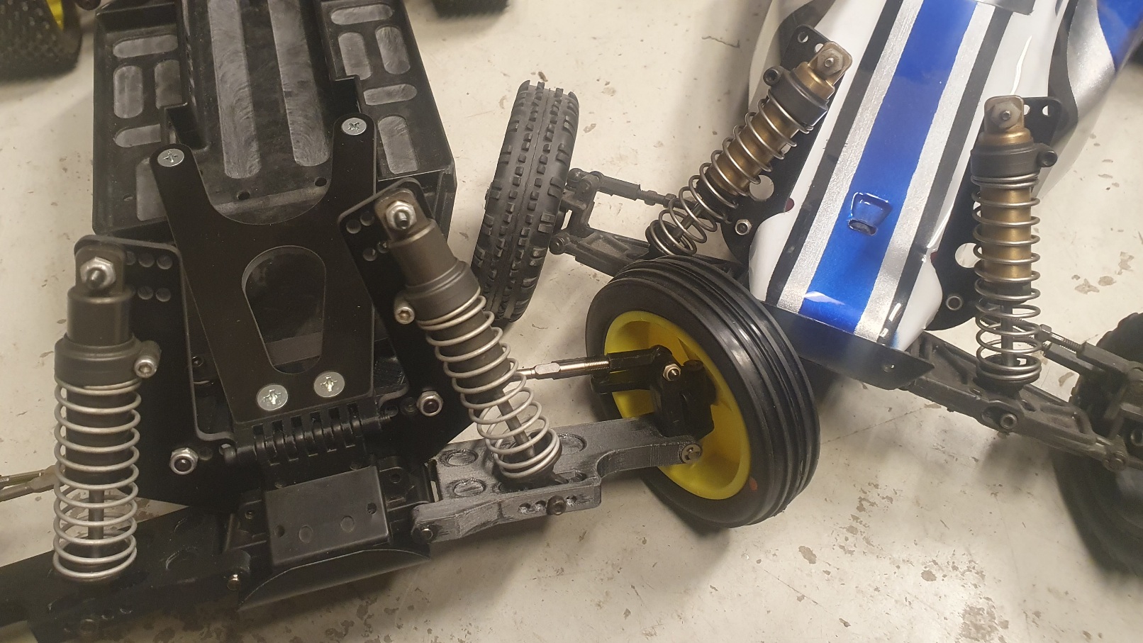

I'm in the process of finding the right stuff to put on the car.
I do have a set of the original gold/bronze hard anodized front shocks on my JRX-Pro. But they belong to that car so they will stay there. I chose to use a set of the darker shocks from one of my xxxt:s.
I just had to put some wheels on it to see what it will look like. 8)
//Johan

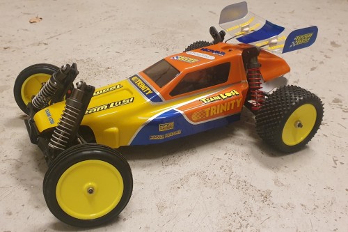

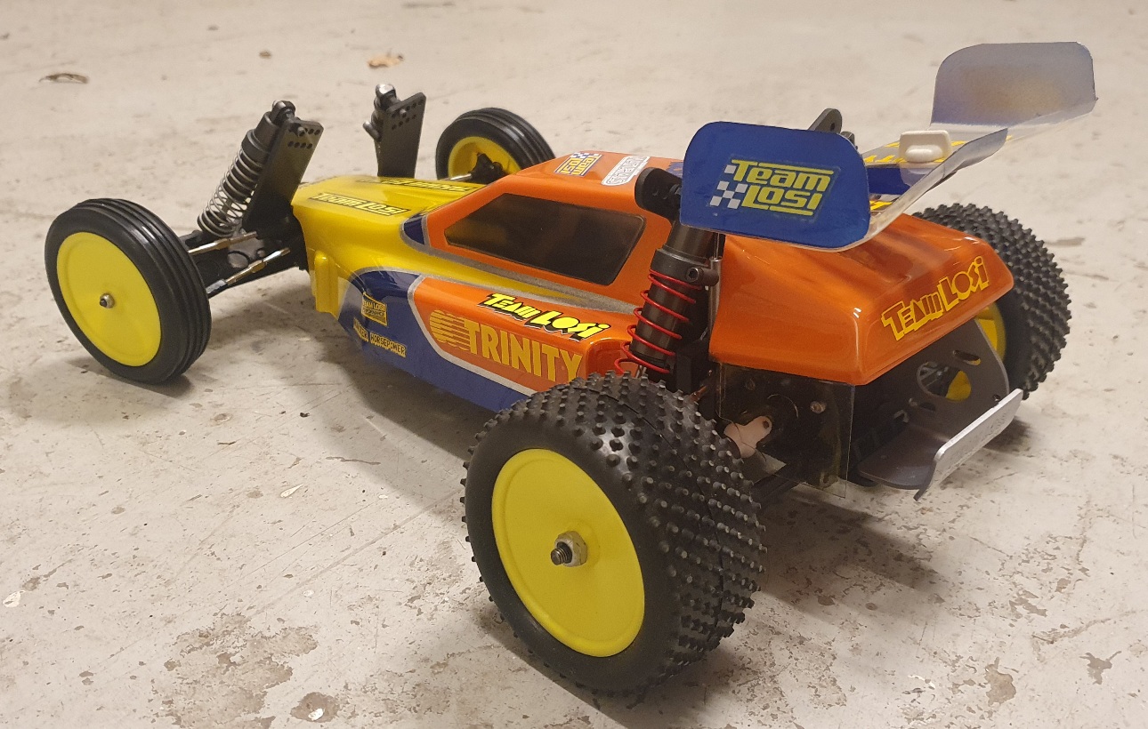

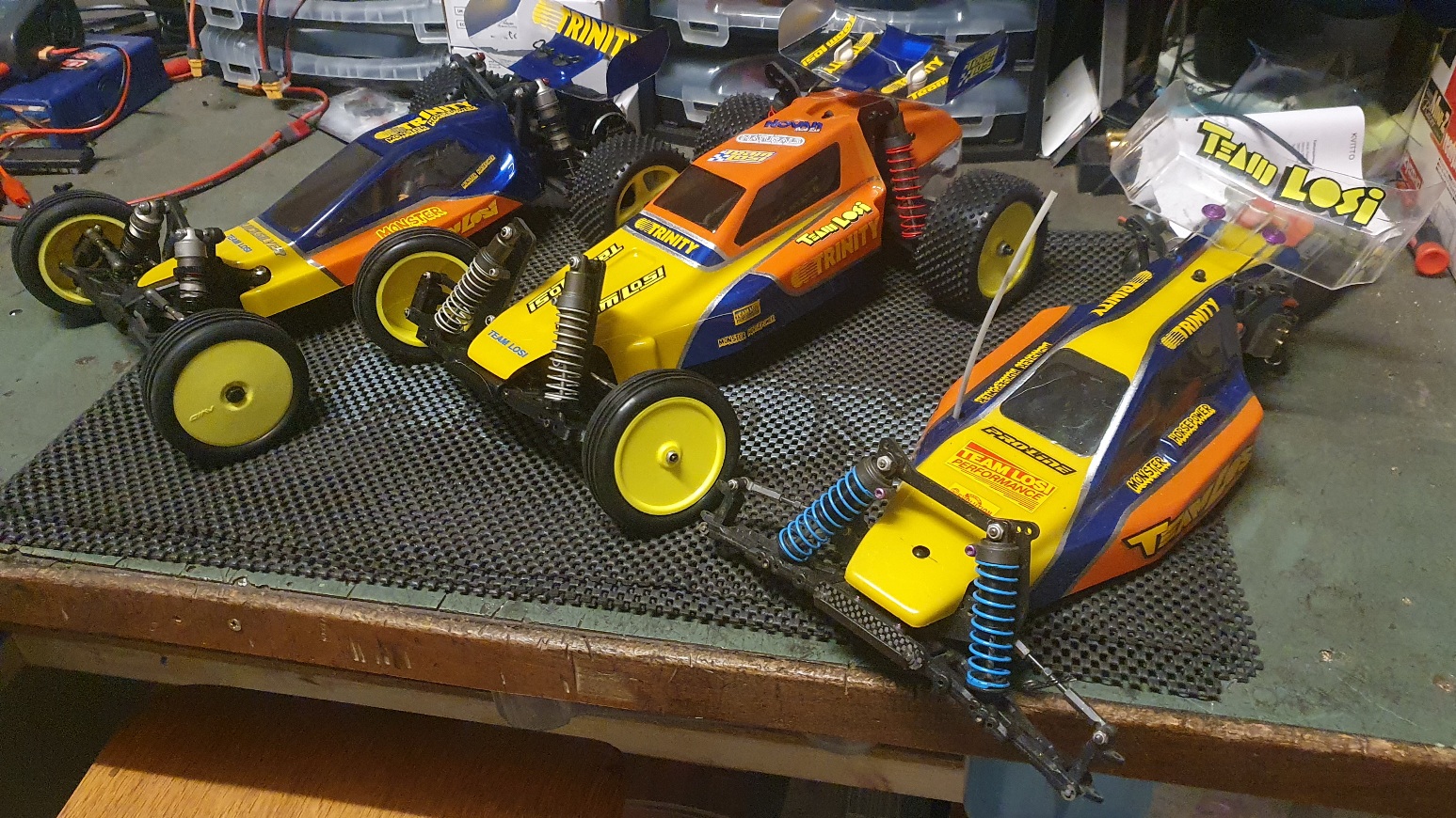

Took the opportunity to paint up a body while I had the workshop heated.
Went for the Joel Johnson pattern but using my current colors.
I put Trinity stickers on. But then realized I don't have a period correct Trinity to use. :oops:
Might go for a slightly newer brushed Trinity Ex-tech or one of my Peak Performance motors.
//Johan

Very nice! I like that paint job as well. Is that an original pro se body?
Johanp
Posts: 148
Joined: Sun Jun 28, 2020 3:15 pm
Location: Sweden
Has thanked: 117 times
Been thanked: 243 times
Re: 1991 Detroit Losi prototype – tribute car.
Post by Johanp »
mikea96 wrote: Tue Jan 07, 2025 10:38 am Very nice! I like that paint job as well.
Thanks! :)
I have a couple of variants using these colors.
My rear motor 22 "1.5" runner, the '91 Worlds and my runner XX (ongoing "cr" update, hence no front spindles and no rear end).
mikea96 wrote: Tue Jan 07, 2025 10:38 am Is that an original pro se body?
It's a Team Bluegroove Pro SE body.
I get most of my bodys from TBG and they fit great.
//Johan
