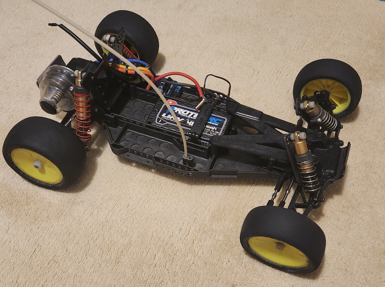

Little more done, still hunting for the Jr2 arms and some Losi xx/xxx era springs. I'll have some Factory Works towers, chassis brace and steering on it pretty soon. Should have a 21.5 setup in a few weeks. Paint this weekend
Put the Losi 2021/2038 hubs in for better wheel clearance over the Jrx2 hubs, which are period correct either way

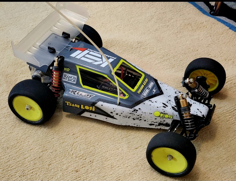

My VONATS paint transferred over the the JRX Pro body pretty well, of course I made the windows twice their molded size-
The problem is the Flourescent yellow Losi decals I have are too small....and so I'm going to put off what I'm going to do eventually...
But I do hate cutting into an uncut original sheet

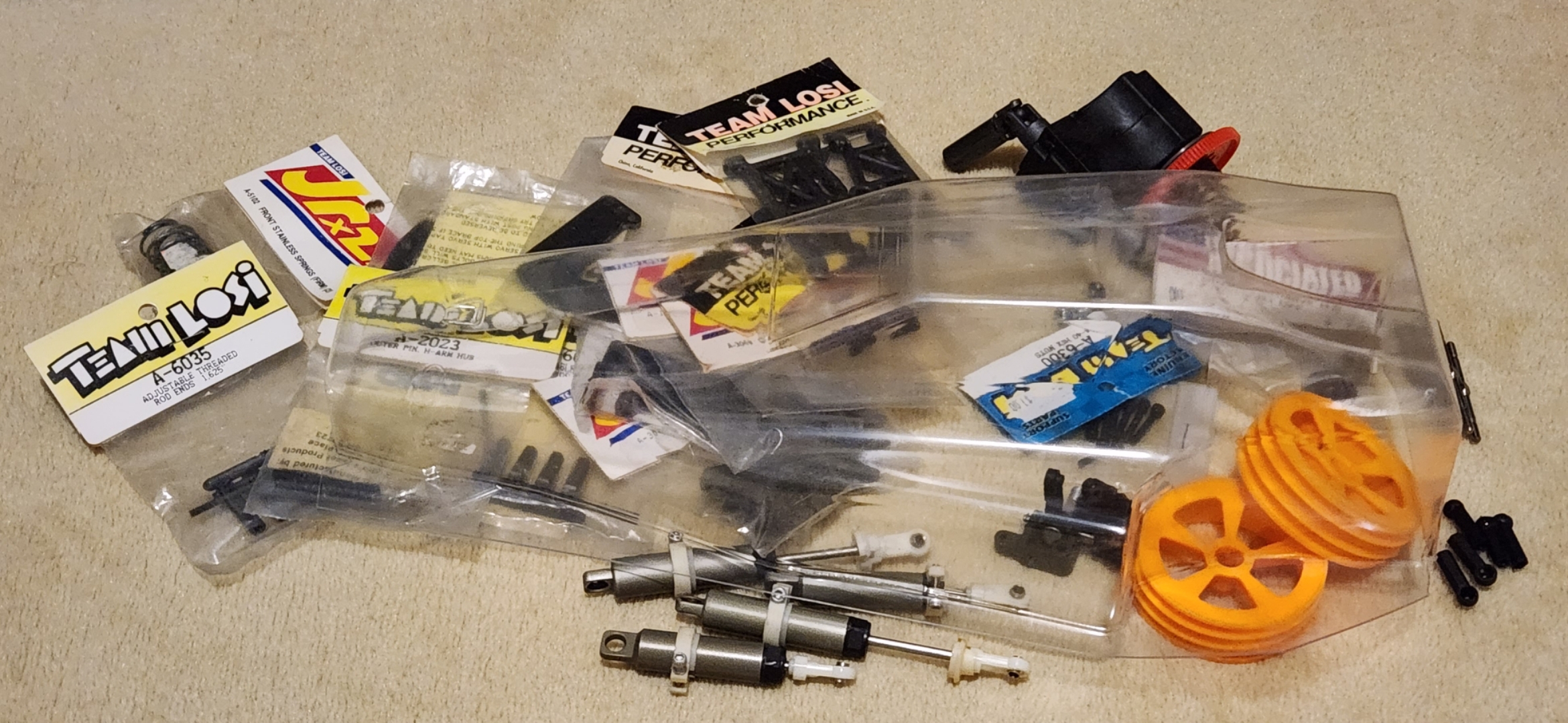

Just a little more. Mounted some fresh tires to break in, thanks to Teshreve I have 99% of the springs and extra shocks I was looking for (like to be able to just swap entire shock packages into the car during testing). Still have more to go

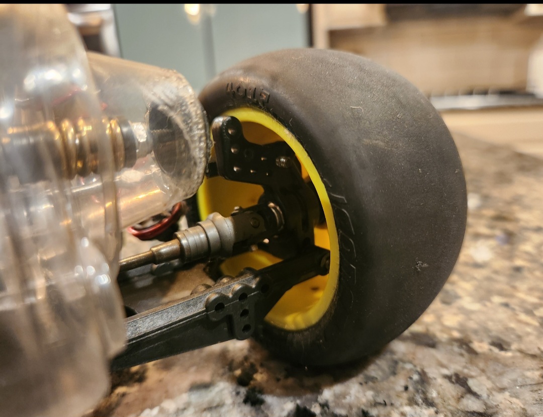

Jconcepts Mono 2.2 RC10 bearing front, Jconcepts Mono B6 rear with 8mm wide clamping hexes.
Shakes out with stock geometry in the rear, width adjustable by 1/8" up front using the Custom Works +/- inline axels which have always been perfect copies of Losi alumminium Jrx series axels!
