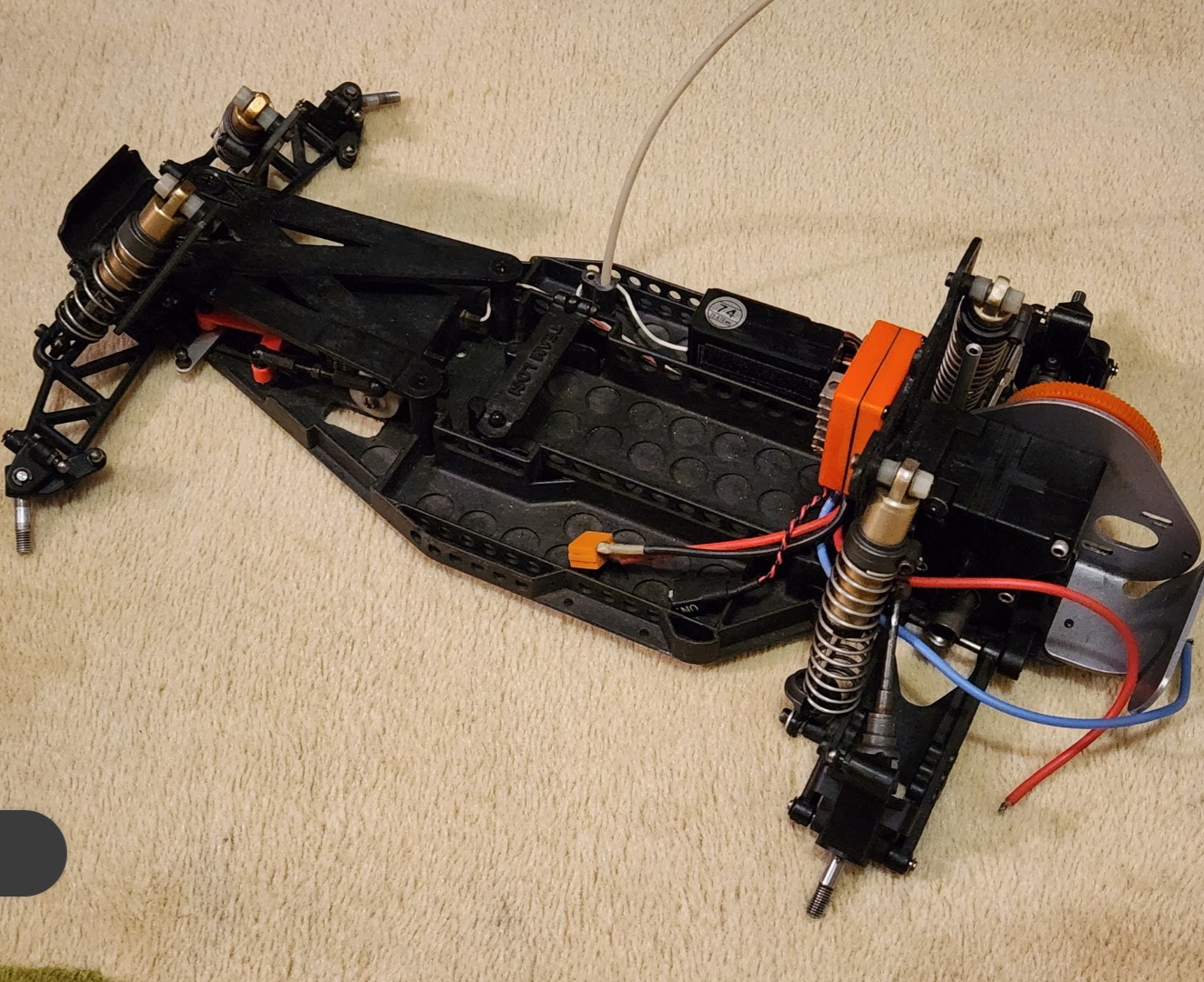

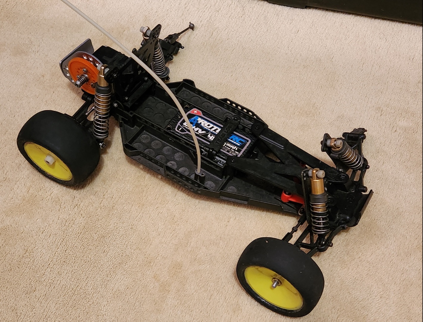

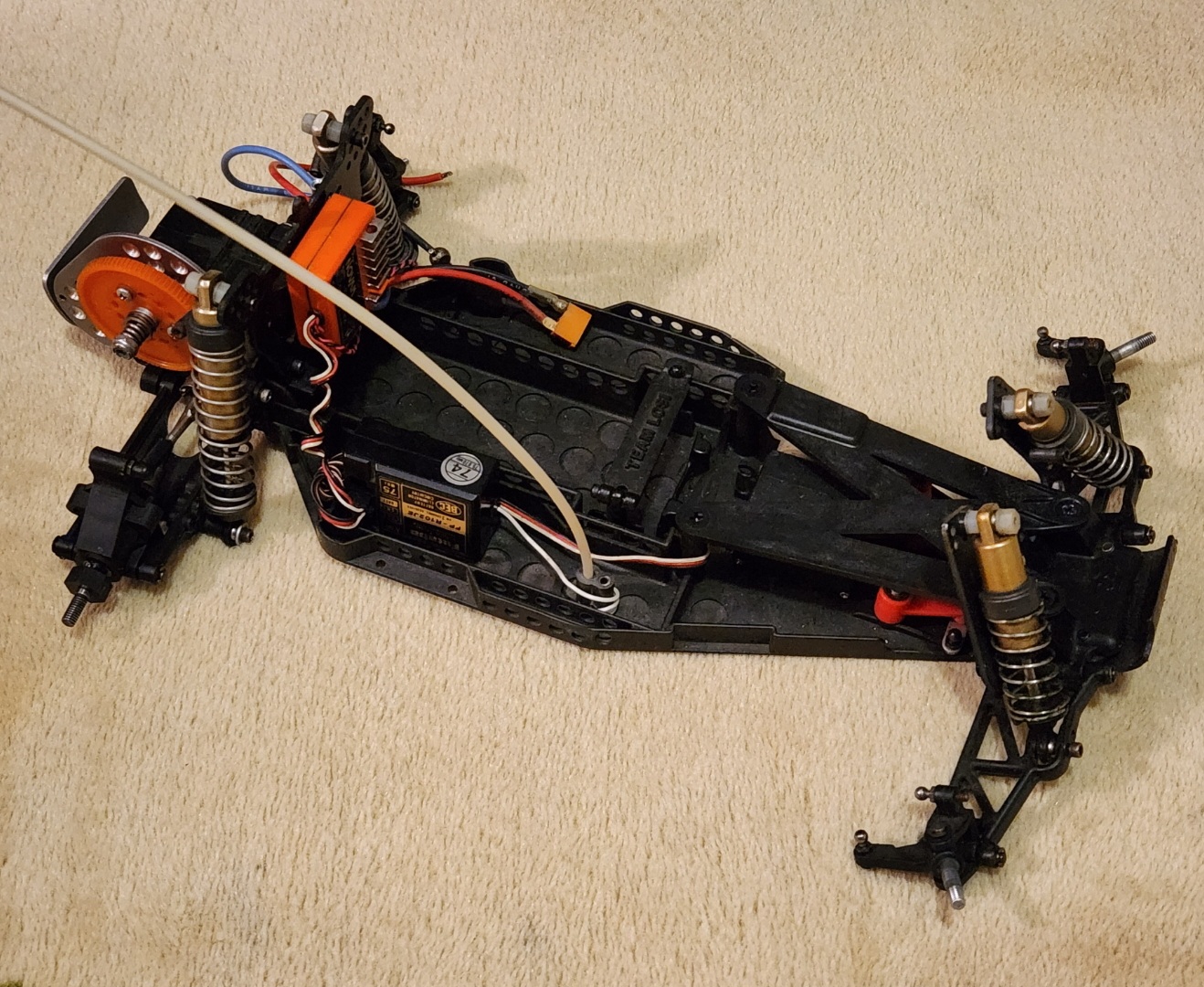

I've had this buggy that has lots of factory driver or factory supported parts that's essentially what factory guys were doing with the JRX Pro before the SE was released, so maybe 1989/1990 ish. Anyway the 21.5 heritage class is growing like fire because of the re re 40 car, so I thought I'd run it with something different.
Here's the start. Updates as possible!
Posts: 9282
Has thanked: 355 times
Been thanked: 470 times
Re: 2025 21.5 Pre-Pro SE buggy

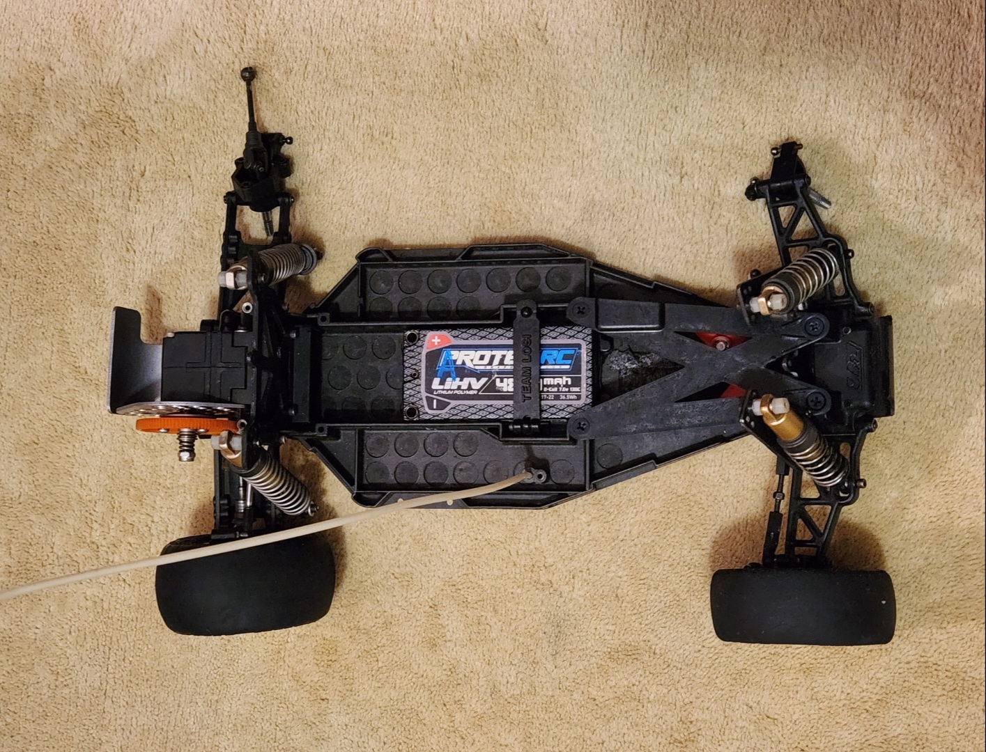

Geometry looks good, B6.4 rears fit with 6mm wide 12mm hex blocks. JConcepts RC10 fronts line up well. Car was setup for 7 cell, so the chassis works well for shorty packs moved forward.
Still need to get into the trans and see what's in there, there is a slipper...may be a Powerclutch.

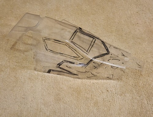

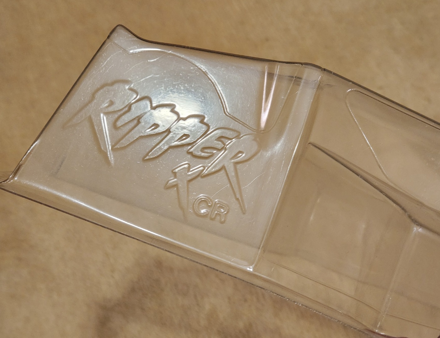

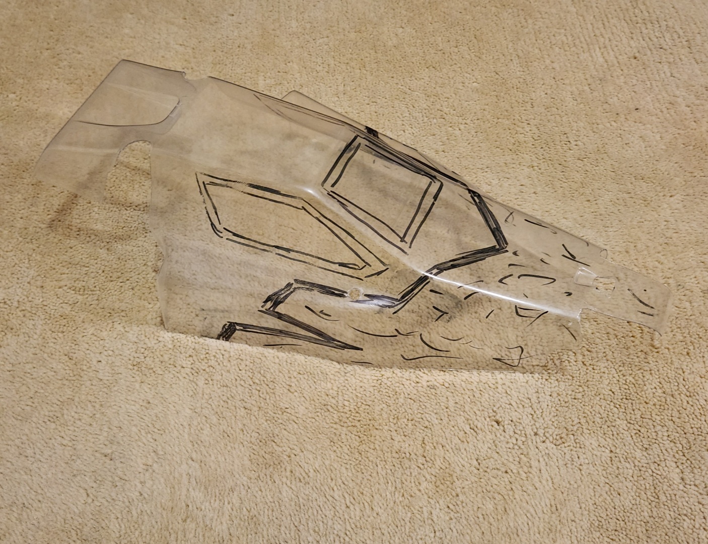

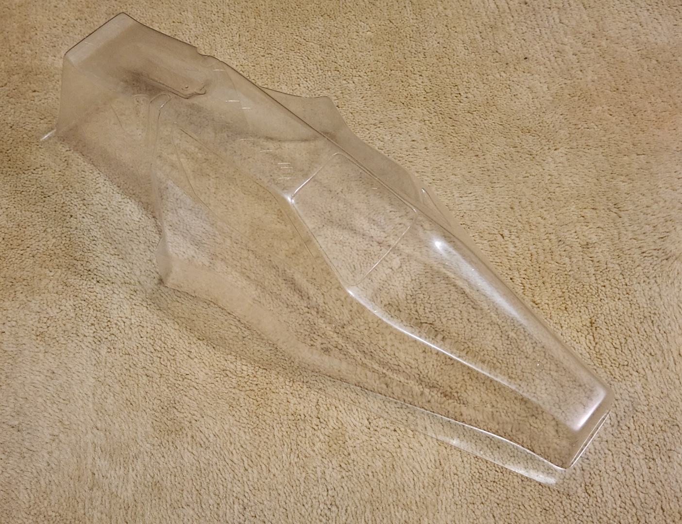

Dug into the body stash and found one of Brandon G's original 2009 ish reproductions...our current paint scheme looks good on it. But...found this Protoform xx-cr Ripper X which looks pretty damn cool and looks like it will fit too.

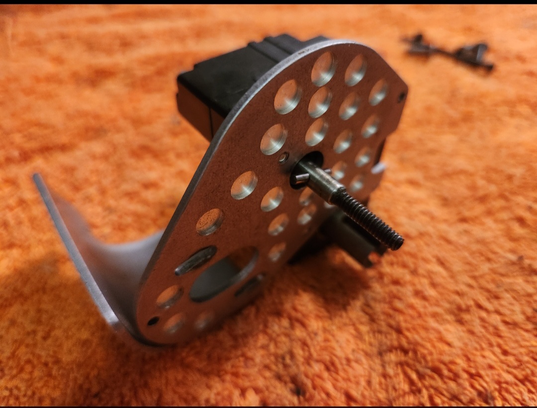

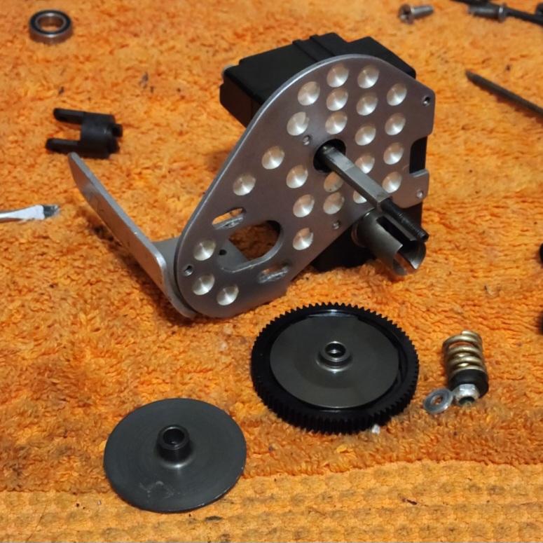

Tore into the trans. Built well, diff is solid. Outdrive bearings were rubber shielded and as stiff as bushings, so I replaced them with some silky ones from another trans. I never realized how tight the Losi tolerances were. Good god that was a pain in the ass to change!

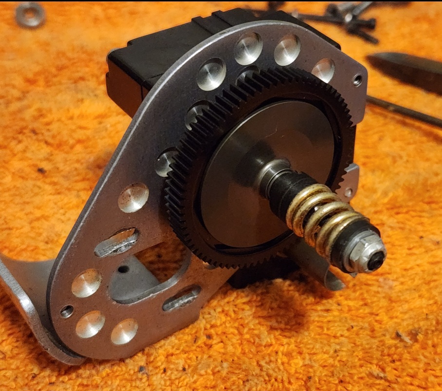

Trans is much smoother, still not stealth smooth...prob can't get that out of it anyway. Changed out the topshaft to a hydra one I had kicking around and threw on a B4 slipper setup
Anyone have any tricks to make this trans ultra free?
RC10th
Posts: 4761
Has thanked: 52 times
Been thanked: 1548 times
Post by RC10th »
Ceramic bearings...
Eliminate the slipper....
Is the tightness caused by the mesh or other friction? It's a pain trying to find the source but I've found that even a snug fitting bearing pocket in a transmission case was enough to seriously slow down a bearing.
Posts: 9282
RC10th wrote: Mon Oct 07, 2024 8:01 am Ceramic bearings...
With the silly putty traction surface we're on at my home track I'm afraid the shock to the driveline would toast these gears. Ceramics are a possibility...assuming I can figure the bearing sizes out lol. Seems more like gear interface friction to me. It's not bad, just not 21.5 smooth

Charlie don't surf wrote: Mon Oct 07, 2024 7:21 am Changed out the topshaft to a hydra one I had kicking around and threw on a B4 slipper setup
How does that work?
Posts: 9282
JosephS wrote: Mon Oct 07, 2024 2:25 pm
How does that work?
The Hydra shaft "cut" and spacing is the same as the B4-B6
Slipper hubs. I'll shoot pics this eve

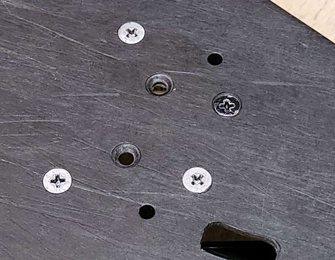

I just noticed that it has a JR2 chassis instead of the Pro SE one.

RogueIV wrote: Mon Oct 07, 2024 4:54 pm I just noticed that it has a JR2 chassis instead of the Pro SE one.
Charlie don't surf wrote: Mon Oct 07, 2024 2:42 pm
Sorry, I guess I didn't mention that in the first post. A lot of racers were doing this with the JR2 chassis for some time before the Pro SE was a thing
How does that work?

Not a bad idea. I may try the old toothpaste packed slave case trick.

We used to pack a case *not the one we were racing* with toothpaste and bushings, junk balls and rings and just run the gears in with a dremel on high attached to the top shaft to burnished the gears in and create a soft "wear" to free up any binding in the gears.
Also. That trans is stealth free and quiet now. The gear on the Hydra shaft wasn't as smooth as the one on the power clutch top shaft, swapped the topshaft gears, changed the diff bearings and it's silky and quiet. Now it is ripe for ceramics once I find the sizes needed
