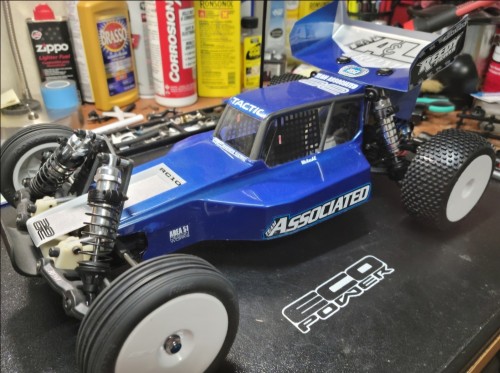

- juicedcoupe
- Posts: 3445
- Location: Pascagoula, MS
- Has thanked: 265 times
- Been thanked: 2032 times
Re: Aluminum/silver shocks for Javelin re-re
These shocks were originally anodized blue and the caps black.
The bulk of the color was stripped with Easy Off. Any remaining color was removed with a brass wire wheel on a Dremel.
The main polishing was done with a buffing wheel and white compound. They were then finished with a polishing flap and Mothers wheel polish.
