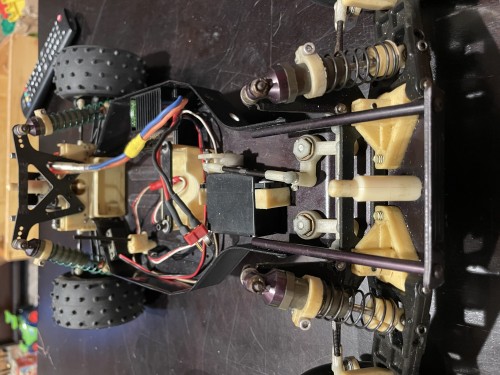

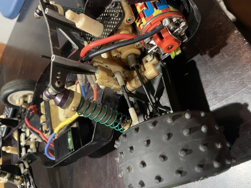

What do you guys think? The pan is milled and the stamp is a “C”.
I can take more pictures. Some of the pictures I took were too large to load.

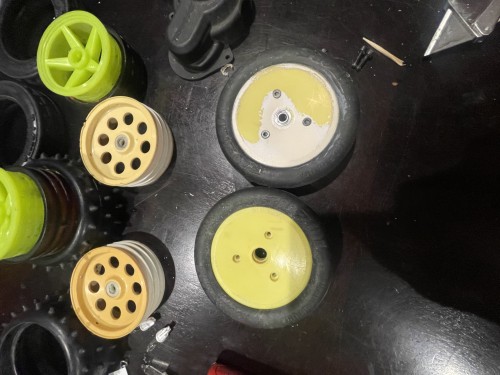

Started to clean the rims. The previous owner painted them white.
I’ll need a yellow set for the rear. Does anyone know where I can find a set of yellow for the rear?

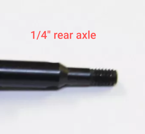

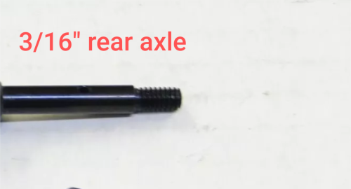

3 piece or 1 piece? 1/4" or 3/16" rear axle? Aftermarket 1 piece rears are available. Several options here:

Thanks for the link. I need wheels for an rc10gt as well. I have to replace the battery in my digital caliper before I find out the axle size.
Thanks again for the link. Do you know what that era world’s car would have came with? Assuming the front are period correct with a three piece do you think the rear would have been three piece too?

The original 1994 front wheels were 3 piece and rear were 1 piece.

1/4" rear axles are 1/4" where the bearings go and smaller size where the wheels go. 3/16" rear axles are constant size.
