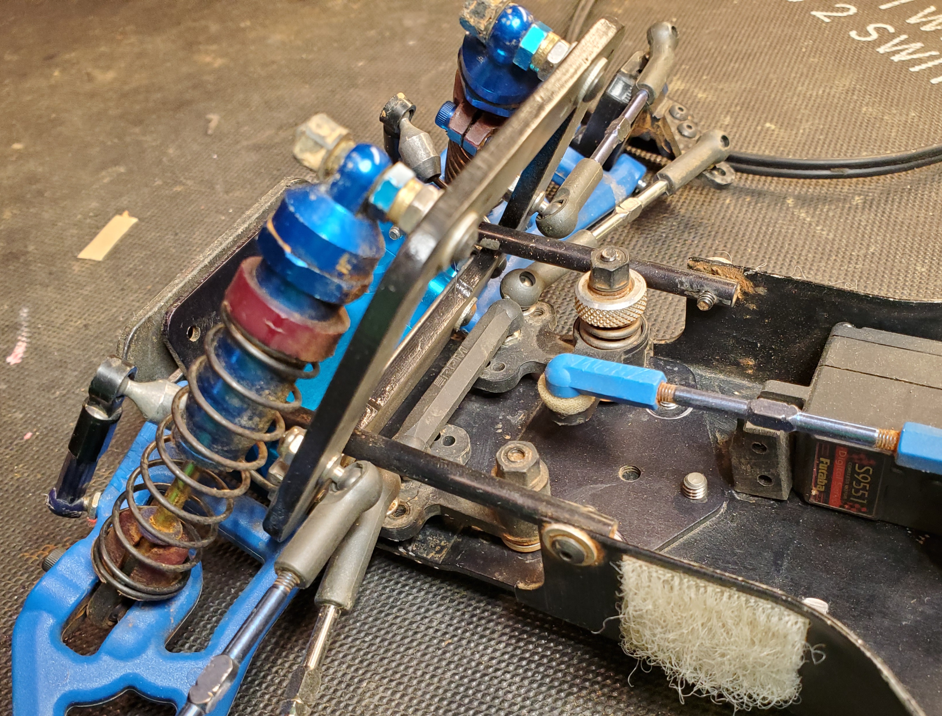

Re: RC10 Retro Racer
If using the GT/DS servo saver with the nose plate in the long wheelbase configuration, you should attach the bellcranks/servo saver to the front holes (you might have to tap them, 8-32). Then use 1/4" (100*) screws to attach the nose plate to the chassis.
ahhh-- this will probably improve the steering geometry significantly. thank you!juicedcoupe wrote: ↑Thu Sep 05, 2024 11:18 am If using the GT/DS servo saver with the nose plate in the long wheelbase configuration, you should attach the bellcranks/servo saver to the front holes (you might have to tap them, 8-32). Then use 1/4" (100*) screws to attach the nose plate to the chassis.

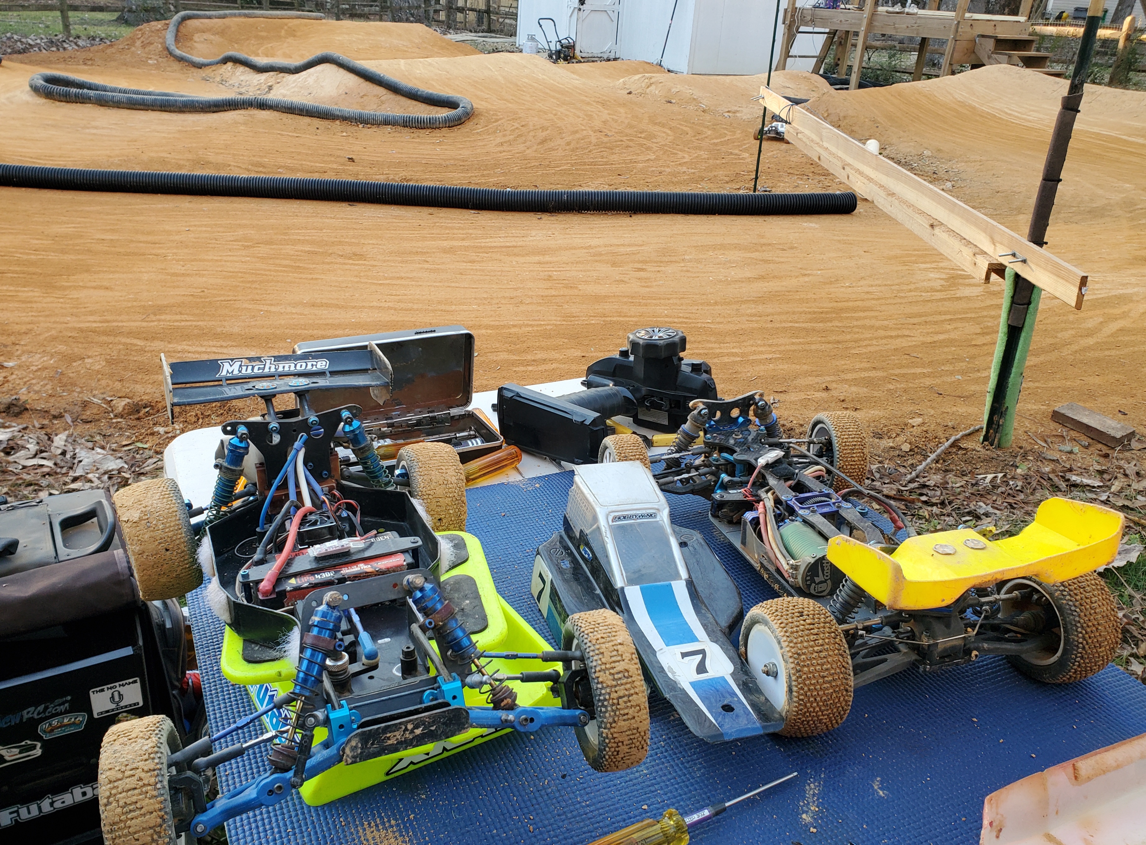

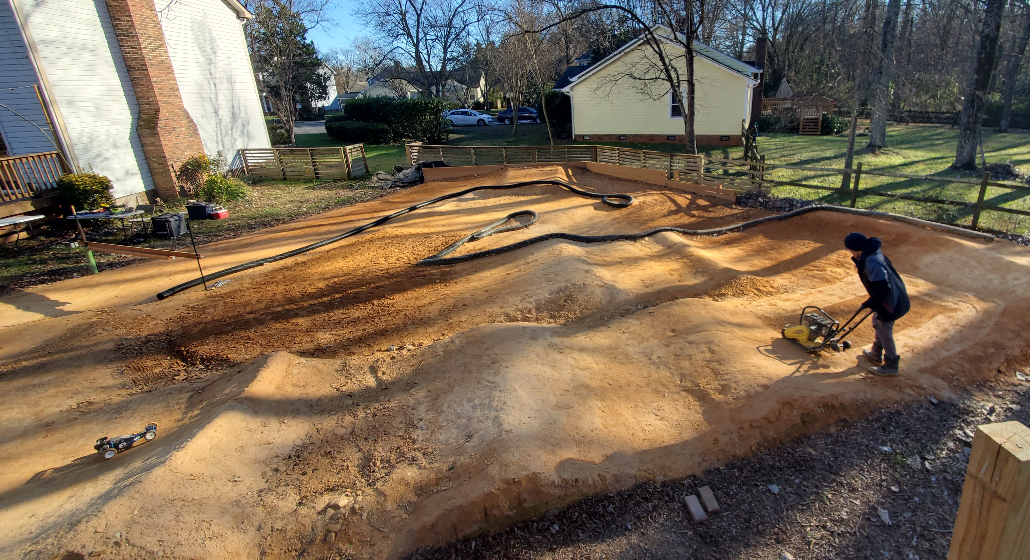

Had this buggy and the B44.3 out at a friend's backyard clay track this weekend. Making the triple was not possible with this car, but the double was doable, sometimes. Had a blast.
The 8T motor is playing havoc with the ball diff- my slipper must be too tight or I just haven't set the diff correctly. It's all kinds of gritty, with new ceramic balls.

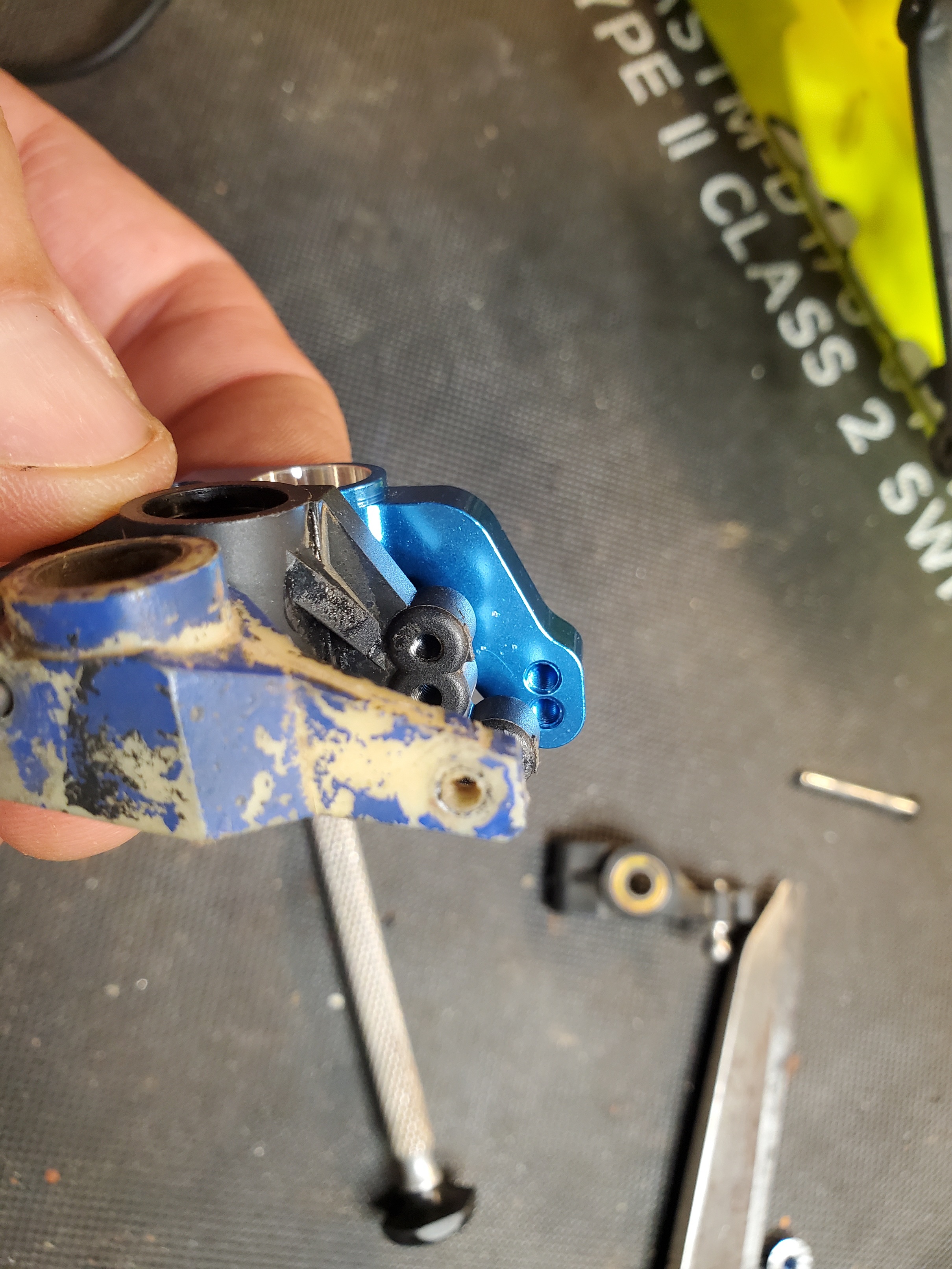

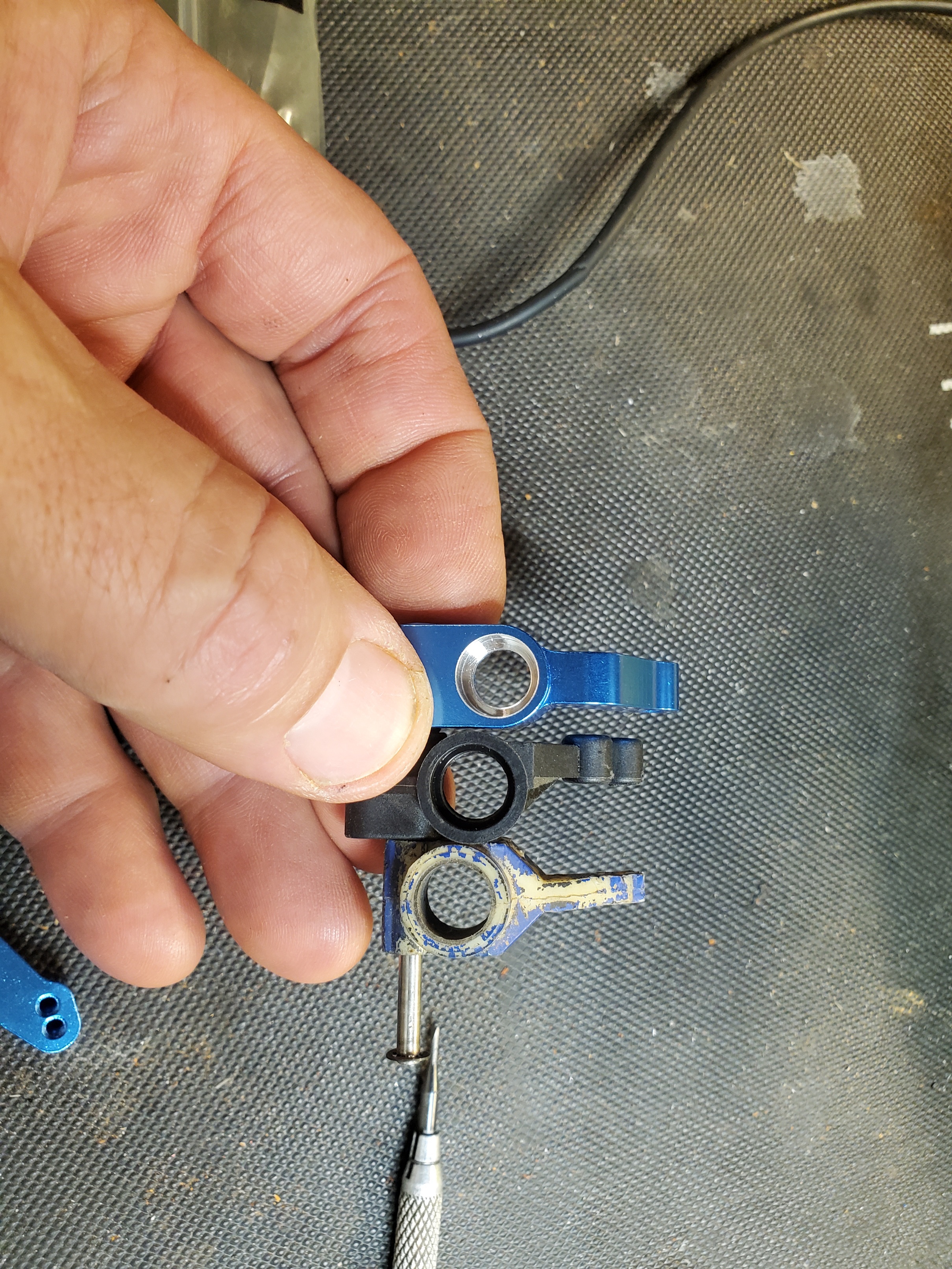

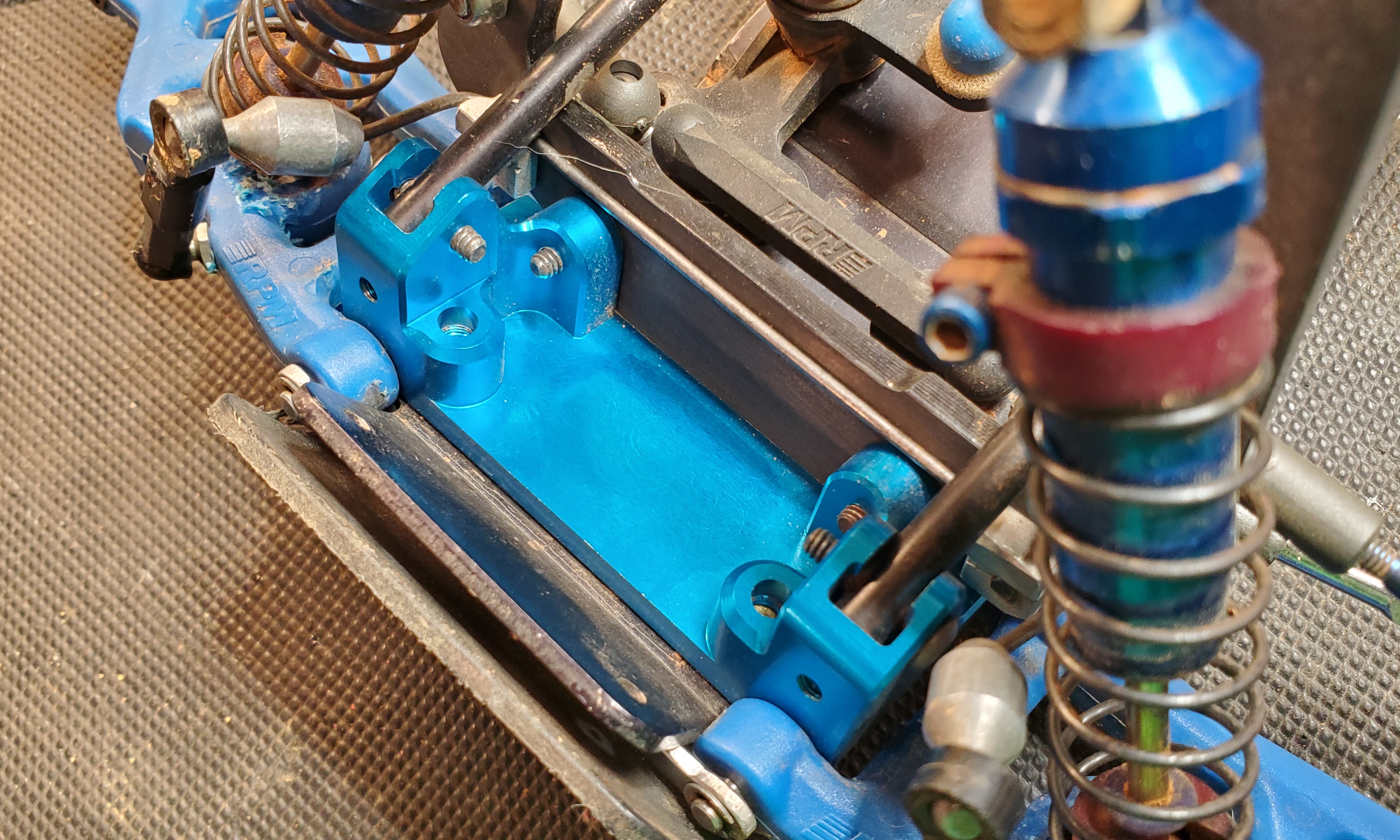

Upgrades!
The factory nylon front block was not able to retain the shock tower screws.
Went with the blue aluminum DHawk front block to support the 4mm front shock tower.
