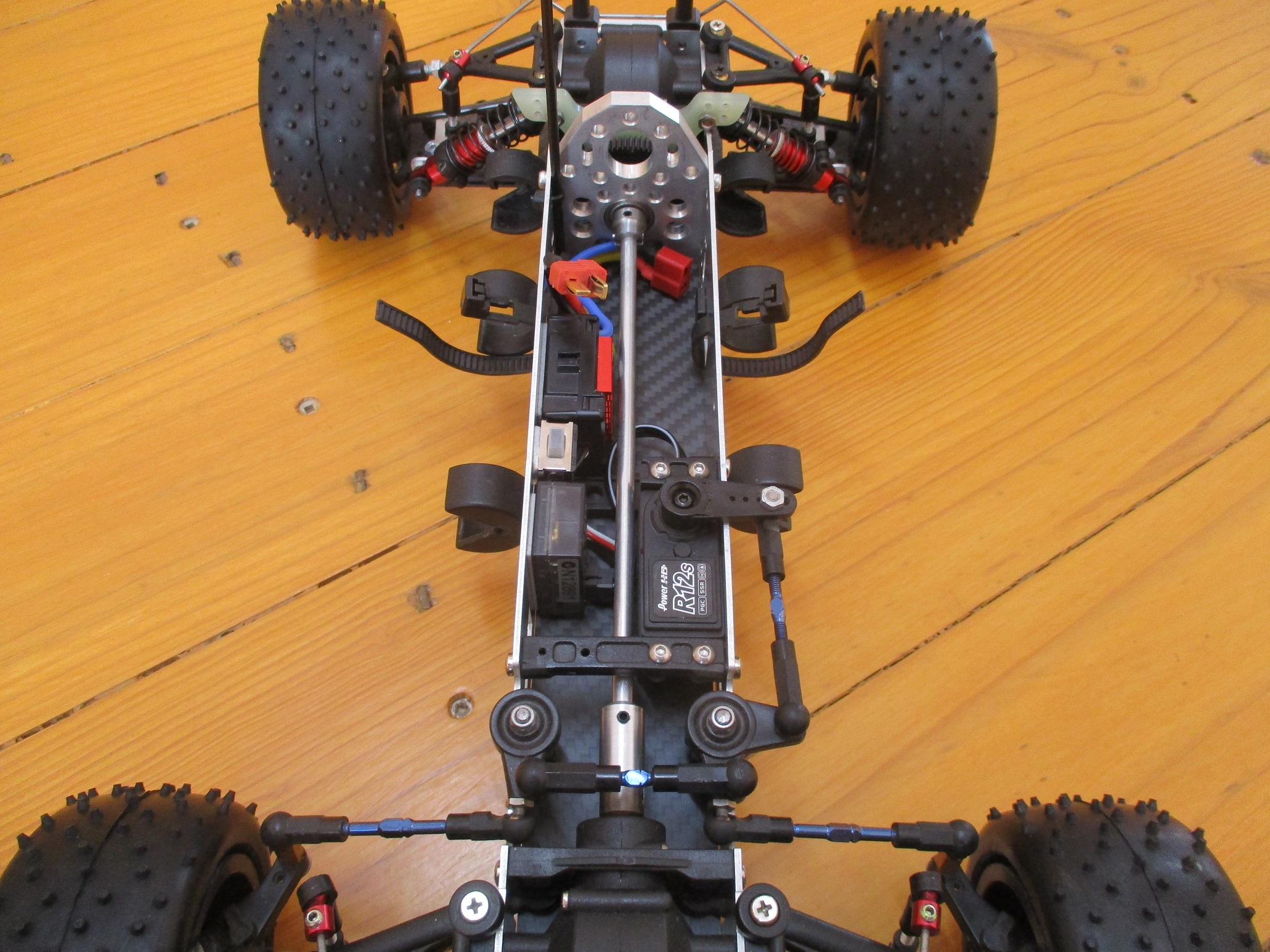

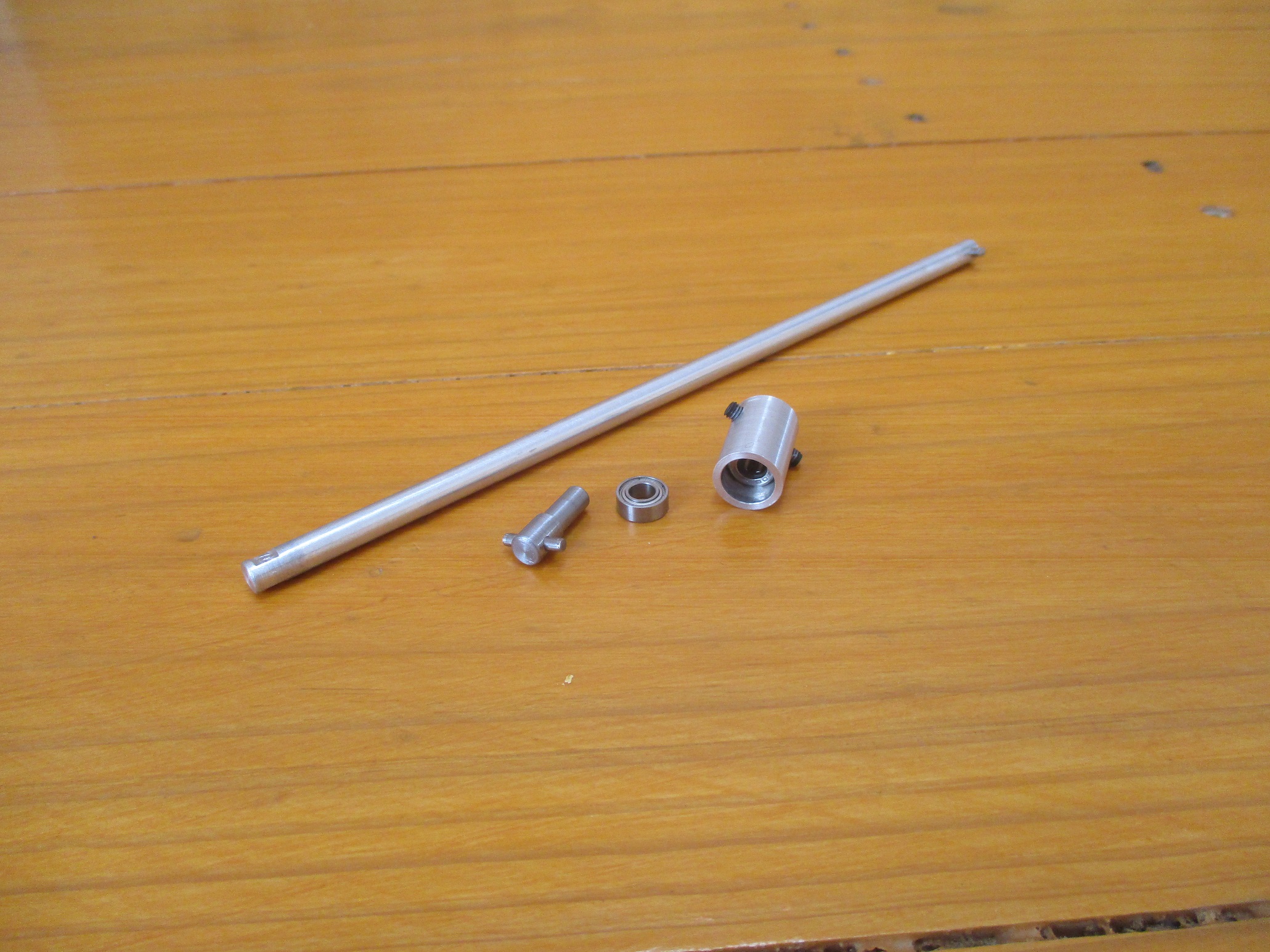

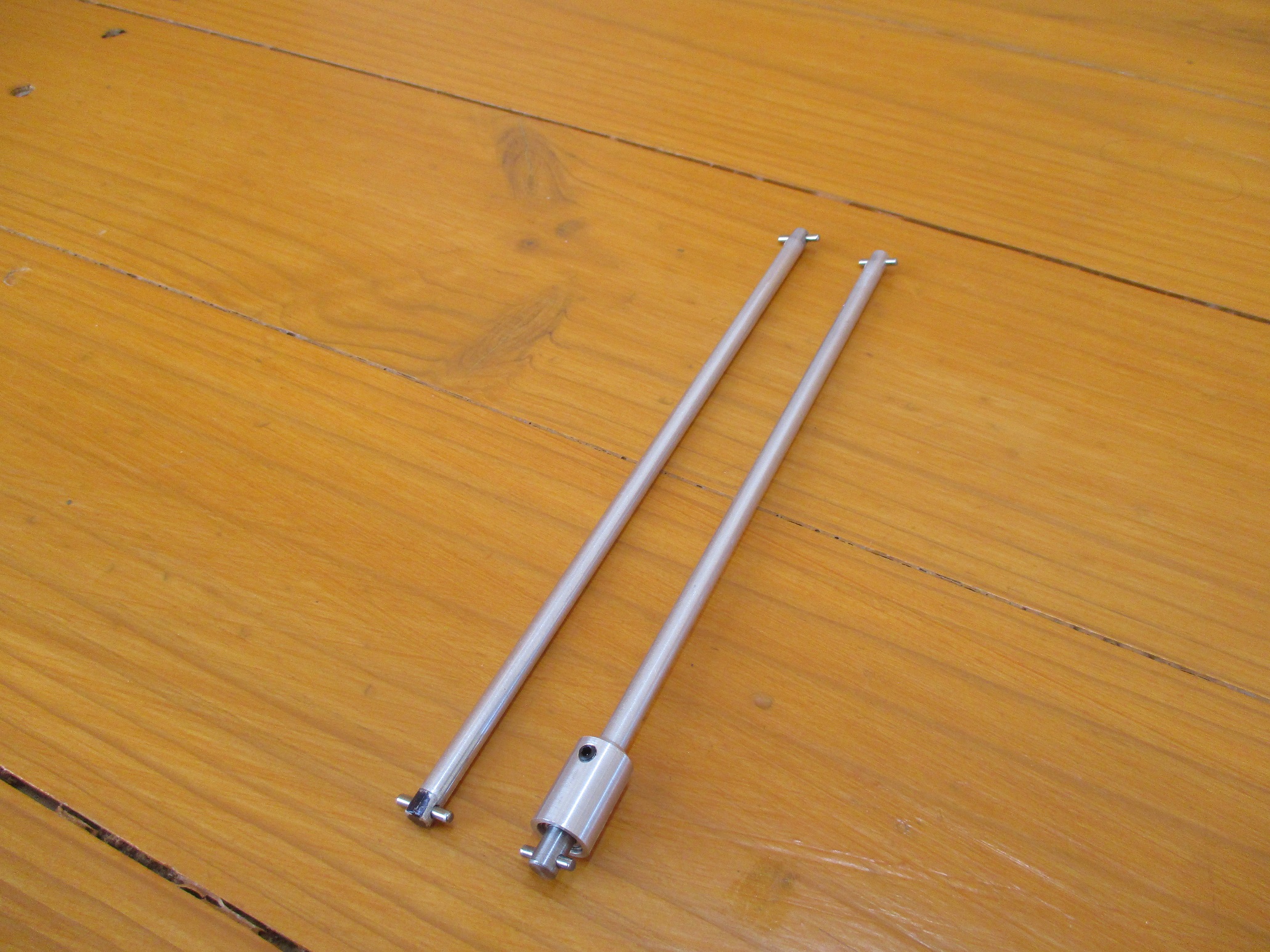

The final tuning option I wanted to try is a one-way main driveshaft. All the parts are in this picture. The short front steel piece still needs to be hardened.
Assembled and side by side with the full-time 4WD shaft.
Fitted into the Coyote in this picture. Very smooth. I can swap from full-time to part-time drive in less than ten minutes. Absolutely chuffed.
It'll be interesting to try it out on a high grip track.
Chris.

Love the one way , been thinking of this for my hotshot for some time .

I was playing with the idea of making a one-way spool to replace the front diff but I will need a rotary table to drill holes radially to mount the crown gear. I ended up going with the one-way driveshaft due to having the materials and equipment on hand.
Dadio wrote: Sat Dec 28, 2024 2:24 am
1300GT wrote: Sat Dec 28, 2024 1:30 am
Coelacanth wrote: Tue Dec 24, 2024 12:08 pm Gotta love a custom Kydex bumper! 8)
Thanks. I reckon it looks pretty damn good. :D Too bad it'll get used.
The final tuning option I wanted to try is a one-way main driveshaft. All the parts are in this picture. The short front steel piece still needs to be hardened.1.jpg
From memory, at least a couple of companies made one-way shafts for the Hotshot. One was Japanese and came as a complete shaft. The other was marketed by Dynamite and was called a torque splitter which was just the housing and bearings. I'm pretty sure with that one you used the Hotshot's stock driveshaft which you had to cut yourself.
Did SRM make one as well?
Hot Trick made one-way front wheel hubs with matching stub axles for the Hotshot.

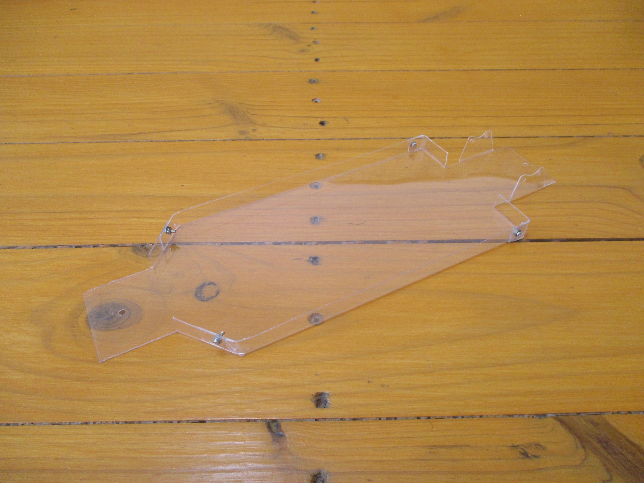

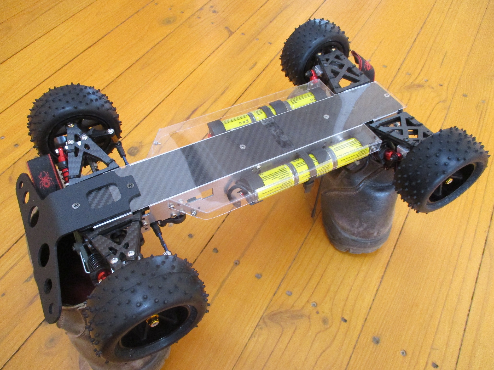

Finished the last improvement today. Knocked up an undertray from 0.5mm PETG. It won't help performance, but I think it's necessary considering the position of the cells. They can take an awful lot of hits from debris if you aren't using a full width chassis.
Fitted. Bloody marvellous I reckon. :D
Almost done now.

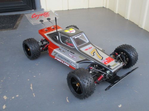

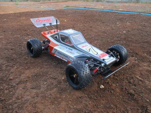

Finally done. All painted, stickered and threadlocked.
Getting ready for a run on the weekend.
