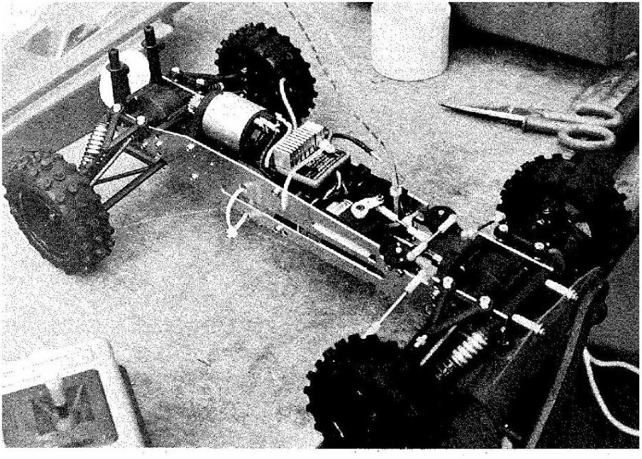

New pics of the day:
Where I am..., electronic is in place , with some good thinks:
-Motor DEMON
-ESC Novak 4
-Servo RS700 / 131 sh FUTABA
-Receveir Micro
The rear :wink:
The front :lol:
The front shock tower like the rear, I must cut the front body mount, if no I have the same trouble than on the rear.
Washers on the screws.
I used a plastic ring from wheel, to replace the ring spring presure, I broke the original... :twisted:

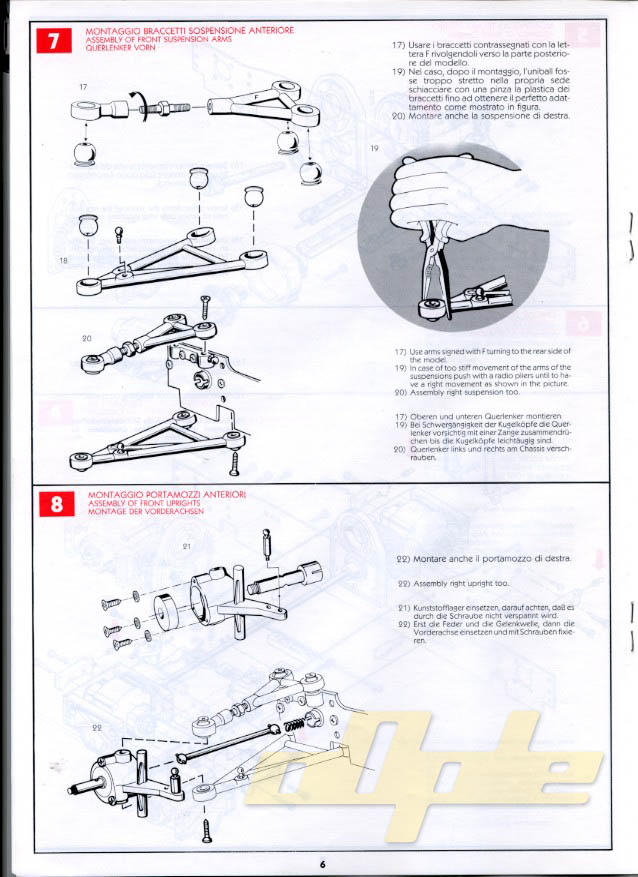

from Oople web site.
On the manual , they says to use a radio pliers to have the right movements, but when you do that the plastic breaking.
Without built of the ball from the arm, use a long screw with a bolt and put it on power drill, and drill with short run until you have a soft movement, it's long but it's the best way to save your arms.
Carefully with the ball on the shock support, the hole is short and the part is thin...the plastic is very fragile.
Same thinks on the lower shock cup, the hole is short and I filled them for a good alignment...
Enjoy :mrgreen:
