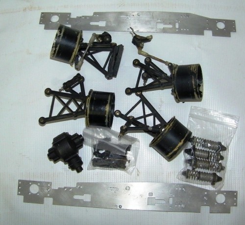

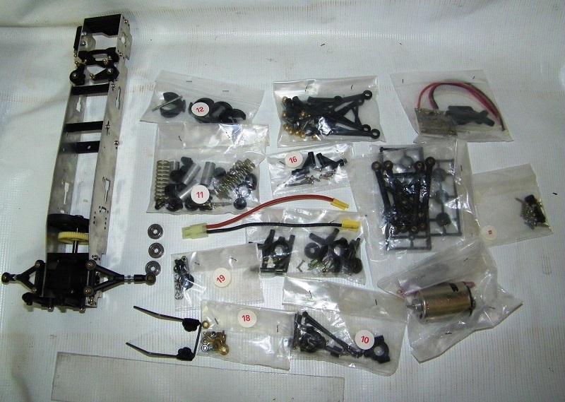

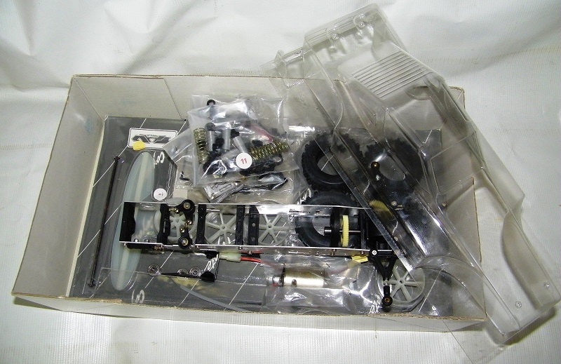

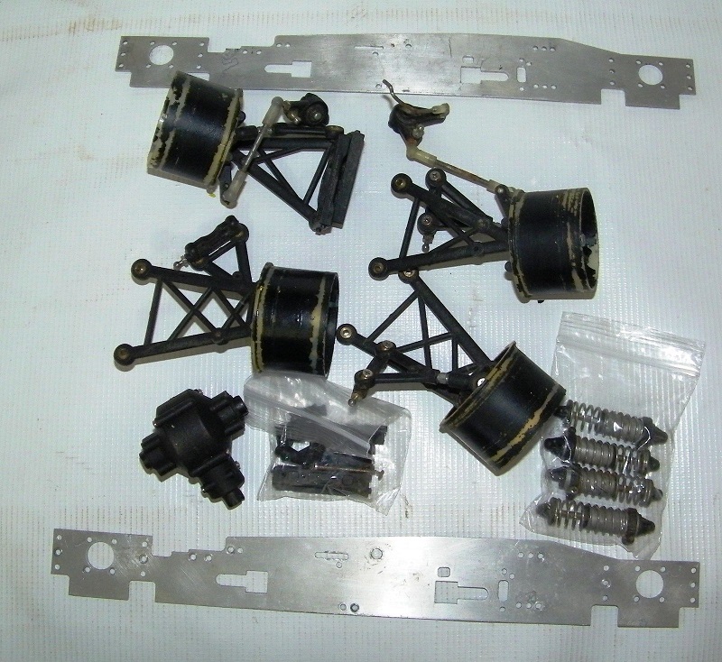

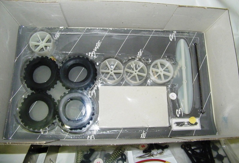

So.... i have posted a few of my old race cars on the forum already, and they are the usual RC10 and Yokomo offerings, but when i was just getting into R/C i always lusted after the adverts of the TAG Coyote which was posted in Radio Race Car magazine each month. I remember it boasting about it having won the Italian 4wd championships some time in the late 80's. Anyway, i always thought they looked cool and a little different.
I had long forgotten all about them until somebody mentioned them in a thread on here a couple of days ago and that mention jogged my memory and as clear as day i could see the old advert in my head.
Reminiscing, a quick eBay hunt later and i just won one. It appears to be a mish mash of a NIB 2wd kit, but comes with the 4wd central drive shaft included, as well as also coming with some spare parts of what look to be the missing 4wd items. Namely the other gearbox and the required front hubs and 4wd black wheels. I will know what is there (and what isn't) when it eventually arrives, but i am pretty excited about this build project. Certainly something very very different anyway. In my eyes at least these buggies look amazing.
Supposedly they drive like an absolute pig having read a few reports on here, but i'd love to try to make something of it and get it on to the track, and I already have a few mods in mind for it. Does anybody on here have any spares (or know anybody who might have)?
Some pics from the ad....
