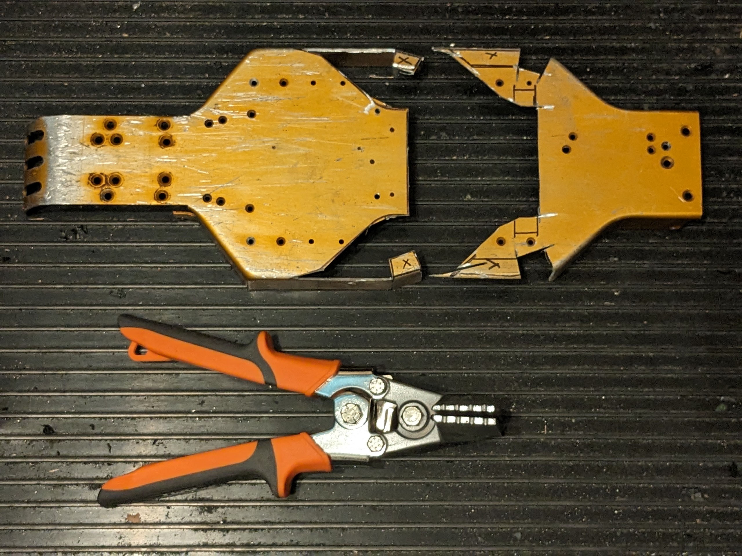

This started as a trial to see what I could do with an unloved gold pan tub. It started with some snipping and bending.
It finished up with brazing, filling, sanding/filing/grinding, and some painting. Then assembly with standard A stamp parts...

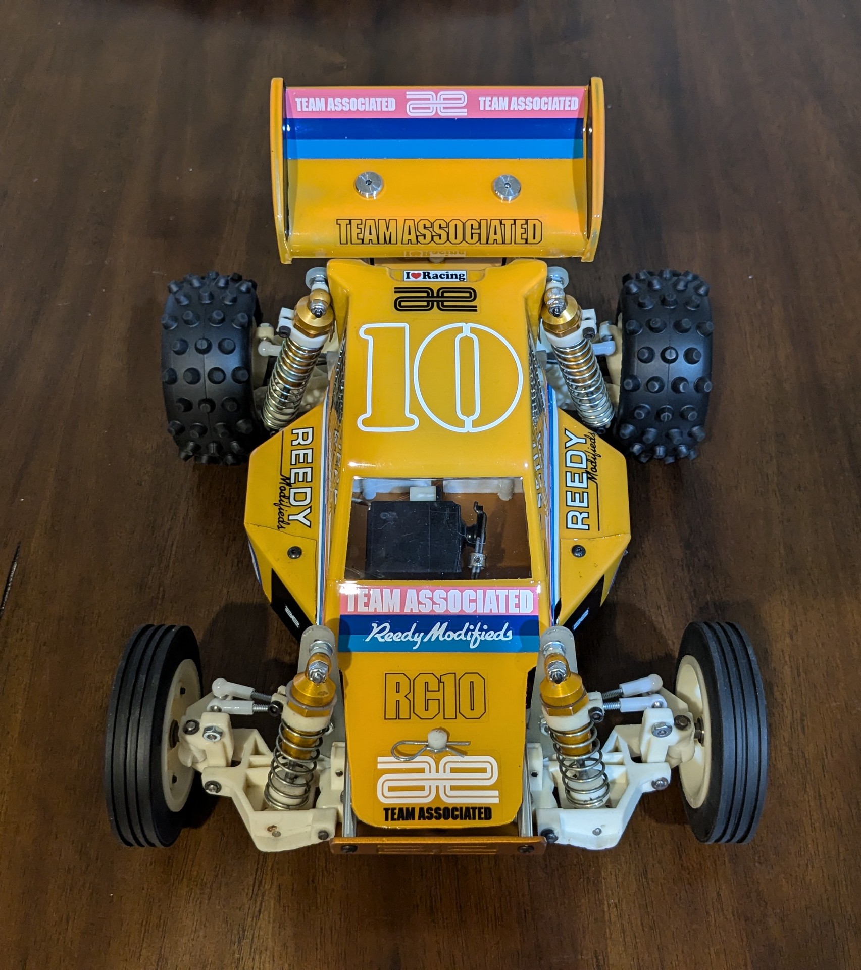

It's 3.75" shorter with an even 7" wheelbase. Same as Frankenshorty #1.
I added a 3 screw Novak 1 ESC, Novak NER-2X Rx, and a CAM modified.
The batter cups are sized to hold an Ovonic 2S 50C 1000mah battery. I still need to change the battery's connector so I can go do some romping around.

This is awesome! Was going to say, I know you could squeeze a mini or micro battery in there! So how does it run? Gotta be a wheelie monster!

Yes, looking forward to seeing the stubbie tub in action! This is way more appealing to me than the mini and micro stuff since it shares parts with the 1/10 version 8)
