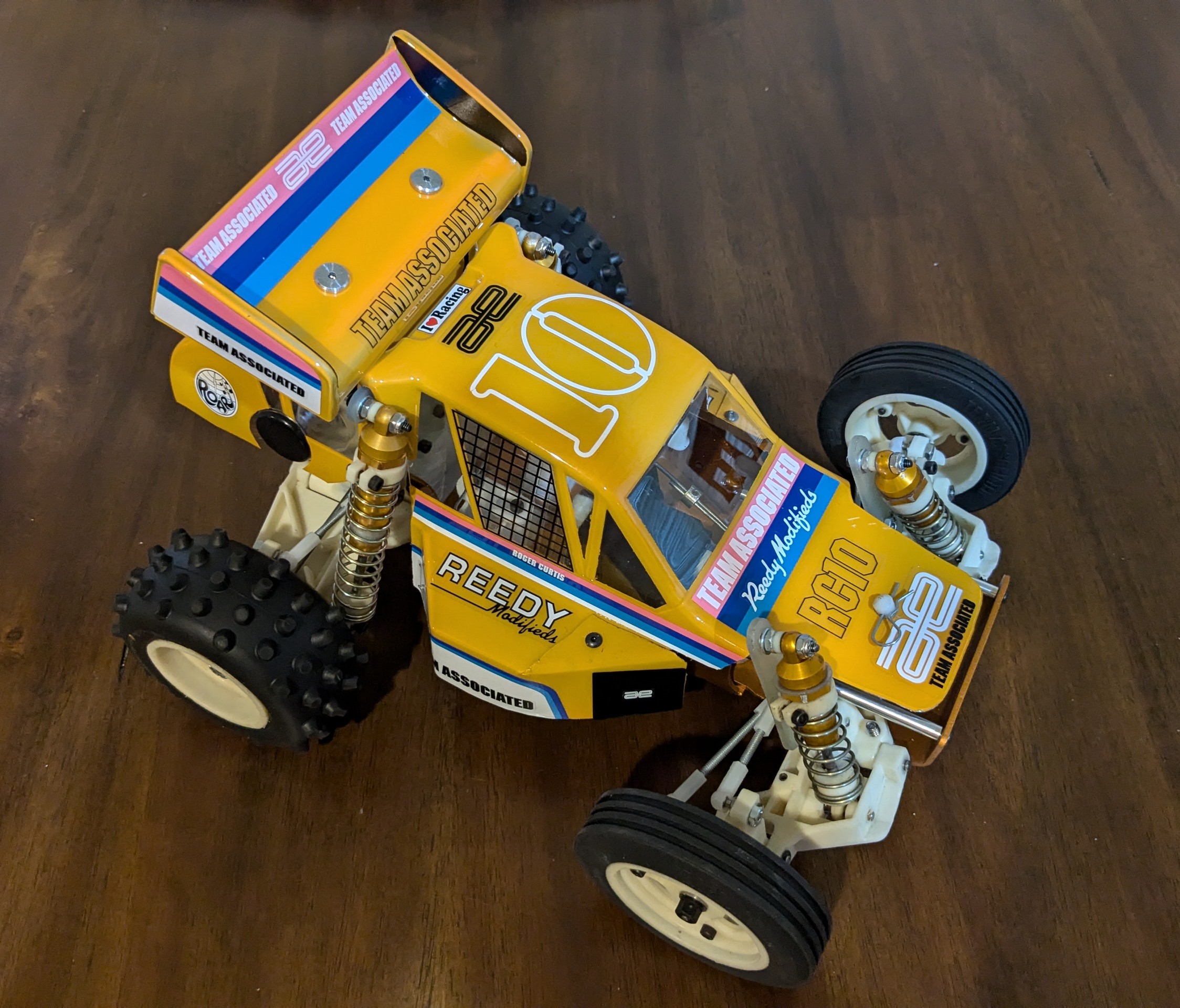

This started as a trial to see what I could do with an unloved gold pan tub. It started with some snipping and bending.
It finished up with brazing, filling, sanding/filing/grinding, and some painting. Then assembly with standard A stamp parts...
It's 3.75" shorter with an even 7" wheelbase. Same as Frankenshorty #1.
I added a 3 screw Novak 1 ESC, Novak NER-2X Rx, and a CAM modified.
The batter cups are sized to hold an Ovonic 2S 50C 1000mah battery. I still need to change the battery's connector so I can go do some romping around.

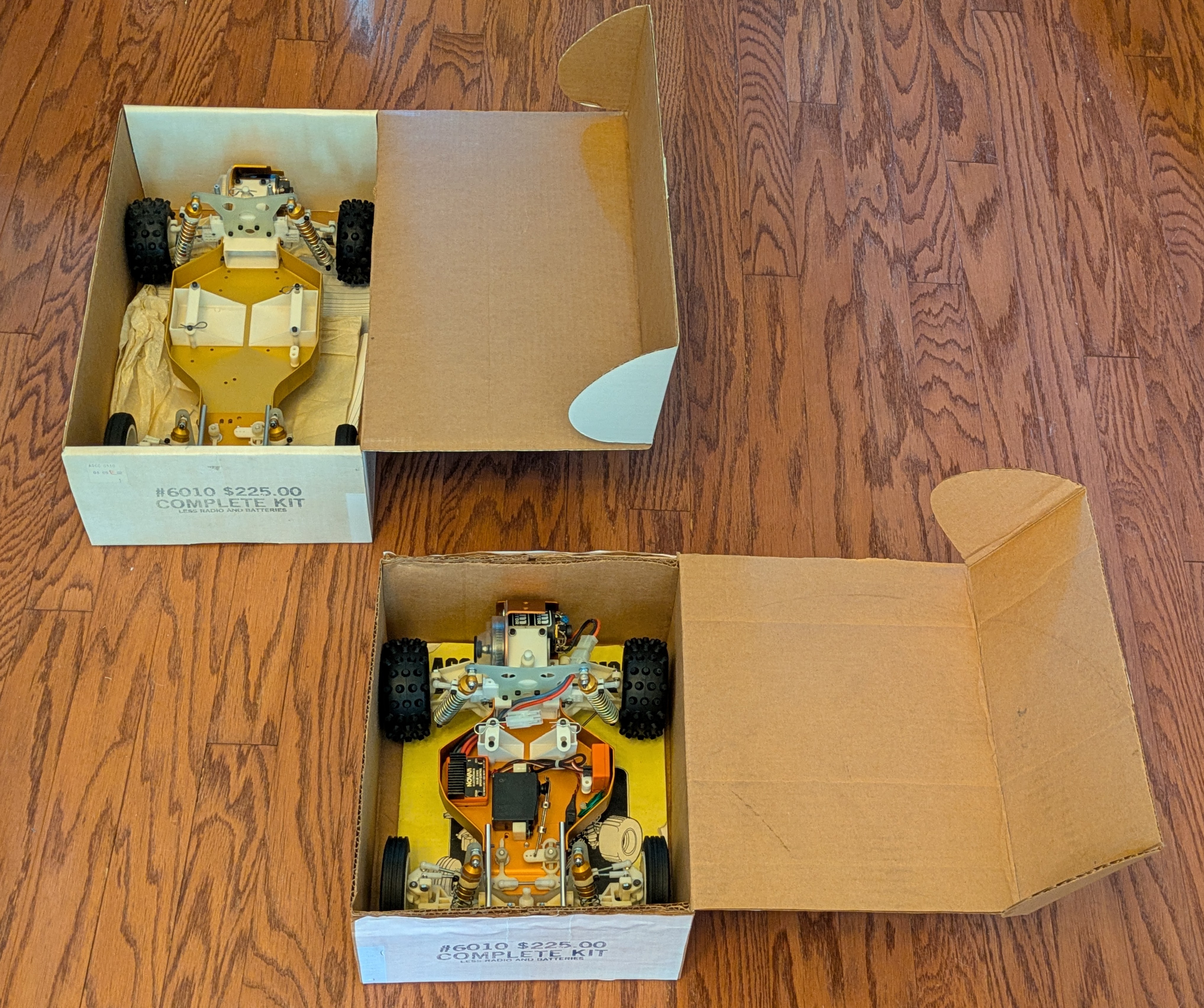

It turned out pretty nice so I thought it should have a storage box too. I took photos of one of my nicer boxes and resized them for the graphics.

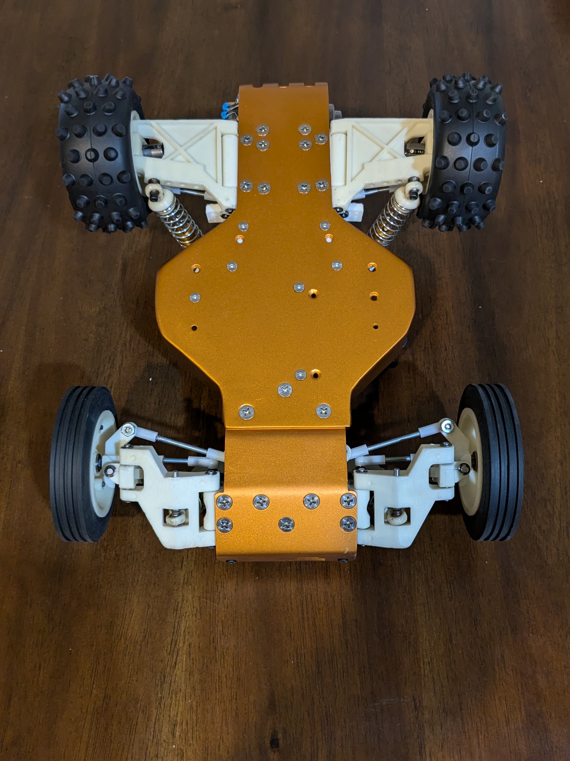

Needed a rear skid plate too. I learned that lesson with Fs#1.
This is what I use for aluminum brazing.
